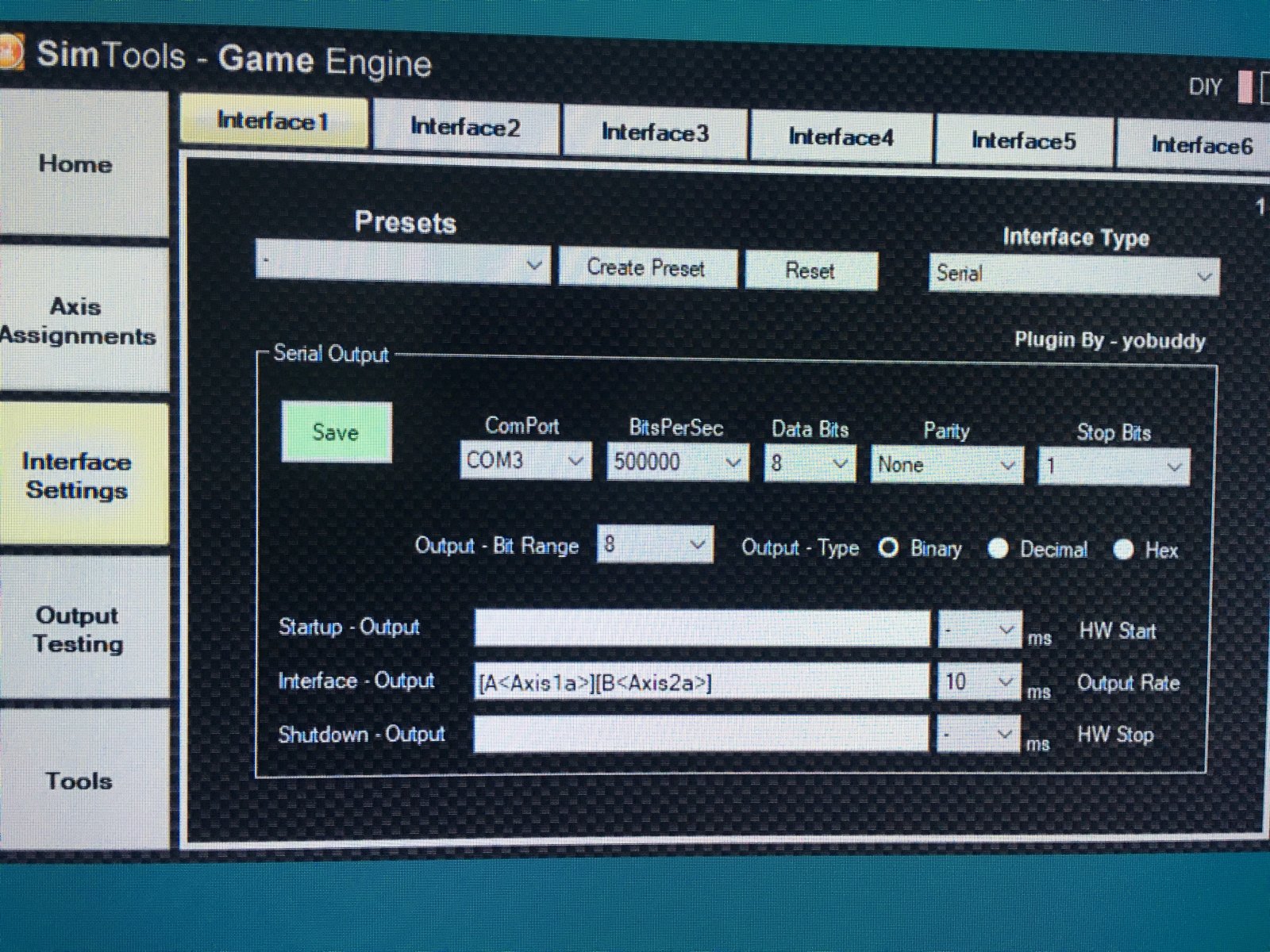

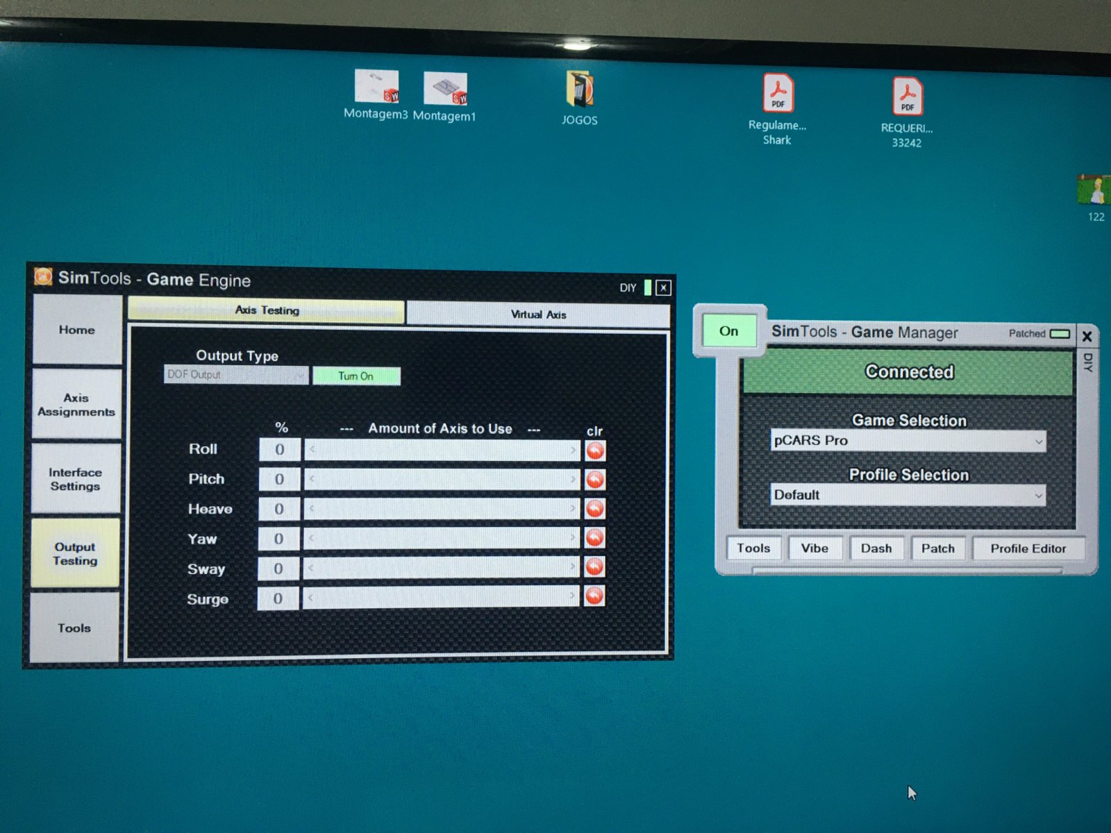

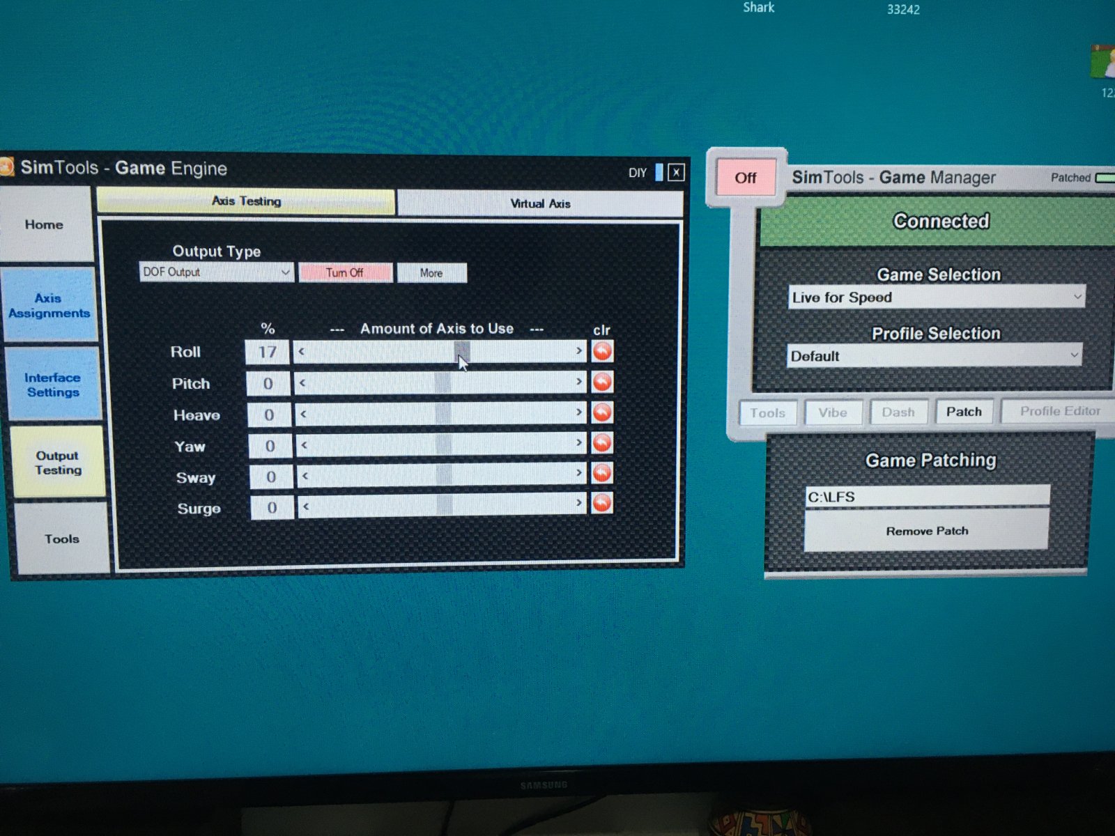

    I formatted my PC and installed Windows10, and now SIMTOOLS no longer sends commands to the 2DOF device when I do the "Output Testting". What can it be?

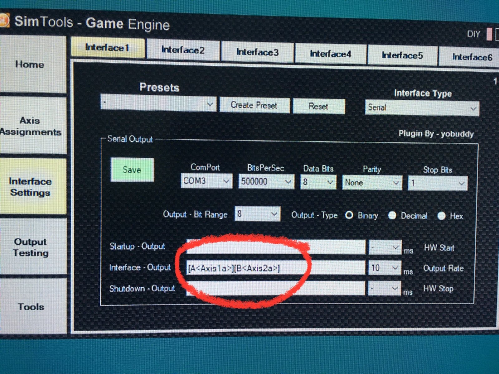

    Interface - Output "L <Axis1> R <Axis2>" or "[A <Axis1a>] [B <Axis2a>]"?
    Please help.
    Thanks.
    Considerations:
    - 2 Engines
    - Updated version of SimTools 2.5.1
    - SMC 3 communicates normally with the 2 engines.

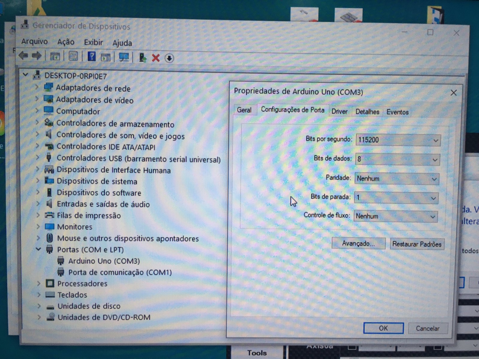

    - Com3 arduino port
    - Arduino uno and 2xPonte H 43a

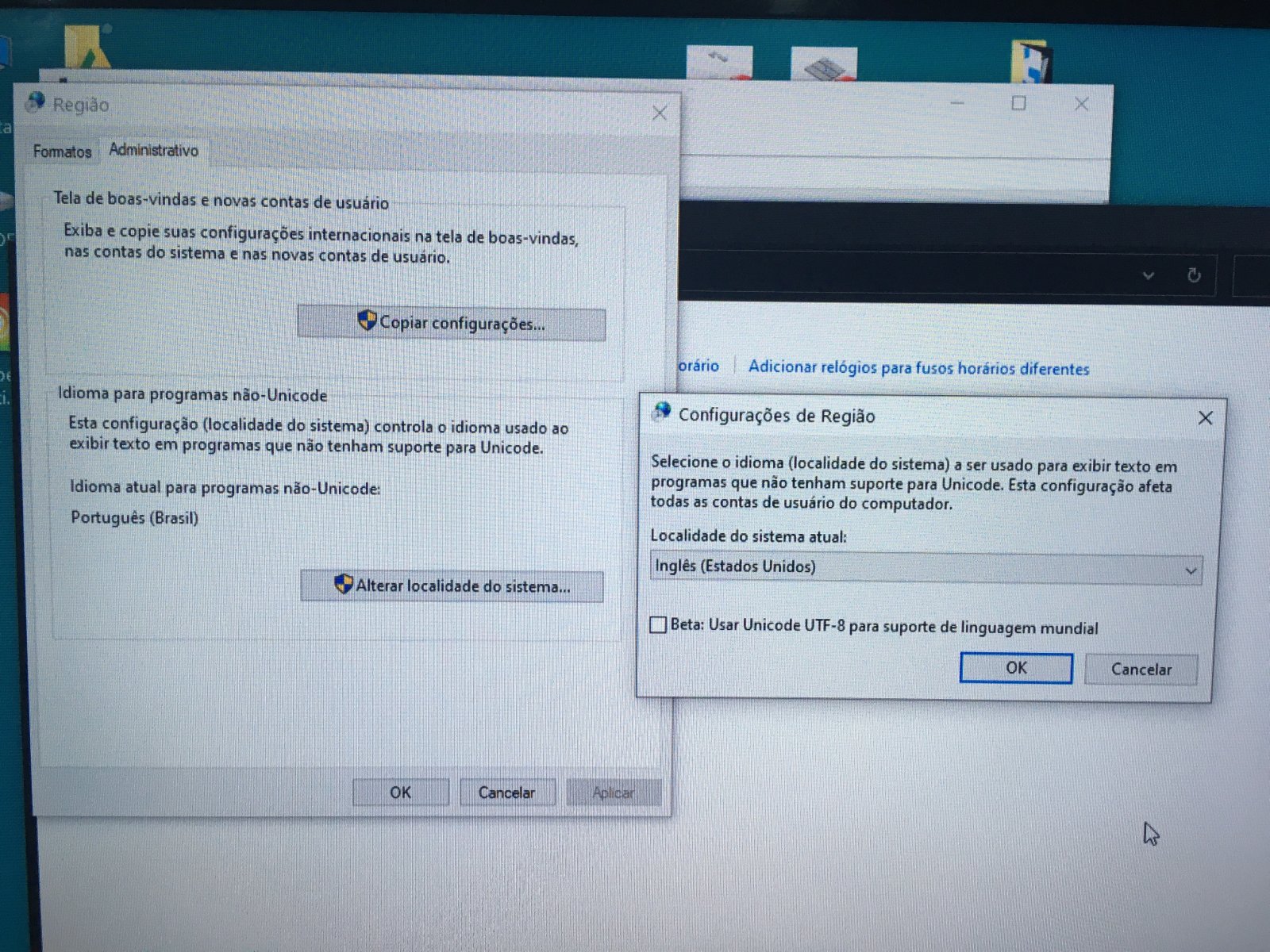

    - Language "Unicod" English United States

    Have you configured a Default Axis Assignment profile, as that is what Output Testing uses.
    Output Bit Range should be 10:

    Hi. Thank you so much, it worked perfectly now.
