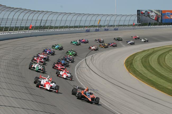

    The Tuning Centre allows you to define the minimum and maximum values of a given game output (e.g. pitch) that will result in 100% output of your simulator axis.
    Let's say the maximum tilt of your simulator is ±13°.
    If you drive a banked turn, the pitch value actually could reach 45°.
    Chicagoland_Speedway_ow.jpg Wikipedia)
    However during normal game play a typical value might be ±8°.
    Therefore if you enter in MAX MIN ±45 the full deflection of your sim (±13°) will be reached in this banked turn only but during normal game play there will be only very little movement.
    Consequently you enter 10 into Max Min and the movement will be about right when on a "normal" track. Of course there will be no additional movement, if your car is tilted more than 10°.
