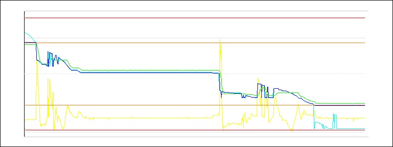

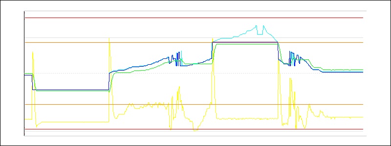

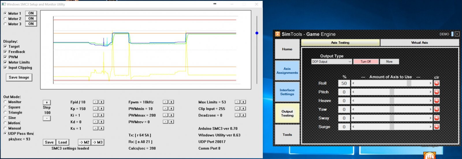

    Hey guys,
    Skipping the introduction, I'm trying to setup a 2DOF arduino sim here in Ukraine.

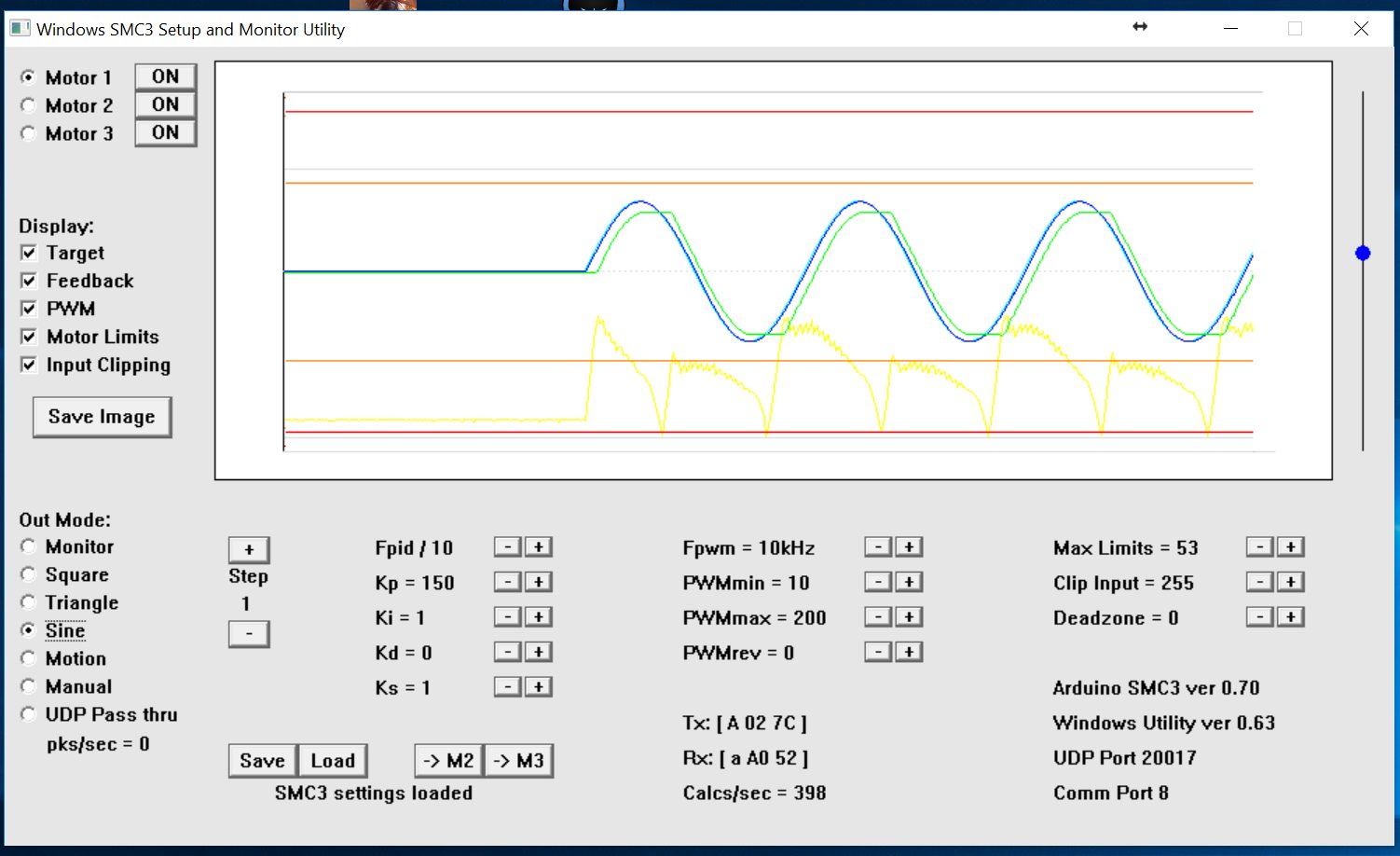

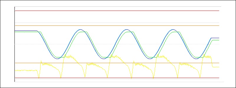

    The problem is: in SMC3 it works perfectly. All the tests for both motors are passing and I'm getting perfect sin on it.

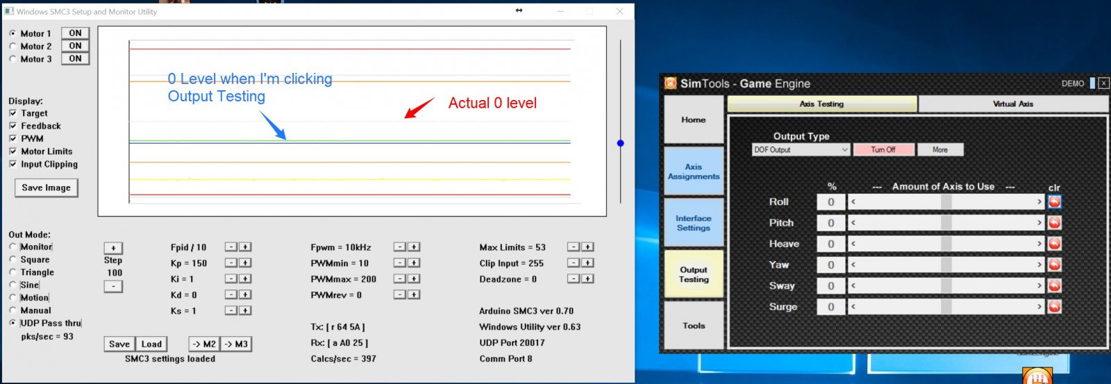

    When I'm trying SimTools Output Testing (and Live for Speed as well) I'm getting extremely strange behavior from the sim. See pic 2 and 3. Basically, with the shift change it tries to make me hit the steering wheel with my head..
    Within the Output Testing I've tried to move slider all the way to the right and then to the left as smooth as possible.
    Any advise will be appreciated.
    Thanks in advance!
    Sergey.

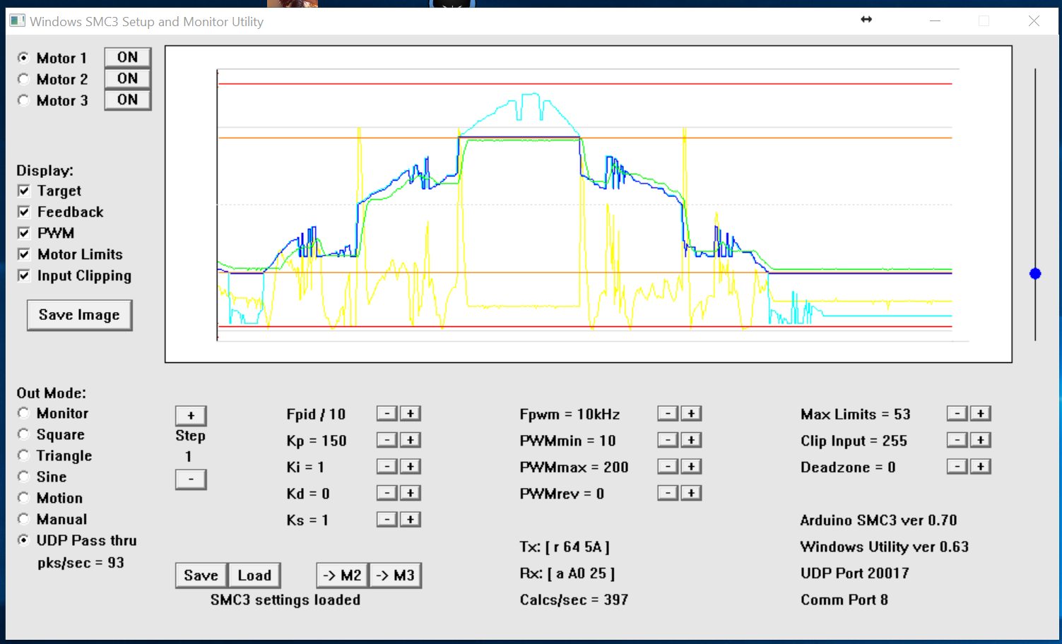

    SMC setup to pass the data it's getting from SimTools to the sim so I can see what is actually being sent there. Without SMC it acts exactly the same way but I just don't have graphs :)
    Any clues?

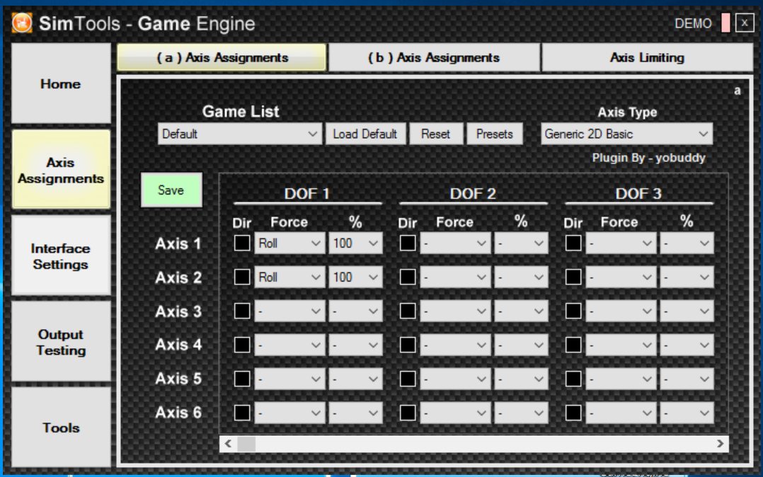

    Please post clear pictures of all your SMC3 and SimTools settings.

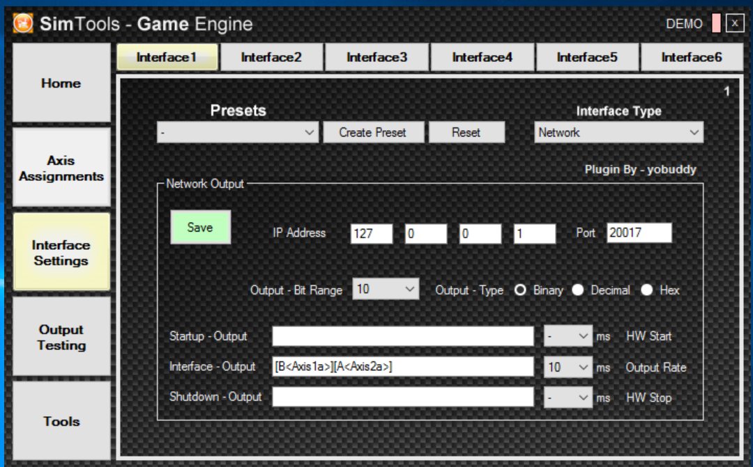

    Not sure what you mean by "clear" but here they are. Let me know if you need more info.
    Also, is there any debug mode in SimTools?
  7. nihkiruks
    nihkiruks New Member Gold Contributor
    Jan 2, 2017
    11
    Ukraine
    239Coins

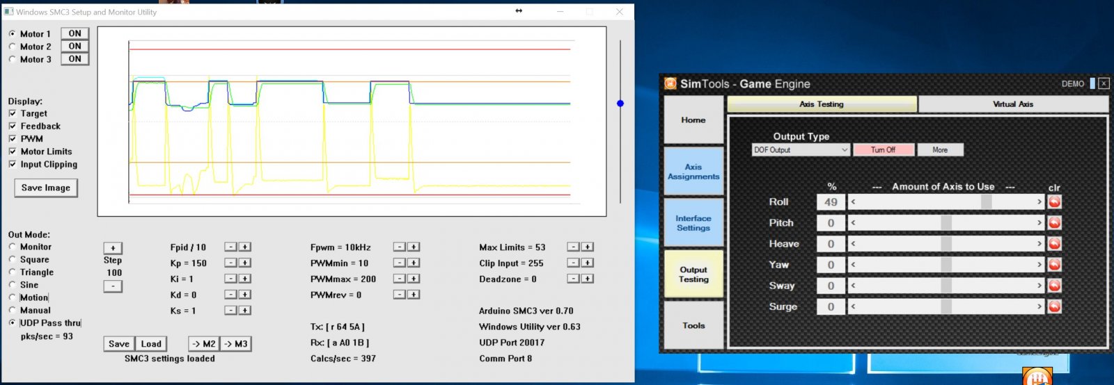

    And two more pics where you can see the difference between 49% and 50% roll.
  8. nihkiruks
    Jan 2, 2017
    11
    Ukraine
    239Coins
    And the 0 level is about 50% down...

    Negative. Using SimTools 2.0 PRO. The bug is still there. I've read it was fixed so didn't paid much attention to it but when I've changed time/date format to from English (United States) to English (Europe) it got my problem fixed.
    Btw, how to report it back to developers?
