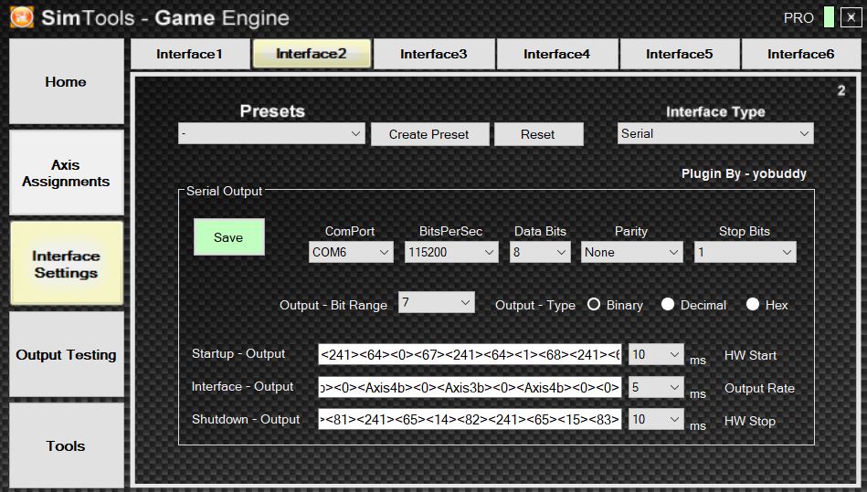

    [​IMG] I wonder if someone could give me a little help please. I've tried to set this up today but when I try to test using the b axis (as its setup) the LED on the ServoCenter board comes on but the servos don't move.
    The ServoCenter control panel allows me to move them fine and I have the correct serial port, any help would be appreciated.
    The image attached shows my settings and the output for startup, interface and shutdown are these
    <241><64><0><67><241><64><1><68><241><64><2><69><241><64><3><70><241><64><4><71><241><64><5><72><241><64><6><73><241><64><7><74><241><64><8><75><241><64><9><76><241><64><10><77><241><64><11><78><241><64><12><79><241><64><13><80><241><64><14><81><241><64><15><82><241><22><63><122><63><122><63><122><63><122><64><5><63><122><64><5><63><122><63><122><63><122><63><122><63><122><64><5><63><122><64><63><122><0>
    <241><22><Axis1b><0><Axis2b><0><Axis1b><0><Axis2b><0><Axis3b><0><Axis4b><0><Axis3b><0><Axis4b><0><Axis1b><0><Axis2b><0><Axis1b><0><Axis2b><0><Axis3b><0><Axis4b><0><Axis3b><0><Axis4b><0><0>
    <241><65><0><68><241><65><1><69><241><65><2><70><241><65><3><71><241><65><4><72><241><65><5><73><241><65><6><74><241><65><7><75><241><65><8><76><241><65><9><77><241><65><10><78><241><65><11><79><241><65><12><80><241><65><13><81><241><65><14><82><241><65><15><83>
    Fred
