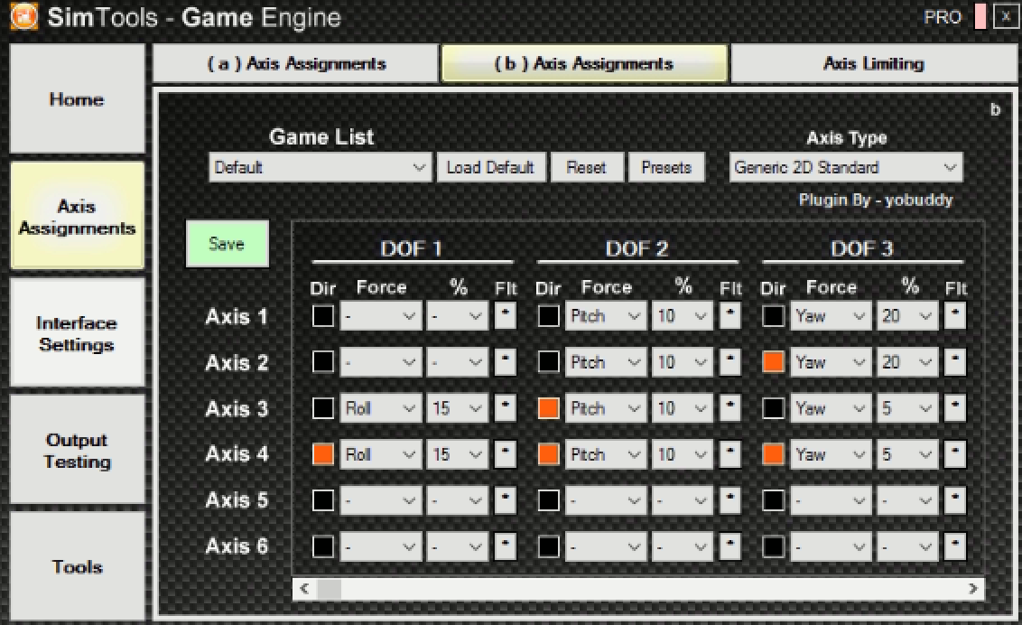

    I've attached a screenshot of my Axis Assignments - am I entering the wrong commands?
  17. darkcrayon
    darkcrayon Member
    Jun 27, 2015
    79
    New York, NY
    305Coins
    +34 / 1 / -0
    3DOF, SCN5, 6DOF
    Hmm ok, I think there's a problem with your Axis assignments, thought im not exactly sure why you'd get NO motion.. Unless LiveForSpeed doesn't output sway and surge and only does the basic 3 (pitch, yaw, roll).
    In any case, you're going to want each DOF column to only have 1 type of force. Or at least that's how mine is set up. The Axis column is "flaps" on the GS-4, and the DOF column is for each type of actual movement. See my screenshots for how mine is setup. Note that this is for a flight game (Elite Dangerous) and not a driving game but it should be similar. It's up to you of course to decide which flaps should move for which type of motion.
    See if that helps. Screen Shot 2017-03-07 at 6.41.51 PM.png Screen Shot 2017-03-07 at 6.41.31 PM.png
