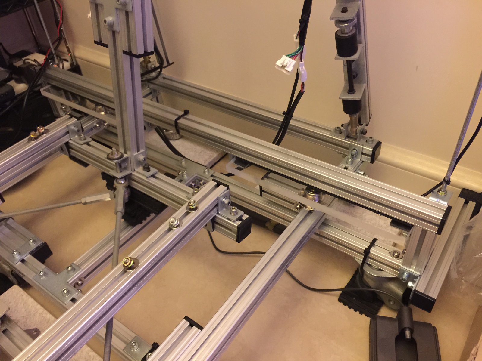

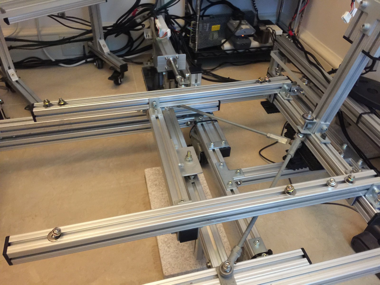

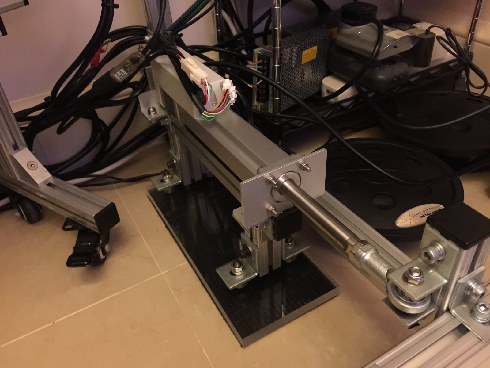

    I am about to finish my conversion of Frex 2Dof to 2Dof + traction loss running Simtools & addition of bass transducers running SimVIBE. Appended are some photos for the WIP:
    SCN5 150mm actuator for TL
    Front pivot for TL
    Ball wheels for TL frame
    Seat base frame on TL frame
    Pedals & Steering Wheel
    Will upload more photos in coming days after installing seat & the bass transducers. Comments are welcomed. Thanks!

    Hi, they are running with Simtools already. I took a video for the testing of the initialization in Simtools

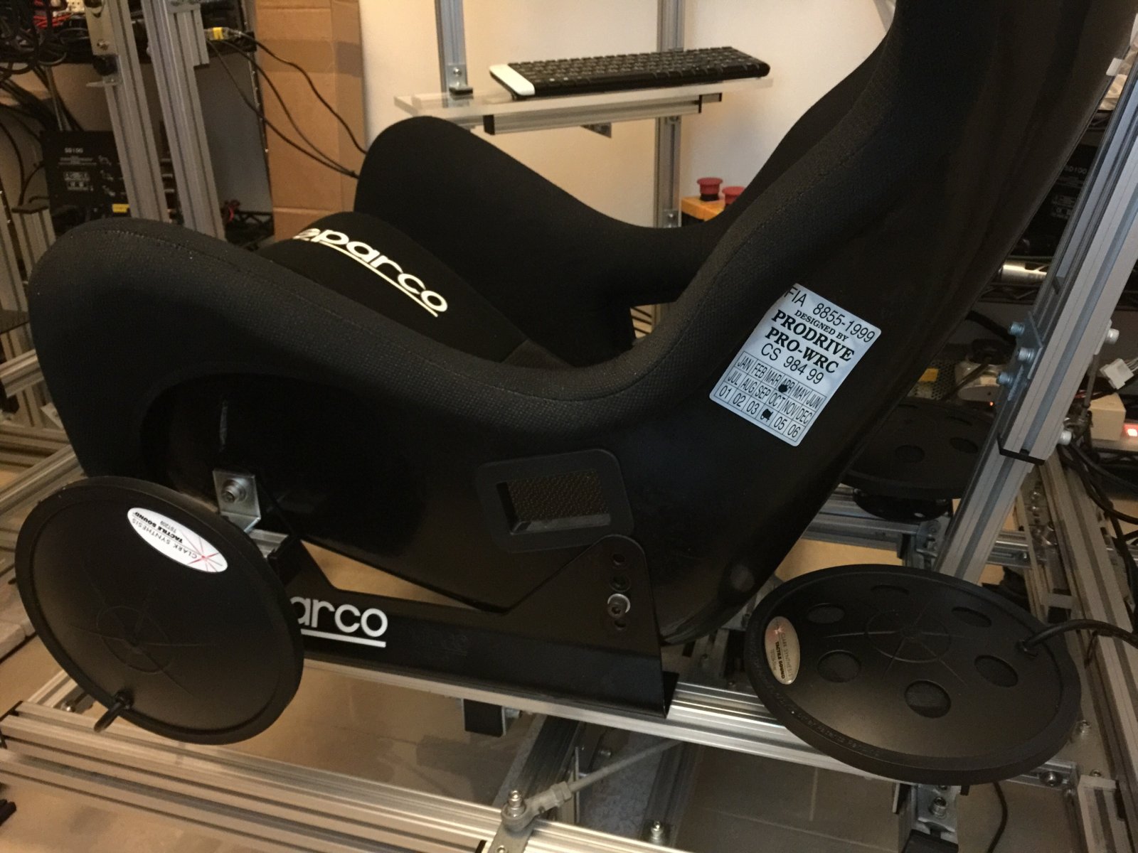

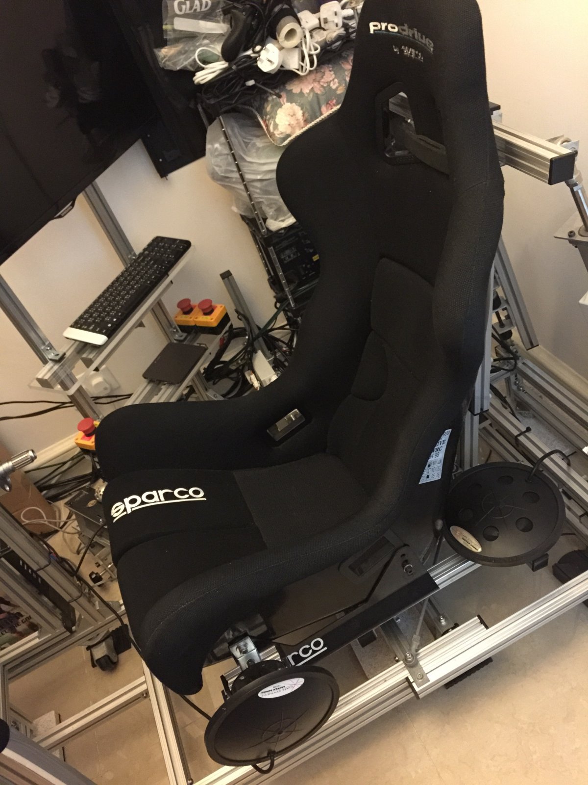

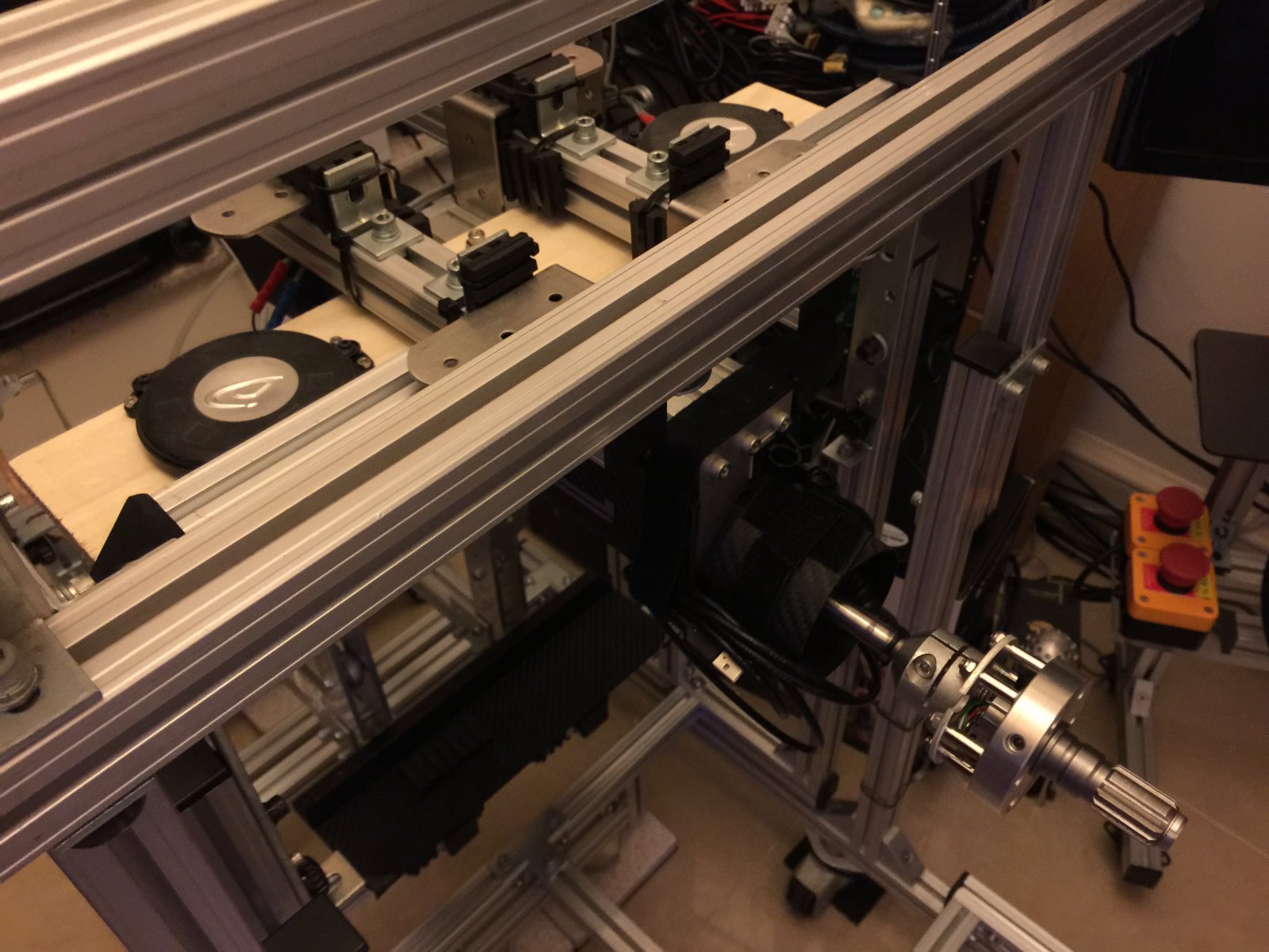

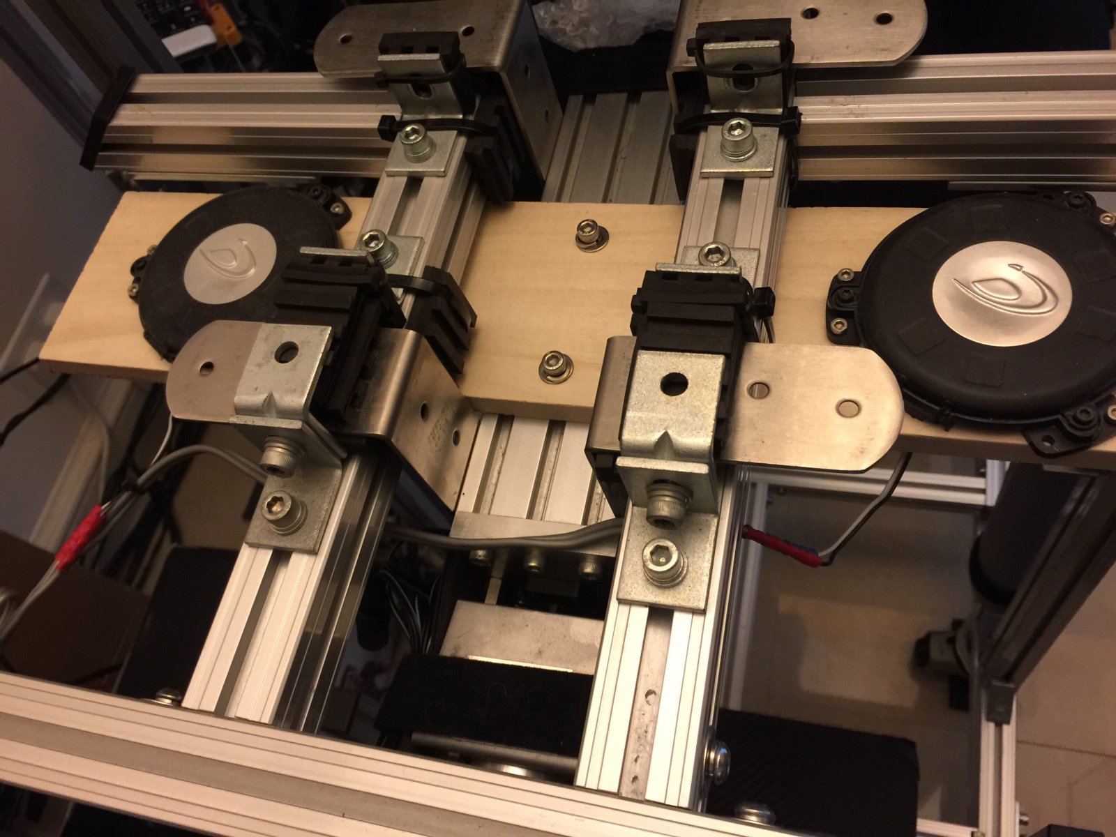

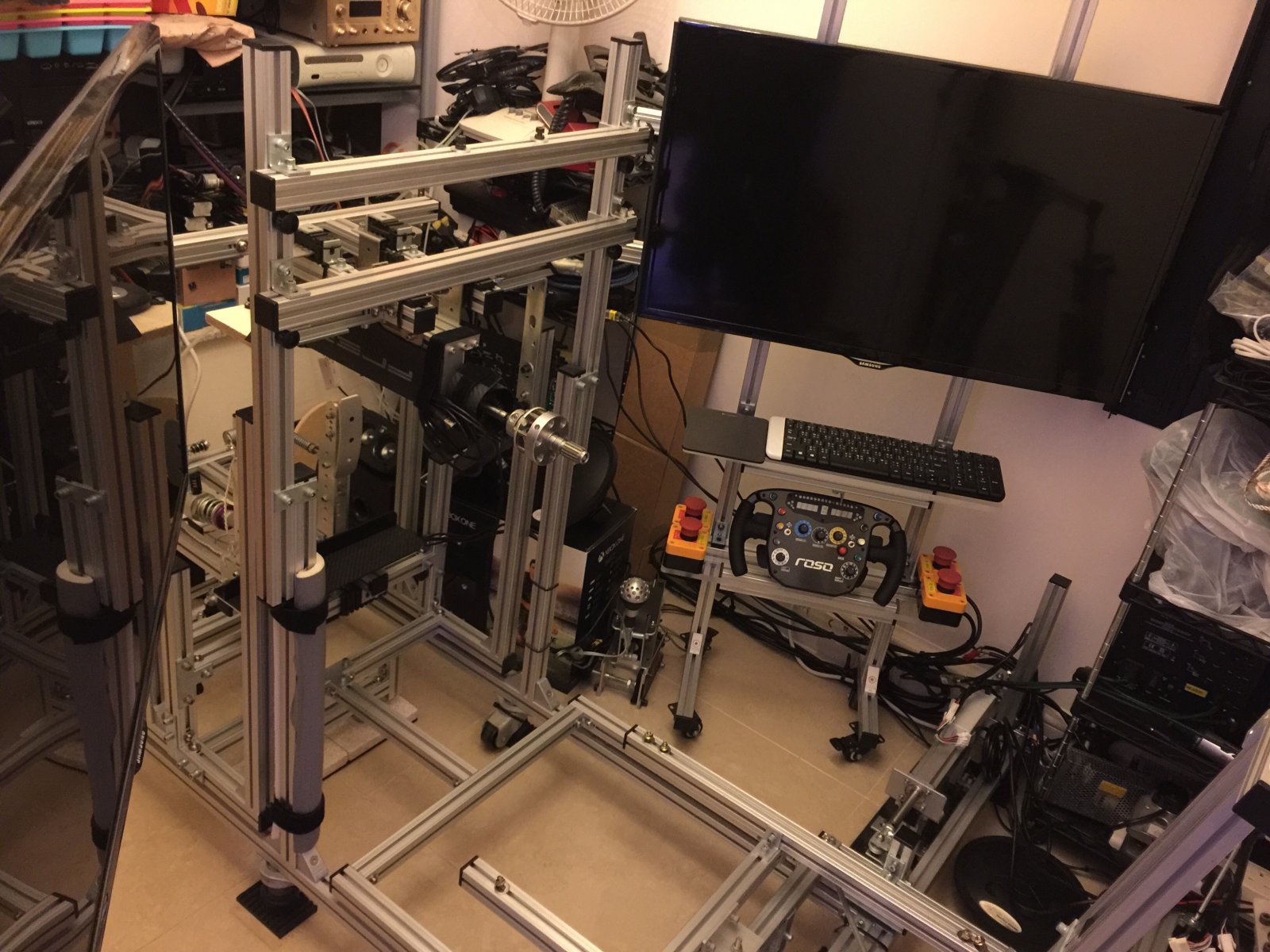

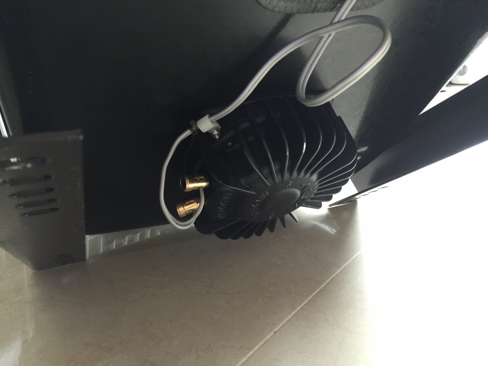

    Just installed the seat and the tactile transducers.
    One installed under seat
    Four more for vibrations from four corners

    I am using two Clark Synthesis TST209 and two TST239, for the amplifier I use four Yung 100W class D plate amplifier.
    http://www.parts-express.com/clark-synthesis-tst209-tactile-transducer-bass-shaker--300-861
    http://www.parts-express.com/clark-synthesis-tst239-silver-tactile-transducer-bass-shaker--300-863
    http://www.parts-express.com/yung-s...ofer-plate-amplifier-module-no-boost--301-500
    For the shaker under seat I use Aurasound AST-2B-4. I also have shakers to be installed under the pedals and steering wheel.

    Shakers installed under pedal on steering wheel

    Hi! Yes, that's all. I run SimVIBE Chassis mode using the four Clark Synthesis transducers and run SimVIBE Extension mode using the others.

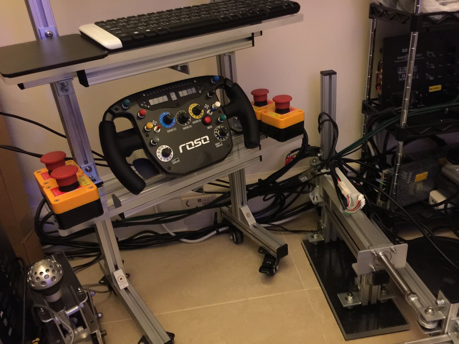

    I like your pedals! :cool:

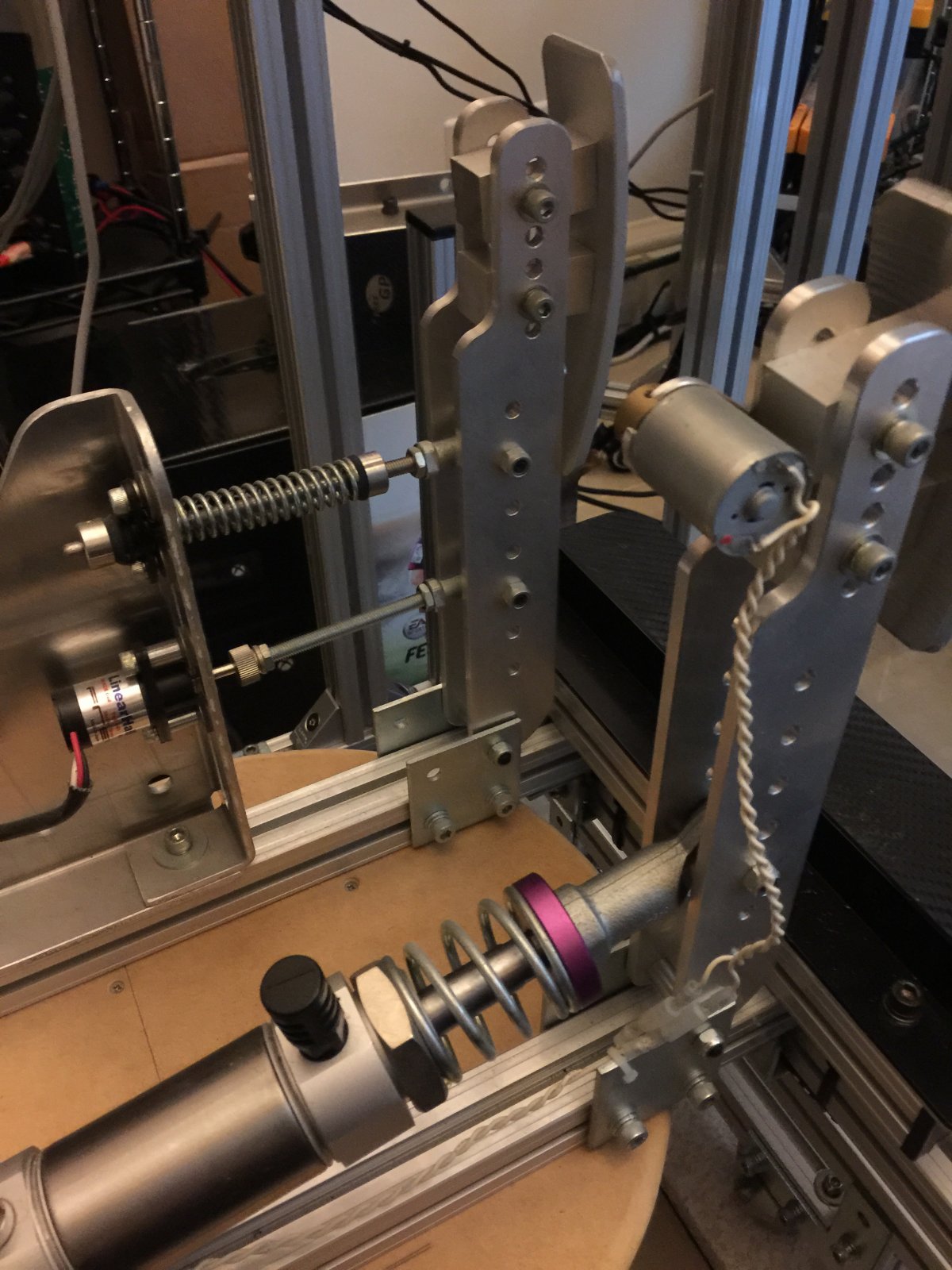

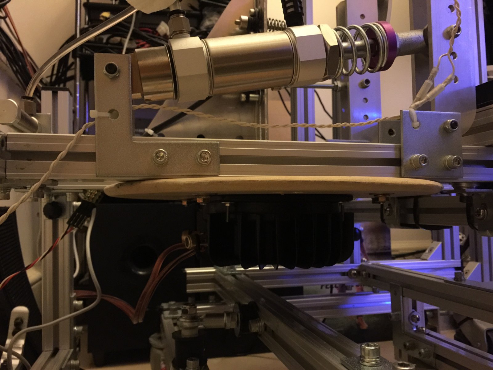

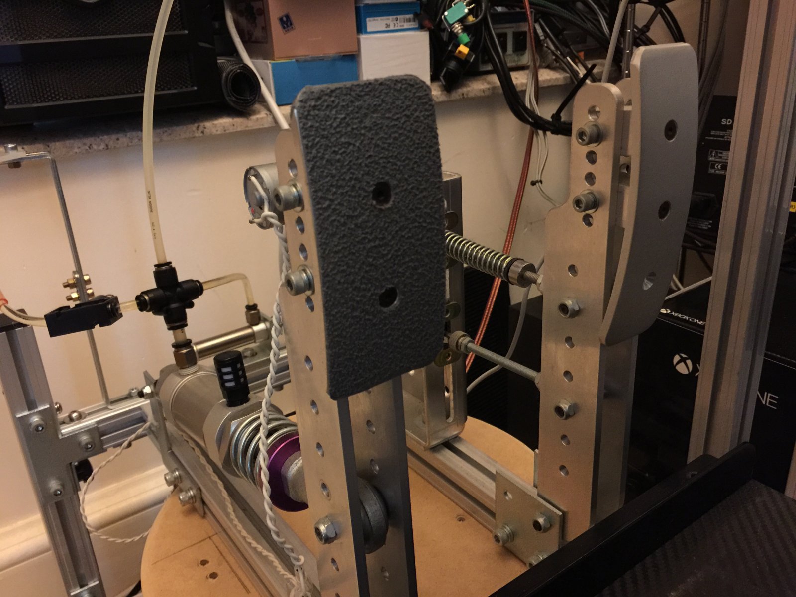

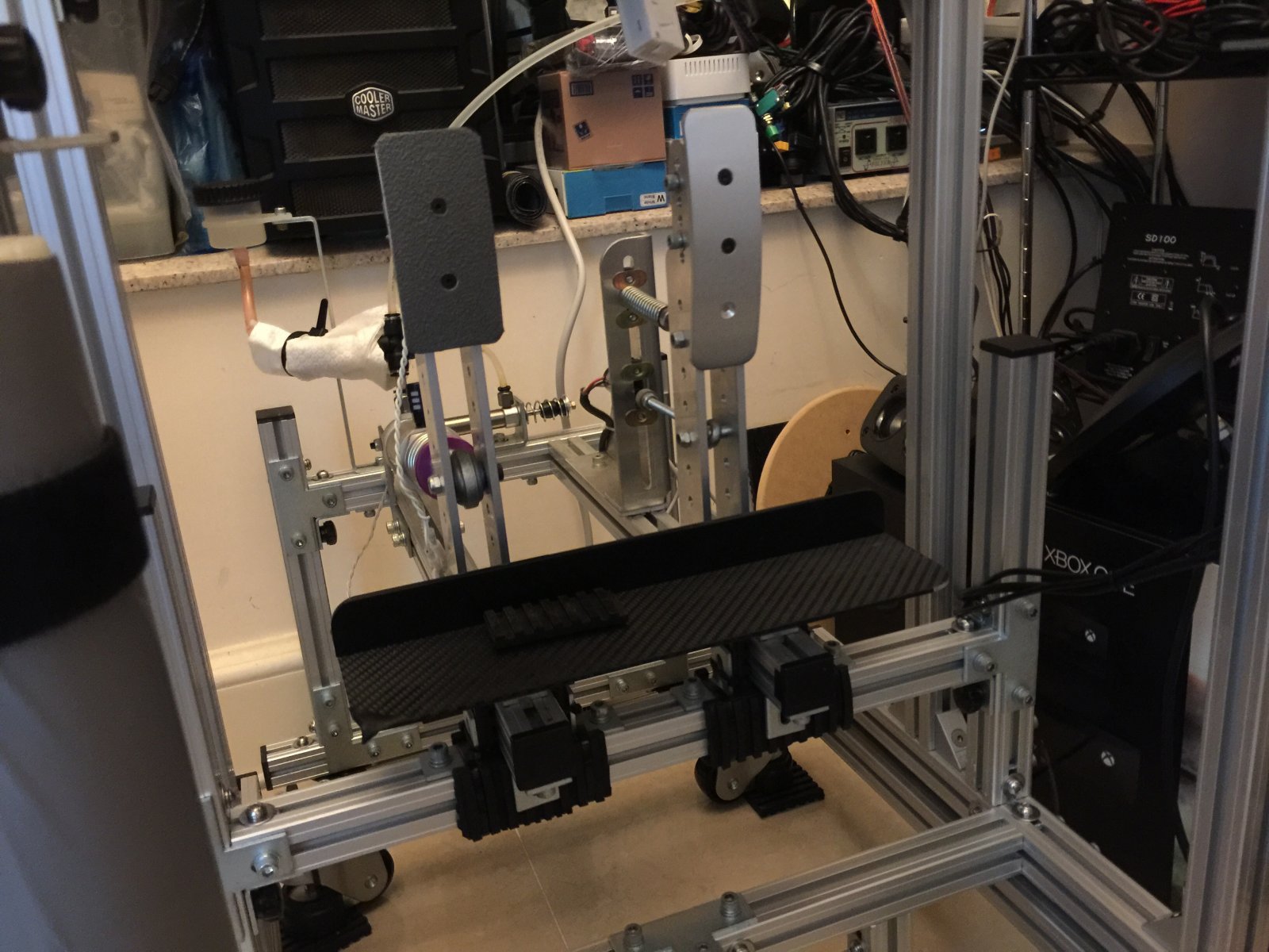

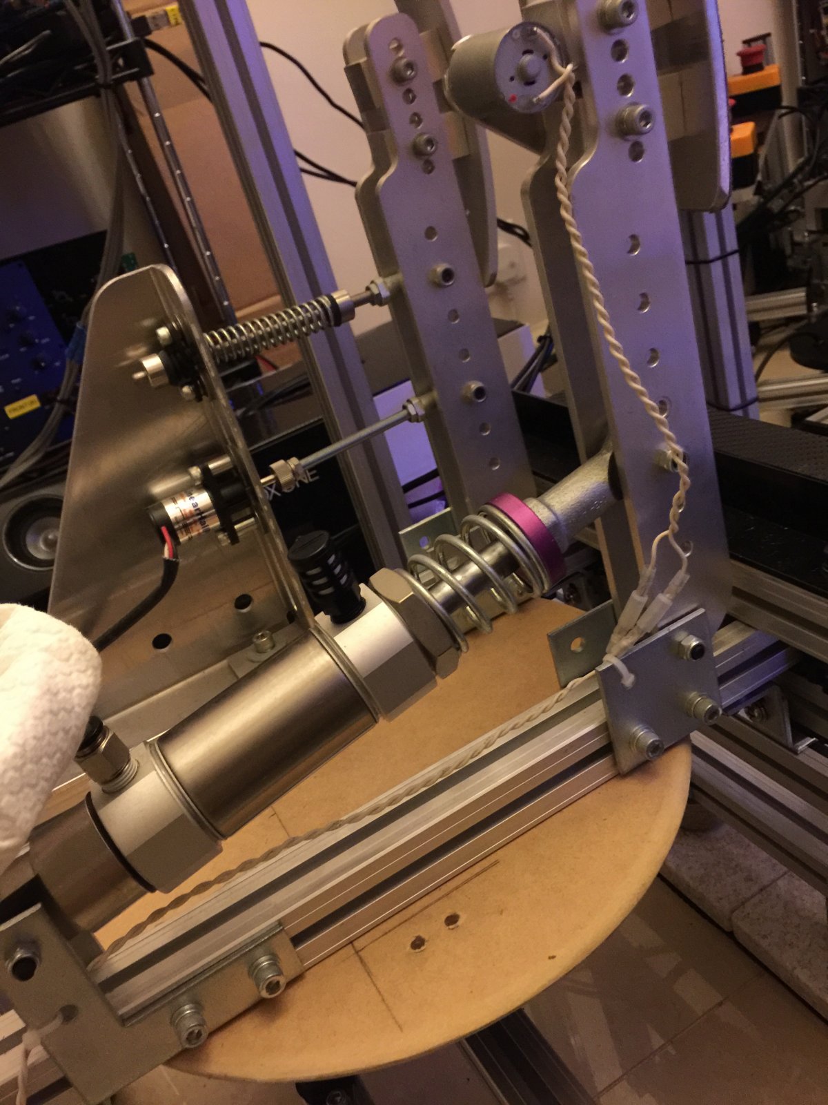

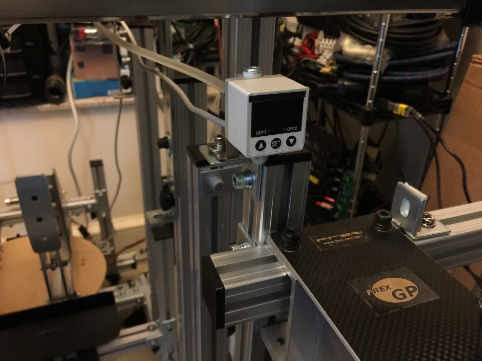

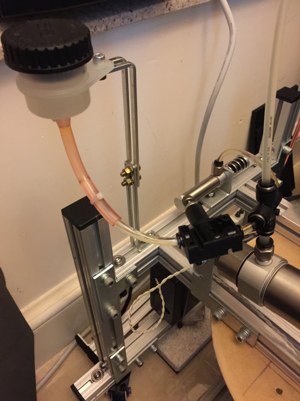

    Did you build them by yourself?
    Where is your brake sensor? Can we have more details ans pictures?
    I'm curious about the vibration motor: do you manage it with SimCommander?

    Hi, I bought the pedals from FREX a couple of years ago. It comes with a pressure sensor. From this sensor a threshold pressure can be set above which the brake rotor will turn on.
    Some photos are as follows
    I will upload some more photos/video after u hook up all the connections.

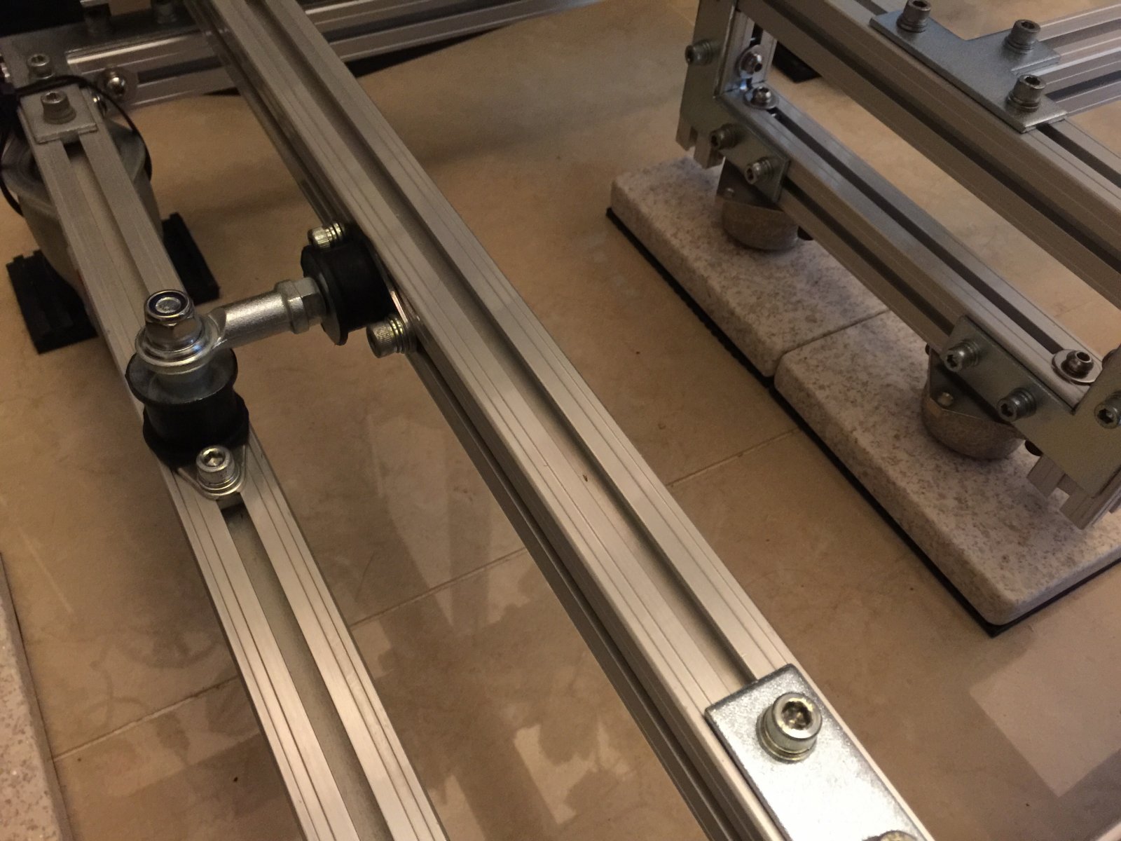

    Hi, I have the four big transducers generating suspension and collision, road surface condition effects while the shakers under the pedals, steering wheel and seat for car engine effect and some others.

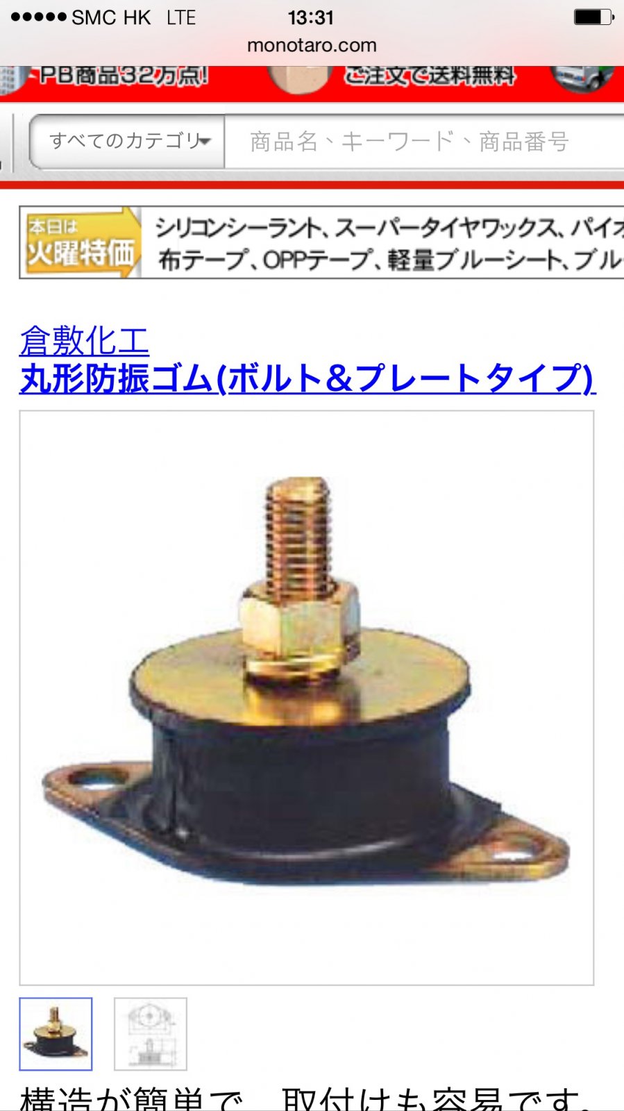

    The pedals and steering wheel are not bolting to the main cockpit frame directly but via some neoprene rubber for 'vibration' isolation.

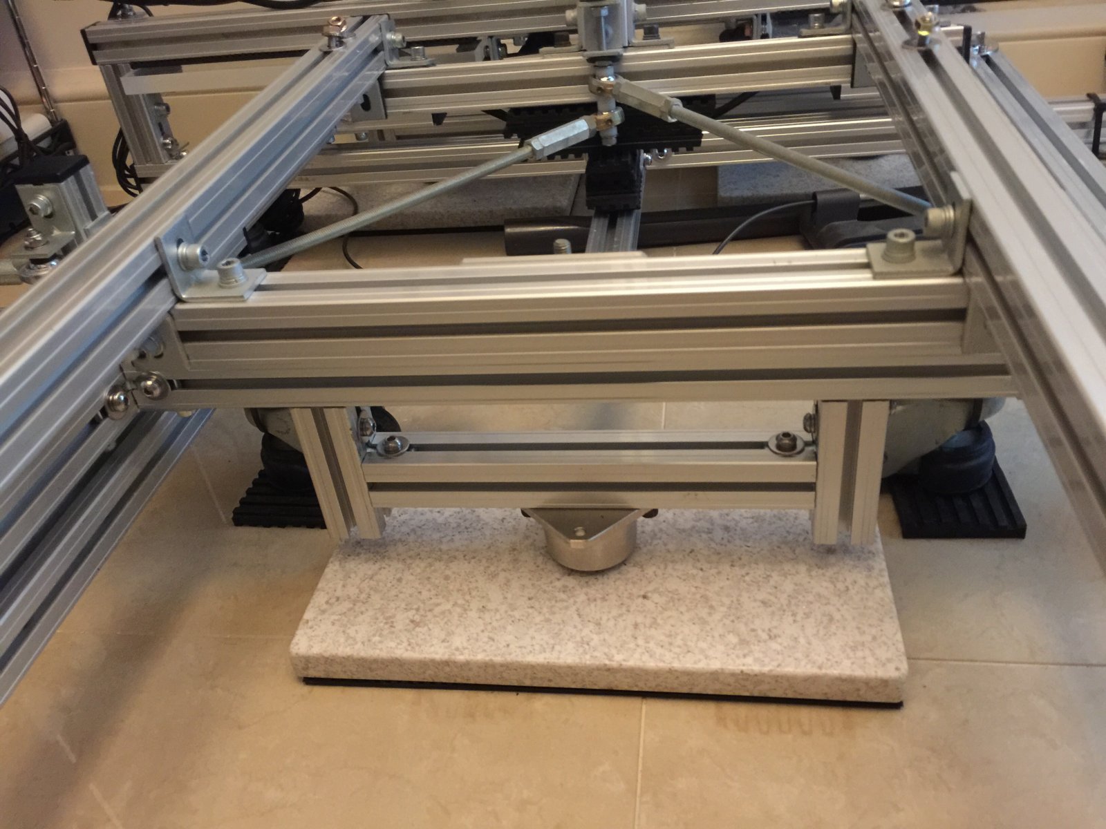

    For the four big transducers I mount them to the four 'corners' of the seat rather than the to the four corners of the whole cockpit. For the latter which I tested before I found I could not distinguish where the vibration comes from because the seat is connected to the base frame via a single pivot which is this part:
    Also, seems the low frequency signals do not transmit through aluminum very well. For my current mounting scheme I can feel the directions of the forces.
