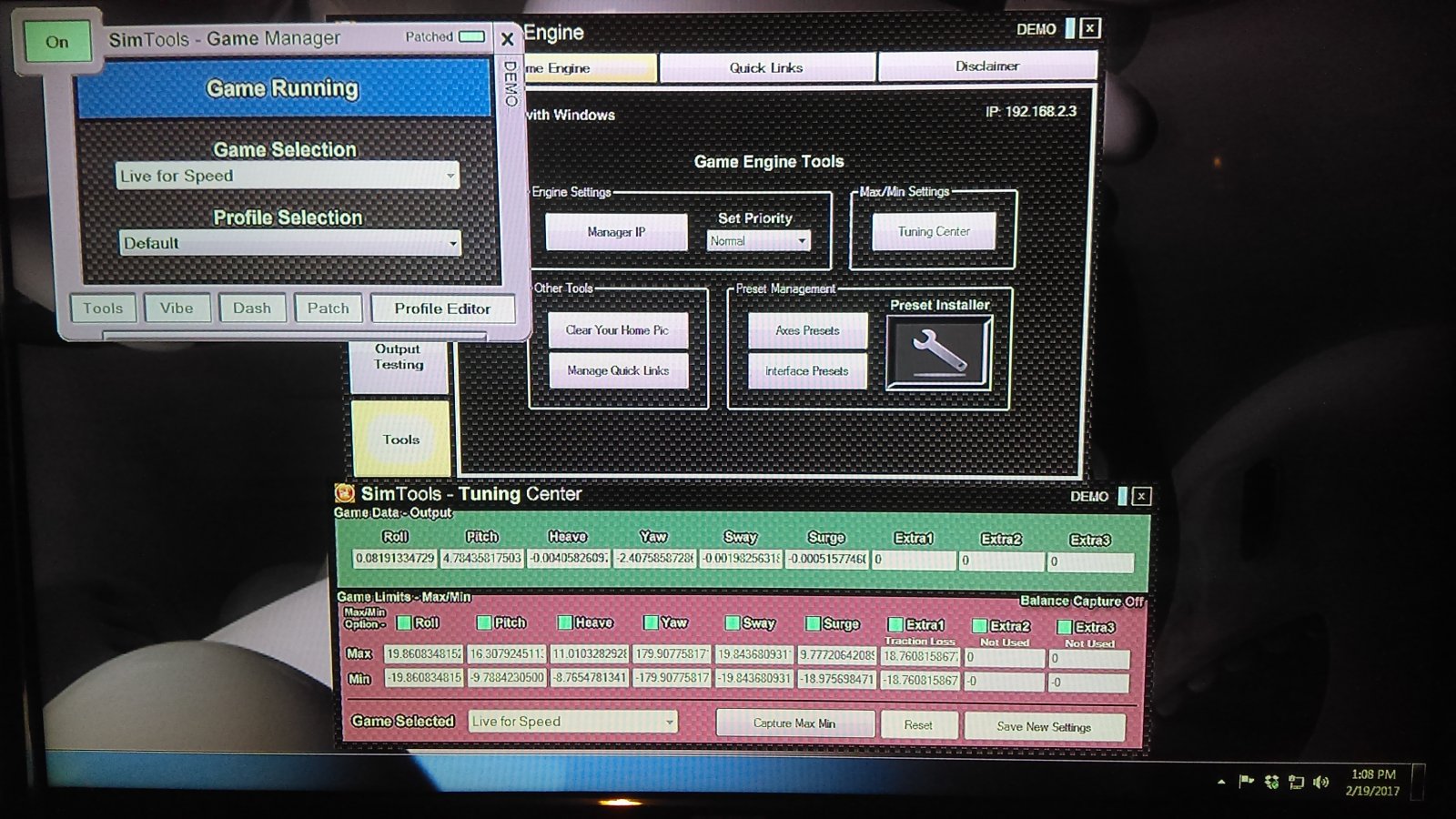

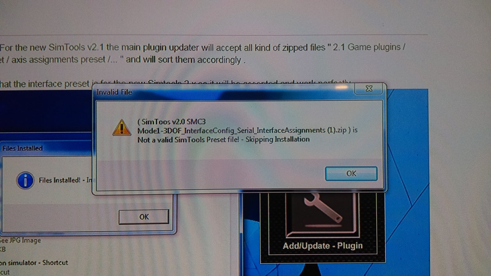

    Cheers mate i started from scratch reinstalled lfs and simtools 2.1.....my screen looks diffrent to yours here are some pics im still having the same problem.... getting this 3 dof going has been a battle the whole way im so close but so far lolololol thanks heaps for your help
    the game output is working but i think im missing the perset thats why theres no moment on my rig?????

    Your still in demo mode buddy.
    Only 'Live for Speed' will be recognized as a valid game plugin until you license the software.

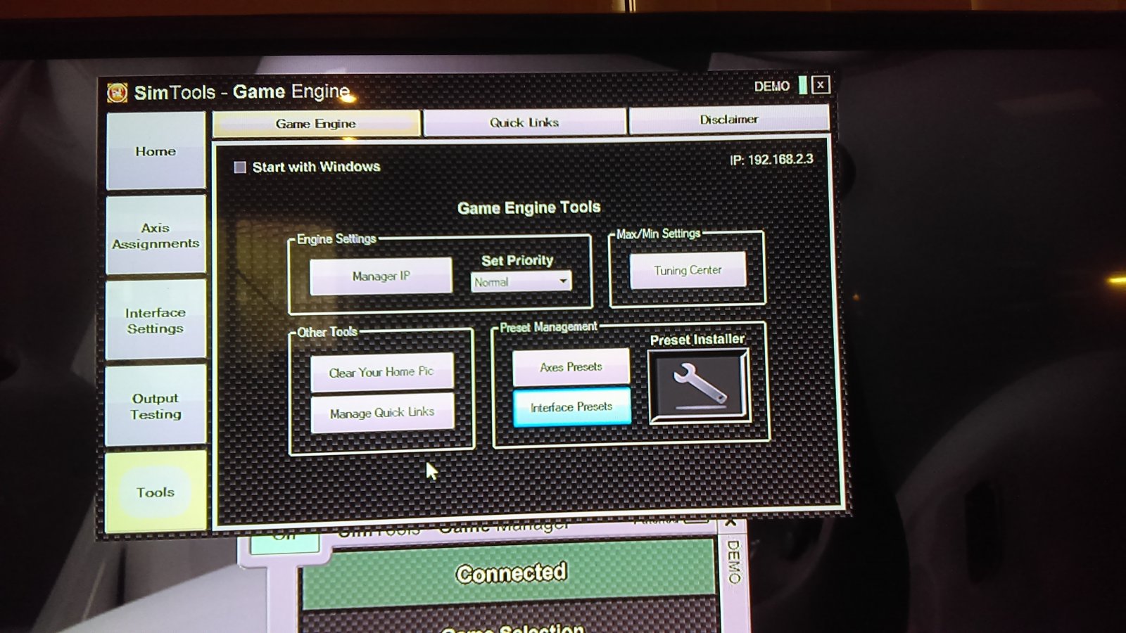

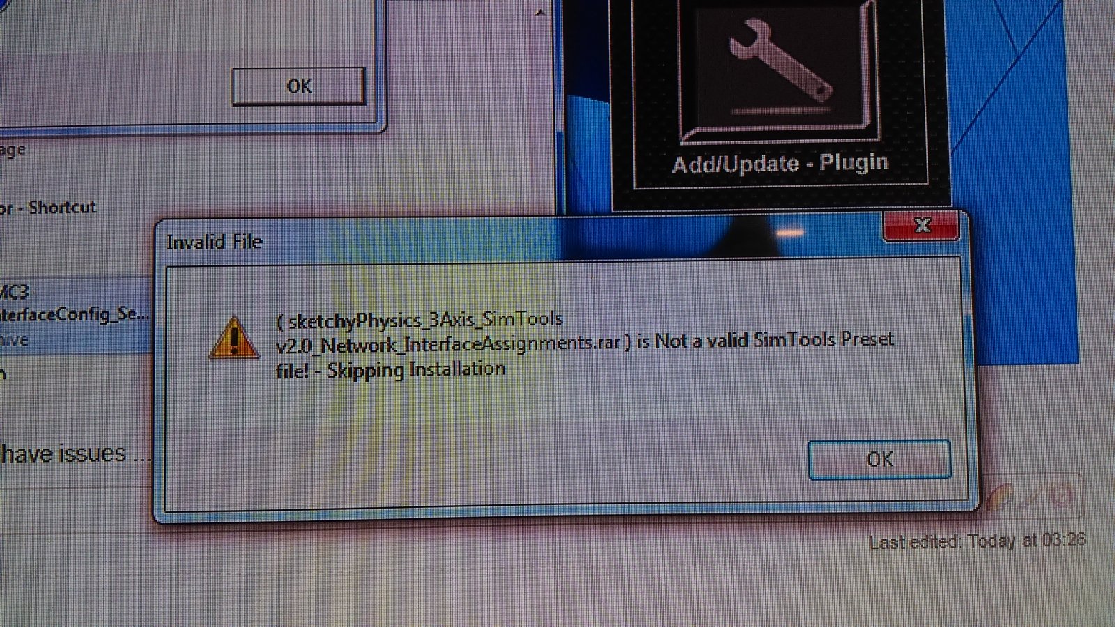

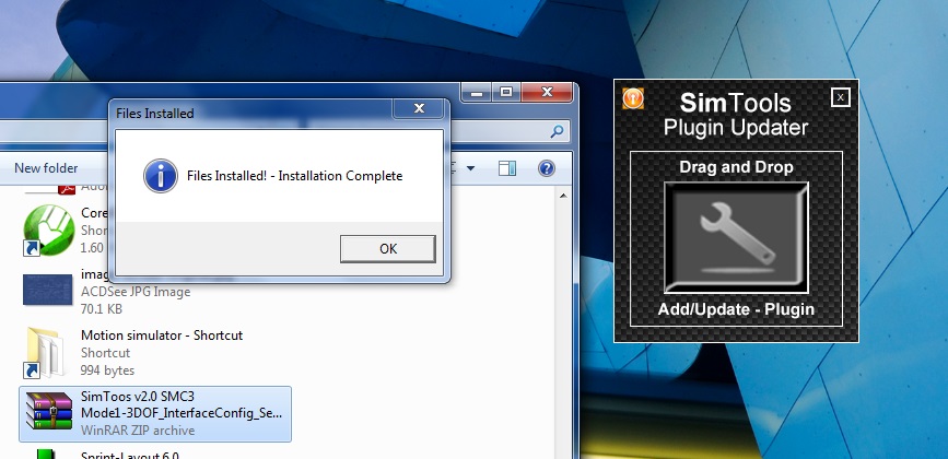

    yes im still in demo mode..i found the right simtools installer to so my screen looks the same now.. im only use lfs am i using the wrong download or something ???? i installed the the perset and it said install was complete...
    still movment tho... when you patch the game do you just do it to the LFS file or do you need to chose one of the files in the LFS file??maybe ive gone wrong there...the game said it patched
    also ive just looked for a lfs perset file and its been deleted i couldnt find one
    Everything is working on screen just nothing off screen lol

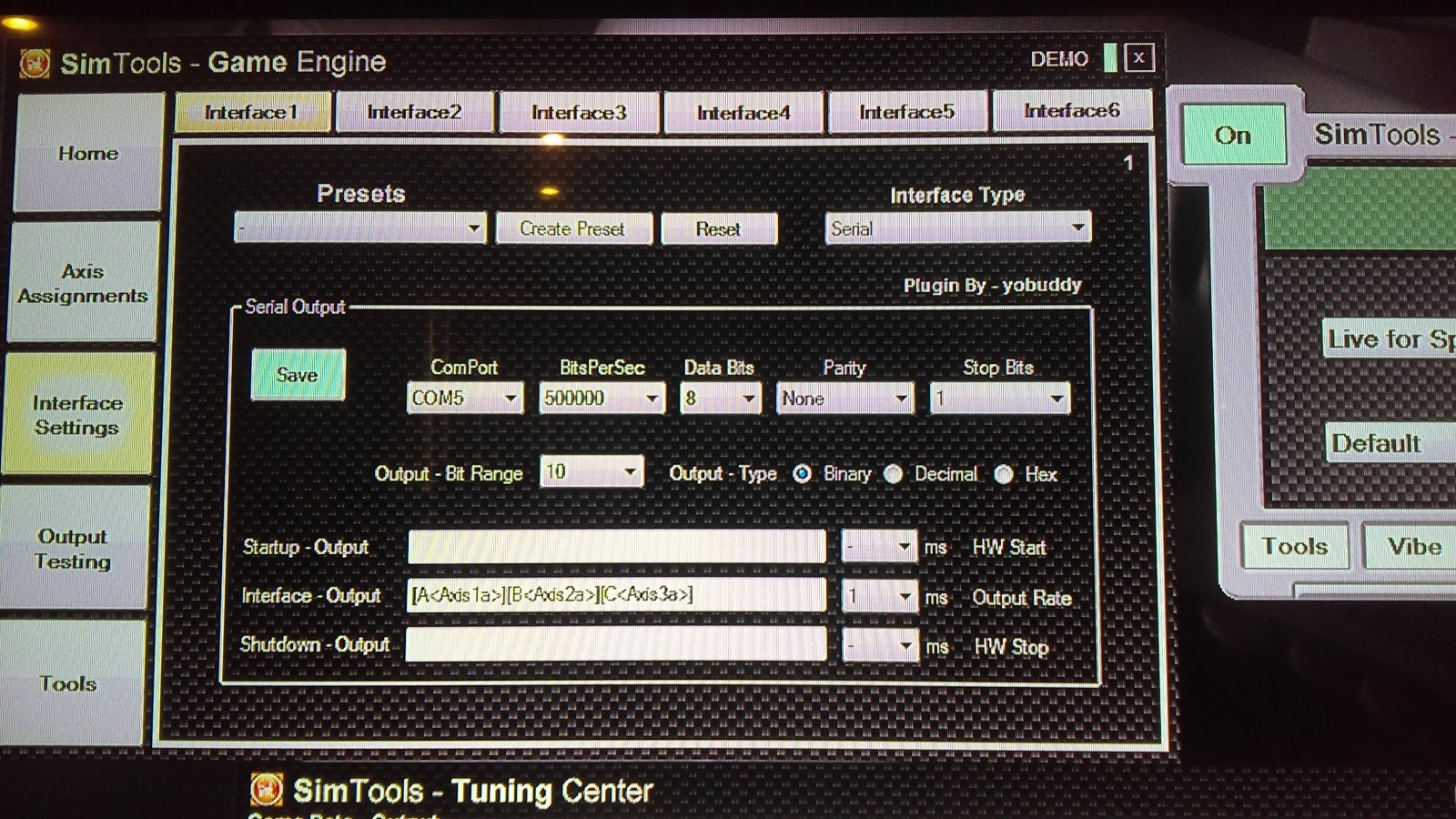

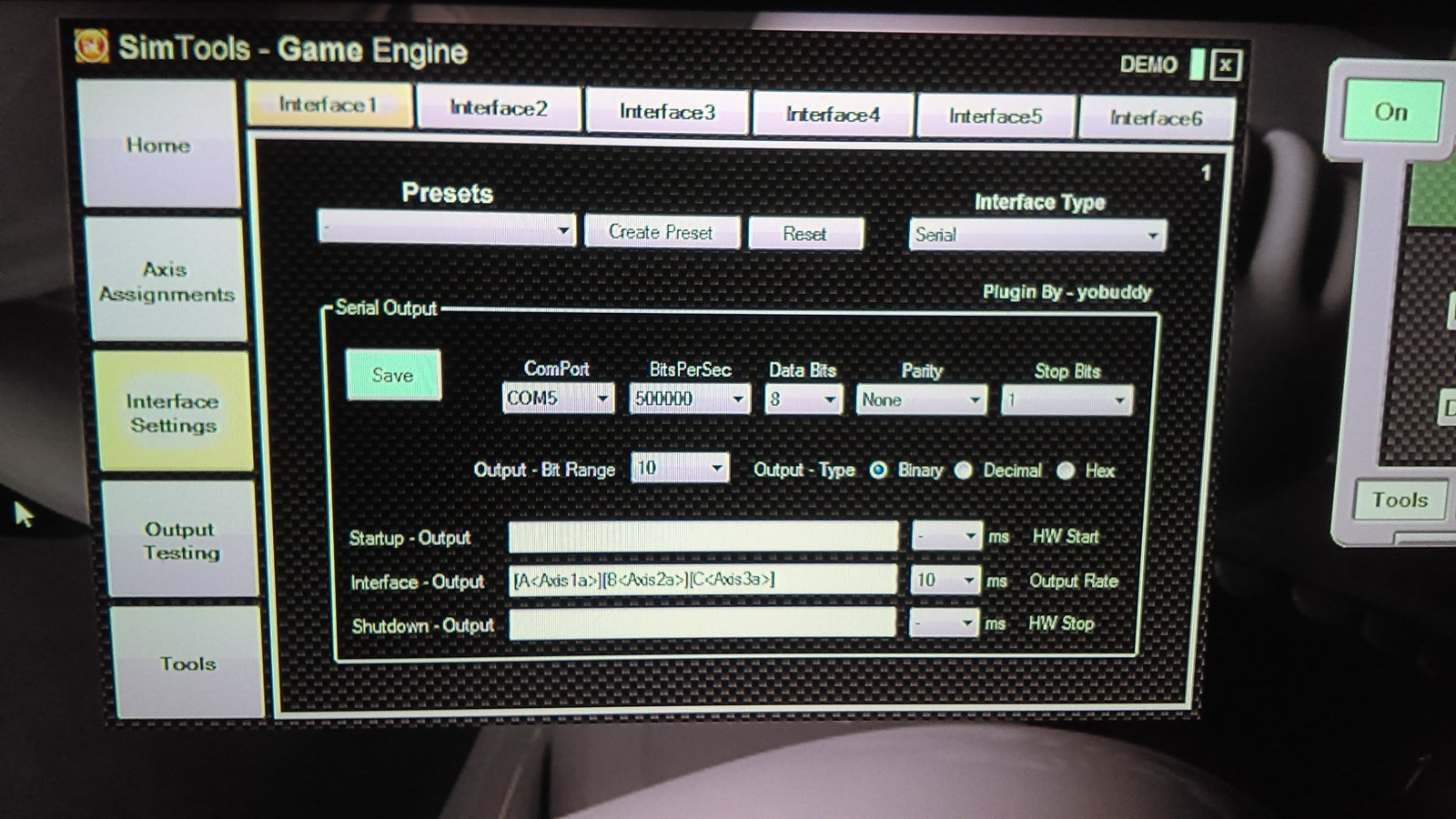

    if your interface is in the "a" tab ... you don't have an "a" in the line of the output in game engine ??
  5. Evan Rowlands
    Evan Rowlands EMR Industries
    Jan 22, 2017
    190
    business owner/ EMR industries
    Melbourne Australia
    - 82Coins
    +33 / 0 / -0
    sorry mate what an A tab ? are you talking about the a after the Axis1? [A<Axis1a>]?

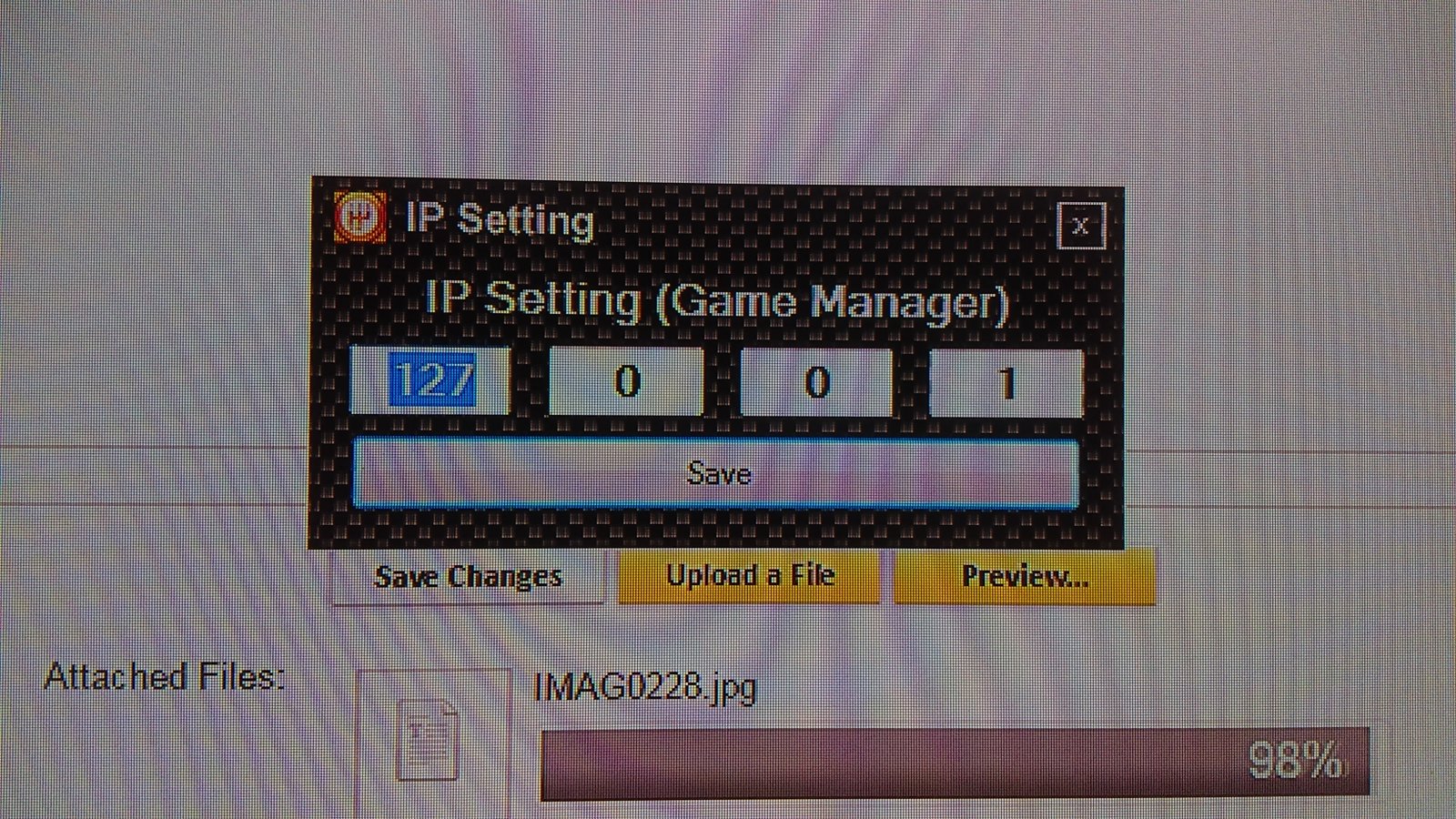

    what is the Engine settings for the ip manager do you just leave it as 127 0 0 1 or do i put my ip address from the game engine screen ?? same with the game the game manager ip address? do i also need to change that one
    cheers guys and thank you for all your help
    cheers mate ive done everything you said and it said it installed and was complete...but when i go to run it everything on screen is going but no motion at the rig apart from the shakes it does when u first power it on
    here is what i have

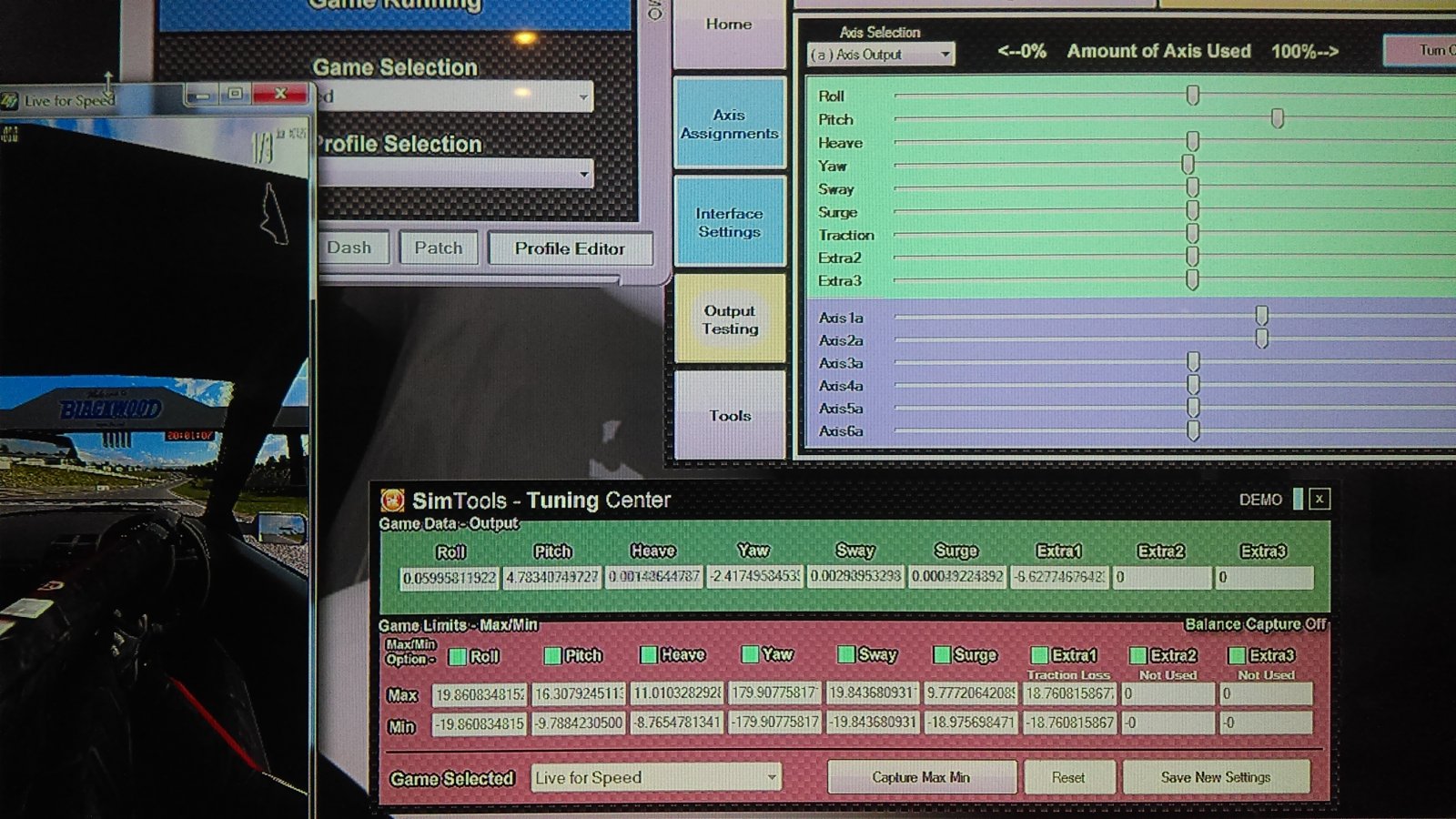

    when i open LFS and enter single player there is no movment..But in the sim tools engine manager the virtual axises are moving.. same as in the sim tools turnning centre the game data output is show numbers as soon as the car is on screen..but no movment at the platform..i really have tried here guys but im really stuck..should the ip from the game manager be 127 0 0 1 or my own ip address the game engine asks the same thing..when i use the SMC3 utilty i have full motion on both motors no worrys..

    Did you install SimTools on a single PC?
    If so, the ip address for both apps don't need to be changed.
    You can leave then at "127 0 0 1" or put them back to this number.

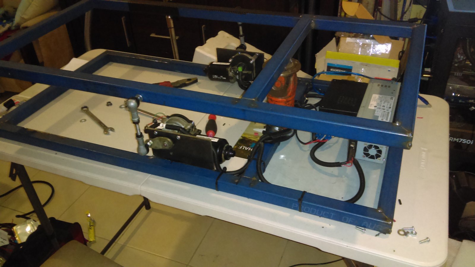

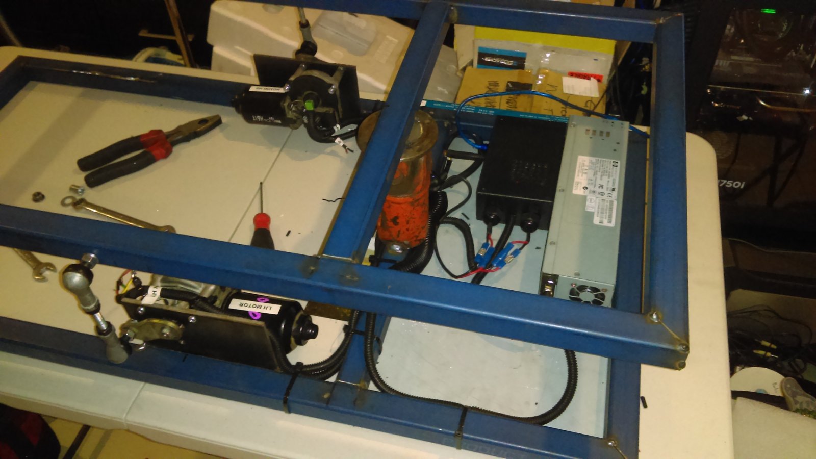

    Let me see a pic of your sim please.
  14. Evan Rowlands
    Jan 22, 2017
    190
    Melbourne Australia
    - 82Coins
    +33 / 0 / -0
    here you go mate

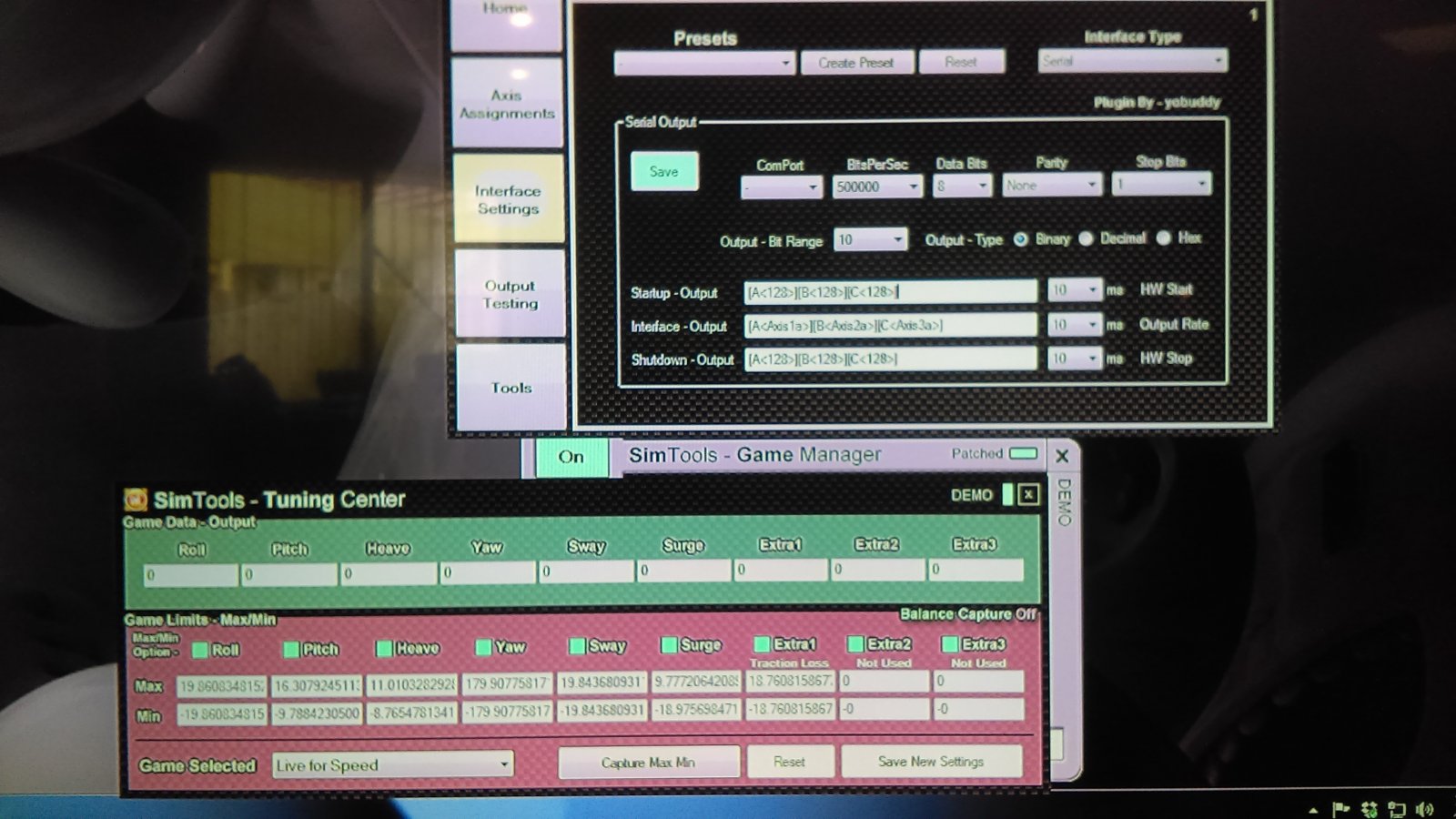

  15. Pit
    3,007
    30,512Coins
    +3,098 / 31 / -0
    BTW your output rate is way too low (1ms), should be 10ms.
    (look at the interface settings)

    - 82Coins
    +33 / 0 / -0
    its what i was told this morning but ive since worked out it was to low

    Ive opened my control box and i notice that the rx light is on when i open LFS but no TX any ideas id say this is the problem
