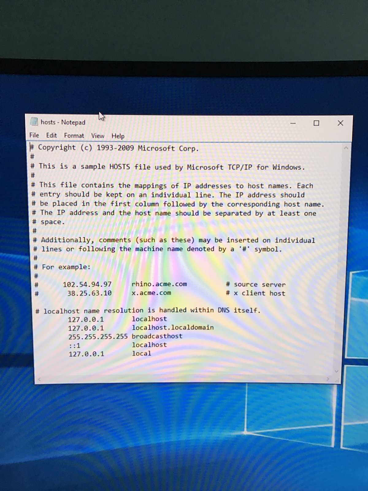

    Ok changed it, done all the same, didn't connect!
    22,129
    154,400Coins
    +11,181 / 57 / -2
    Is that with a reboot with no dongle or cat cable plugged in?
    Edit - this should still be in the file
    # localhost name resolution is handled within DNS itself.
    # 127.0.0.1 localhost
    # ::1 localhost
    And if the edited file does not work the hosts file should be restored to the original configuration.

    Hi @noorbeast #
    Yes I tried rebooting as well.
    So when edited it should look like this?
    # ::1 localhost
    127.0.0.1 localhost
    127.0.0.1 localhost.localdomain
    255.255.255.255 broadcasthost
    ::1 localhost
    127.0.0.1 local
    Thanks MWB
    22,129
    154,400Coins
    +11,181 / 57 / -2
    Yes @MWB that is how it should look, but if that is not making a difference remove the following and flush to return the file to its original state:
    127.0.0.1 localhost
    ::1 localhost
    127.0.0.1 local
    Once that is done can you right click on your network connection and go to Open Network and Sharing Center.
    Under View your active networks click on the Connections link, then Properties in the window that opens.
    Highlight Internet Protocol version 4 and hit properties, and do the same for Internet Protocol version 6. Are both set to Obtail IP and DNS server Automatically?

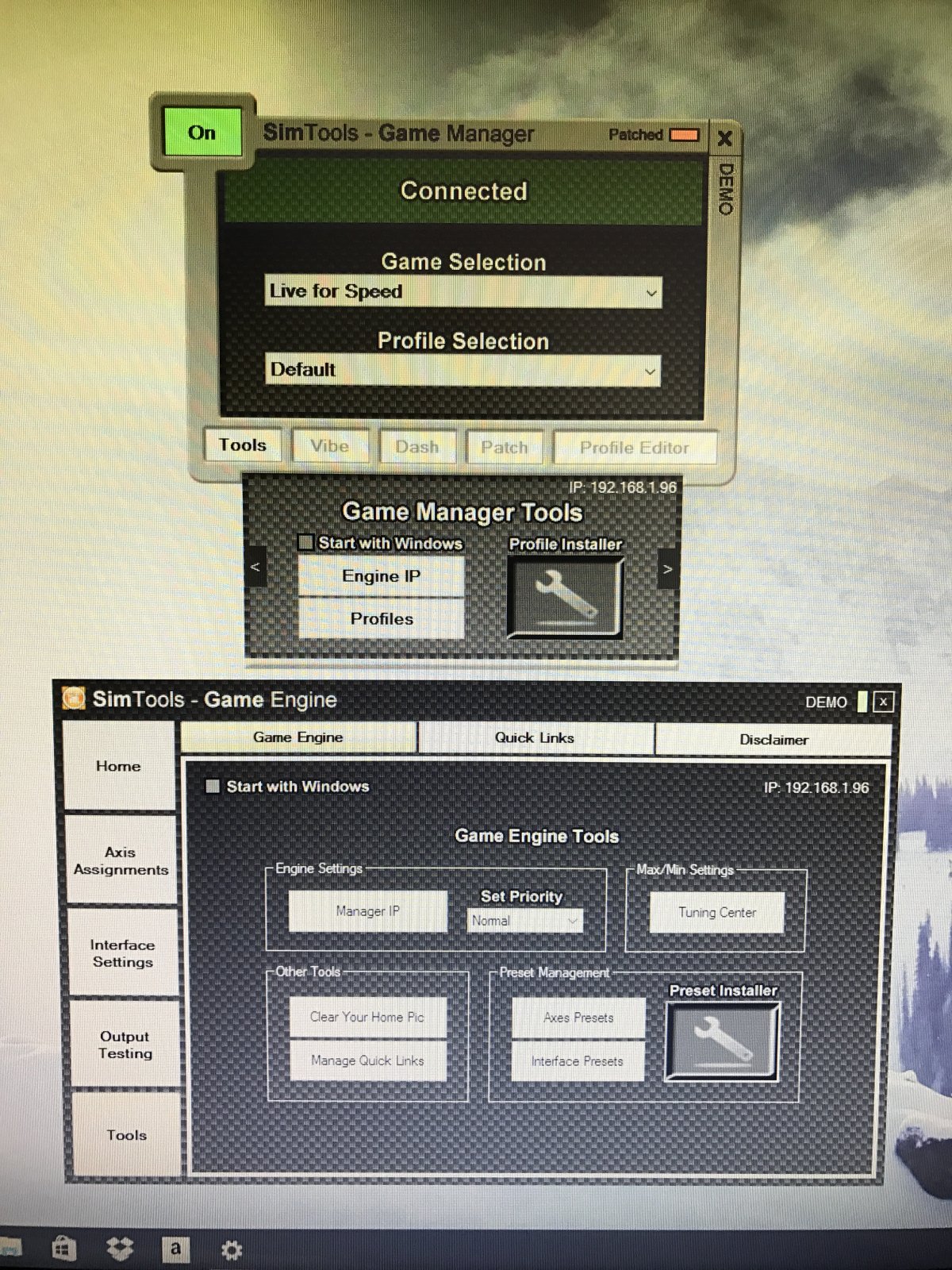

    Hi @noorbeast
    Just tried my dads PC, Windows 10 home
    Download it, installed it, didn't do any administrator stuff. And it connected first time
    :think
    Think I'm just going to rebuild my PC, my windows was an upgrade from 7 so maybe this is cocked stuff up!! :confused:
    22,129
    154,400Coins
    +11,181 / 57 / -2
    Yes it sounds like something is confusing it between being localhost and its IP address. It is the machine, not SimTools that is the issue.
  7. MWB
    MWB Drive it like you stole it!!
    Jan 2, 2016
    131
    Commissioning Engineer
    U.K.
    424Coins
    +148 / 0 / -0
    2DOF, DC motor, Arduino, Motion platform, 4DOF, 6DOF
    Yeah 100% agree that's it's no fault of Simtools, I would love to work through this and find the fault because it's good for the forum, but I want to get back to using my sim, and it shouldn't take long to rebuild! But thanks soooo much for everyone's help. I'll let you know how I get on.

    Hi All,
    I've installed Windows 10 Home 64 on a new SSD installed Simtools 2.0 and have connected Game Manager to Game Engine!!! I have no clue why it didn't work before, but thanks to all involved with your help especially!
    @bruce stephen @speedy @noorbeast @yobuddy
    Now I've just got to wait a couple of hours for my games to download through steam and I can patch a game!! Let's hope that go's a bit smoother!! :cheers

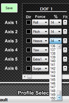

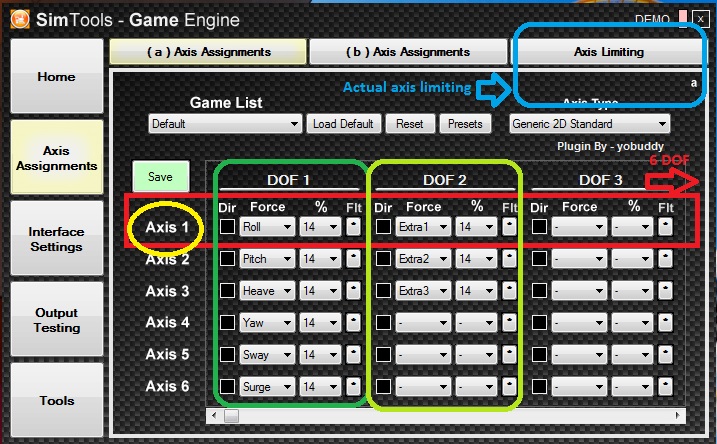

    Assigning forces to axis in SimTools ...
    - DOF 1 - DOF 2 - DOF 3 - ..... - DOF 6 are the main 6 forces "Degree Of Freedom" plus the Extra 1 ,2 ,3 forces as the game plugin provides them that could be assigned , reversed/added with different values for each Axis ...
    - Axis 1
    Axis 2
    Axis 3
    Axis 6
    are the actual available axis used for any simulator that can provide motion to it's platform with respect to their mechanical motion ...
    - Each Axis line of 6DOF's at the end will sum total gives its output to its specifically assigned motor in the interface settings ...
    - For Axis mechanical limitation its actual physical range can be limited by the Axis limiting tap ...
    - For the overall game behavior adjustments could be done via the main level in the Game Manager Profile Editor ... unless you need to change the behavior of a specific force you add zeros to its previously saved value in the tuning center so any new value will be smaller thus the simulator will act slower for that force only ...
    you can scale the DOF strength up/down per axis without losing details with smoothing it ... in three working arias :
    - [Normal] If you use 100% strength of any DOF force assigned with a 100% usage of the Axis movement ...
    SimTools will distribute that 100% strength over that 100% distance resulting of a 1:1 movement .
    - [Zoom In] If you use 50% strength of any DOF force assigned with 100% usage of the axis movement ...
    SimTools will distribute that 50% strength over that 100% distance resulting of a 1:2 movement [ stretched up movements over the required distance ] .
    - [Zoom Out] If you use 150% strength of any DOF force assigned with 100% usage of the axis movement ...
    SimTools will distribute that 150% strength over that 100% distance resulting of a 1.5:1 movement [ stretched down movements over the required distance ] .

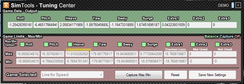

    The "On/Off" feature makes tuning and axis management soooo easy. Coupled with the new "Balanace/Capture/Off" in the tuning centre, I can concentrate on one force / axis without affecting the already stored values in Max Min for other values.
