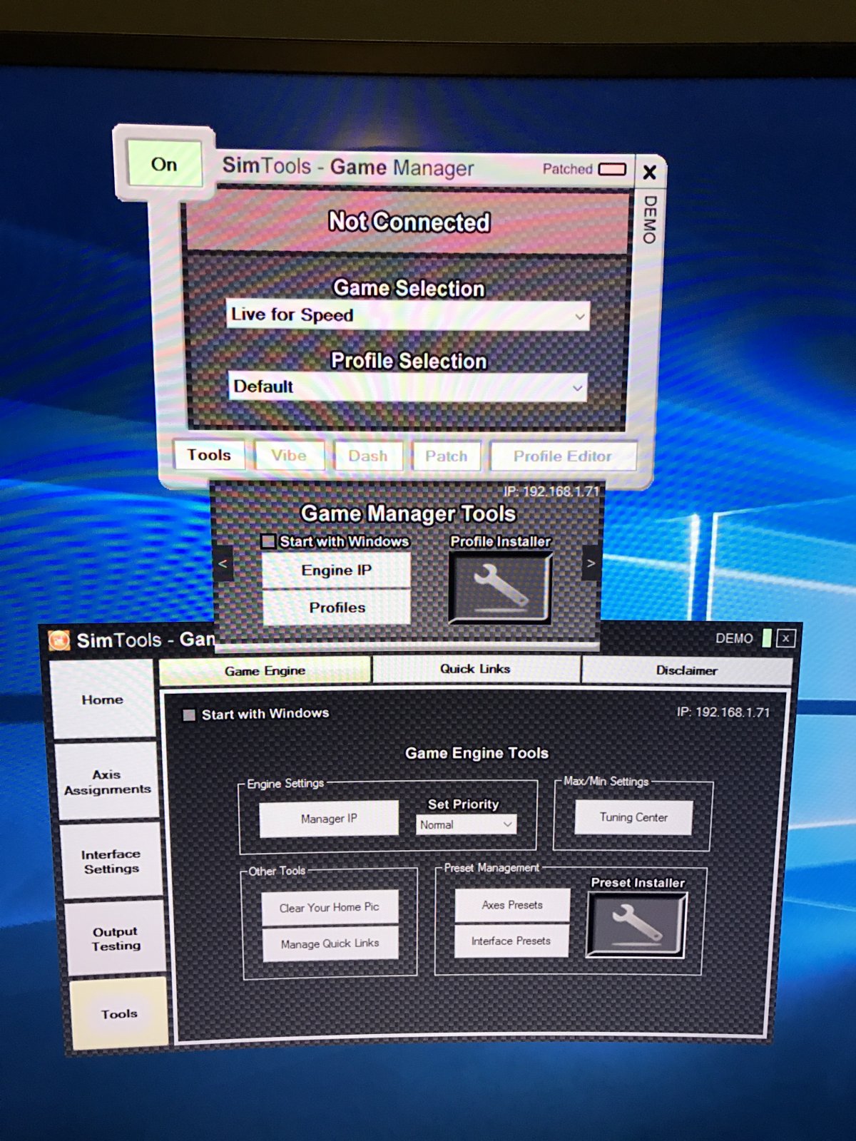

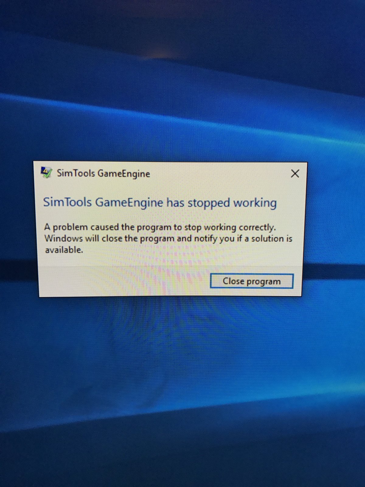

    From your explanation pulling the dongle didnt help. Is it possible to plug your machine into your network/internet directly with a cable for troubleshooting purposes. Then do clean restart. Then take a screen shot.

    Ok IP has changed to 192.168.1.71 on both

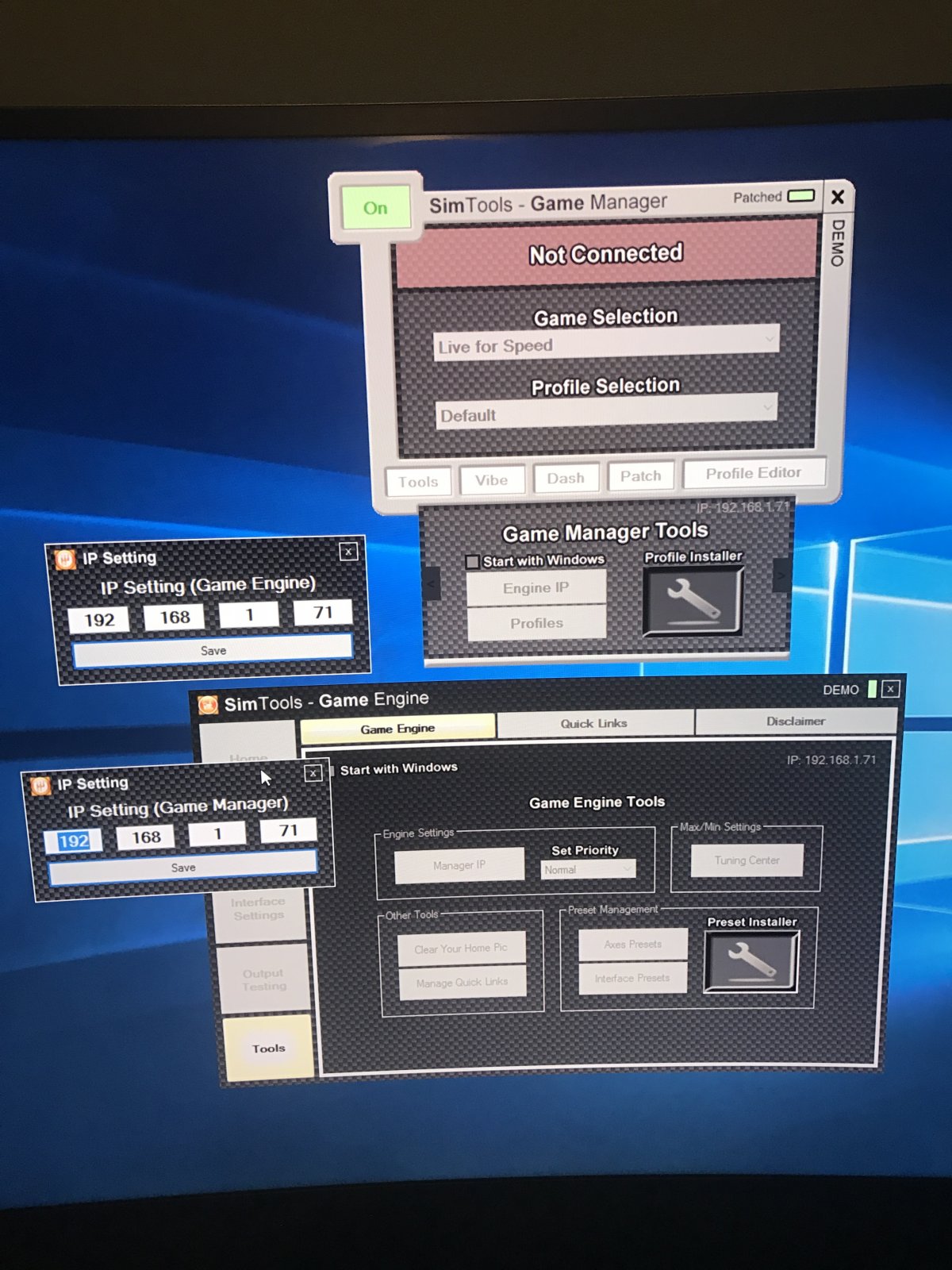

    Now enter that ip into both apps. Don't exit or restart your PC or either app. As soon as you save is when it should connect. Let us know.........

    Hit save on both, didn't connect!

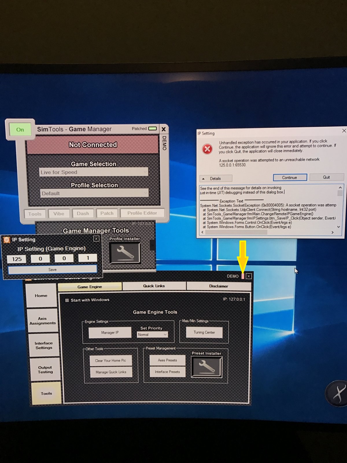

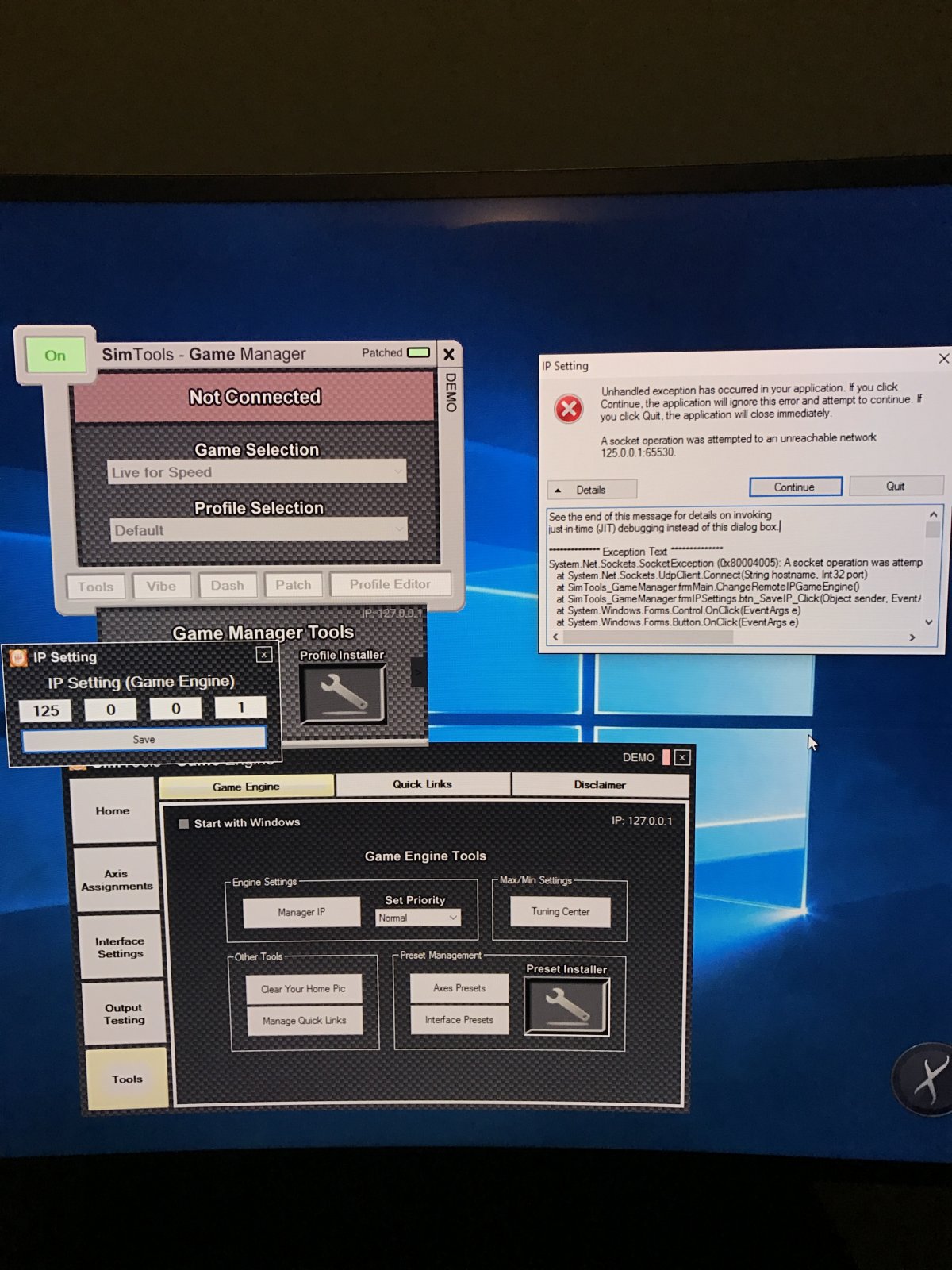

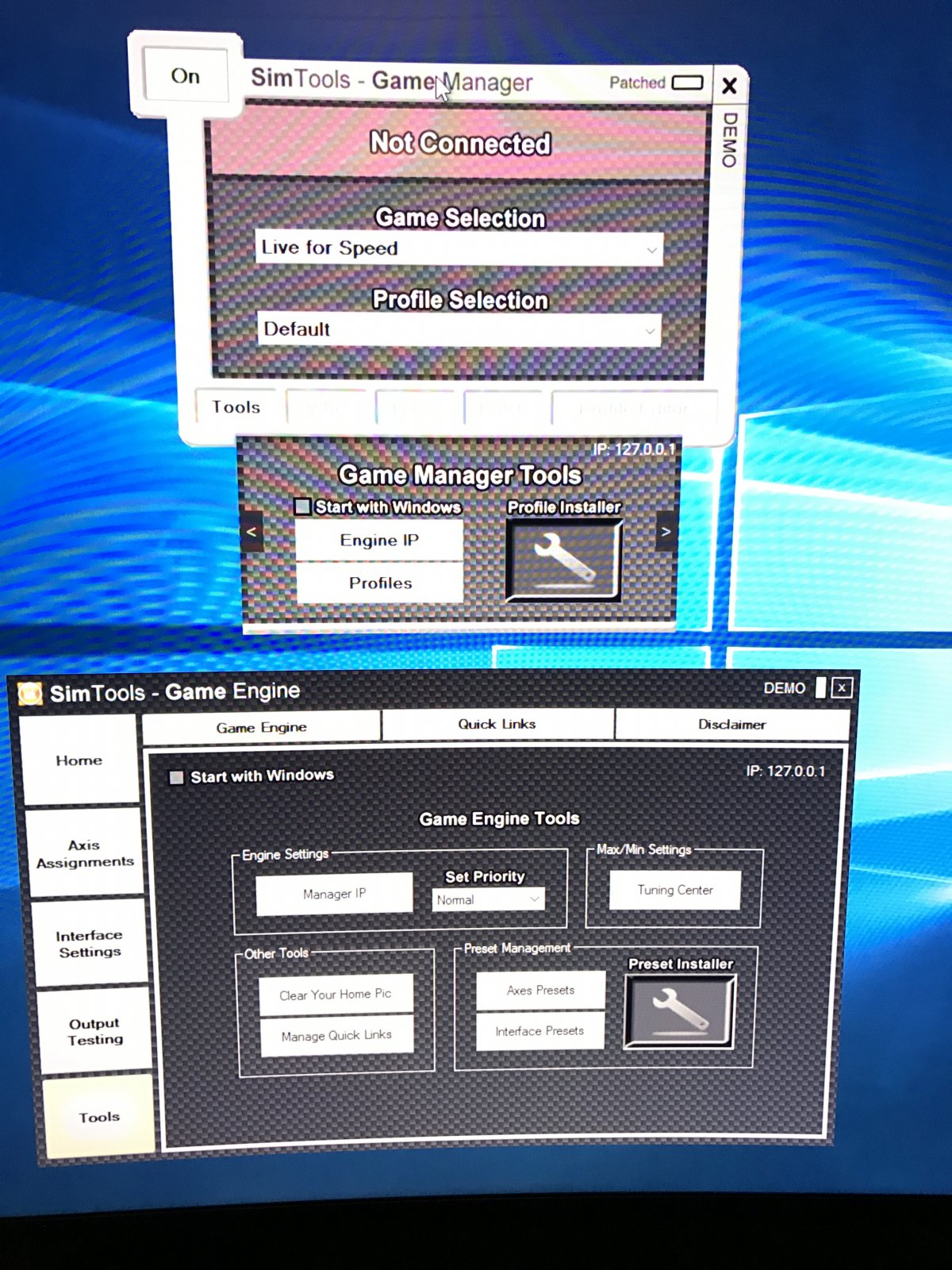

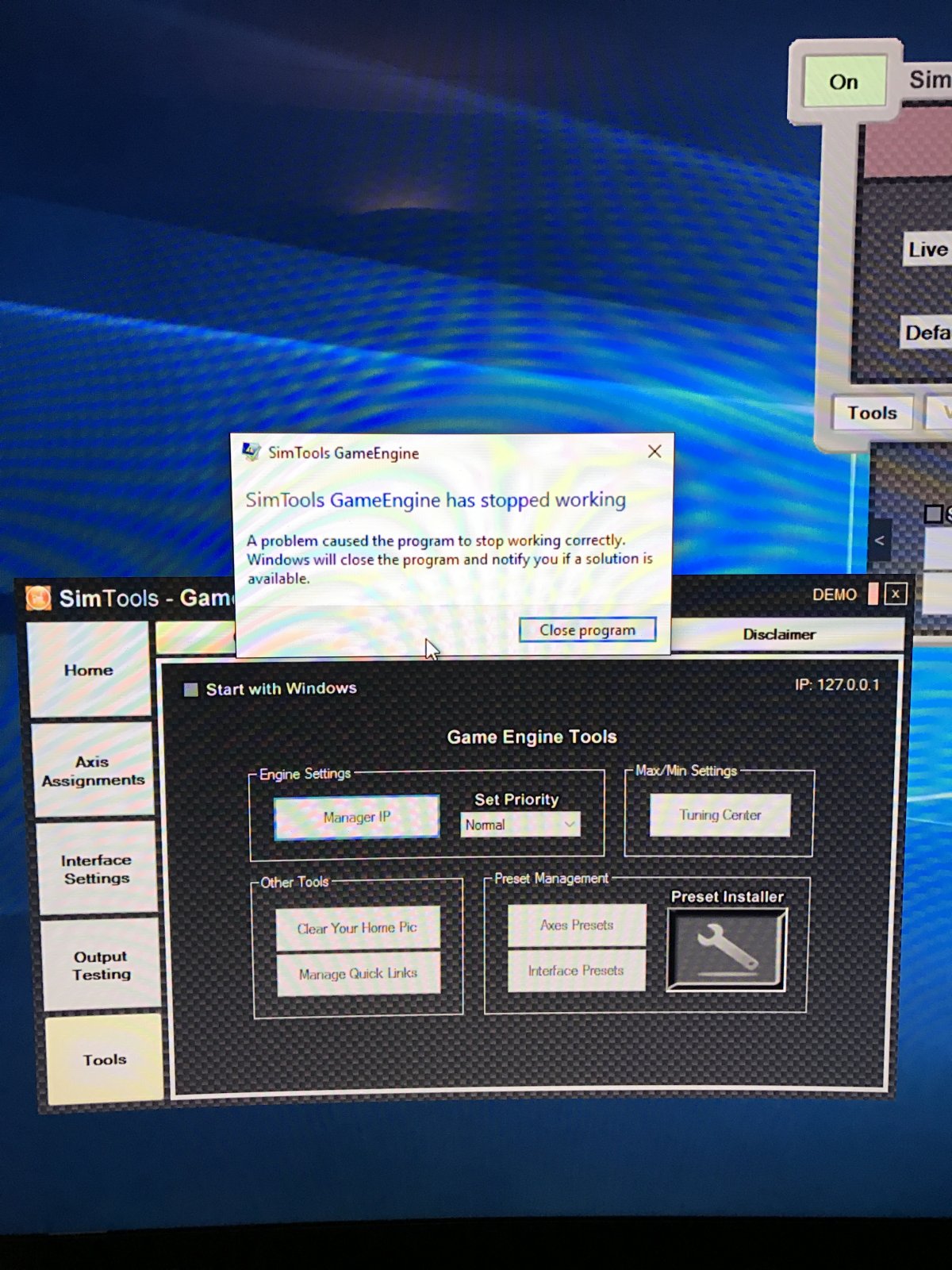

    The problem is that you may still have a previously used and a pre configured UDP port and it's not free for the new v2.0 installation ... maybe a windows 10 issue as I'm getting used to hear :(

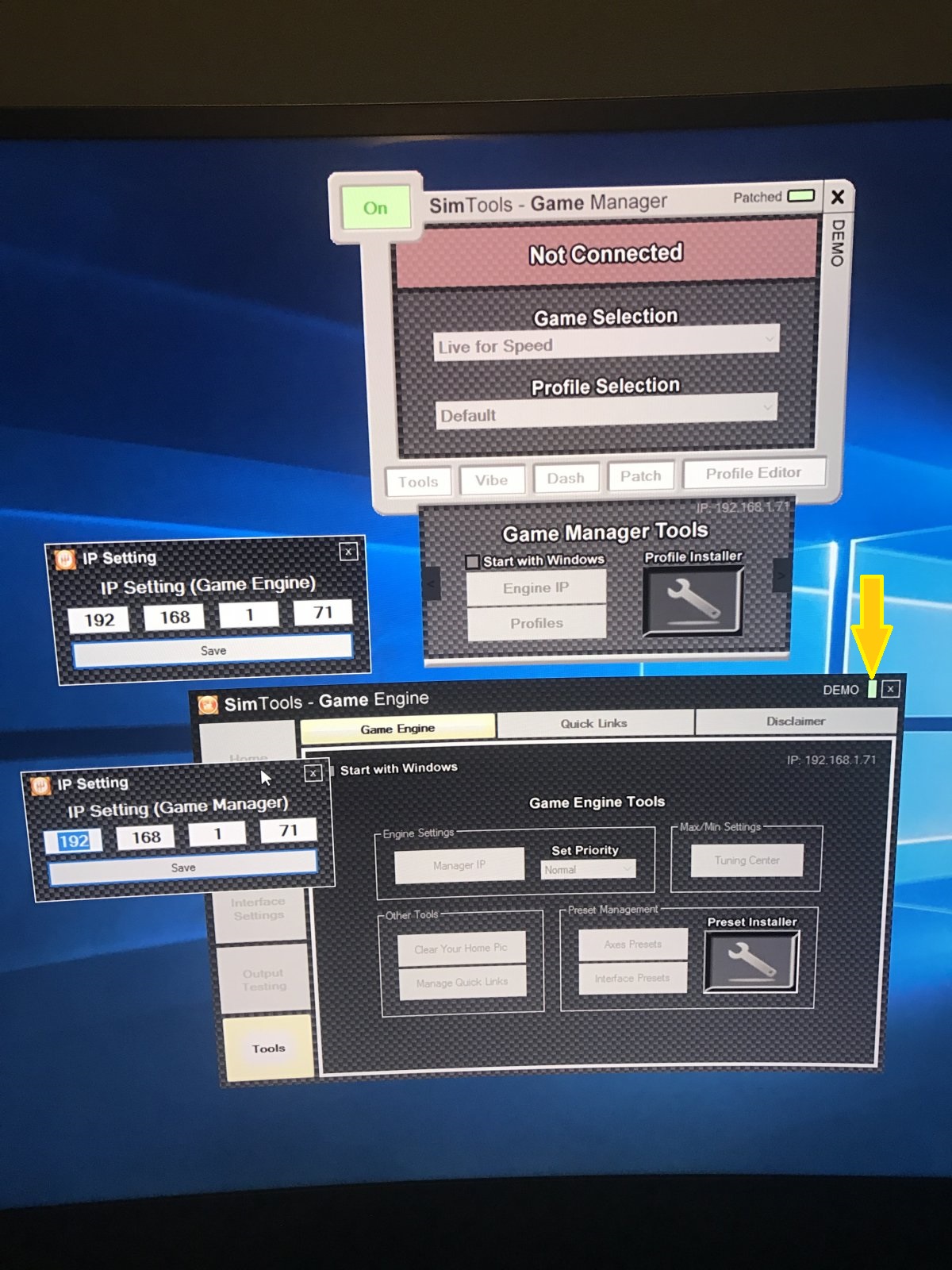

    I've previewed your photos closely and you had it buddy just one click away ...
    you should go and continue with the messages that says Unreachable network ...
    Yes ... These will reset the previous installation stuck network addresses and UDP ports and leave you free to go back to them again ... And use only the Game Manager to change the IP back ... just use the 125.0.0.1 first ... continue with error messages ... go back to 127.0.0.1 ... Close and Exit then on every change .

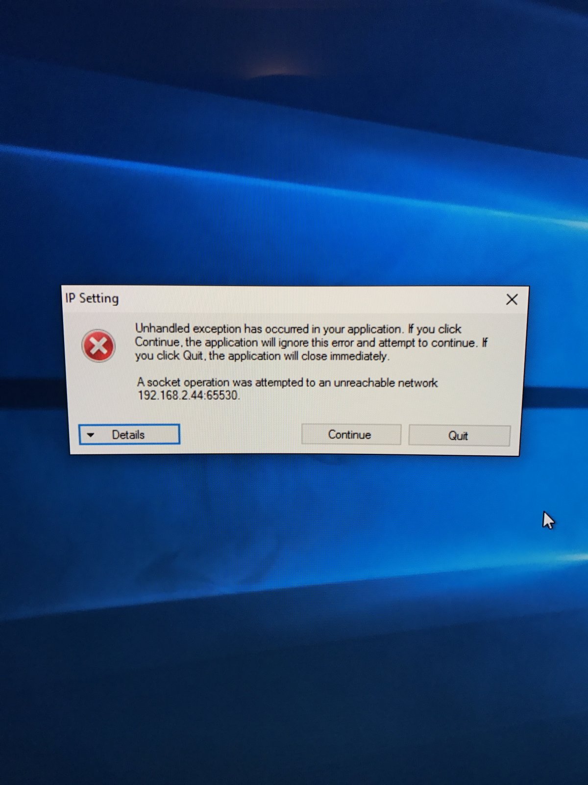

    @MWB - Might be a long shot, but I wonder if your "Local" network is locked down. It appears you can't send traffic locally which is really odd.
    Open up File Explorer, go to Windows then System32 and scroll down to find cmd.exe. Right click this and run as administrator.
    Once the CMD line opens, type this to kill your firewall across all profiles (Public / Home)
    NetSh Advfirewall set allprofiles state off.
    Then fire up Game Engine and Manager again.
    If no joy, to restore your firewall, just do:
    NetSh Advfirewall set allprofiles state on
    Failing that, I would see if your Anti-Virus has some how marked SimTools as "rogue" and is stopping any communication from it. It should not, it's perfectly safe, but if your AV has some setting to treat "new" as suspicious, it could be an avenue...

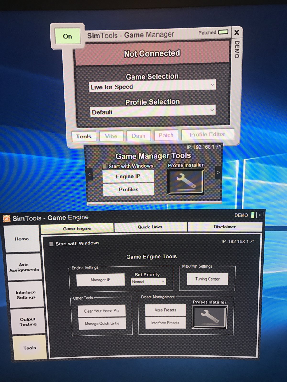

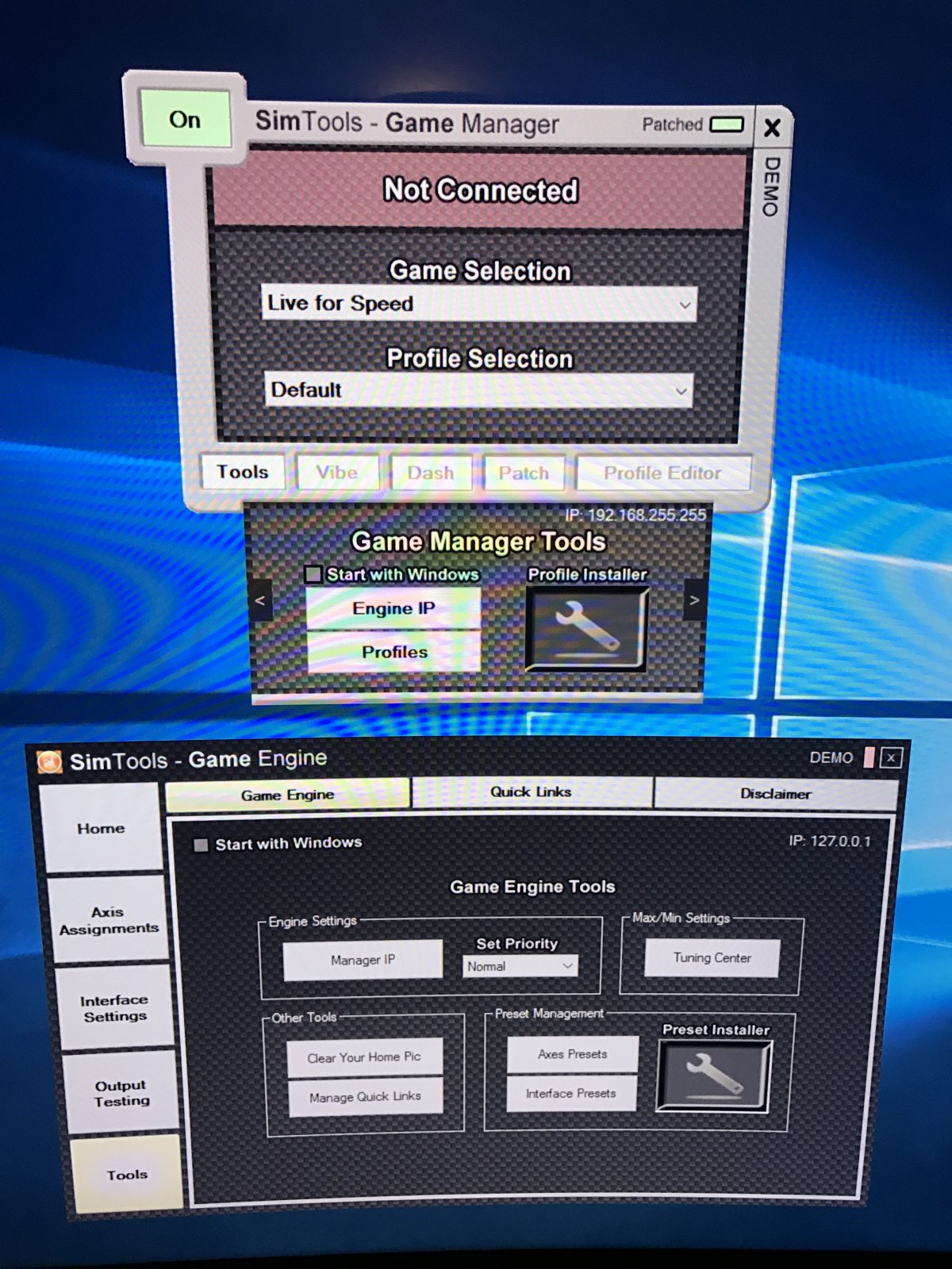

    @MWB @bruce stephen ... Sure you have a progress in this issue :thumbs...
    see the first photo the Game Engine was not connected to the background port "Red Rectangle" ...
    At the second one it is connected "Green Rectangle" .
    @MWB You were just a click away ... do the same with the Game Manager .:thumbs

    @MWB 127.0.0.1 is the address used to establish an IP connection to the same machine or computer being used by the end-user.you are on a single pc configuration right? i don't think you have problems with the ip. probably your firewall is blocking Game Manager to communicate with Game Engine.you could give it a try on a other PC to see what happens there.
