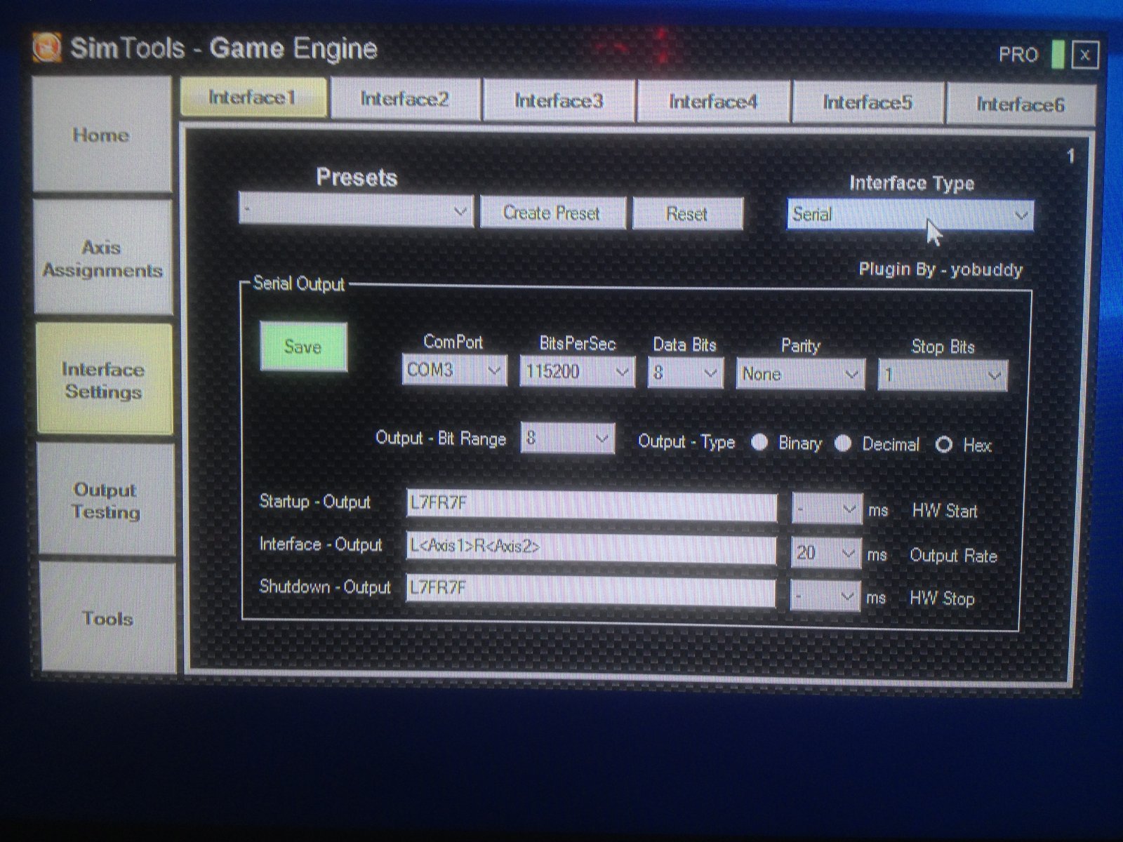

  19. MPG
    MPG New Member Gold Contributor
    Sep 9, 2016
    26
    Netherlands
    57Coins
    +13 / 0 / -0
    the settings are changed?
    Below the picture my current settings, this worked perfectly with simtools1.3
    But not with simtools 2.0
    I have an Arduino with sparkfun Monster Moto Shield.
  20. Historiker
    2,163
    9,212Coins
    +2,177 / 19 / -1
    Add an "a" (without quotes) behind Axis1 and Axis2
    • Agree Agree x 3
