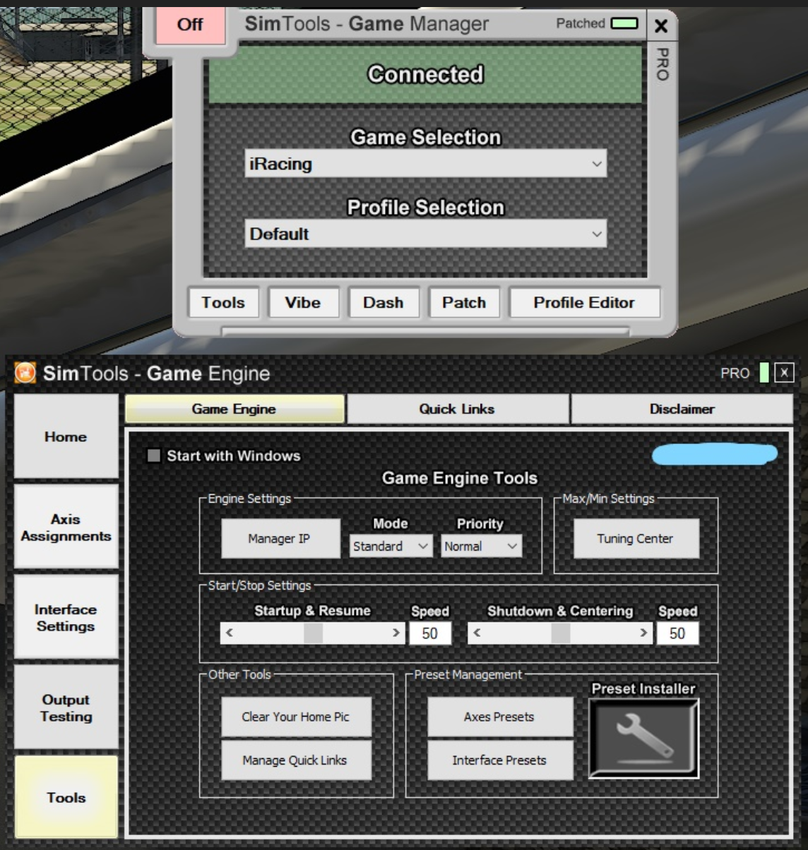

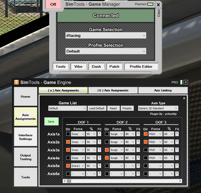

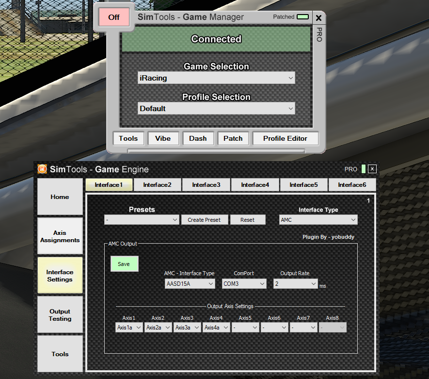

    hey,
    i have really annoying problem and i tried so many thing to get it to work but no luck .
    first of all i don't know where i should write my problem but here i think i can get help
    my problem is that when i connect to sim tool and go to test output and press turn on nothing happen
    also when i connect it to iracing nothing happen
    i'm using AMC interface AASD15A , also using windows 10
    i have tried so many things
    i have tried 2 different PC ,and both pc on english language
    i have tried using 2 different professional license
    also tried uninstalling sim tool and reinstall it
    also tried installing simtool while windows defender is turned off
    also tried installing sim tool on fresh windows version
    updating windows to the latest version
    also tried deleting the FTDI driver provider and plug the usb again
    also i don't live in US i don't know if that matter but maybe the IP matter , also tried using VPN didn't work
    i tried patching iraicng .
    i contact the support many times but no one responded to me
    note that i have tried using flypt mover and it work just fine but no luck with simtool
    i have spent more than 200$ for this sim app hopping it will work but no luck

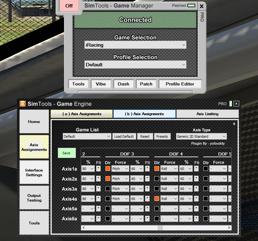

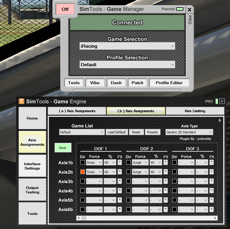

    i have used different setting not only this

    In all of the images Game Manager is Off (top left), which means Game Engine is disconnected from the game.
    Does Output Testing work as expected on the Default Axis Assignment profile?

    yeah it's off but when i open iraicng it connect automatically and it says game on , i turn it off to take the photos
    output testing doesn't do anything when i try it
    yes i have thanos controller and i talked to thanos about the controller but it seems it work just fine

    Please try output testing again, but select the "( a ) Axis Assignments" to control from the drop down list in output testing.
    Do you get any movement?

    yaeh i tried this before no movement

    I know others are using this interface, are you using v2.4 of SimTools and the latest firmware for the AMC-AASD15A?

    For a SimTools installation on a single PC the IP address should be 127.0.0.1 for both Game Manger and Game Engine.
