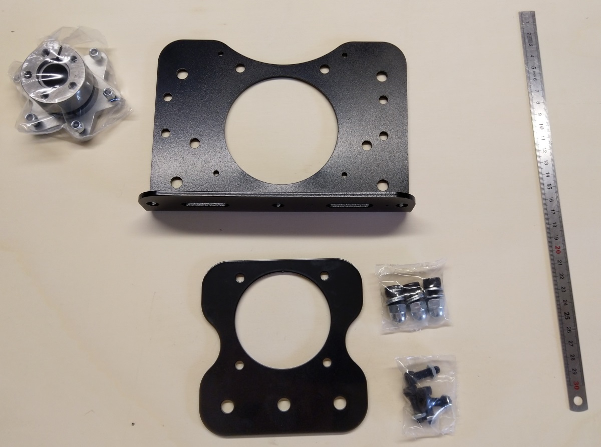

    The kit is good quality, made of one control unit, some cables, the MIGE motor and the mounting plates.
    the assembly is very easy, not more than 20 minutes, taking your time.

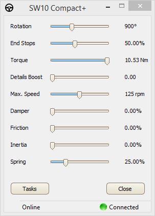

    The control software is pretty basic, as it is in the following picture.
    Despites the small numer of options it works well and you can tune your wheel the way you want.
    (Ollie told me that they are still actively working on the dev, and I received 3 software/firmware updates since end of August)

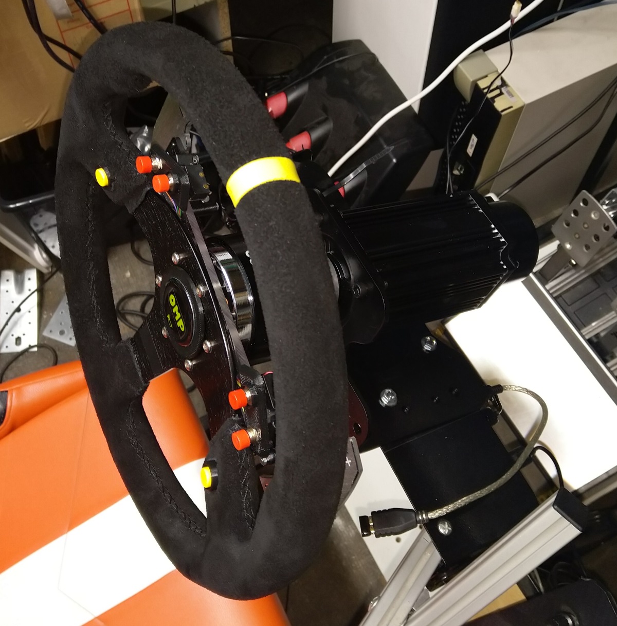

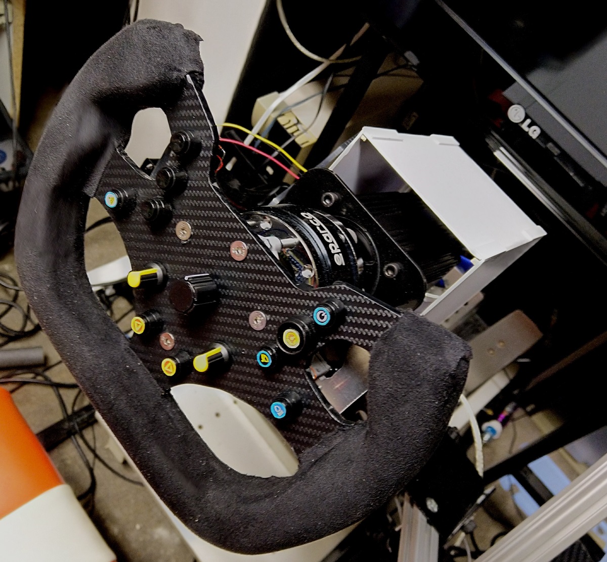

    I have two different wheels, both of them DIY.
    the first one is based on OMP wheel copy from aliexpress, 35cm diameter. I added 3D printed magnetic shifters and quick release (fake 15€ Sparco).
    This wheel is pretty heavy (>1.5Kg).
    With this wheel I run at 10Nm and 85-100% of force in games.
    With the weight/inertia there are some missing details in the FFB, and with the large diameter you can 'counter' the force effects with a lot of strength.

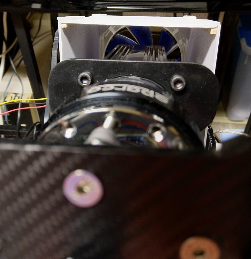

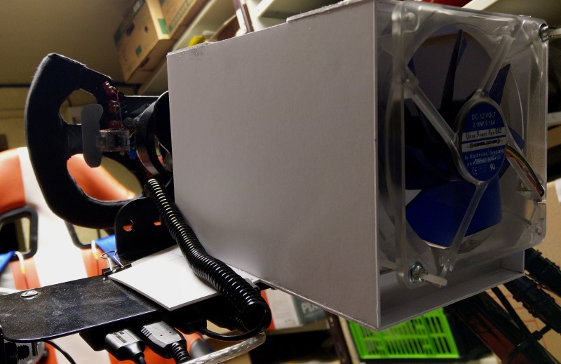

    with such a wheel you can be at the limit of MIGE motor, and it can get quite hot after intense racing, that is why I added a fan to keep the motor at a reasonable temperature (to be able to keep the hand on it).
    The second wheel is a DIY replica of the Huracan GT3 wheel (should be perfect for VR in ACC in the future...)
    I made it from 6mm plexiglass and foam so this wheel is very light.
    The diameter is also reduced to 280mm
    with this wheel I can feel more details, but my arms cannot suport running at full torque for a long time.
    In AC i'm running about 60 to 85% depending on the car.
    with ACC I'm running at 70% with the Huracan.

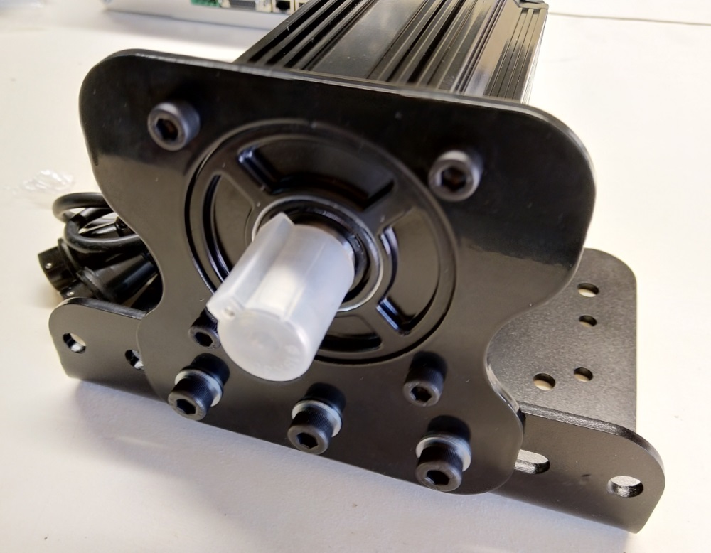

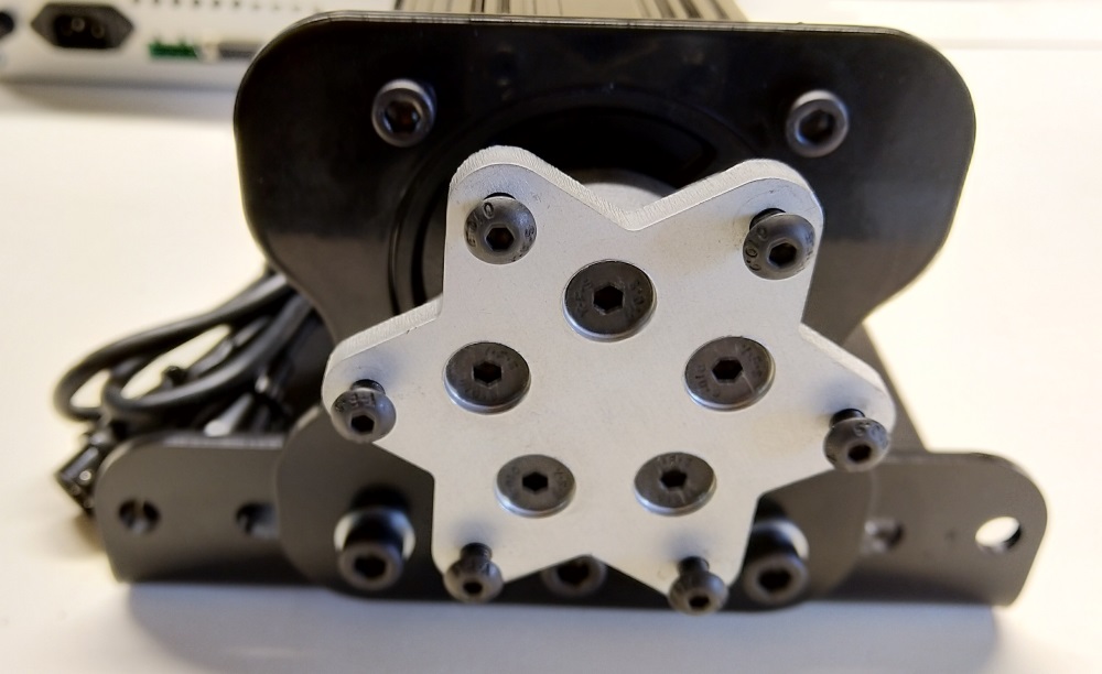

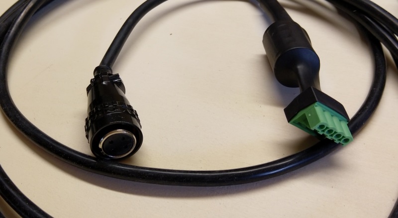

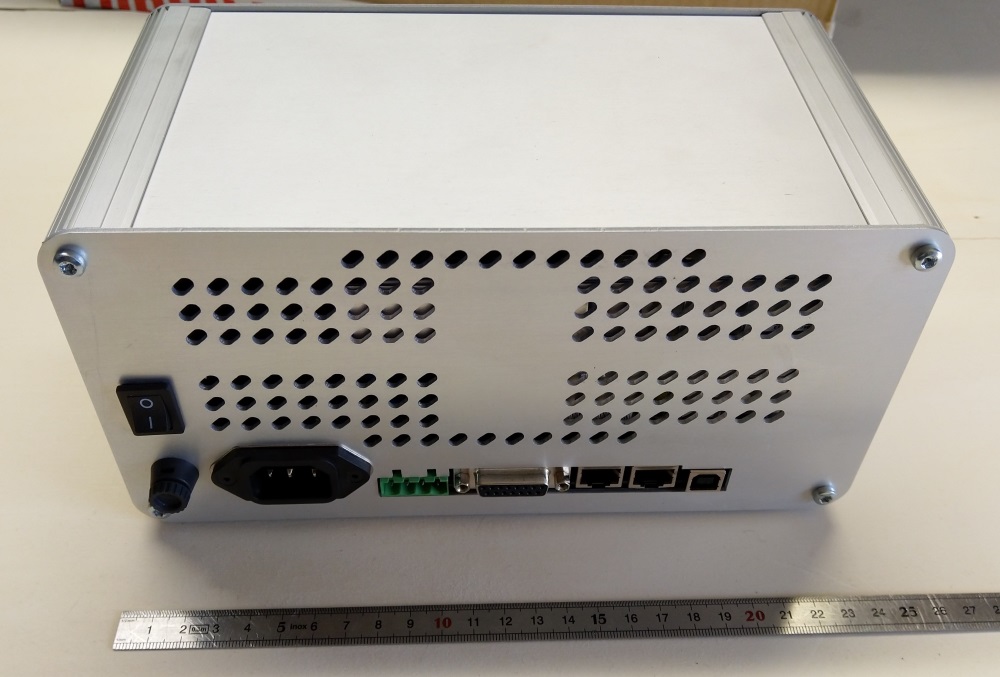

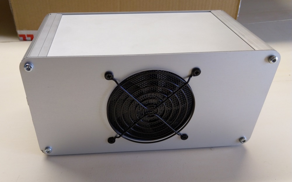

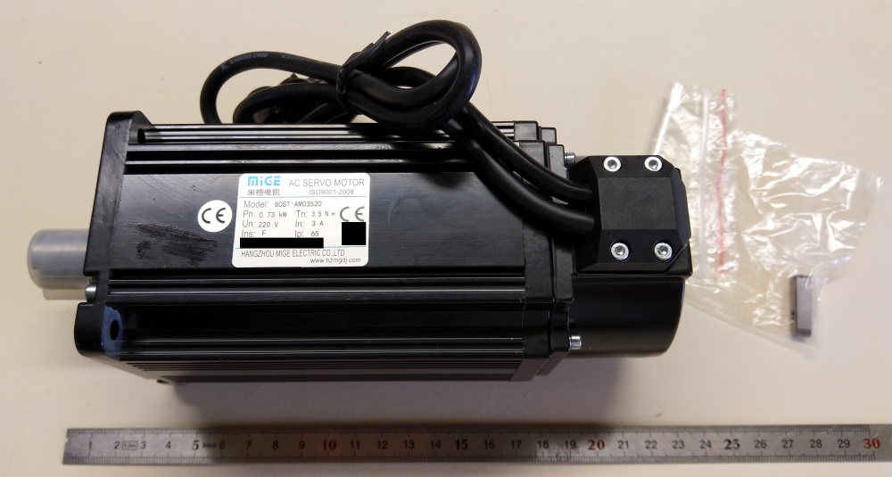

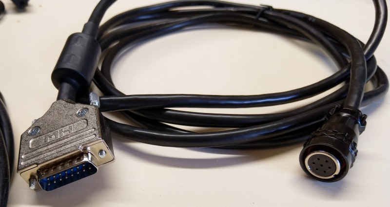

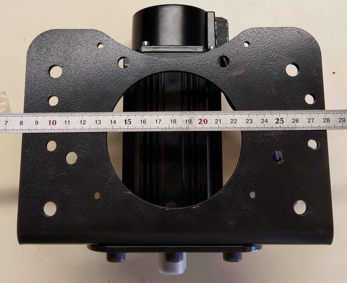

    Here are some pictures of the unboxing
    001s.jpg 002s.jpg 003s.jpg 004s.jpg 005s.jpg 006s.jpg 007s.jpg 008s.jpg 009s.jpg 0010s.jpg 011s.jpg

    Please keep us updated with how the software develops and also any game you test. AC and ACC are my main games also, but I would also be interested in what this wheel is like in R3E, Automobilista and PCars2. Also, that Huracan wheel looks really good. You wouldn't happen to have a video of how you created it? A written tutorial or explanation would also be cool. :)
    One thing I'm concerned about regarding DD wheels is electromagnetic interference. Are all the cables above shielded?

    Here is thread to detail the building process for my wheel:
    https://www.xsimulator.net/community/threads/diy-huracan-gt3-wheel-replica.12506/
    Regarding EMI, I don't notice anything on my rig. I have many DIY things (button boxes, shifter, custom pedal set, ...) and everything works well.
    the cables between the base and the motor are using shielded connectors.
