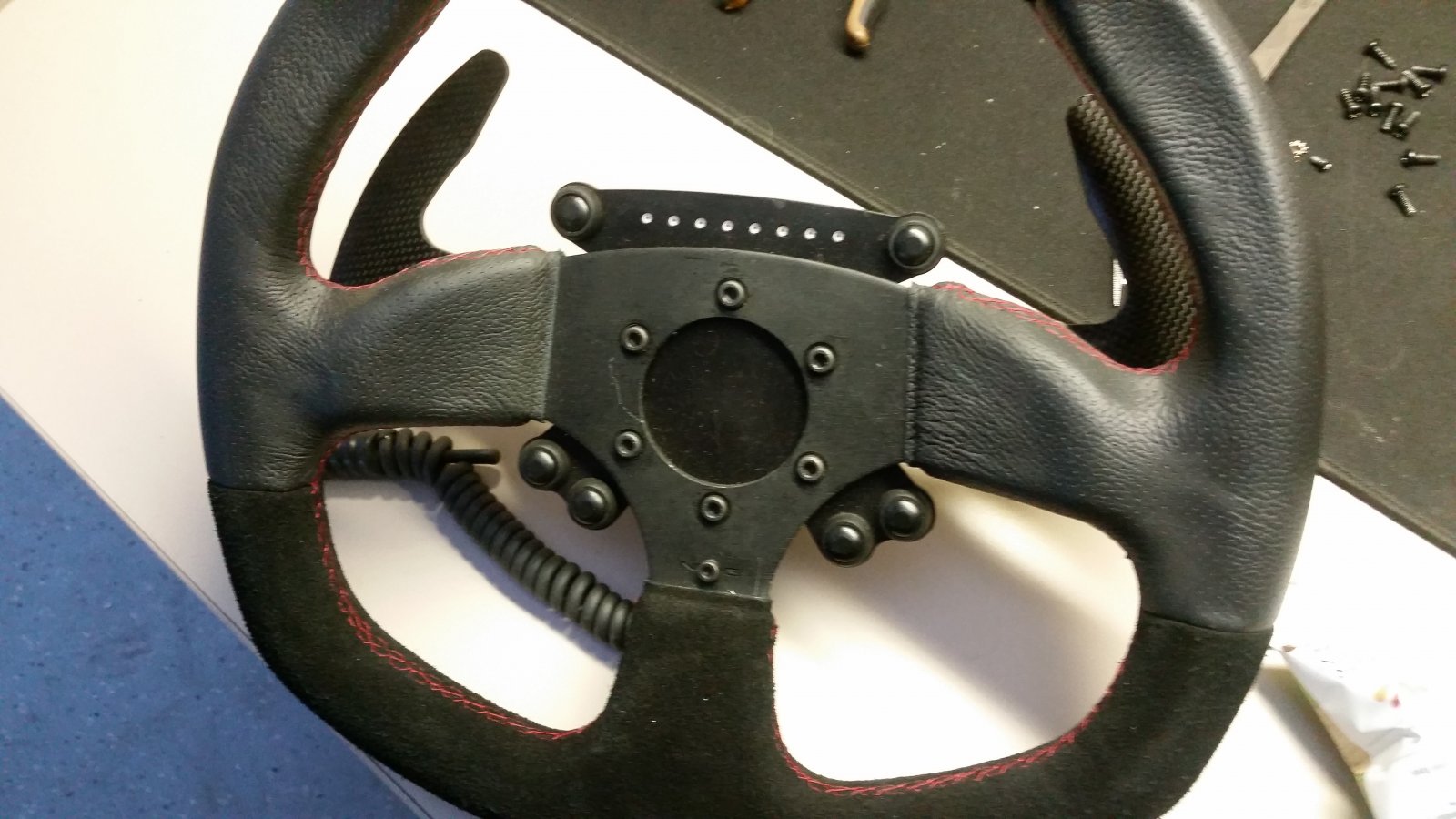

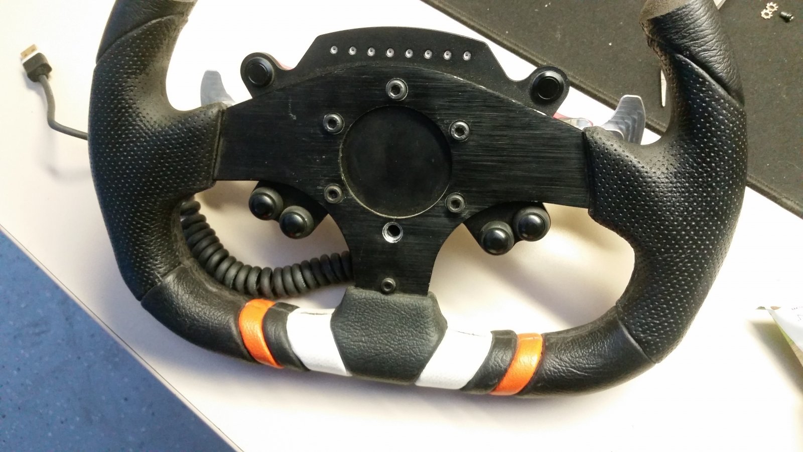

    That great about the discovery, I use one with my OSW, although only for the wheel itself and a shifter input. Have you seen the new Simucube Granite Devices is coming out with.
    Sorry, I'm not able to post a link, but if you google "SimuCUBE - the force feedback controller from the future" it's the first link I get.
    It has the discovery chip built in and has a lot of other bells and whistles as well. Right now I use the Argon for my osw, but I'm pretty sure I'll move to this when it is released. I'd love an easy solution for dash displays. The firmware for the Simucube is going to be open source, so I wouldn't think it would be too hard to incorporate someting if it has the appropriate I/O. On the diagram it says "Display Connector", but I'm not really sure what it is meant for.
