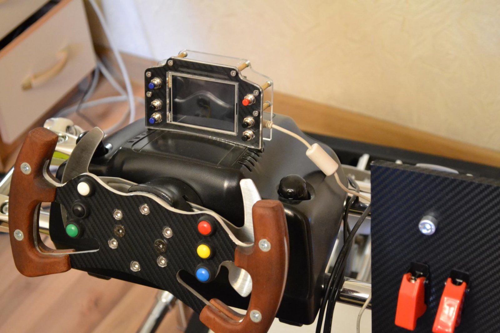

    I mount the dash in holes of my G27, this way:

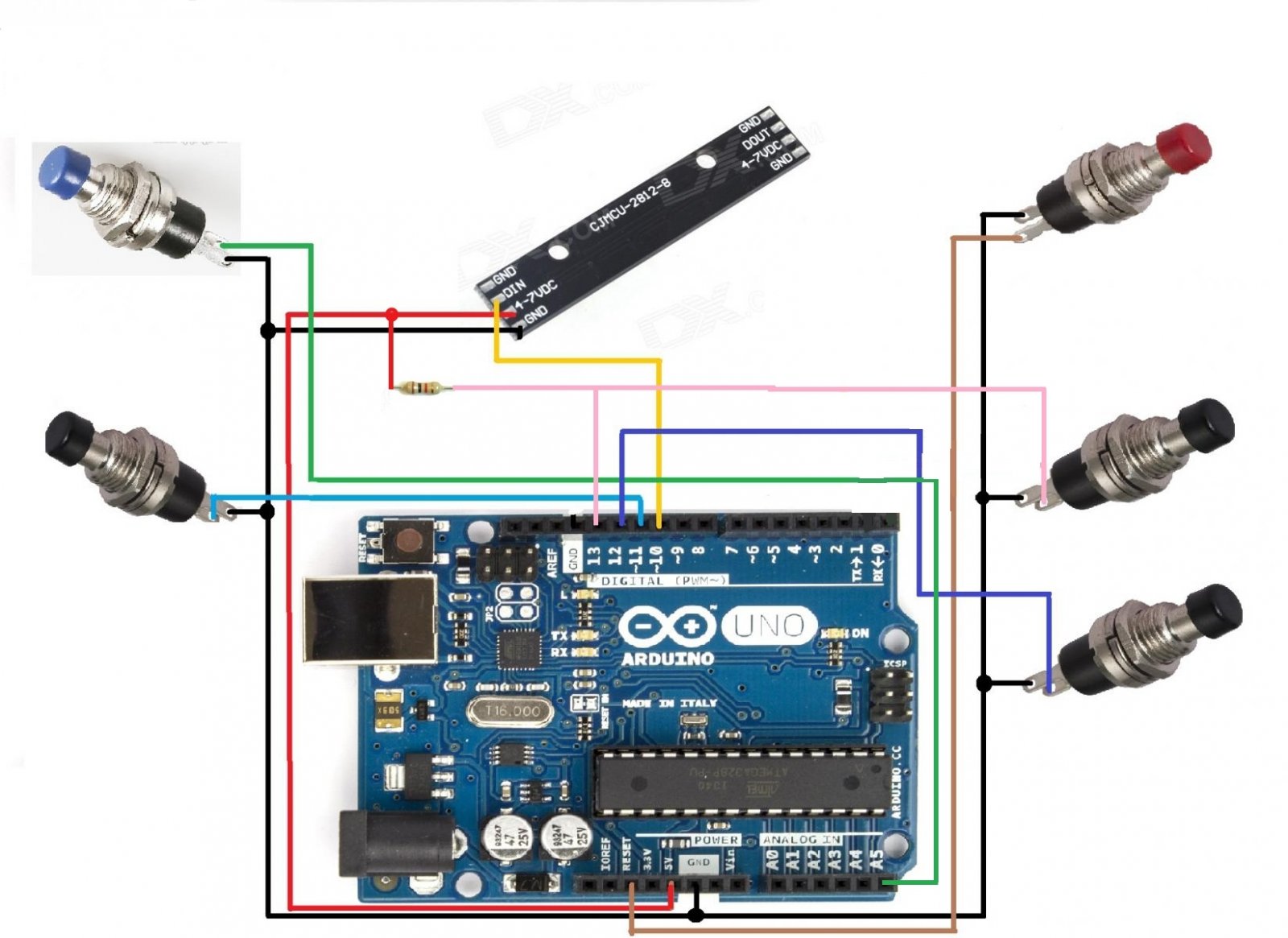

    Wiring is pretty simple, the diagram is below:
    I.e.:
    PIN A5 - “Screen” button
    PIN 11 - “Settings” button
    PIN 13 - “Increase” button
    PIN 12 - “Decrease” button
    PIN “Reset” - “Reset” button
    PIN 10 - NeoPixel strip DIN

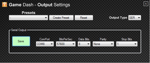

    Yes, I'm using GameDash, I can't attached screenshots, but settings are:
    BitsPerSec - 115200
    Data Bits - 8
    Parity - None
    Stop Bits - 1

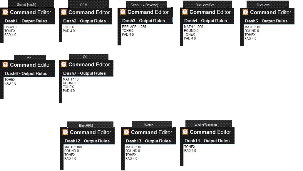

    Interface Output - R<Dash2>G<Dash3>S<Dash1>F<Dash6>
    R - RPM
    G - Gear
    S - Speed
    F - Fuel
    Shutdown Output - Z0000

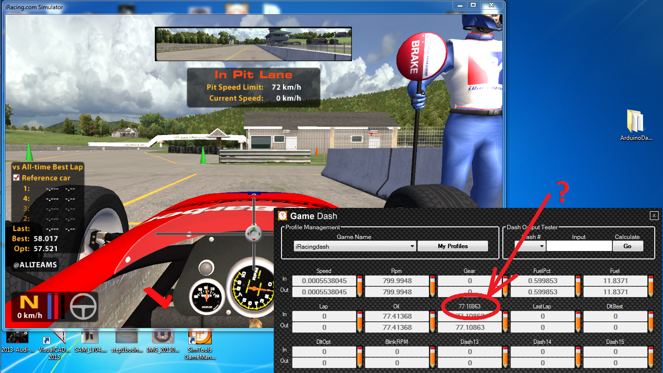

    Also I have some weird behaviour in gamedash - it shows actual value of water temp insteed of dash's name "Water". All other dashes are showed nice. Made screenshot for more clear explanation of this.
    But anyway I can live with it some time.
    I believe plugin works only in 64bit game (how guys is it possible to set 2 different const _ProcessName in plugin?) and gather only dashboard telemetry.
    Dash_1 - Speed,m/s
    Dash_2 - Rpm
    Dash_3 - Gear
    Dash_4 - Fuel Remaining, %
    Dash_5 - Fuel Remaining, Litres
    Dash_6 - Lap
    Dash_7 - Oil Temp, C
    Dash_8 - Water Temp, C
    Dash_9 - Players last lap time, s
    Dash_10 - Delta time for best lap, s
    Dash_11 - Delta time for optimal lap, s
    Dash_12 - BlinkRPM

    I found and fixed the problem in GameDash itself. :blush
    For now a simple workaround is to change slot 8 to slot 13.
    so change "Dash_8 - Water Temp, C"
    becomes "Dash_13 - Water Temp, C"
    and just don't use slot8 at all.
    Its just the title that shows wrong for slot 8, it should work just fine...
    The fix for this will be in the next update of GameDash...
    It also looks like some of the plugin has been disabled?
    so it may only work for dash stuff?
    anyway, just a little update on what I found.

    Yes, it works fine this way, thanks!
    And yes, its just my draft plugin and it only works for dash stuff :)

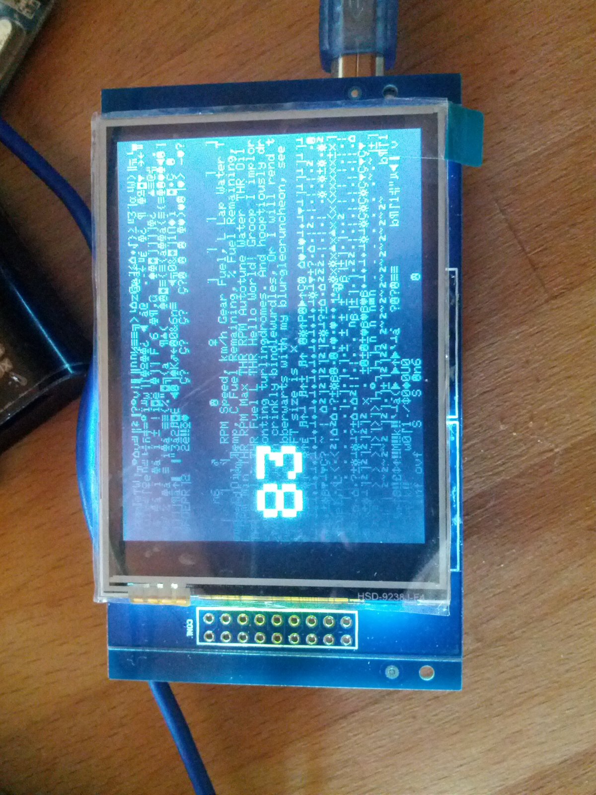

    After the TM1638 dashboard I made, I'm making a new one based on your great design. I have some issues with the LCD I got from DX
    If I use the lib from adafruit you mentionned I just get a white screen. If I use the modified lib from here it improves the situation a bit: now the LCD shows garbage caracters but I cn spot Fuel, RPM spped, and other strings. When sending data to serial, it sometimes displays the value (like S0000) but most of the time crashes the sketch?
    With this updated lib, the sample graphicstest works nicely. It reports a ILI3941 as show below:
    FT LCD test
    Using Adafruit 2.8" TFT Arduino Shield Pinout
    TFT size is 240x320
    Found ILI9341 LCD driver
    I also added the testtext function from the example to your code in the setup and it worked.
    Any hints ? I' a bit stuck for now.
    Bonus question: what do you use to have this carbon-fiber look ?

    you can see Fuel, RPM, etc strings (ie "titles"), but no actual values, do I understand you right?
    Do they in correct places like in my video? If so I expect you find correct library for your LCD and issues only with data from GameDash.
    Garbage chars is most likely for Gear
    Ok, can you fisrt check that GameDash shows correct values in itself? Then try to output only one dash value (for example Speed or Rpm) from GameDash and see how its shows on LCD. If it works than try to add another value and so on. Such sequental approach can tell you what value crashed the ard.
    And what game do you using? I tested the sketch only in LFS and iRacing, so it can be easer to troubleshoot in these games. GameDash settings in the OP are for iRacing, if you need those for LFS I can make screenshots of them when I will be at home
    @Nick Moxley is right, I used cheep carbon tape. Front panel of my dash consist of two slices - there is thin aluminium plate with carbon tape placed on it under the plexiglas one

    I haven't tried yet with a game, just using the serial console to send data and see how it behaves. The screenshot below is after sending "S0000" through the arduino console windows, which made "83" appear.
    If I send something like 'S0200' it crashes and reboots.
    I'm using arduino 1.6.5r5, with different libs as explained earlier. Really strange......
