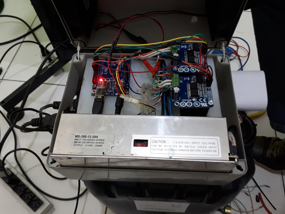

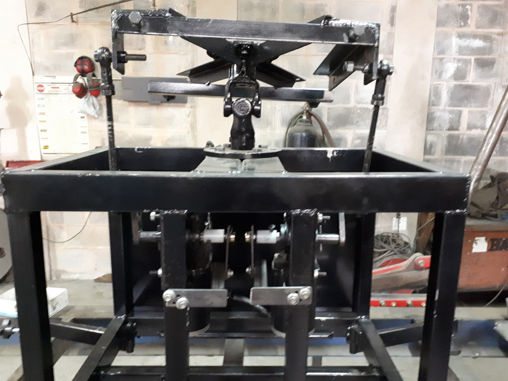

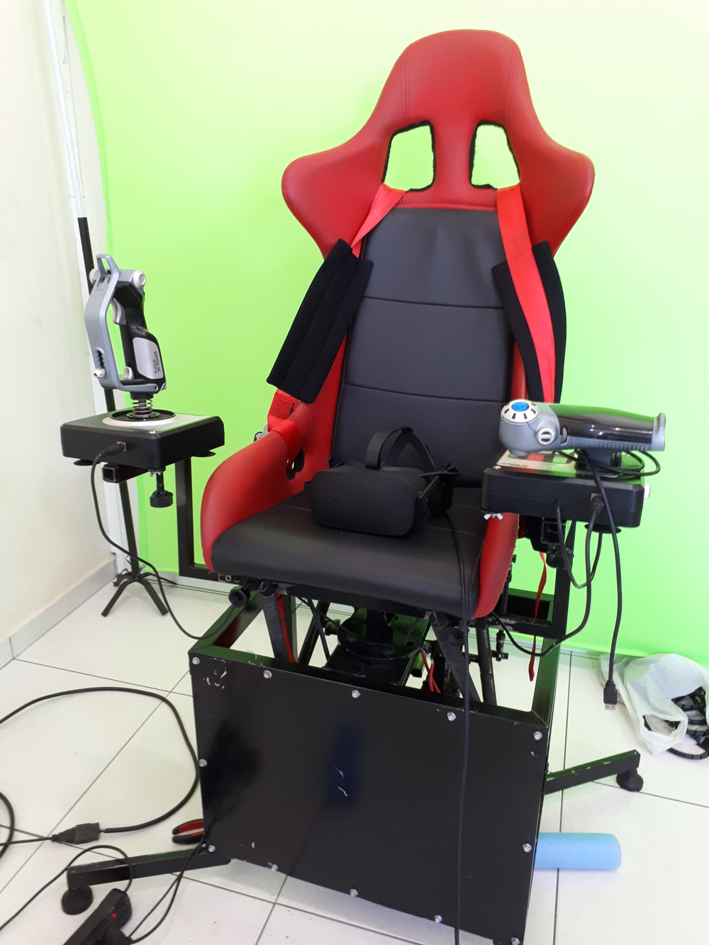

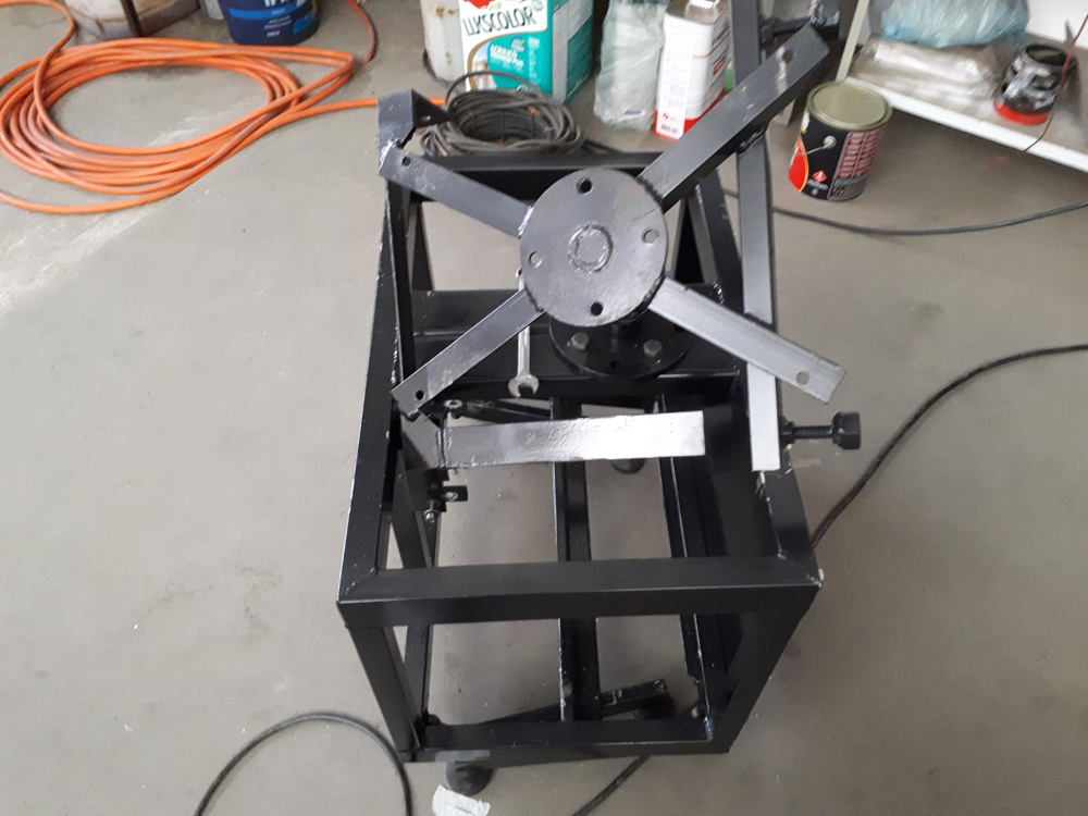

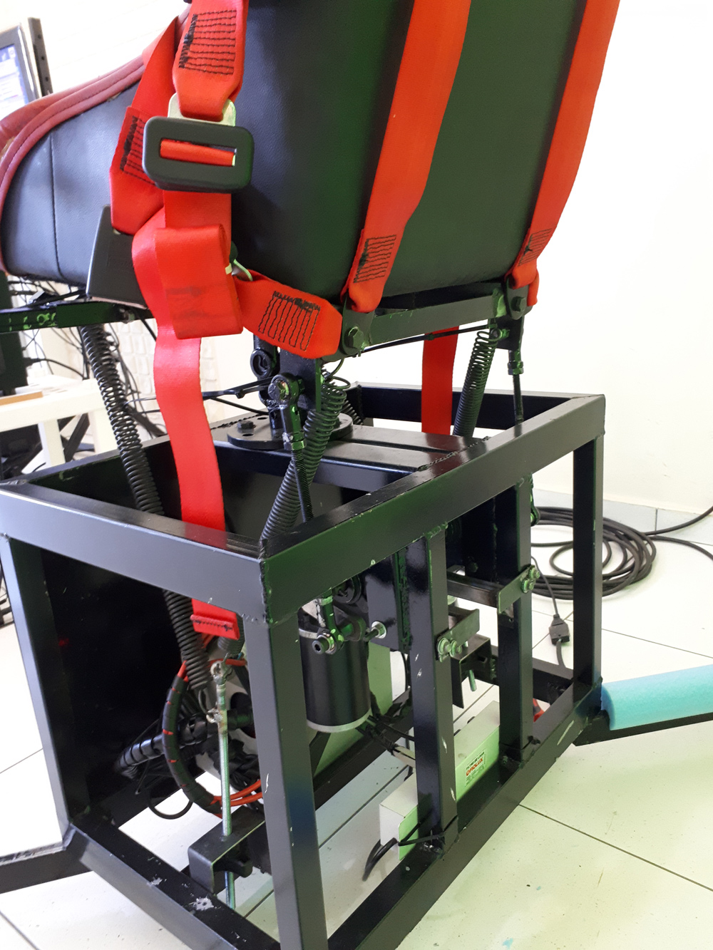

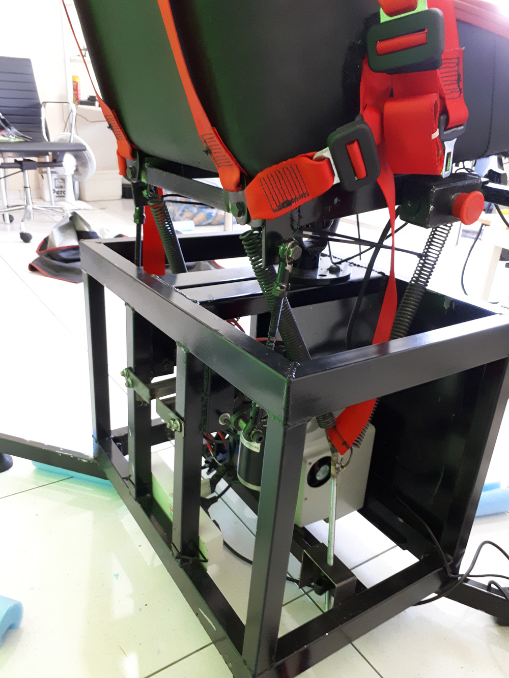

    Hello everyone.
    My name is Ricardo Moraes and I am developing a 2D compact sim for use with the Oculus Rift in Flight Simulators, Car and especially for NoLimits2.
    I've done another project a long time ago using the Velleman k8055 with the Sabertooth 1x12 for x-sim. But I noticed that x-sim is outdated and I decided to migrate to SimTools.

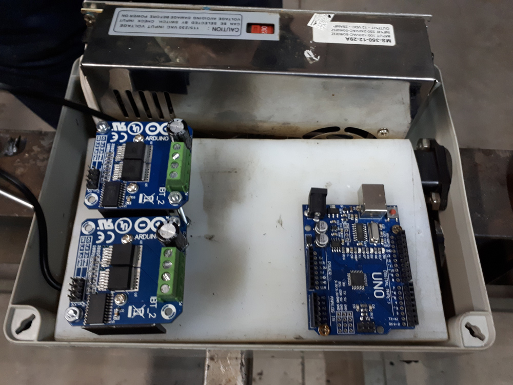

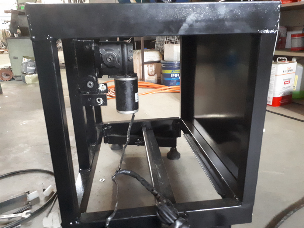

    I am following the post of RufusDufus whom I already thank immensely for the detailed scheme, UNO code and SMC3 software. I was impressed with my first tests. I still have a lot to pack but I'm already very satisfied with the result. Here are some pictures.

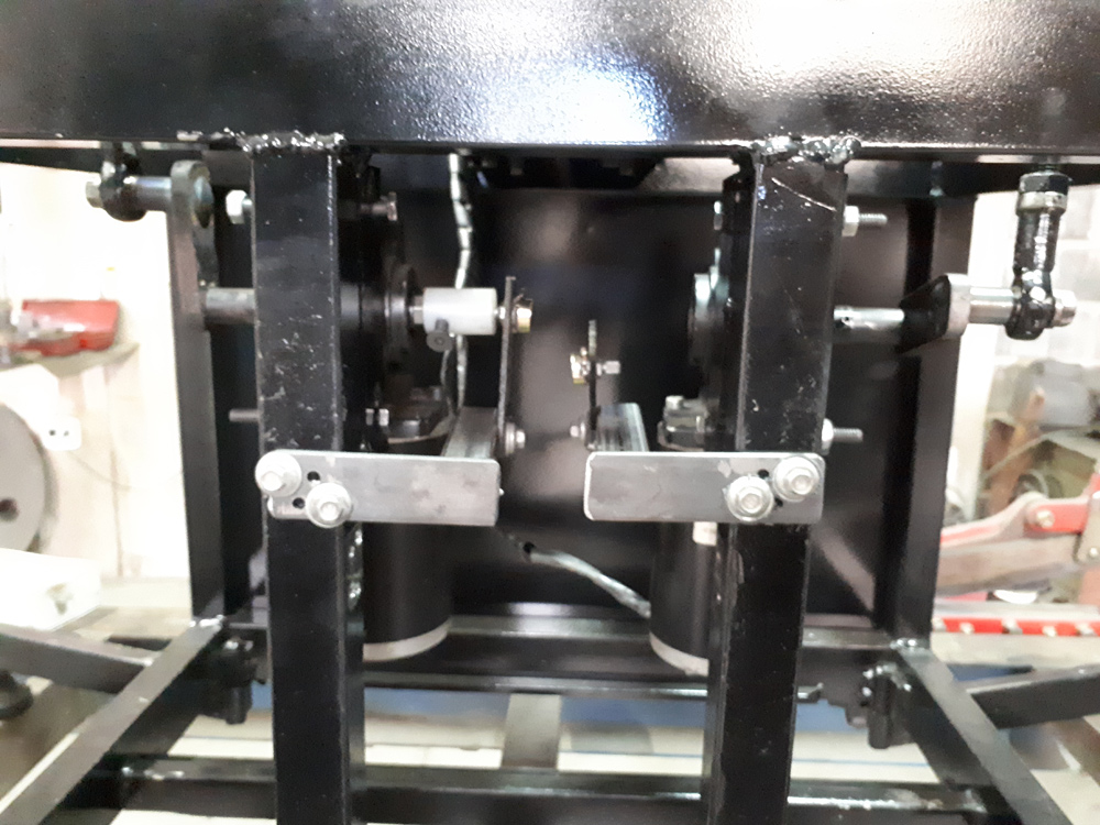

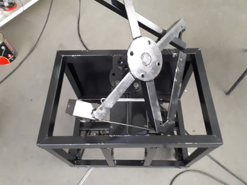

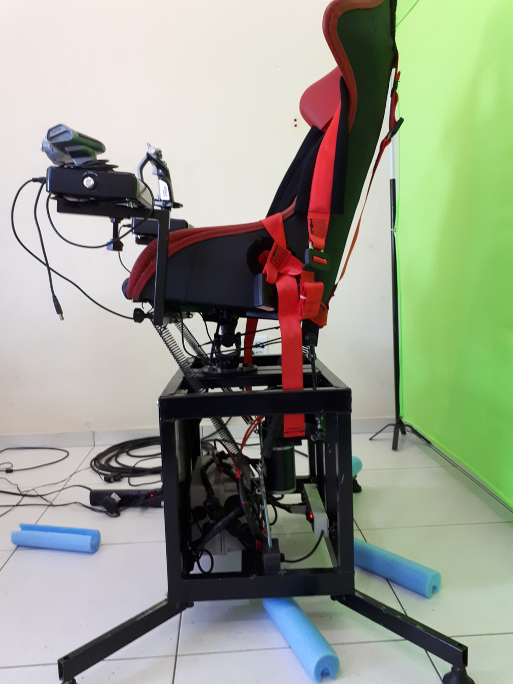

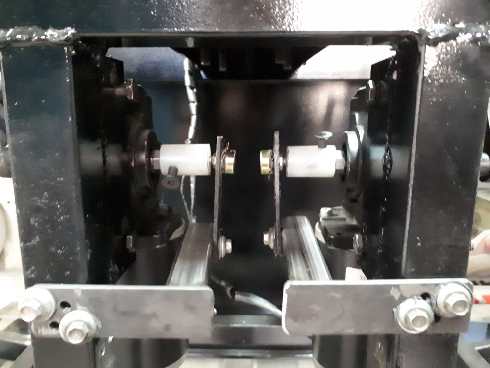

    Here photos of the project almost completed.

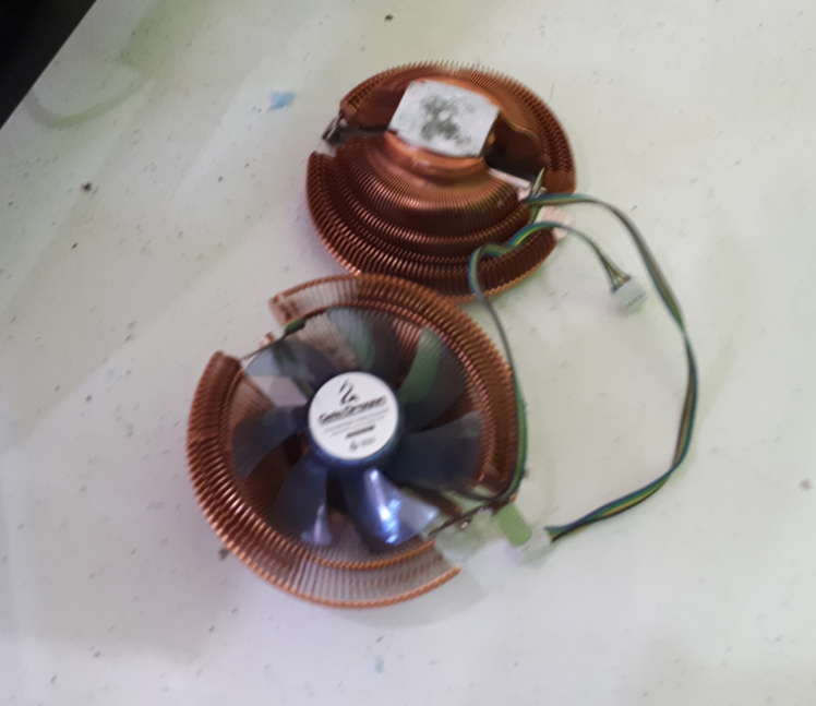

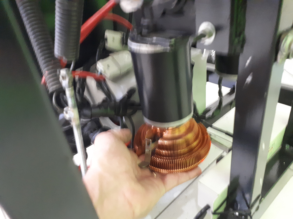

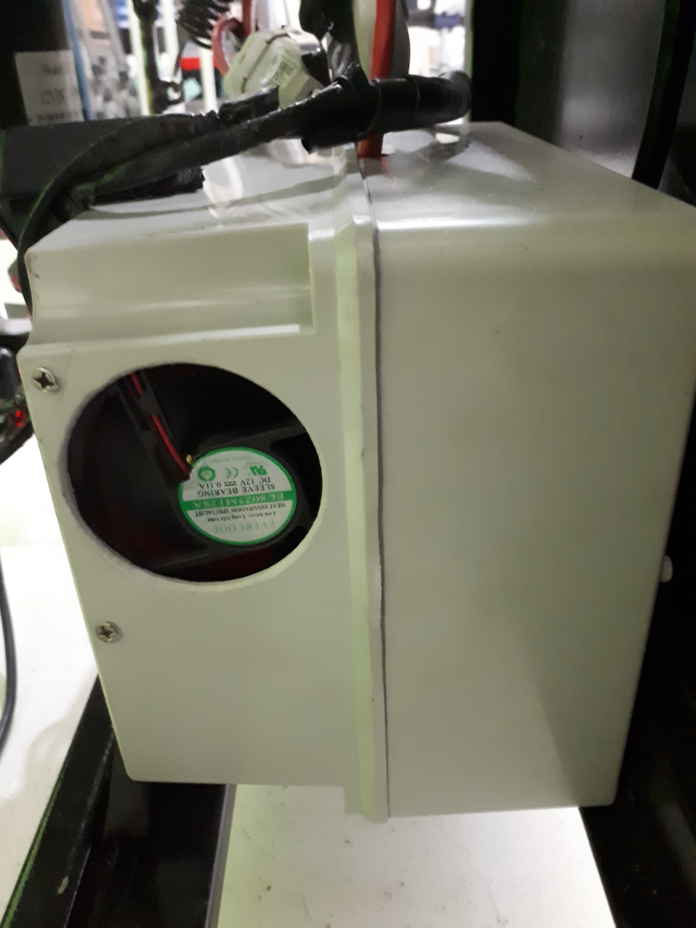

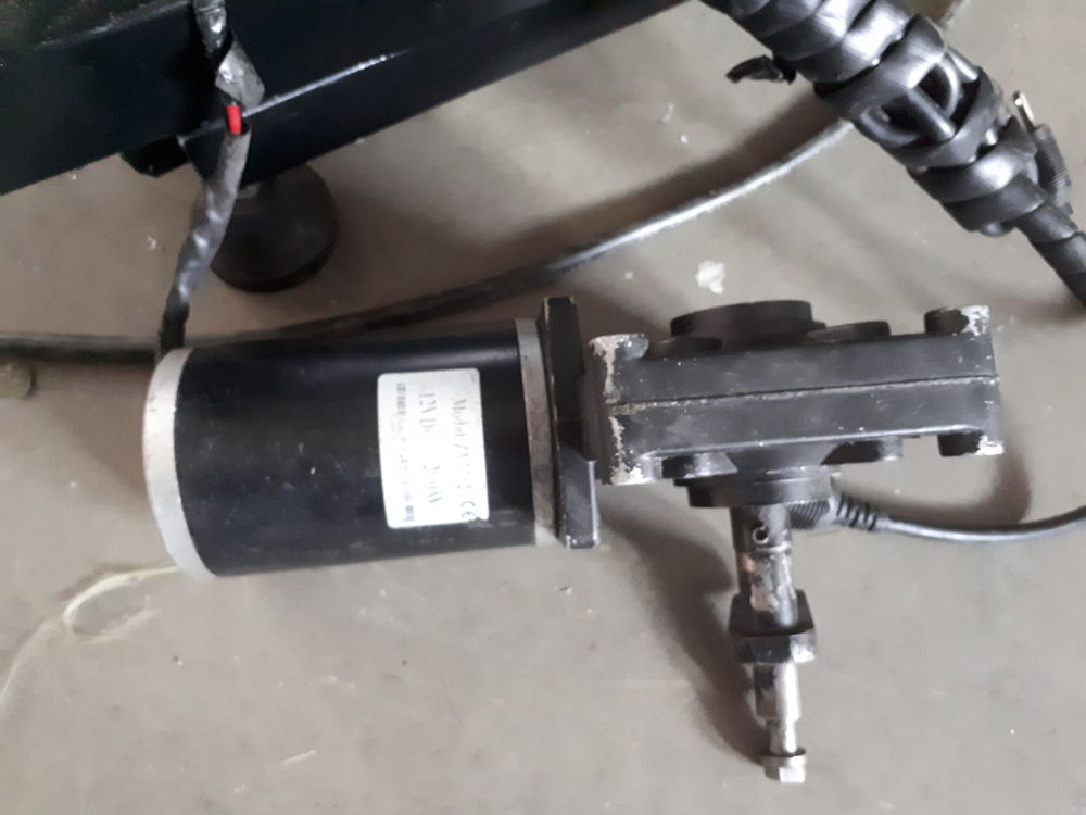

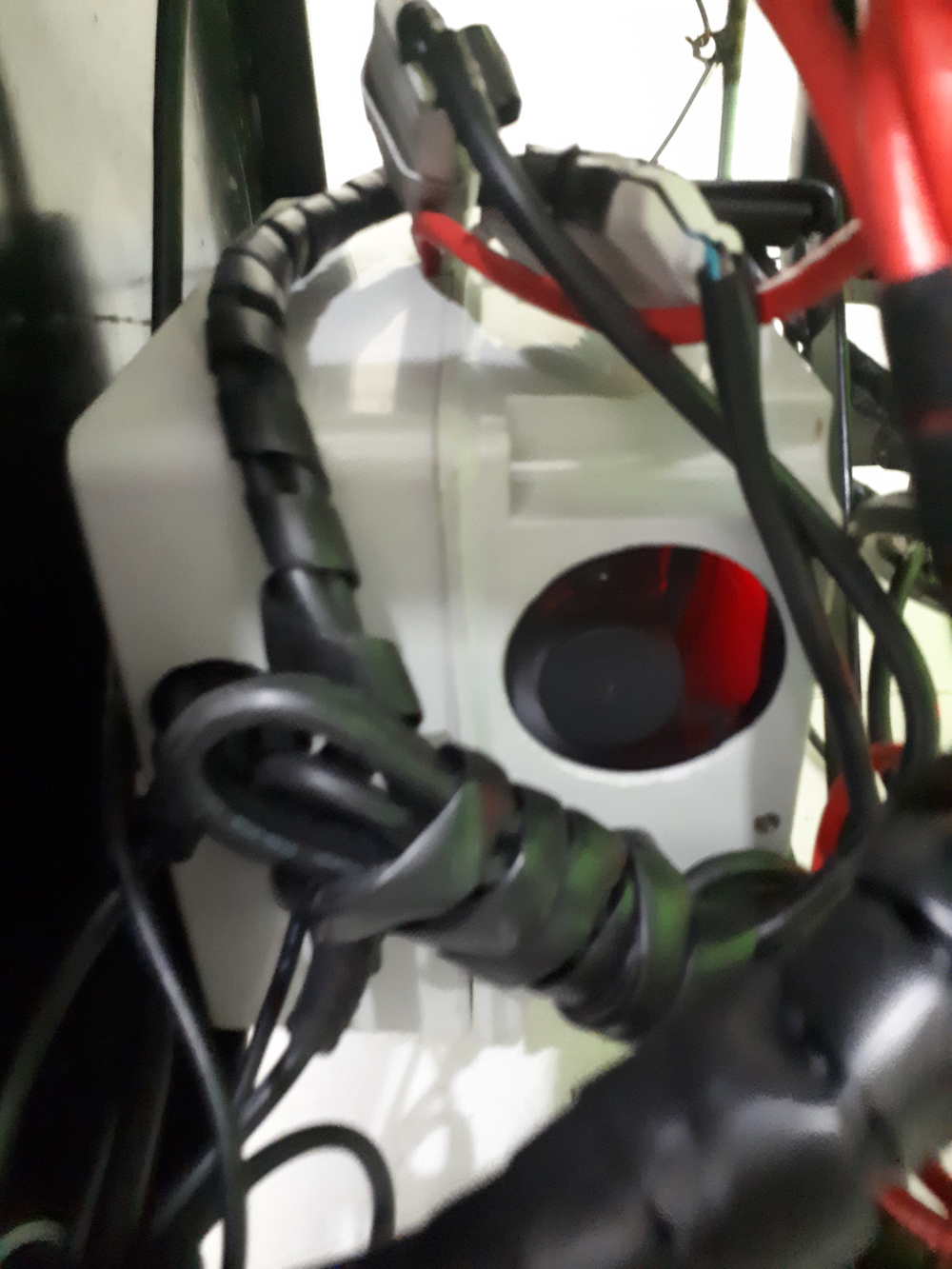

    Hey Ricardo, it's looking good! One thing I noticed though is that it looks like your power supply fan grill seems blocked and it doesn't look like you have any heat sinks or fans on your motor controllers. Those all may need some better cooling to keep from having thermal protection cut in. Or maybe you are already on all that and just aren't showing it in your photos. Have fun!

    I've been thinking about that, I decided to put these CPU coolers I've been here for a long time and they're working perfectly well on the engines like in the images below.

    Sorry I did not understand your question but here are some pictures of the ventilation system I made for the 12V, Arduino and Ibt_2 source. I put 2 coolers one pulls the air in and the other removes it.
