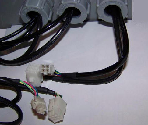

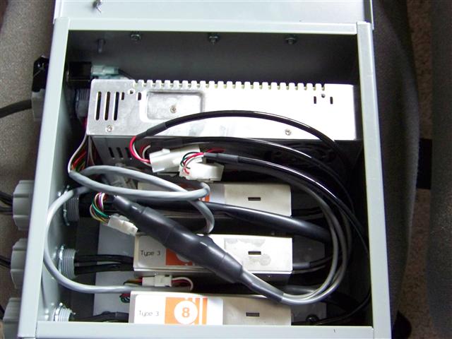

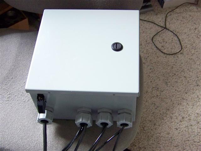

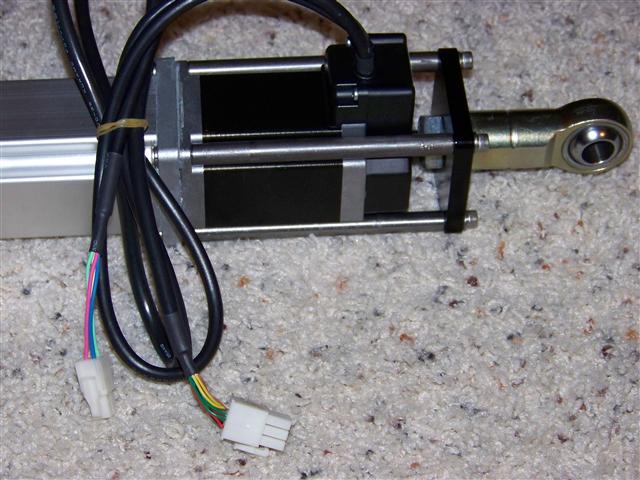

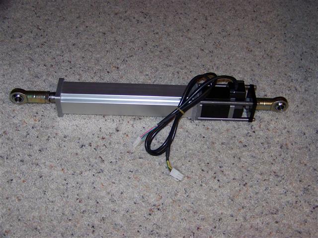

    You mean these actuators? To me it looks like three off the shelf SCN6 actuators, an off the shelf power supply, and off the shelf RS485 adapters stuffed into an alarm box from the outside of a house. X-Sim even detects them as SCN6 actuators! Tell us the specs of these actuators and how they are “customized” that make them worth thousands of dollars more than buying the SCN6’s directly from simxperience

    To be honest, they pretty much look like SCN6, just with bigger stepper motor.
    Perhaps Bernard could ask Mirai how much they would be for us.
    Well, I guess X-Sim compatiblity is no issue then ;P

    From the photos, they look like plain old SCN6 actuators with a bolt on 4-post mounting bracket, but not the faster 020 series, they look like the slower 100mm/sec 050 series motors.
    I only stock the 150mm SCN6-020 and 300mm SCN6-020. The 040 series only has more power at very slow speeds, so I don't think it is cost justified for simulation. The 050 series is out of the question due to the slow speeds.
    I'll invstigate other motor options that can be bolted on to the SCN6 but I really don't think that's what we're looking at here.

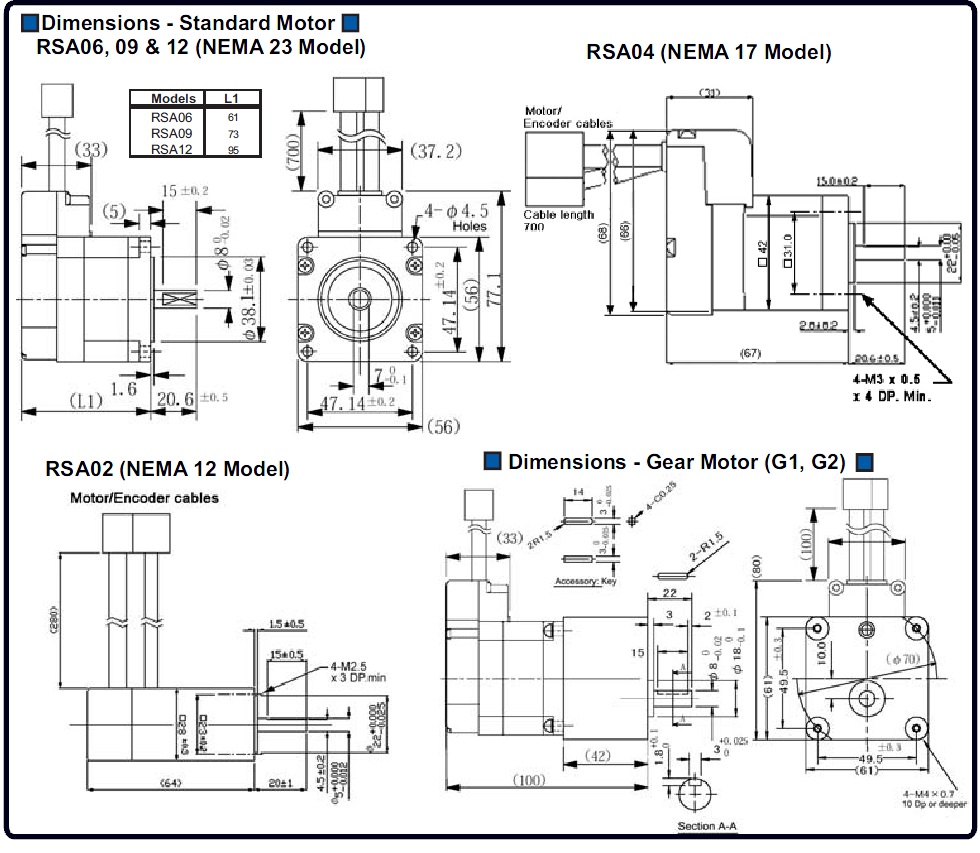

    Each of the Dyadic SCN6 actuators uses a different stepper motor. The motor numbers and the cooresponding actuators they are used on are as follows:
    RSA06: SCN6-020
    RSA09: SCN6-050
    RSA12: SCN6-040 & SCN6-060
    Each of these motors has different dimensions. Based on the dimensions shown, the picture above shows a 150mm SCN6 40kgf model with the standard RSA12 motor. I'll need to get some more comparitive pics before I can say for sure but I would appear to me to be a debranded SCN6-040-150.
    The one things that's for certain is that a standard SCN6 can suit the needs of Roadster. Also, please not that the speed and thrust of the more cost effective 020 series is nearly identical to the more expensive 040 series until the speed drops below 125mm/sec I personally think that a racing simulator should at least he achieving 200mm/sec to properly reproduce road surface, so the 020 series will make more sense if your sim design is optimal.

    532Coins
    hi bernard,
    the diagram from the scn6 on your side say the 20 and the 40 scn6 have the same speed and
    under wight the 40 are faster.

    You are correct Nima. THe point I was making is that the SCN6-020 and SCN6 040 perform almost identically between 125mm/s and 200mm/s speeds. The 040 shows its additional strength at speeds between 0 and 125mm/s. The 040 is more expensive, so I am suggesting that for many sim builders and sim designs, that the 020 may be a better choice.
