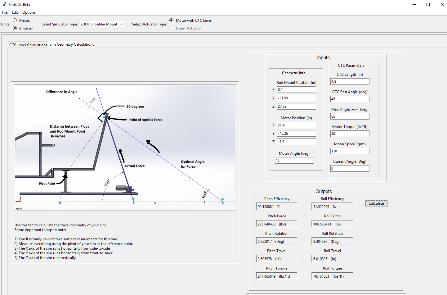

    Finally got the chance to try out 2.0 on the rig. I can't tell if it's placebo or somehow the new software outputs motion data with less latency than the old one, but it feels more responsive (I don't know if @yobuddy can comment on this or not).
    I've also got a rough prototype GUI of the calculator app in progress. It's coming slowly now that I'm back in school and have work. but it's coming along. The math for the geometry calculations is proving to be much more complicated than I thought it would be :confused:

    Some quick updates. University this semester is proving to be absolutely brutal, so progress has been slow. I've gotten some good work done on the calculator though, and all of the underlying math and programming is done. I just need to make some diagrams, improve robustness, test to make sure that all of the calculations are returning reasonable results, and find out how to turn a script into an executable, then I should be good to release a test version :confused: (these always seem to be way more work than they seem like they should be).
    As of right now, it's capable of calculating pitch and roll efficiency, total sim travel both linear and angle, pitch and roll force at the rod mounting point, and equivalent pitch and roll torque at the pivot point. Once I get a beta version out I'll move this to its own thread.

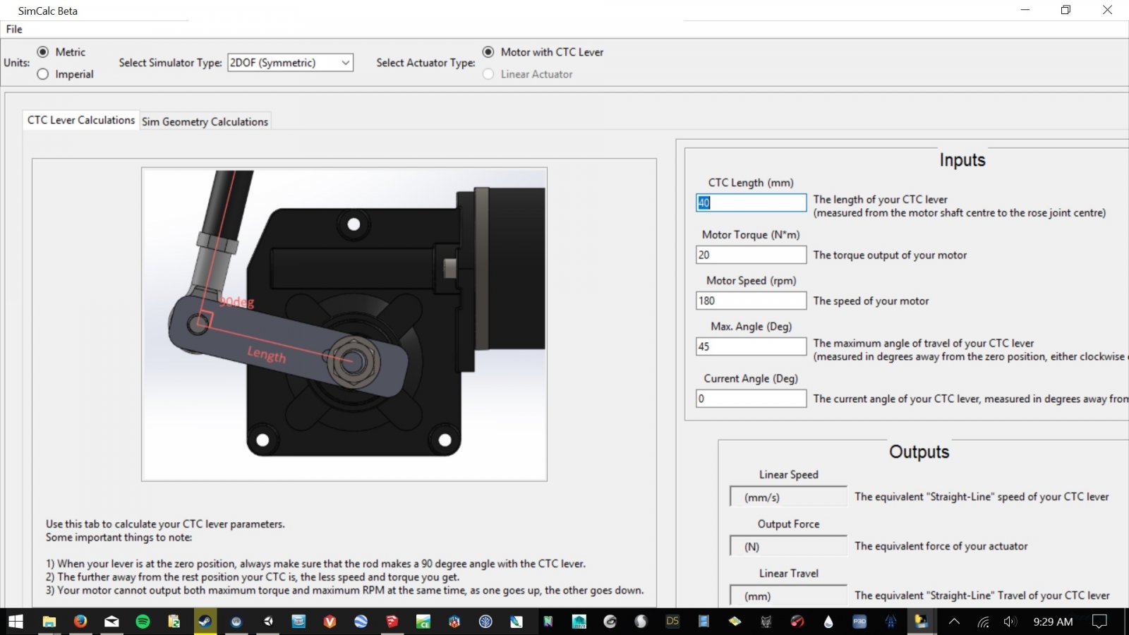

    Alright, doubts be damned, I think I can give you guys what I have so far, it seems to be spitting out reasonable results as far as I can tell.
    Obligatory warning: Take everything that this tells you with a LARGE grain of salt. There may still be bugs in the calculations, this is still a very early version of the software. I'm not responsible for any mistakes that you may make. If it spits a number at you that makes no sense, go with your gut. Please feel free to message me if you find any bugs/things that could use improvement:

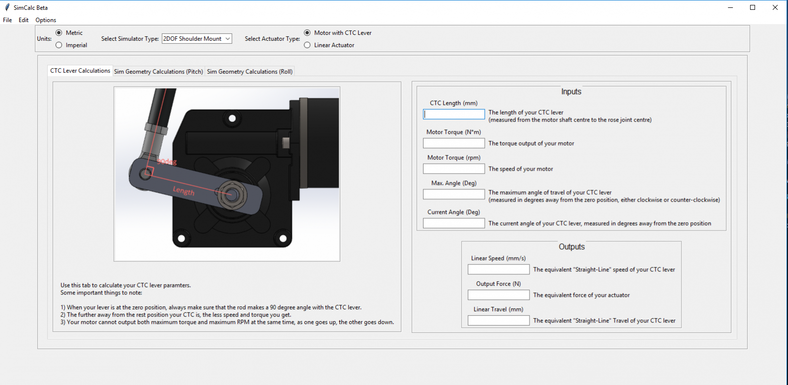

    I have an issue where the program canvas is not rescaling.
