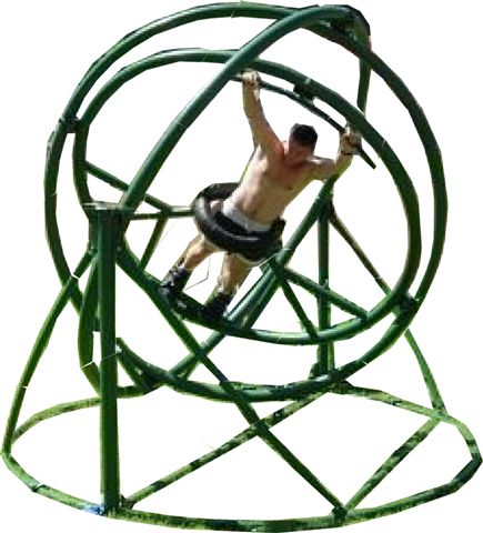

    Check out this design - I think it might be more suitable for your 360° project:
    viewtopic.php?f=52&t=2424&p=23827&hilit=#23827
    Well, once you have 360° working, you'll have ideas for improvements for sure ;D

    Watch my video of my creation on YouTube it might help you it is as three axis 360 degree rotational motion and human flight simulator and read the description.

    These guys did it for right under 11k usd.....
  12. noorbeast
    21,723
    152,051Coins
    +11,063 / 56 / -2
    Super dangerous testing that without a seat and harness, but it is a good example of a DIY motion sim based on pretty typical 360 degree design.
  13. SeatTime
    2,573
    Dangerous is that guys middle name.:D More of a carnival ride than a sim ( and I could see plenty of that in the background).

    But it has vertical rotation rotation only on one position and all three axis doesn't move at the same time in a synchrinised movement and it looks to me that it has hydro motors instead of servo motors.
