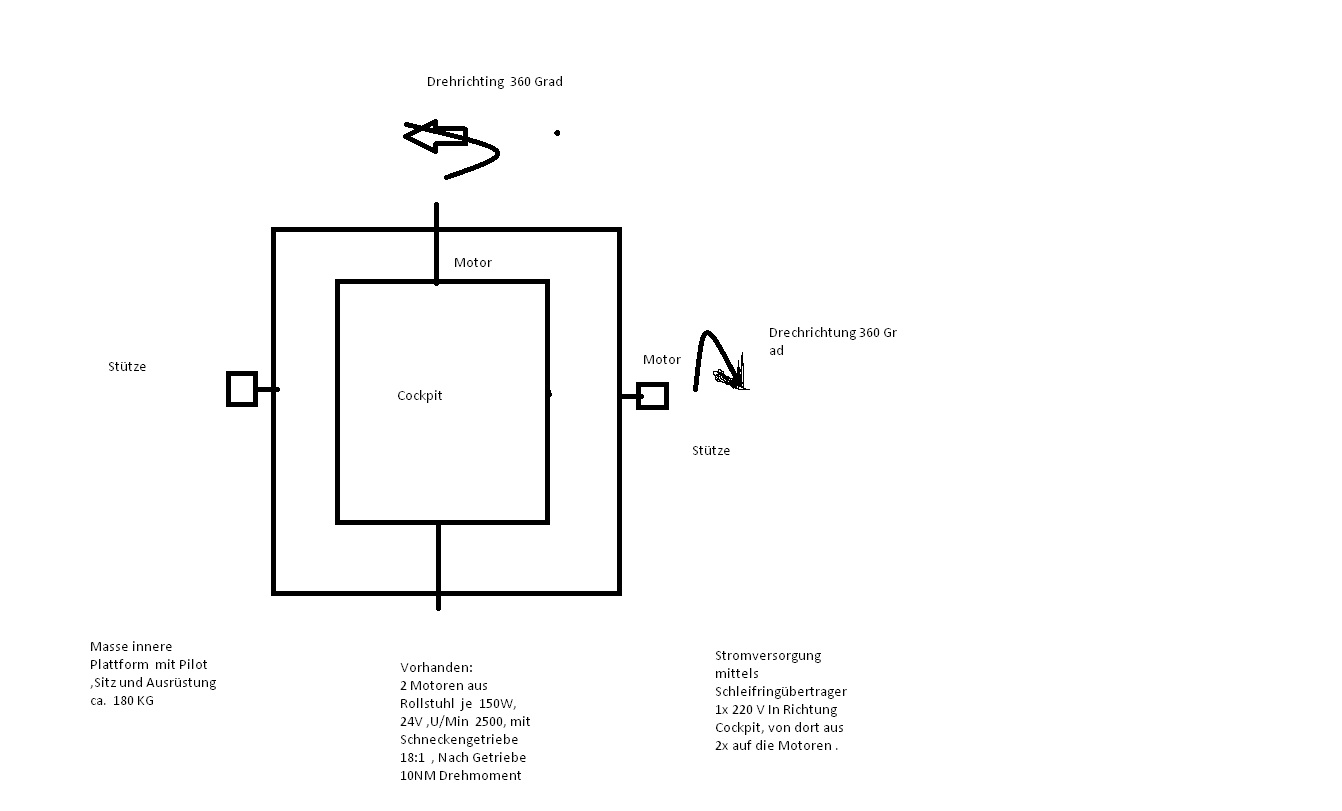

    OK to make it easier to build, I changed my globe design to a square one, like Menix's. Here's a mockup:
    And here's an animated GIF from a different angle, to help everyone's imagination:
    The squares are all perfect, and the cockpit is a cube, which should make it possible to maintain a stable centre of gravity. Of course, this kind of thing is easy to model, but maybe not so easy to build. I can see how this could end up being a really gigantic machine, if I'm too generous with cockpit space.
    What do you guys think? Now that I've drawn it out, does it seem more feasible?

    My machine is about 1,8m x1,8m
    and 1,8m in height but i only have 2 Axis for the first Time pitch and roll
    its easyer to build and lower costs

    Looking at this construction, as to me, one of the main problem is connecting the cables to the inner frame... so it could have full rotation, not a limited angle.

    This is going by using Sliprings

    In theory it looks nice and easy for sure. You will need powerful motors to move all that mass at a reasonably realistic speed and the frame has to be strong enough. With only the 3 rotational axis I think it is doable, once you start adding the 3 linear axis things will get much more complicated.
    How much are you planning to spend?
