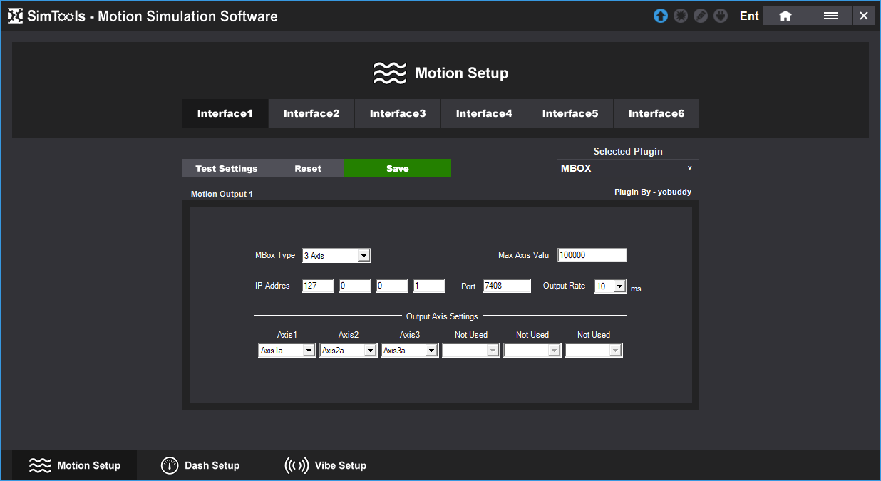

  4. Blastertoad
    Blastertoad Member
    Nov 21, 2023
    59
    372Coins
    +7 / 0 / -0
    3DOF, AC motor
    The issue with parking is it doesn't help when testing interface. If test interface had an initial position enum or initial axis value field so you could set initil test axis values -100 - 100 that then lerp 0. Just like if axis is not zero and you stop testing they lerp to 0 currently
    Passcode is second set of bytes. 55 aa 00 00 where 00 00 is pass code. I reprogramed my passcode to 00 00 for testing but that is preventing me from setting other variables. Would be nice to have passcode var instead of requiring programming hardware to match 00 00

  6. Blastertoad
    Blastertoad Member
    Nov 21, 2023
    59
    372Coins
    +7 / 0 / -0
    3DOF, AC motor
    Just using packet sniffer I figure "Max Value" var will rest somewhere between 260000 and 300000. However It is very violont and hard on the rig when it jumps to center when datar starts from test interface so I havent tested on hardware yet. Was hoping to talk you into lerp to center or start up command.
    Now that I can change vars a again I will try to find center ish for when servos power on and I can test from there. Will be trying some things in an hour or 2.

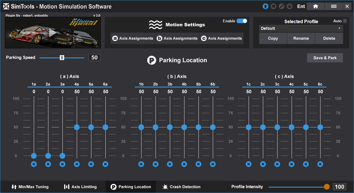

  7. yobuddy
    51,771Coins
    +5,206 / 19 / -0
    But interface testing is just to prove your setup is working, you would not ride interface testing or anything.
    To be honest, I thought both axis and interface testing have soft parking implemented, it's just soft startup that still needs added.
    If I hard code something in the interface plugin, then we can't use the soft start/stop in feature v3, as the sim is always centered.
    Please try running a game and see what happens, it should slowly center before and after a game.

  9. Blastertoad
    Blastertoad Member
    Nov 21, 2023
    59
    372Coins
    +7 / 0 / -0
    3DOF, AC motor
    Thanks looks great. Installed fine after I manualy removed old again and restarted simToolss pre and post install.
    Got an output issue somewhere between axis value 25 to 35 and same -25 to -35.
    I am moving just axis1a and watching its value. Sweeping 25 -35 I am seeing axis hex
    00 02 f5 47
    00 02 fb 1a
    00 00 03 ed
    00 03 06 c1
    So the piston is hovering above mid point, then drops out and jumps back when sweeping 25 - 35 range. Again this behavior is also mirrored on -25 to -35
    Edit: Data ouput update. Max Axis Value Var = 298250 output:
    Axis value 31 = 00 02 fb 1a
    Axis value 32 = 00 00 03 ed
    Axis value 33 = 00 03 06 c1
    Found my happy max with variable Max Axis Value being 298250 corresponding to 00 04 8d 0b at axis 100. At 29900 I can hear it bottom out when I max output. At 298500 I can just get it to hit when driving hard from 50 to 100 axis value.
    Passcode variable send incorrect info but turns out to be unnecisary. Value of 3721 sends hex 0e 89 instead of 37 21. However interface hardware is happy to play axis position with no password and just supplying 00 00. So the complication of sending a passcode can be ignored.

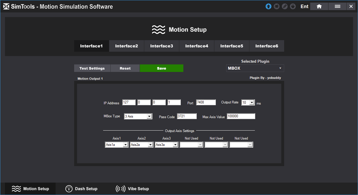

  11. velik0ff
    velik0ff New Member
    Aug 26, 2023
    12
    85Coins
    Do not confuse config password with access password, sending 00 00 in the request is the access password and FN 008 is the config password which should be 3721 unless you want it to be something else.

  13. yobuddy
    51,771Coins
    +5,206 / 19 / -0
    Ok, I edited the passcode out.
    Let see if that changes anything...
    (File Removed)

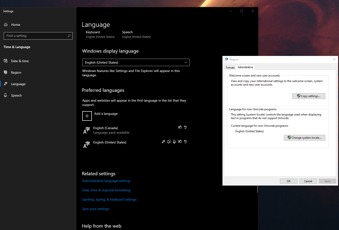

  14. yobuddy
    51,771Coins
    +5,206 / 19 / -0

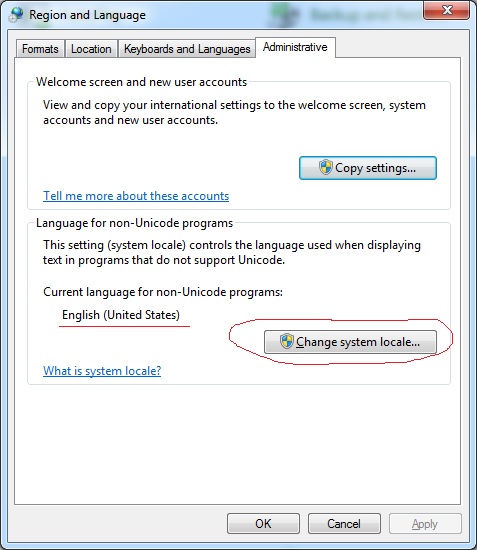

    Let also make sure there is not an extended ascii problem.
    Do you still get the wrong output if you set your pc to?
    Getting closer! :thumbs
  15. Blastertoad

    3DOF, AC motor
    Already set as Eng US on win 10
    Latest plugin update works great, at least for 3 axis, i cant test 6. Still has drop out on specific values listed in previous post.
