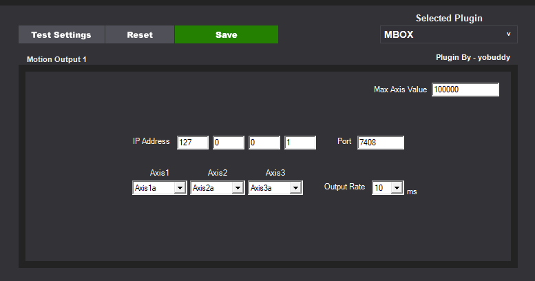

    Well I thought I would give a proper MBox interface a shot for v3, anyone want to test it out?
    Simply drag-drop it into SimTools v3
    Max Axis Value is the max number that will be send to the MBox.
    (We might not need this as the end of the day, but I'll add it in just for some testing)

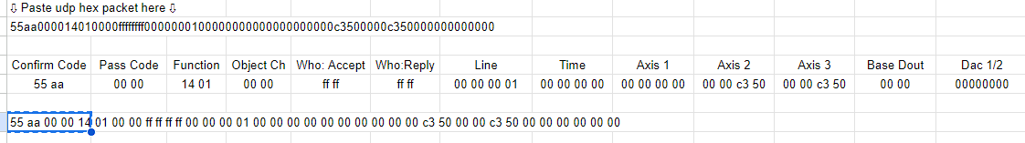

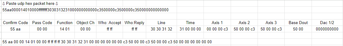

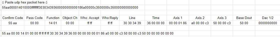

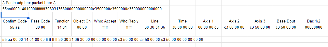

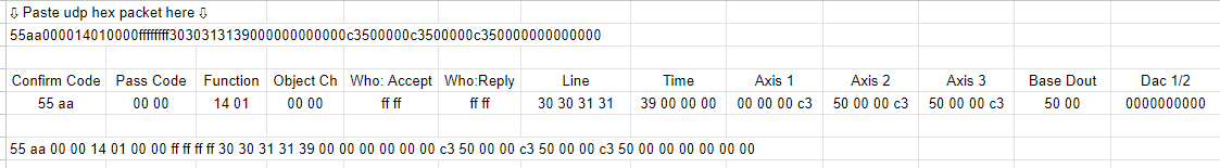

    Sorry for delay, I put a sheet together to parse hex value.
    Default settings outputs : 55 aa 00 00 14 01 00 00 ff ff ff ff 30 30 31 36 30 00 00 00 00 00 00 c3 50 00 00 c3 50 00 00 c3 50 00 00 00 00 00 00
    There is data in Line that I dont know what it does if anything. Axis 1 barly driven at all, axis 2 -3 are way over driven and error out. Looks like whatever is filling Line or Time is pushing data over by 4 chars

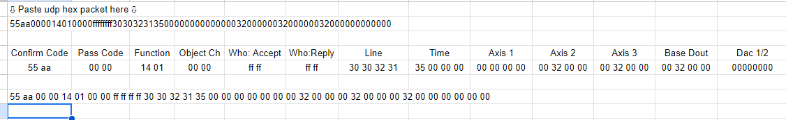

    Here is what output looks like if I use "Max Axis Value" of 100 instead of 100000
    55 aa 00 00 14 01 00 00 ff ff ff ff 30 30 32 31 35 00 00 00 00 00 00 00 32 00 00 00 32 00 00 00 32 00 00 00 00 00 00

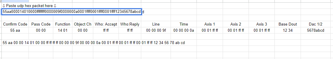

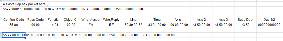

    Sorry I had an error in my sheet. Here is output from v2. Axis is still shifted so axis 1 is empty
    55 aa 00 00 14 01 00 00 ff ff ff ff 30 30 30 32 34 31 00 00 00 00 00 00 c3 50 00 00 c3 50 00 00 c3 50 00 00 00 00 00 00
    In comparison here is what I am getting with our workaround from yesterday
    55 aa 00 00 14 01 00 00 ff ff ff ff 00 00 00 9f 00 00 00 0a 00 01 ff ff 00 01 ff ff 00 01 ff ff 12 34 56 78 ab cd

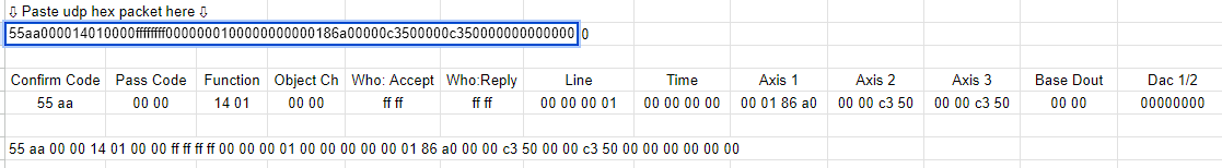

    This is a test with v3 and setting axis 1 to 100
    Output starts off length 39 bytes, axis values pushed 1 byte :
    55 aa 00 00 14 01 00 00 ff ff ff ff 30 30 34 39 36 00 00 00 00 00 01 86 a0 00 00 c3 50 00 00 c3 50 00 00 00 00 00 00
    Then moments later becomes 40 bytes in length and axis value pushed 2 bytes:
    55 aa 00 00 14 01 00 00 ff ff ff ff 30 30 34 31 30 30 00 00 00 00 00 01 86 a0 00 00 c3 50 00 00 c3 50 00 00 00 00 00 00
    I suspect this change is time value as you mentioned setting line to static.
    Since we are using relative timing mode ( function code 14 01 ) time value can be set as "00 00 00 XX" where XX is a 8 bit value representing output rate in ms. Note my previouss testing supplying static "00 00 00 0a" for 10 ms rate.2.

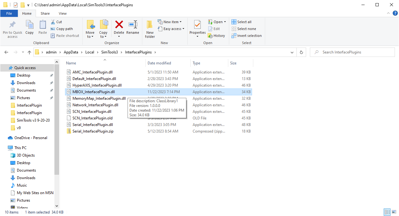

    "%LocalAppData%\SimTools3\InterfacePlugins"
    Then delete the "MBOX_InterfacePlugin.dll" file
    Then restart simtools v3, and reinstall the last plugin above (test version 3).
    (I bet you get different results doing it this way)

    Ok manualy removed MBOX plugin while SimTools was closed. Dragged v3, nothing, no prompt. Dragged v2, no prompt, dragged v1, install plugin prompt popped up.
  11. Blastertoad
    Blastertoad Member
    Nov 21, 2023
    59
    372Coins
    +7 / 0 / -0
    3DOF, AC motor
    Seems to be a naming issue if zip does not match name of .dll
    I redownloaded "MBOX_InterfacePlugin_v3.zip", dragged over and nothing. Renamed to "MBOX_InterfacePlugin.zip" and get the plugin prompt

    V3
    Output
    55 aa 00 00 14 01 00 00 ff ff ff ff 00 00 00 01 00 00 00 00 00 01 86 a0 00 00 c3 50 00 00 c3 50 00 00 00 00 00 00
    Line and time are static. Axis are staying within thier windows, Length is good at 38 bytes. Since the axis values are low I am going to power up my motors and test this.
