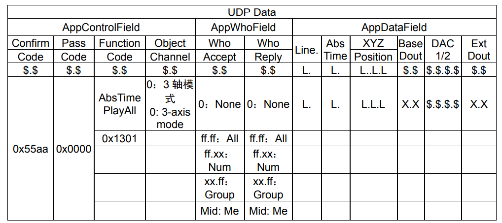

    UDP protocol:
    Spec
    3-axis relative time data
    Attached are a machine translated copy of SC-MBOX manual, and an english manual for integrated MBOX product that uses same interface. Credit @velik0ff for integrated MDBOX manual https://www.xsimulator.net/community/threads/dc-mbox-v2-software.18058/#post-241207

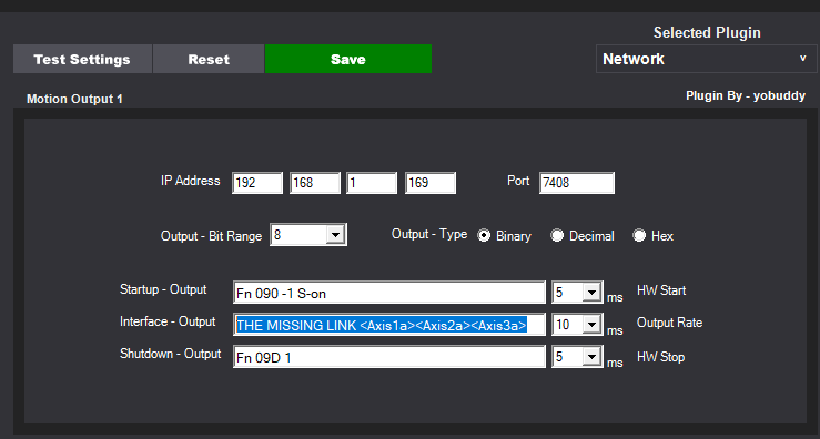

    Sim Tools:
    From what I have gathered this should be a simple enough setup in sim tools via network interface
    @pmneo provided startup and shut down commands which trigger SC-MBOX servo stop functions.
    Fn 090 -1 S-on enable
    Fn 091 1 stop behavior
    https://www.xsimulator.net/community/threads/how-to-interface-an-sc-mbox-v3.17113/#post-239226
    What myself and other searching members are now missing is the output string that will format SimTools axis data to the above spec. Any help with constructing the interface - Output string would be much apreciated.

    I think we just need to figure out what each part is.
    Like is the confirm code always 55aa?
    Is pass code always 0000?
    Object counter is probably static at 0000 for 3 axis mode?
    Line looks like a packet counter?
    Once we identify all the pieces, I bet i could modify the network interface to do what we need to.

    All examples share same opening confirm code. Passcode is user set, default on hardware = 3721 ( listed as handshake pascode in initial post ). Function code is setting 3 axis. Object channel is for reading or writing memory Fx channel for functions / setting, Dx for diagnostic or feedback data. Since we are not changing memory this stays empty "00 00". Who entries "ff ff" seem to be if interface should listen and if it should reply back and for handling daisy chained interfaces to accomodate more axis. Note sure about line. It changes based on time mode function code but has no explination in docs. Abs time is time to reach target, since sim tool is constantly broadcasting this could probably be set to baud rate using relative mode and then do smoothing in simtool. The Dout and Dac fields are not explained in the manuals however the values stay the same in every example so should just be left as is. Dout has something to do with breaking resistance and surge protection.
    Info taken from pages 28 - 40 ( ethernet protocol section ) of MD-BOX document. Matches other manual however since MD_BOX doc is native english I trust it more than machine translated doc.

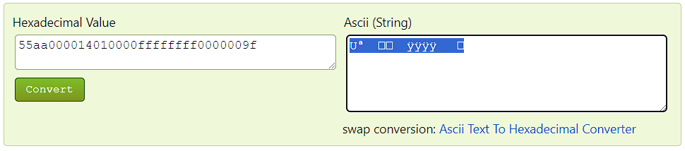

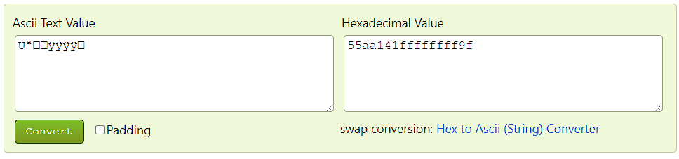

    Hit a brick wall. Was trying to make interface string with a hex to ascii converter so that the whole data line could be pre filled with just axis being variable. Not human readable but promising as packet sniffer showed it was sending parts of the converted data
    The blocker to this potential solution is that the input field does not accept null characters ( hex 00 ), not even when manualy typed ( Alt+00 ). This lead to malformed data.
    Null character persist when copied, this was confirmed by pasting converted string into Notepad++ that support null characters.
    @yobuddy If the network interface input fields could be modified to allow ascii null characters this could be a solution for supporting this interface.

    Possibly even better solution would be modified network plugin that would transmit raw hex as entered in fields instead of converting field to hex.
  8. yobuddy
    5,167
    48,248Coins
    +5,038 / 16 / -0

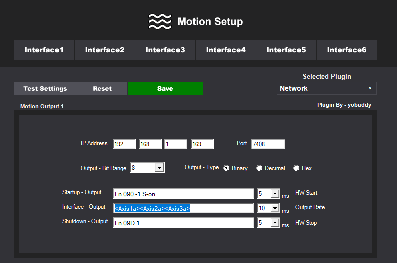

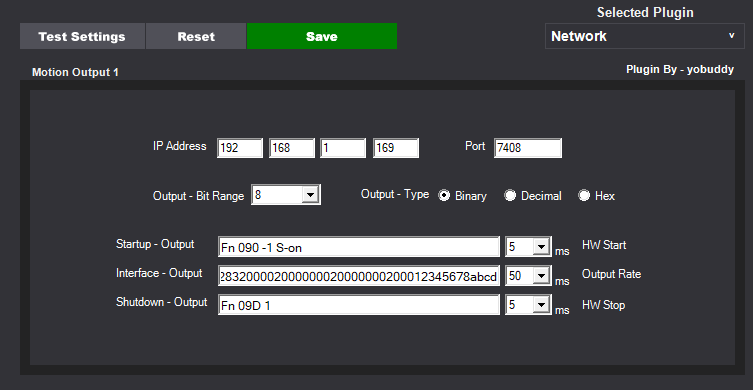

    Whatever you type on the line gets sent, only the stuff in the < > gets changed.
  9. yobuddy
    5,167
    48,248Coins
    +5,038 / 16 / -0

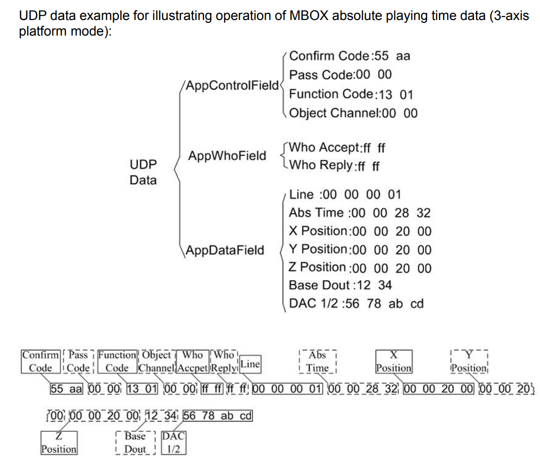

    What happens is you send this as a string?
    "55aa000013010000ffffffff000000010000283200002000000020000000200012345678abcd"
    If you put this as the interface output string in simtools it may do something.
    <85><170><0><0><19><1><0><0><255><255><255><255><0><0><0><1><0><0><40><50><0><0><32><0><0><0><32><0><0><0><32><0> <18><52><86><120><171><205>
    You wont be able to convert hex to ascii as a lot of asc chars are not printable to the screen.
    What the line above does, it tells simtools to look of the ascii chars for each integer between the < > and send that in place. notice 55 is <85> and aa is <170> and so on.
    Wire shark shows data value of:
    55aa372120313420303120303020303020666620666620666620666620303020303020303020396620303020303020303020363420ce207f207f203132203334203536203738206162206364
    Wireshark udp hex packet:
    55 aa 37 21 20 31 34 20 30 31 20 30 30 20 30 30 20 66 66 20 66 66 20 66 66 20 66 66 20 30 30 20 30 30 20 30 30 20 39 66 20 30 30 20 30 30 20 30 30 20 36 34 20 ce
    20 7f 20 7f 20 31 32 20 33 34 20 35 36 20 37 38 20 61 62 20 63 64
    No responce from interface, continues to sit with display reading "rEADY"

    Packet output
    55 aa 00 00 13 01 00 00 ff ff ff ff 00 00 00 01 00 00 28 32 00 00 20 00 00 00 20 00 00 00 20 00 20 12 34 56 78 ab cd
    That update is damn close. Has an aborant 20 though. No responce from interface. I have it sitting on my desk for testing, woudl take me just 10 min to throw it back in rig if we can get the sample output 1 to 1

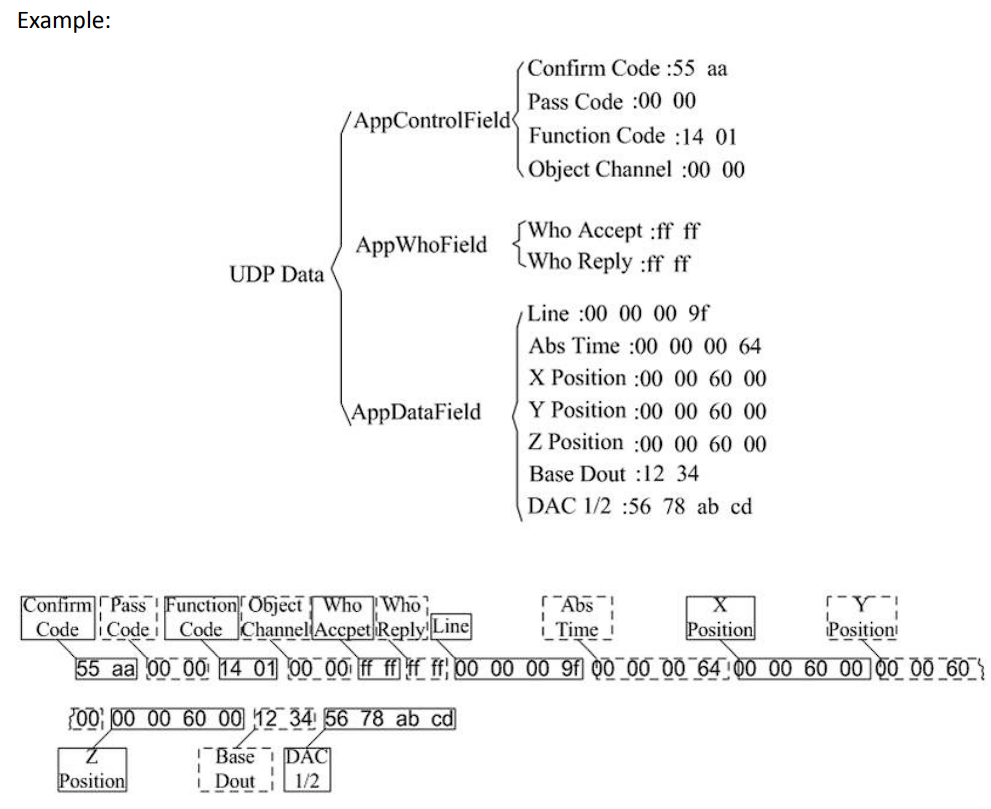

    Ok there was a typo that you transposed. I converted the relative 3 axis input into hex as decimal char
    <85><170><0><0><20><1><0><0><255><255><255><255><0><0><0><159><0><0><0><100><0><0><96><0><0><0><96><0><0><0><96><0><18><52><86><120><171><205>
    which equals the sample
    55 aa 00 00 14 01 00 00 ff ff ff ff 00 00 00 9f 00 00 00 64 00 00 60 00 00 00 60 00 00 00 60 00 12 34 56 78 ab cd
    I reprogrammed my password to 00 00 ( FN 008 = 0000 )
    now I am getting a responce back from interface in wireshark.
    55 aa 00 00 00 00 00 00 00 00 00 00
    Going to look at doc to see what empty responce means. If it is not errored I will try replacing "<0><0><96><0>" with axis and see if formatting holds or I continue to get a responce.
    We are close, I can feel it in my sack!

    @yobuddy We got it, now just need to get axis values in range.
    So my feeling earlier was correct the relative time needs to match baud rate. I swaped 64 out for 10, set interface out to 10 and programmed baud rate to 10 and the platform moved. It was a very small movement but movement.
    I then replaced "00 00 60 00" with "00 00 Axis 00" and I could drive movement in hex and binary mode. Small movement though like 1" of my 7" travel slamming slider to max. The axis value varies between 1 and 2 pairs ( ff to ff ff ) puting axis line length out of spec so the axis output like "<0><0><Axis1a><0>" will not work. I then replaced all 3 axis lines with value args. Punched one piston to max and errored out controller.
    So now we just need to find a way to keep axis value to a 4 pair line.
    Code I used to launch a piston
    <85><170><0><0><20><1><0><0><255><255><255><255><0><0><0><159><0><0><0><16><0><0><Axis1a><0><0><0><Axis2a><0><0><0><Axis3a><0><18><52><86><120><171><205>
