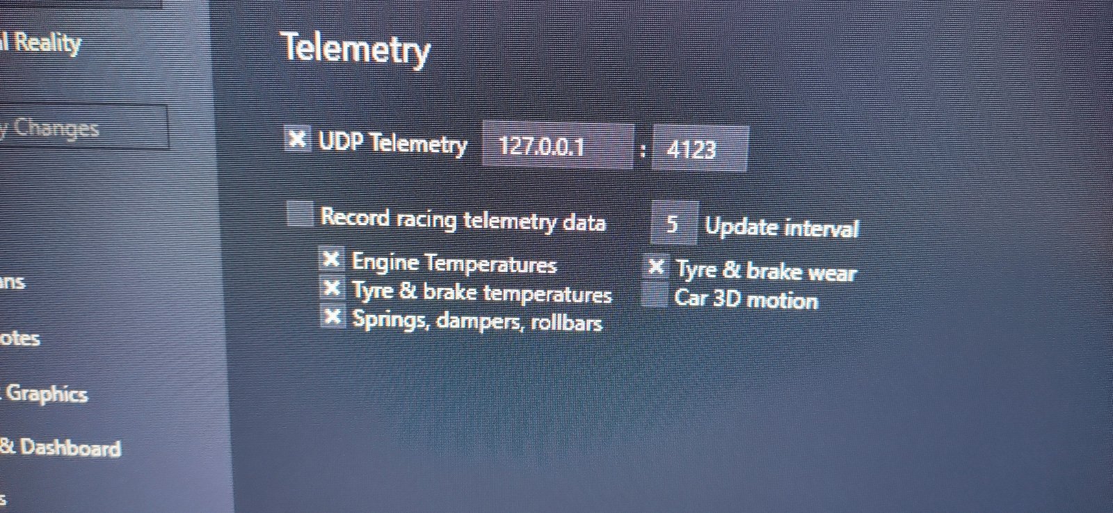

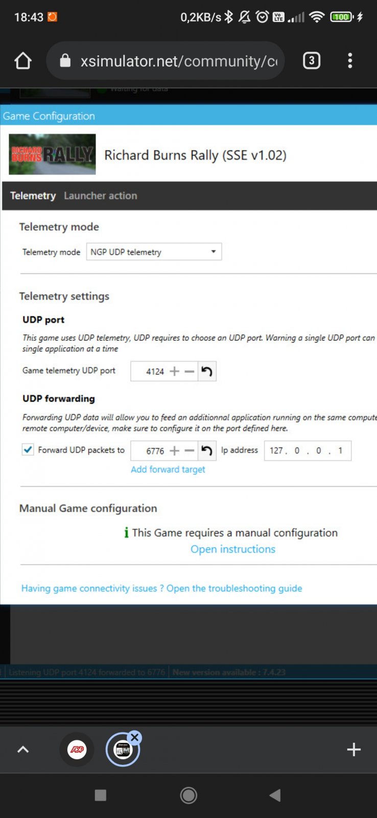

    Hi I have problem with simhub port forwarding. Due to long term testing and adding more simtools stuff I have noticed that I have my rbr configured in 4124 port but sim tools use 4123 and when I try set tuning center maybe this was reason why rbr not work properly. And then my problems starts again. Can't set simhub to work with sim tools. When I set in game port to 4123 and set udp relay in simhub to 6776. Simhub doesn't work. But when I set in game port to 6776 and in simhub to 6776. Sim tools working but simhub doesn't!!!! Maybe some port issue? When don't start simtools simhub work. Someone have multiple devices in rbr using udp and simhub?

    This in game port 4123 in simhub like this but there is an error this 4124 means 4123 :p

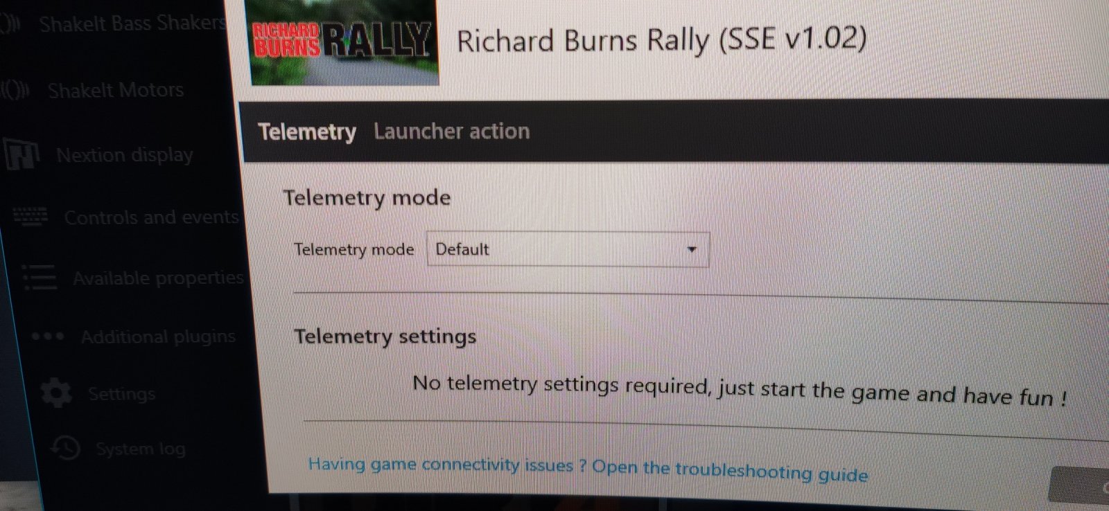

    First i wanna thank you for your time and work. Now I solved this. Sim hub problem. After reinstalled everything working fine. The best thing was that all others game was working normal, only rbr not. Now it's working without any configuration :)
    On pics : game config, simhub config

    SOLVED DEFINITELY!!!!!
    FOR ALL PLUGINS (Pro, rsf)
    In ini file or launcher DON'T NEED to set 4123 port. Game don't sent Ngp telemetry to simtools. It use its own sygnal from 4123 port so if u use UDP telemetry send it will be conflict or sygnal muffed
    It's crazy but after year of play I start playing rbr correctly now!!!!
