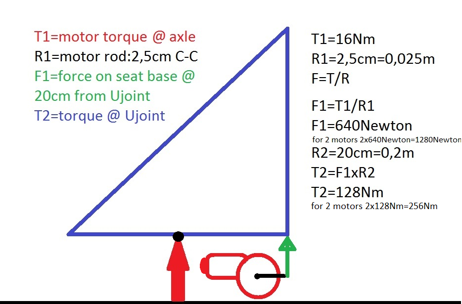

    This is how my design works.
    EDIT R2=the distance from u-joint to the green arrow(rose joint mounting point).

    Bad idea on design, motors have to work hard to overcome and lift weight.
    The higher you get the motors to connect about the centre of gravity or above, rule of thumb is about your belly button, the less difficult the motors have to work.
    Shoulder mount is overall the best, then desk racer because of the mounts higher than the bottom of the frame.
    People of experience talking here.
    However, feel free to build how you like.

    You all say that its easier for the motor to work once we increase leverage distance.
    I dont disagree with that. I cant. It is a fact.
    ...in fact this is what i used to multiply my motor torque from 16Nm to 128Nm on the seat...as i explained with the previous design(20cm:2,5cm=8:1 leverage).
    But this fact alone doesnt make a design all-around efficient. There are more factors involved than torque alone.
    Noone refers to the fact that by increasing the leverage distance you decrease the overall seat deviation from the center position( as well as the seat's angular speed).
    I dont doubt anyones experience. I built my sim studying your designs.
    Anyway, thank you all for your answers.

    You seem to be assuming that everything stays the same when it does not, other than the presumed weight to be moved.
    A Motion Dynamics motor has a shaft speed of 54rpm and requires a CTC at the motor of 25mm to move a weight of 120kgs with the given torque of 45nm then the linear velocity speed at which it will do so is 0.141372: http://www.endmemo.com/physics/rpmlinear.php
    A Motion Dynamics motor of the same specification placed further out requires less torque to move the given weight. So you can use cheaper 25:1 gearboxes that has a shaft speed of 128 rpm and can also increase the CTC. So at 128rpm shaft speed with an 80mm CTC the linear velocity will be 1.0723328, or just under 10 times faster. The cost is AU $108.96 per motor.
    What a compact design does is require more torque, which costs in terms of less responsive speed and more in purchase cost.

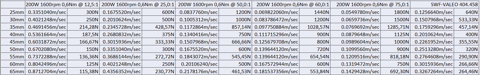

    The following info will be given with the purpose to provide some detailed info and bust some "myhts".
    A DIY (2dof) motion simulator is usualy built with DC motors coupled to wormgear custom or fixed gearboxes (one example is the car wiper motor)
    Some facts about brushed DC motors
    Pros
    DC motors are generaly cheap to buy
    DC motors are safe to power (12v or 24v)
    DC motors are easy to control with USB motion controlers with feedback (eg: arduino+hbridge or jrks)
    Cons
    DC motors require big currents to opperate (typicaly 1Amp under no load up to 30Amps peak max or even more than 100Amps peak max in certain applications)
    DC motors will generate noise (Brush arcing) causing electrical magnetic interference (EMI)
    Some facts about worm-gearboxes
    Pros
    Worm gears can give large gear(speed) reductions (eg 1600 motor RPM to 32 gearbox shaft RPM)
    Worm gears can generate big amounts of torque (eg 0,6Nm motor torque to 30Nm gearbox shaft torque)
    Worm gears opperate under low noise because they work under high ratios (low rotational speed)
    Worm gears are easy and cheap to maintain
    Cons
    Worm gears have an average efficiency of around 65%
    Worm gears have a high power loss
    Worm gears are not suitable for high speed rotation applications
    Worm gears are big sizes due to design limitations
    Lets start our example with the 200W 1600rpm 0,6Nm motor @12Volts.
    https://www.motiondynamics.com.au/2...nd-1600-3200-rpm-selectable-0.6nm-torque.html
    We can fit it with a variety of worm-gearboxes to customize our output
    https://www.motiondynamics.com.au/worm-drive-gearbox-to-suit-industrial-motors.html
    Remember that these gearboxes have less than 70% efficiency. But for the sake of simplicity we will do the calculations with 100% efficiency
    using a 75:1 gearbox we get 21,33rpm idle, 45Nm torque at the gearbox shaft
    using a 60:1 gearbox we get 26,67rpm idle, 36Nm torque at the gearbox shaft
    using a 50:1 gearbox we get 32rpm idle, 30Nm torque at the gearbox shaft
    using a 25:1 gearbox we get 64rpm idle, 15Nm torque at the gearbox shaft
    Using a 12,5:1 gearbox we get 128rpm idle, 7,5Nm torque at the gearbox shaft
    As a comparison,
    using a SWF-VALEO 404.458(SW2L) 24Volt truck wiper motor:
    http://www.smolka-berlin.de/onlines...cteur_24V_DC__Offre_sp%E9ciale%21%21%21_/4398
    74:1 fixed worm-gearbox) we get 48rpm idle, 16Nm torque at the gearbox shaft
    Lets see how things change when we fit our rods.
    All forces are calculated at 90 degrees (sin90=1)
    For smaller angles than 90 degrees just multiply with sine of relative angle.
    eg for 30 degrees multiply with sin30=0,5
    12,5:1 gearbox (128rpm, 7,5Nm) fitted with:
    25mm C-C shaft/rod gives 0.3351040m/sec linear speed and 300 Newton force
    30mm C-C shaft/rod gives 0.4021248m/sec linear speed and 250 Newton force
    35mm C-C shaft/rod gives 0.4691456m/sec linear speed and 214,28 Newton force
    40mm C-C shaft/rod gives 0.5361664m/sec linear speed and 187,5 Newton force
    45mm C-C shaft/rod gives 0.6031872m/sec linear speed and 166,67 Newton force
    50mm C-C shaft/rod gives 0.6702080m/sec linear speed and 150 Newton force
    55mm C-C shaft/rod gives 0.7372288m/sec linear speed and 136,36 Newton force
    60mm C-C shaft/rod gives 0.8042496m/sec linear speed and 125 Newton force
    65mm C-C shaft/rod gives 0.8712704m/sec linear speed and 115,38 Newton force
    25:1 gearbox (64rpm, 15Nm) fitted with:
    25mm C-C shaft/rod gives 0.1675520m/sec linear speed and 600 Newton force
    30mm C-C shaft/rod gives 0.2010624m/sec linear speed and 500 Newton force
    35mm C-C shaft/rod gives 0.2345728m/sec linear speed and 428,57 Newton force
    40mm C-C shaft/rod gives 0.2680832m/sec linear speed and 375 Newton force
    45mm C-C shaft/rod gives 0.3015936m/sec linear speed and 333,33 Newton force
    50mm C-C shaft/rod gives 0.3351040m/sec linear speed and 300 Newton force
    55mm C-C shaft/rod gives 0.3686144m/sec linear speed and 272,72 Newton force
    60mm C-C shaft/rod gives 0.4021248m/sec linear speed and 250 Newton force
    65mm C-C shaft/rod gives 0.4356352m/sec linear speed and 230,77 Newton force
    50:1 gearbox (32rpm, 30Nm) fitted with:
    25mm C-C shaft/rod gives 0.0837760m/sec linear speed and 1200 Newton force
    30mm C-C shaft/rod gives 0.1005312m/sec linear speed and 1000 Newton force
    35mm C-C shaft/rod gives 0.1172864m/sec linear speed and 857,14 Newton force
    40mm C-C shaft/rod gives 0.1340416m/sec linear speed and 750 Newton force
    45mm C-C shaft/rod gives 0.1507968m/sec linear speed and 666,66 Newton force
    50mm C-C shaft/rod gives 0.1675520m/sec linear speed and 600 Newton force
    55mm C-C shaft/rod gives 0.1843072m/sec linear speed and 545,45 Newton force
    60mm C-C shaft/rod gives 0.20106240/sec linear speed and 500 Newton force
    65mm C-C shaft/rod gives 0.2178176m/sec linear speed and 461,53 Newton force
    60:1 gearbox (26,67rpm, 36Nm) fitted with:
    25mm C-C shaft/rod gives 0.069822060m/sec linear speed and 1440 Newton force
    30mm C-C shaft/rod gives 0.083786472m/sec linear speed and 1200 Newton force
    35mm C-C shaft/rod gives 0.097750884m/sec linear speed and 1028,57 Newton force
    40mm C-C shaft/rod gives 0.111715296m/sec linear speed and 900 Newton force
    45mm C-C shaft/rod gives 0.125679708m/sec linear speed and 800 Newton force
    50mm C-C shaft/rod gives 0.139644120m/sec linear speed and 720 Newton force
    55mm C-C shaft/rod gives 0.139644120m/sec linear speed and 654,54 Newton force
    60mm C-C shaft/rod gives 0.167572944m/sec linear speed and 600 Newton force
    65mm C-C shaft/rod gives 0.181537356m/sec linear speed and 553,84 Newton force
    75:1 gearbox (21,33rpm, 45Nm) fitted with:
    25mm C-C shaft/rod gives 0.0549780m/sec linear speed and 1800 Newton force
    30mm C-C shaft/rod gives 0.0659736m/sec linear speed and 1500 Newton force
    35mm C-C shaft/rod gives 0.0769692m/sec linear speed and 1285,71 Newton force
    40mm C-C shaft/rod gives 0.0879648m/sec linear speed and 1125 Newton force
    45mm C-C shaft/rod gives 0.0989604m/sec linear speed and 1000 Newton force
    50mm C-C shaft/rod gives 0.1099560m/sec linear speed and 900 Newton force
    55mm C-C shaft/rod gives 0.1209516m/sec linear speed and 818,18 Newton force
    60mm C-C shaft/rod gives 0.1319472m/sec linear speed and 750 Newton force
    65mm C-C shaft/rod gives 0.1429428m/sec linear speed and 692,30 Newton force
    As a comparison,
    SWF-VALEO 404.458(SW2L) 24Volt truck wiper motor (48rpm, 16Nm)
    25mm C-C shaft/rod gives 0.1256640m/sec linear speed and 640 Newton force
    30mm C-C shaft/rod gives 0.1507968m/sec linear speed and 533,33 Newton force
    35mm C-C shaft/rod gives 0.1759296m/sec linear speed and 457,14 Newton force
    40mm C-C shaft/rod gives 0.2010624m/sec linear speed and 400 Newton force
    45mm C-C shaft/rod gives 0.2261952m/sec linear speed and 355,55 Newton force
    50mm C-C shaft/rod gives 0.2513280m/sec linear speed and 320 Newton force
    55mm C-C shaft/rod gives 0.2764608m/sec linear speed and 290,90 Newton force
    60mm C-C shaft/rod gives 0.3015936m/sec linear speed and 266,66 Newton force
    65mm C-C shaft/rod gives 0.3267264m/sec linear speed and 264,46 Newton force
    Not bad at all for a 35euro part.
    The above charts show that whatever we choose to do, there is a tradeoff between speed and torque.
    Now you can calculate the force you apply on your simulator.
    REMEMBER:
    All above forces are calculated at 90 degrees (sin90=1)
    eg for 30 degrees multiply with sin30=0,5 (the force is reduced to half)
    By multiplying the above force with the distance from the contact point to the center of rotation (radius from pivot point) you can then calculate the torque on the pivot point.
    This is important because every build needs different minimum torque values to be able to move the suspended weight as required.
    By feeding the values of:
    a)linear velocity (calculated above) and
    b)distance from the contact point to the center of rotation (radius from pivot point)
    to the calculator
    we can find our simulator RPM
    Then from rpm we can calculate both our angular speed in degrees/sec and linear velocity at our head point, so we can see if our simulator meets the desired minimum criteria to provide the experience we want.
    Be sure that your force (ie your rod-ends that transmit motion) is on a 90 degree angle (perpedicular) to the radius from the pivot point. If not then you have to calculate only the perpedicuar(to the radius) component of the force (multiply with sinus of angle).
    As you understand... the more your angle deviates from being perpedicular to the radius from the pivot point... the less effective it becomes.
    Lesson learnt:
    The maximum effectiveness of a rotational force is achieved by staying as close as we can to a 90 degree angle between the force and the radius from the pivot point.
    This is why it is suggested for shoulder mount designs to have the rods not vertical but at bigger angles.Because if the rods are vertical then the effective rotational force to the simulator is minimized and the stress/fatigue on the parts is maximised.
    many thanks to noorbeast for our discussion.
