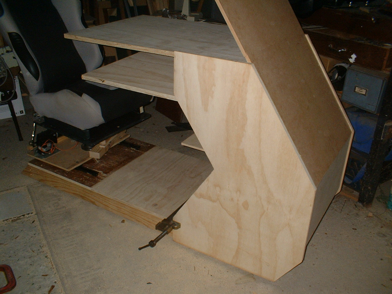

    No way @bsft This rig weighs a ton, it's built from mostly 18mm ply Construct3.JPG I've got 6 heavy duty castors under it and struggle to move it on the carpet, granted I am just a little past my prime (kidding) but I'll settle for 2dof.

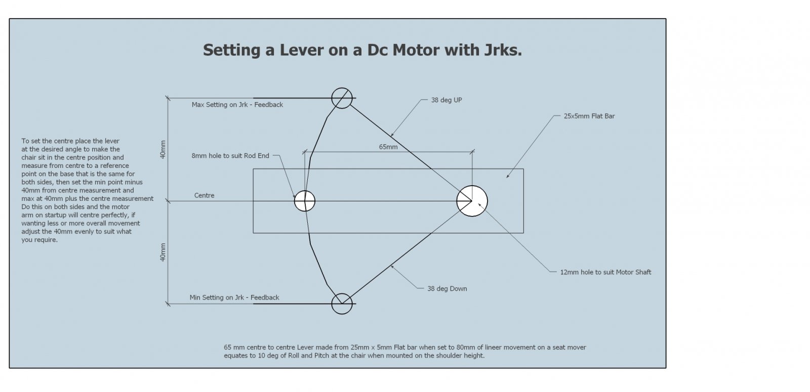

    The actuators I run are noisy mostly from bearings being worn out,, well the right hand one is, the left hand is noisy but not as much.
    As I got them for free, but had to re-motor them myself , I will use them.
    That being said , they move at about 250mm linear per second.
    I have also run a rear shoulder mount DC motor and JRK seat mover, and yes I agree with @Nick Moxley , they are faster and quieter. Mind you the larger DC motors and JRKs can run at 300mm to 500mm linear speed per second, loaded on a shoulder seat mover, with the right settings in the JRK and a lever of 40 to 65 mm CTC.
    @Rastus , my mistake, all the castor wheels you use to move it around, for some stupid reason I thought you were adding a drift frame. Nevermind.
  16. pipis2015
    pipis2015 over-boost
    Feb 18, 2015
    221
    Athens, GREECE
    10,248Coins
    +272 / 1 / -0

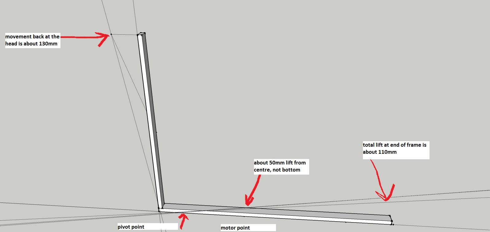

    How does this linear speed translate to (angular speed of) degrees per second in change of seat tilt angle?
  17. bsft
    Dunno! maybe @eaorobbie can explain further.
    All I know is that in the JRK utility program, there is a graph that allows us to measure how fast it goes from top to bottom. And then allowing for actually how far the lever travels, say 80mm up and down, you can estimate the actual linear travel speed.
    But remember, depending on design and motor placement, that 80mm travel at the motors can be more like 200mm travel at the head of the seat.

    Thats what i wanted to hear. I know its all a matter of personal preference but in my opinion there should be a suggested minimum head travel distance and a minimum head travel speed that ensure imersion.
    With such a suggestion new users could have a crude estimate on how their designs should be (before even going to theoretical calculations).
  20. Nick Moxley
    17,057Coins
    +2,507 / 30 / -2
    Problem with that is No all driver's are the same weight, Not all Setup's are Identical and not all user's want as much motion (at the head) as some users might want. Not One of us builder's said "i have to have X amount of travel out of my rig" We build it and tune it from there, And as you will soon learn, using 100% of 1 particular force, is NOT recommended.
