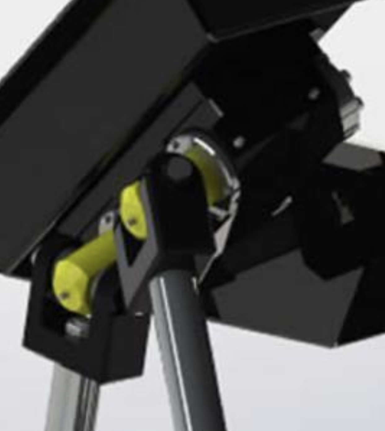

    Hello Matt thank you very much for your help,
    In fact even if the platform is 700kg, I think the weigh/force could be much more than 200kg but looking at professional 6gof that use U joint at the top, they look not so big compare to yours. What is the diameter of your needle bearing? do you have the spec of it ?
    Looking at the professional platform I see that the needle bearing diameter are approximatively the same diameter of the visible part of the rod end diameter, so for my platform should be around 3/4" diameter.
    I need to check how I could adapt my platform to replace rod end by U joint.
    My biggest constrain is the height of my garage where the platform is installed, ideally I should not extend the length of the current arm. So will have to shorten then as U Joint are longer that rod ends to keep the same total length.
    I do not have professional software for the design, I have I made all the design with sketchup from which I can import 3d model (or sketchup model) only .
    Can yo provide me a 3D model of your U Joint to see how I could build that on my current platform ? (I will send you a PM for this)

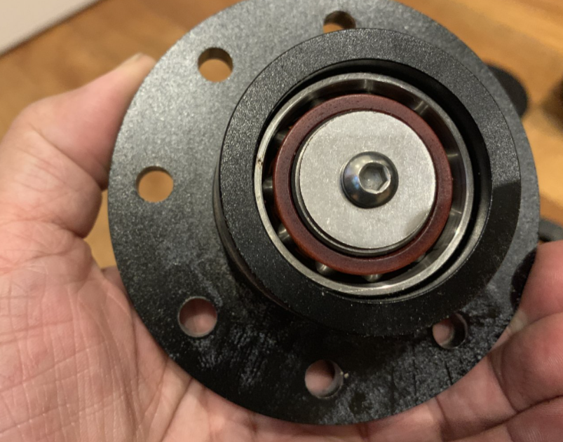

    3) I think there should be as well 2 x 360 bearing as in your picture here upload_2021-7-19_21-7-9.png

    Also my piston part of the actuator is able to rotate, so I don’t need 360 bearings on top or bottom. The image you show was the old top and bottom joint I used and I didn’t like it because it allowed the whole actuator to possibly spin at very obtuse angles.

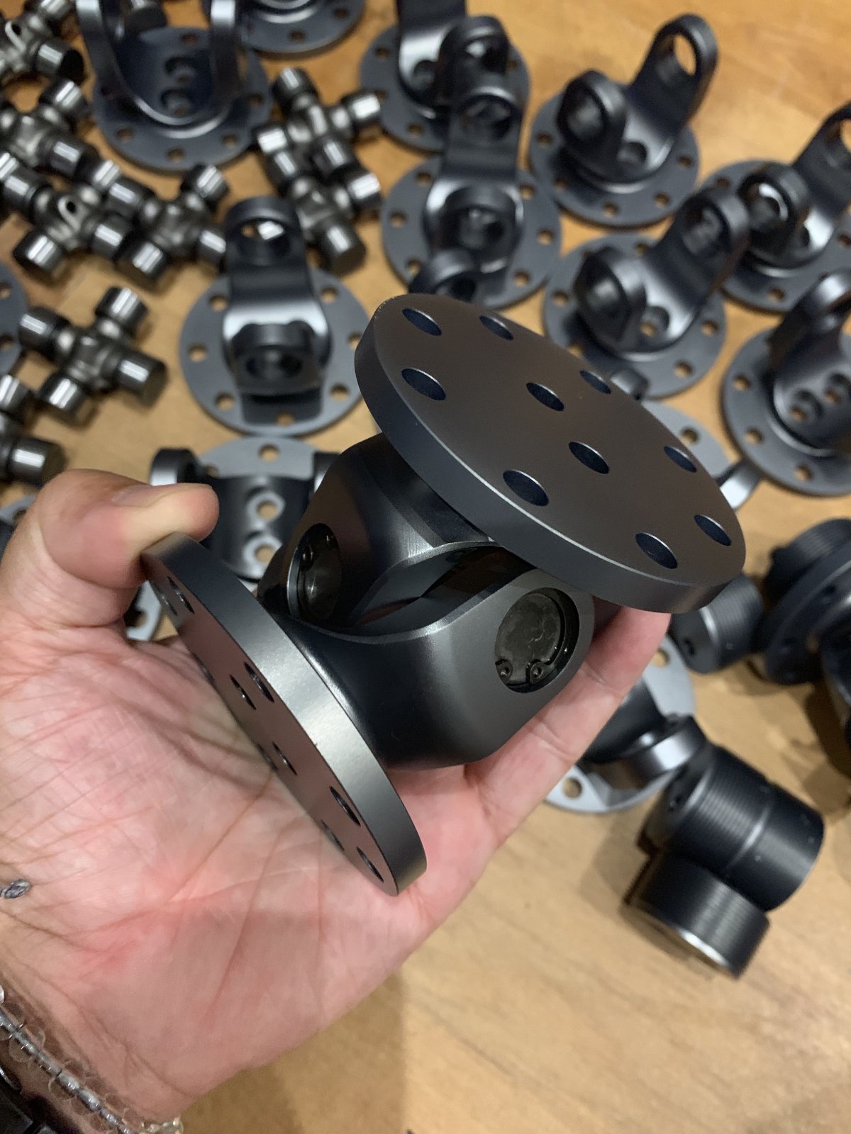

    FYI here are some of my U-Joint prototypes, 3D prints and a final version.
    The final version I made to have both a flat bottom to mount to my floor base. And an optional threaded top/boss to mount on my actuator rod end.
    That way I could manufacture 12 sets and use them either at the top or bottom of the actuator.

    Yes I have limits on the DoF. The less freedom, the shorter I can make them, and the lower my overall platform for the size of actuator. I did not want any bigger than this.
    Shorter/Squat U-Joints are also stronger for their size.
    And currently the degree of freedom is more than double what I need.
    If I made them taller to get more freedom/angle (which I don't need) then I would need to add more material for strength, and that wouldn't look as nice. :)
