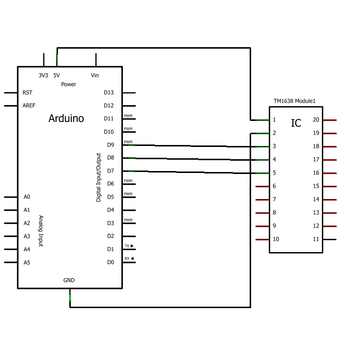

    hi im new here and want to ask for some help. i machined my shift knob from my g25 to house a mini-motor from a cellphone to have shock. my question now is how can i make it work at certain rpm? i think i will need a plugin, and somehow a way to connect it to make it function... but how?

    i have tested the voltage of it and seen that around 0,8 to 1,3v it has a very good feeling for idle rpm, while at around 3v it has a good feeling for rev limiter or also it can start 500-1.000 rpm before limiter. i was also thinking that an easy way to make it function will be to wire them through a led indicator(like the ones the g27 uses). for example 1voltage constant and when the leds flash the voltage will raise to 3. but i dont have a g27 i have a g25 and i need to build a led indicator to make them work. if anyone has a link of a diy rpm light i would be grateful.

    not any progress at all as i just have migrated to germany and i dont have tools, my notes nor any free time. but for until i find spare time i read some posts here and there cause i want also to build a moto controller( http://forum.piboso.com/index.php?topic=1195.msg14426#msg14426) as far concerning this upgrade i have purchased the dx tm1638(http://www.dx.com/p/jy-mcu-8x-red-light-digital-tube-8x-key-8x-double-color-led-module-104314) and im planning on making the shock function everytime the leds need to light on(meaning closing to rev limit). can someone tell me which way im going to get those information from the sim? arduino chipsets do so?

    You have to use GameDash software: go to FAQ ;-)
    I wrote a tutorial about Rev light: look for 7 segments 12v gear indicator (i can't search the link with my phone)
    if you read it carefuly, you will see that you can get the RPM from the game through GameDash companion app of Simtools.
    Once you get the RPM, you can light on the rev light whten it reaches the level you want.
    Yes Arduino can do the job
    Yours
    Mat

    One moment please. So far i have bought a tm1638(http://www.dx.com/p/jy-mcu-8x-red-l...x-double-color-led-module-104314#.VFC0VldERAo) so i guess next thiing to buy is a way to connect this board to another board with a usb on. but ive found numerous different forums here and there pointing at 2 arduino boards. the nano v3(http://www.dx.com/p/nano-3-0-atmel-...d-w-usb-cable-for-arduino-152052#.VFCx71dERAo) and the uno rev3(http://store.arduino.cc/index.php?main_page=product_info&products_id=195) so which one of the two is the right one? sorry i cant read all you have written on your forums cause i dont know a little about electronics its like reading chinese. but i can understand the basics. can someone also tell me if its easier just to buy this (http://www.symprojects.com/shop/spi-d-digital-speedometer/) whats the pros and cons?

    here is @eaorobbie tutorial http://www.xsimulator.net/community/threads/tm1638-multiply-page-display-with-gamedash.5003/
    have tried it with an original uno rev3 and works perfect with a tm1638 like the one you have(blue pcb)
    and tried it also with an arduino nano v3 and cant make it work.i can see the logo when i connect it to the pc or press reset button ,
    but when i open a game my display stays black suppose my settings are ok as i can see nano's led (rx if i remember right)
