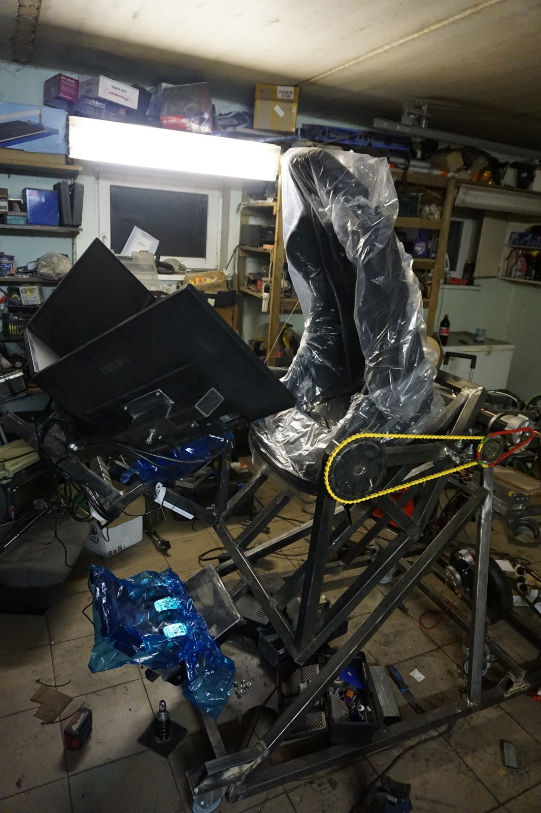

    We are two 20y/o students from Lithuania and this is our little budget diy joyrider rig. It's working but we're adding more features. This is what it looks like now:
    81513120_2491692067824414_2093895319572971520_n.jpg 81552434_2546124592324244_1821581645543636992_n.jpg
    The frame was made in solidworks to check all clearances and stability.
    Specs:
    40x40x2mm square tubing all round except for adjustable monitor, pedal and wheel tubes - 35x35x2mm
    2 axis with 350w 330RPM geared e-bike motors from ebay with additional diy reduction via chains
    BTS7960 H bridges from ebay
    24V 20A psu's
    3x 21.5" FHD monitors (we had them lying around)
    Cheapest steering wheel on the market for testing
    Dampers for more precision and faster response (less likely to resonate)
    The motors have 9 teeth sprockets, they are driving 44t bmx sprockets for a total of 67RPM
    TO DO:
    Swap arduino for an STM32 for 20khz PWM generation, because now the motors are audible
    More reduction via jackshaft for better response on the sway axis
    Wheels for easy transportation
    Traction loss simulation
    Better wheel (T500RS)
    A proper racing seat with 4 point harness
    Adjustable ballast (now is a front disk brake welded to the frame)
    Paint
    Total cost as of now in euros:
    Motors - 130 for both
    H bridges - 17
    Metal tubing, 3mm sheet and 30mm axis - 123
    Bearings with housing - 20
    24V 20A psu's - 50 for both
    Various small tools, bolts, chains and sprockets - about 100
    All other electronic components, wires - 120
    Monitors were free because we had them
    Cheap steering wheel - 30
    Total - around 800-900 euros.

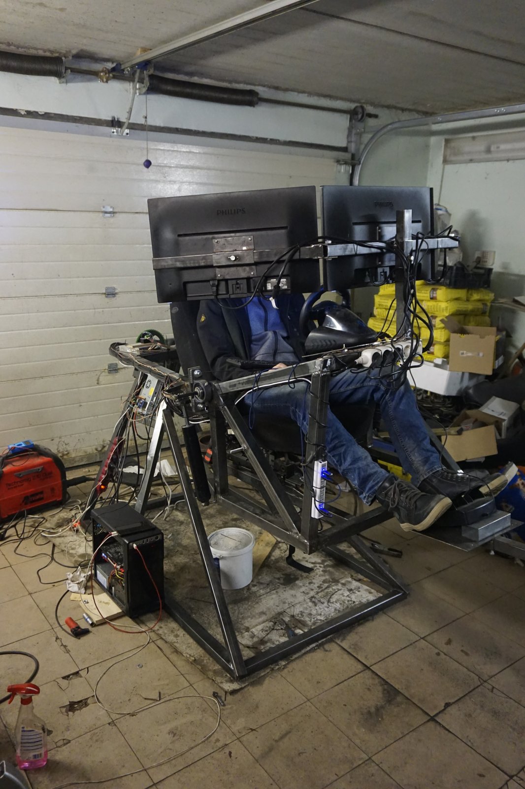

    Big update: the sim is working in its almost final form.

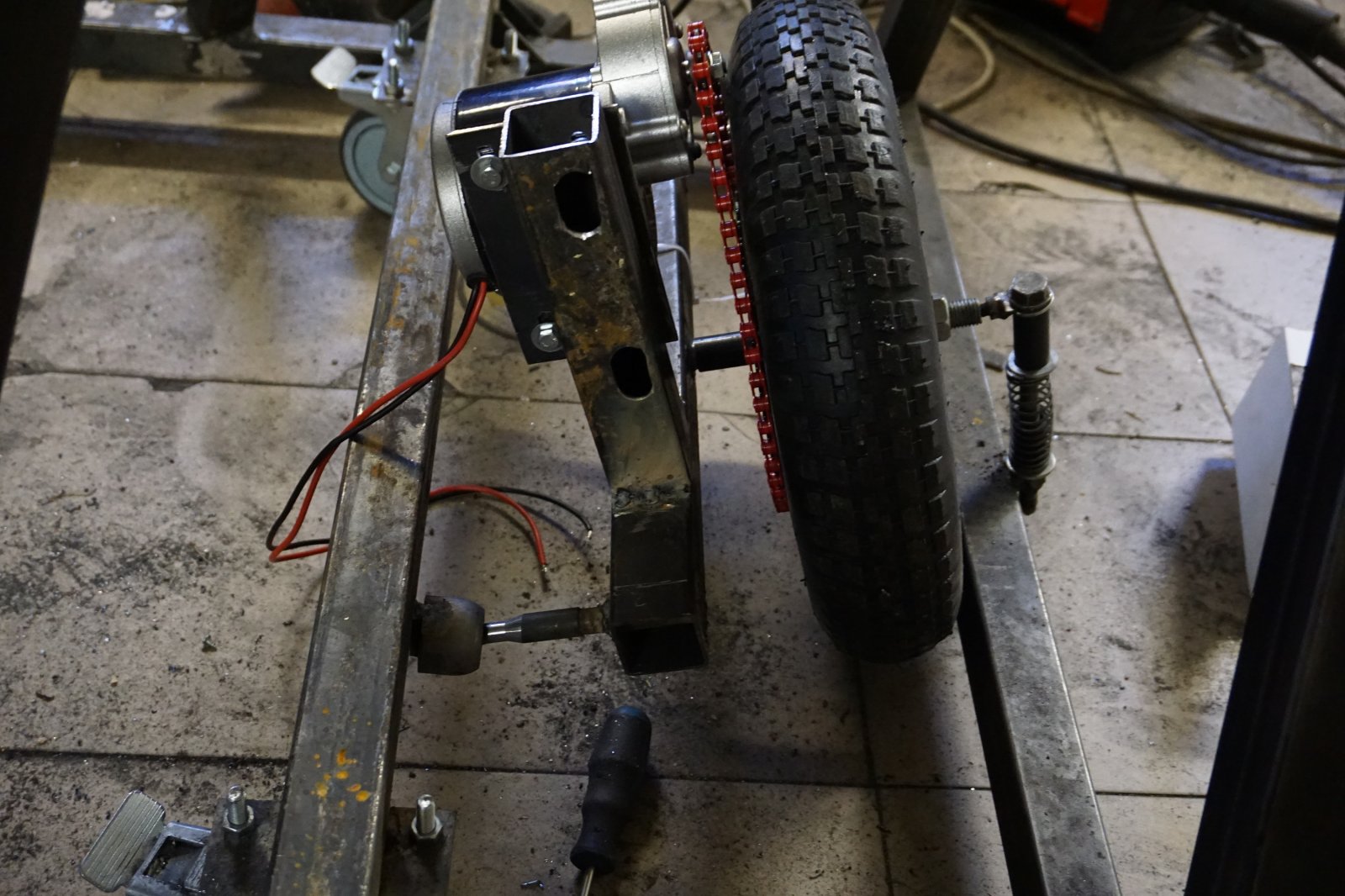

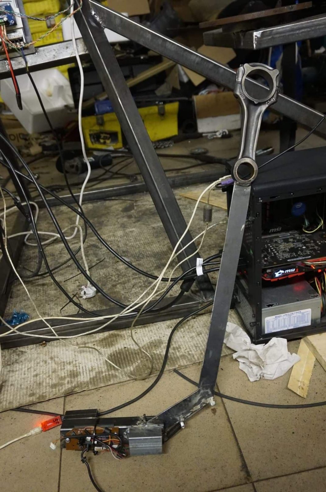

  14. Spart
    Spart Member
    Mar 3, 2020
    33
    Student
    Kauno kaimas
    223Coins
    +26 / 2 / -0
    DC motor, Arduino

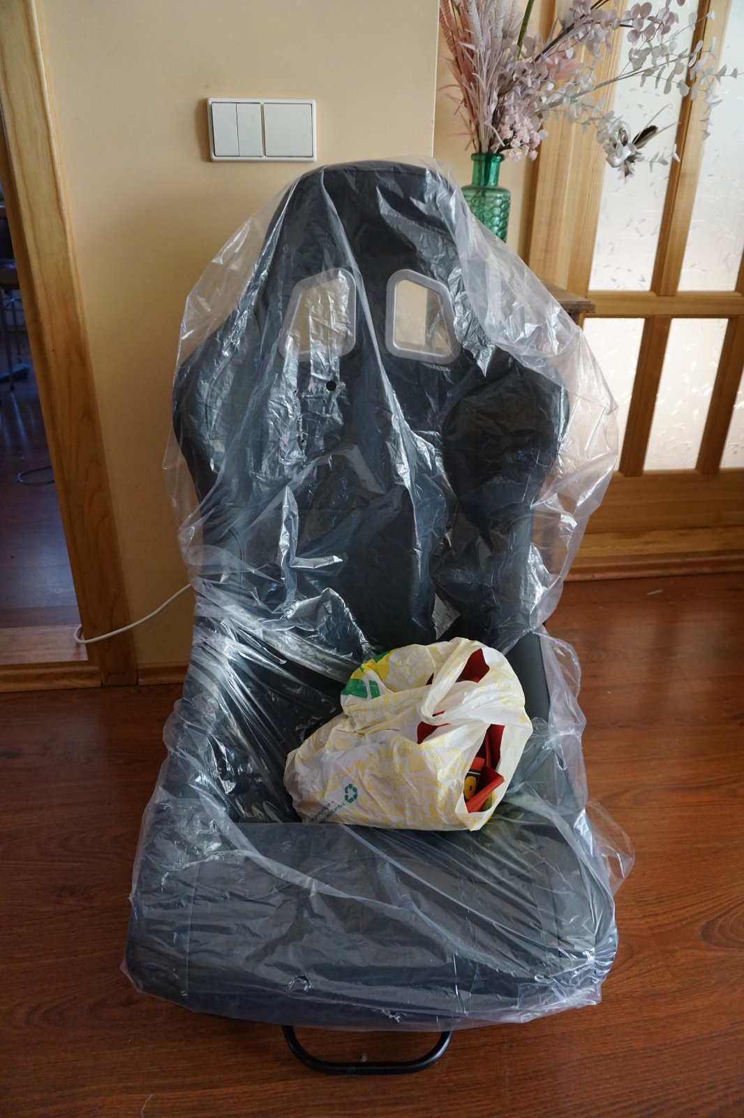

    So big update, our racing seat has arrived. Its the cheapest racing bucket we could find. Also found some 4 point seatbelts.
  15. Spart
    Spart Member
    Mar 3, 2020
    33
    Student
    Kauno kaimas
    223Coins
    +26 / 2 / -0
    DC motor, Arduino

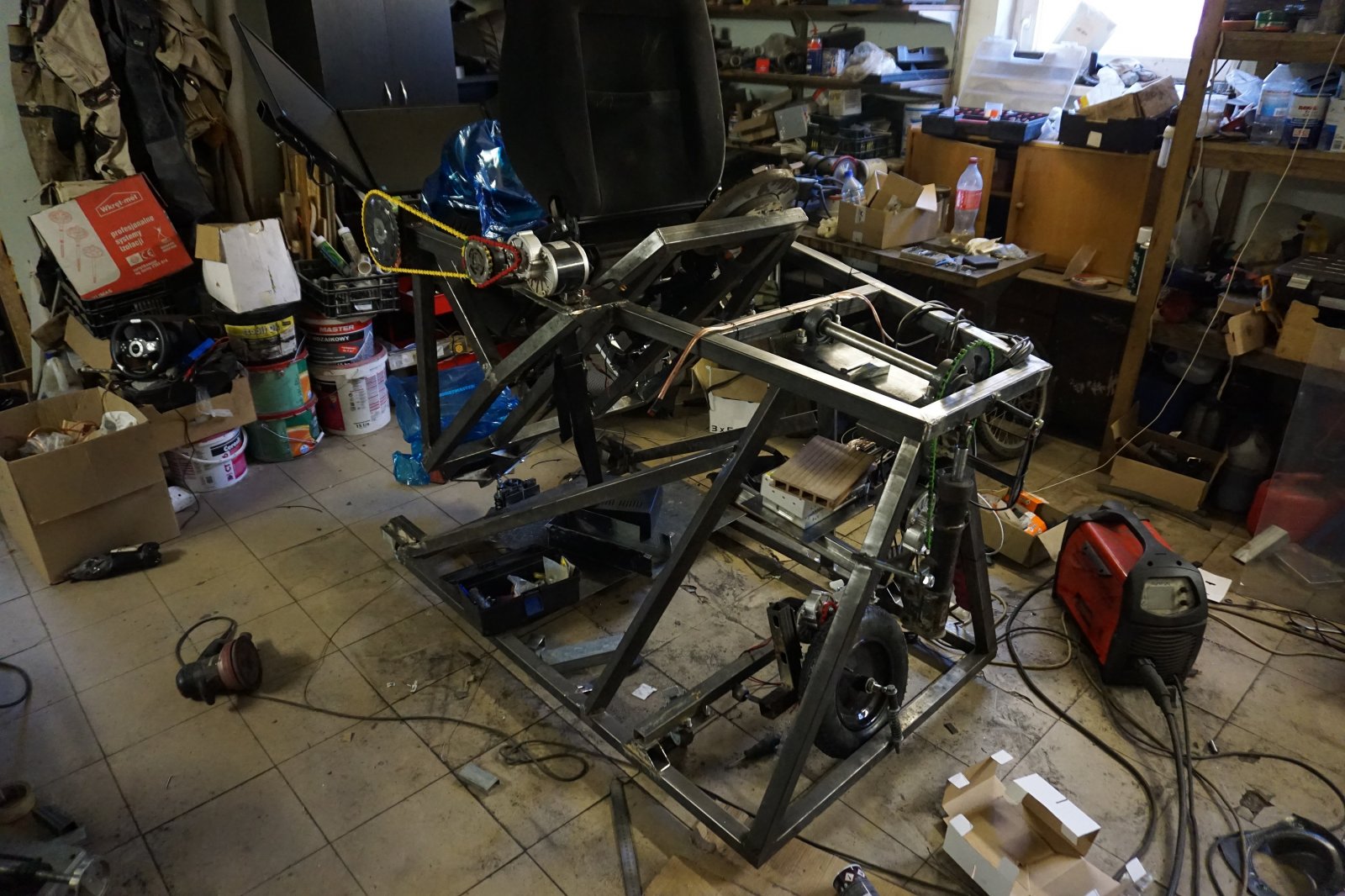

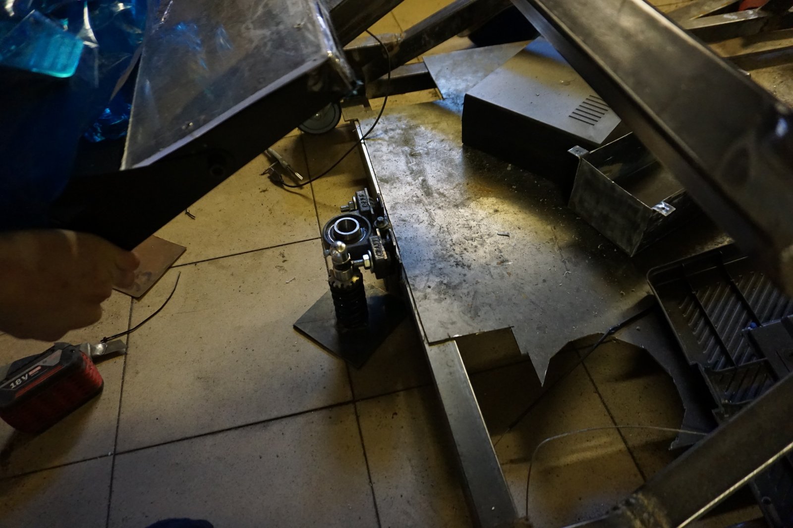

    So here are some update photos you asked for. Second photo is traction loss front pivot point (not assembled at the moment). 4th photo is traction loss wheel at the back, it will spin in both direction and make rig go sideways. We choose this design becouse it gives us A LOT angle (30 degrees to side, but the limit is how much potentiometer can turn at pivot point so its 270 degrees i think )

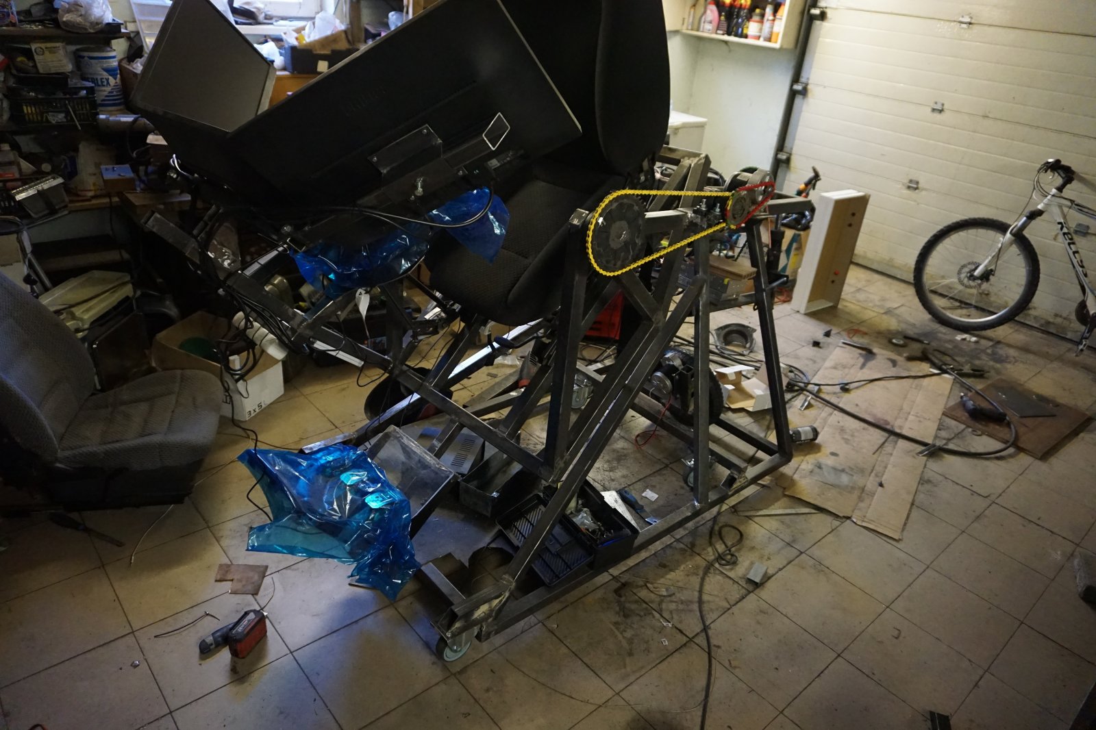

    We also got proper wheel ( T500 RS ). We dint want to go for direct drive becouse in my opinion its overkill compare to real world racing and fanatec is not available in our country. Side engine got better reduction (with jack shaft) so the response of breaking and accelerating would be faster. Reduction of side engine is about 1:66 and for rear engine its about 1:50. Traction loss has also 1:50 reduction and acounting the wheel size it gives us about 1.3 m/s rotation speed. I think it should be plenty for this normal driving, until you spin out . All three current engines are 3000 rpm 350W. Things to do are custom speedometer, we already got the design and all the parts are printed, now we just need to assemble it. We are also thinking of adding heave axis so the racing rig could move up and down but so far its looking a bit expensive. We also need to fit new seat in and figure something out with automatic center of gravity adjustment so our side motor wont have to work extra hard to keep everything level.

    Small update, I got the seat fitted to the rig, had to fabricate some custom angle plates so the seat wont be vertical to chassis. It now sits at about 10-15 degrees, feels pretty good. Another thing I noticed that the seat is a little on the small side for me (and probably my friend). but oh well we have to make it work with the parts we have so it will be alright. And also it will be huge weight reduction compared to Ford mondeo seat we had so the rig will be more responsive. DSC06126.JPG
