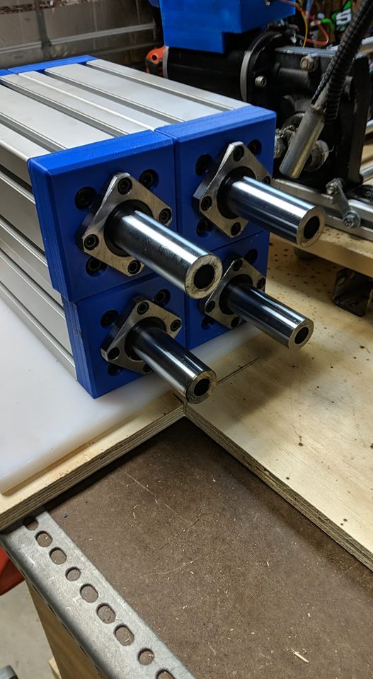

    ok here is where i ordered my 30mm OD and 18MM ID hollow rods....25$ a piece and 10$ a piece to cut to proper length + SHipping...VCB.COM

    Had to order extrusions from www.kinetikmsystem.de as they are a custom type and I didnt feel like modifying the design. They cost me 260$ USD, or 220,47 Euro.
    Shipping was 93$!...

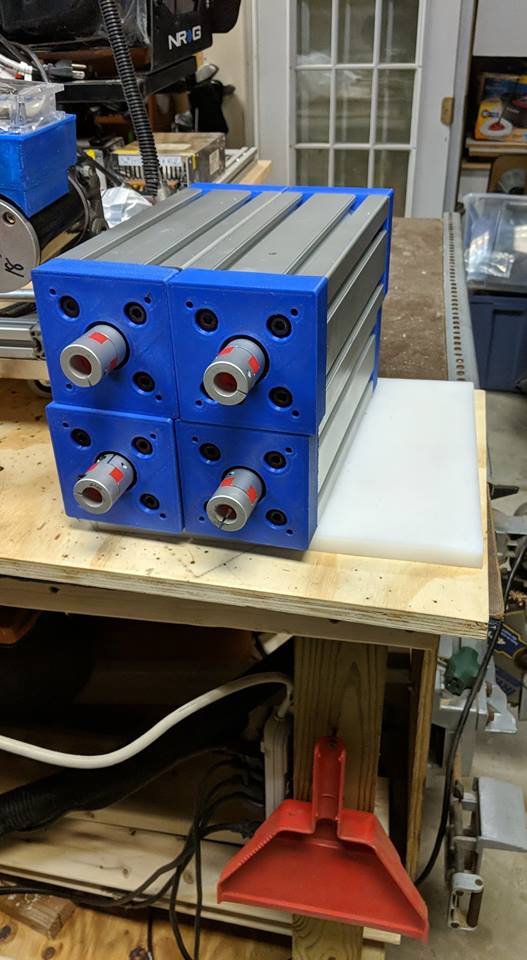

    D sub breakout , found a 3 pack for 13$ and then 8$ for a single unit.
    Amazon 3 Pack

    Well, the actuators are all put together short the motors since i need to test them.
