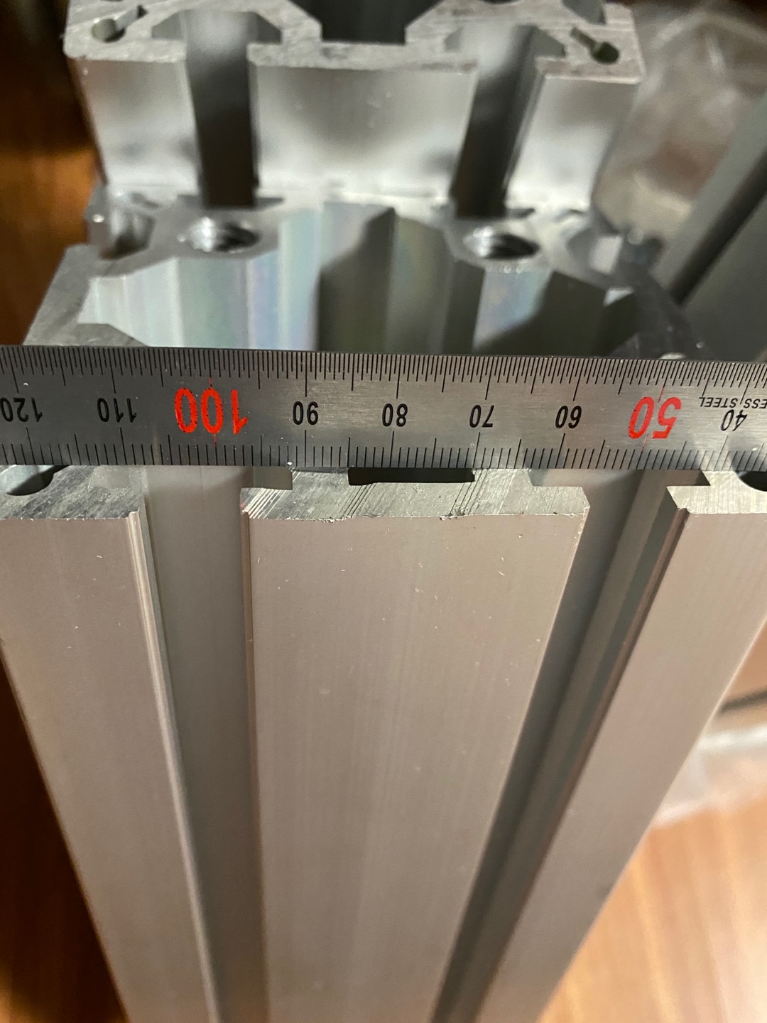

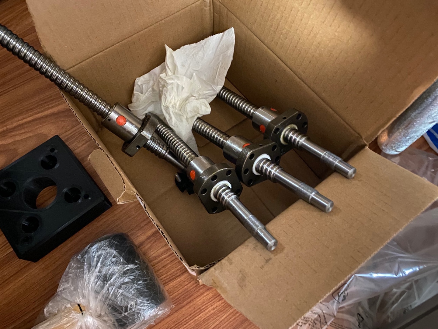

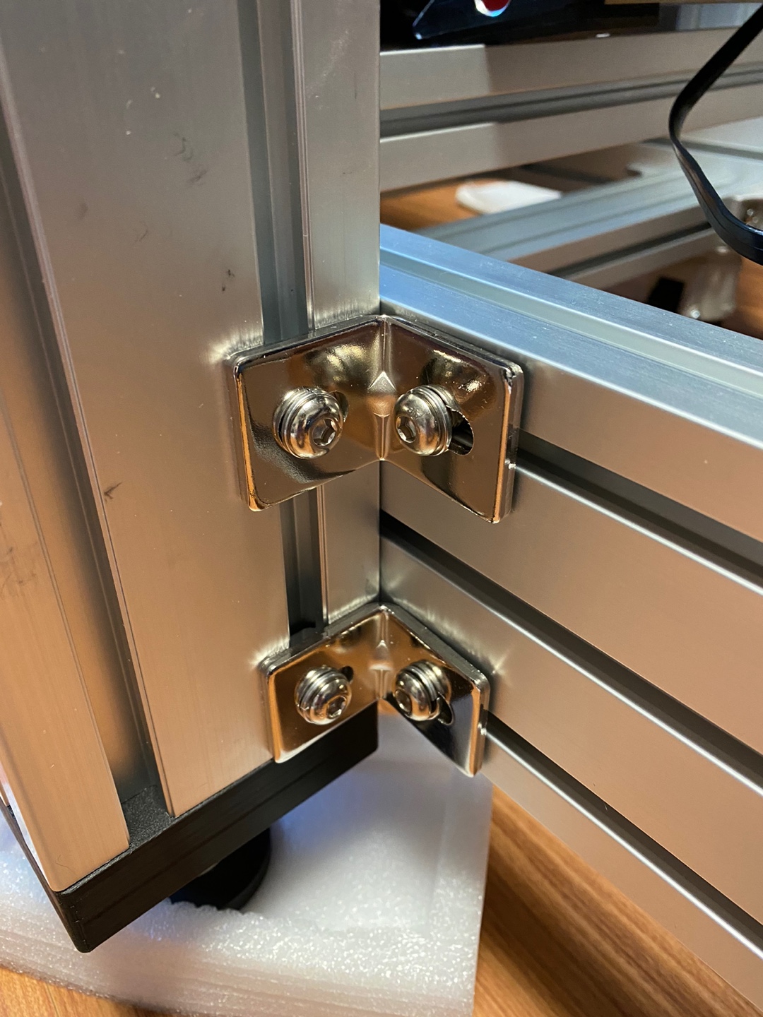

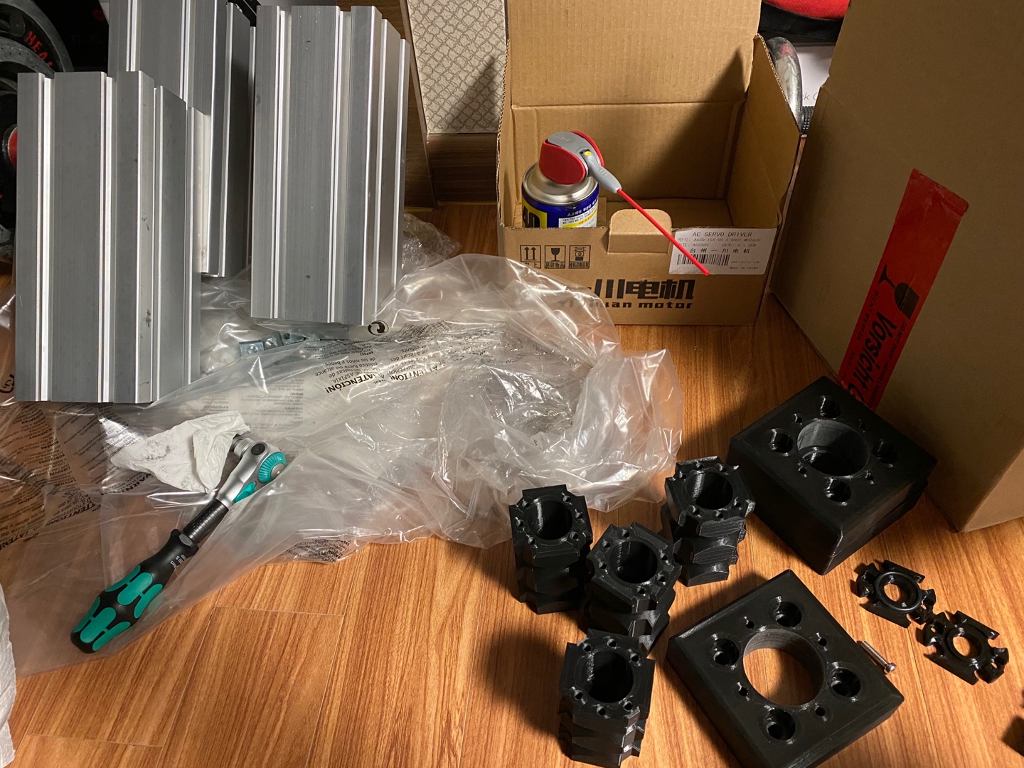

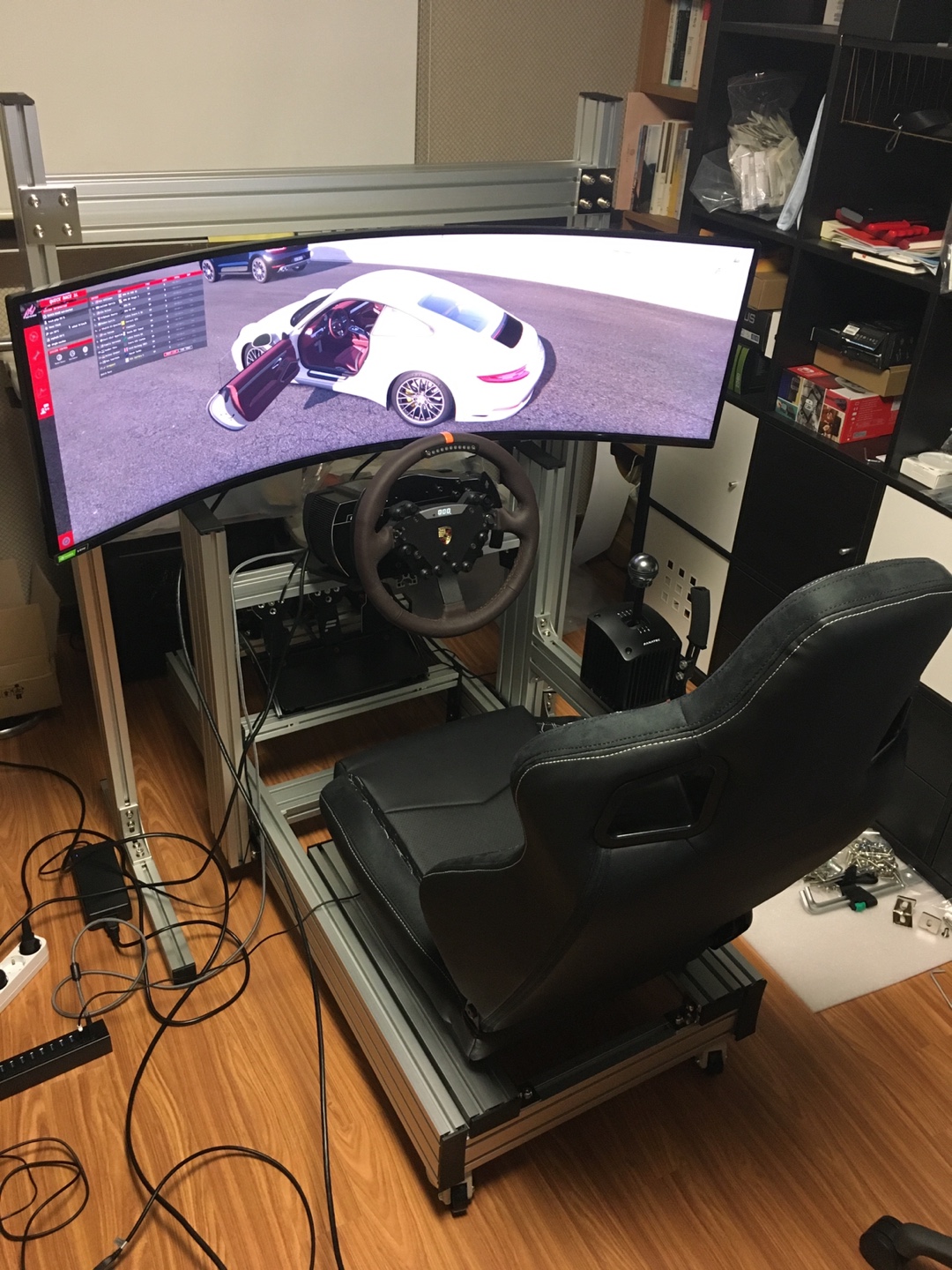

    Hi, I'm building an SFX-100 project + aluminum sim rig with aluminum profiles from AliExpress.
    Here's my rig (without the motion simulator bit).
    3D printed components and profiles
    More components from AliExpress

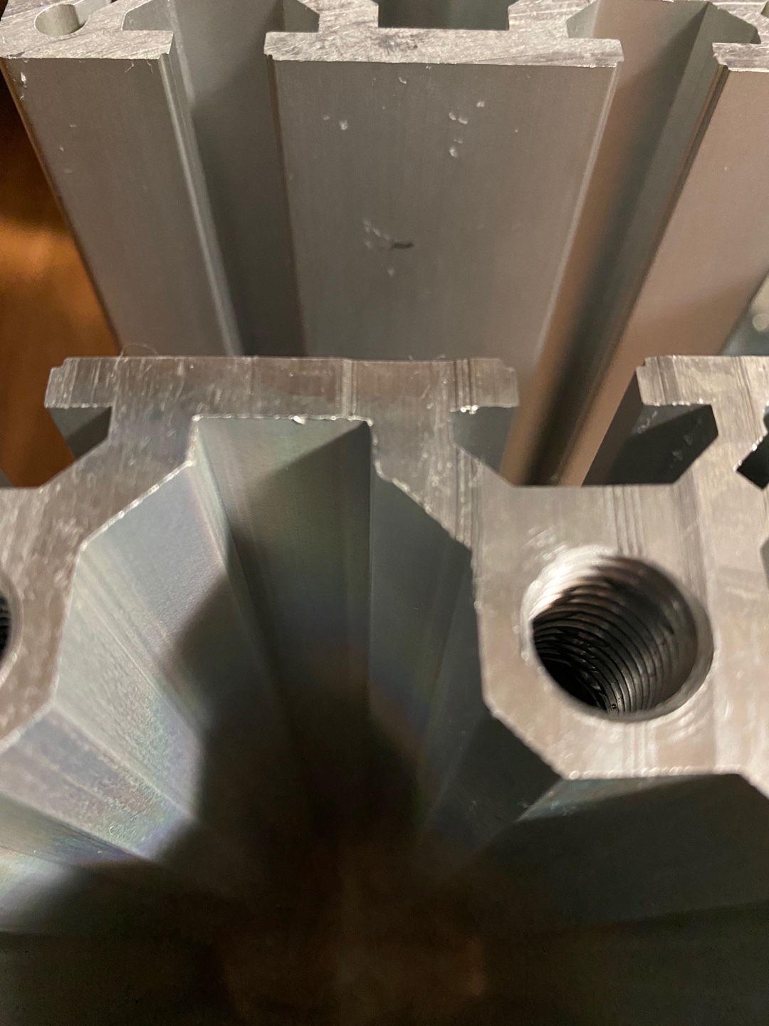

    The cutting of the profiles are of sub-par quality. I'm worried if it will cause mechanical issues later. I do not recommend buying from AliExpress. But they are really cheap. It only cost me $100 for the profiles and 32 slot nuts including shipping fee.

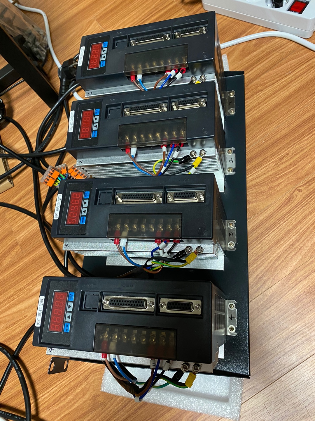

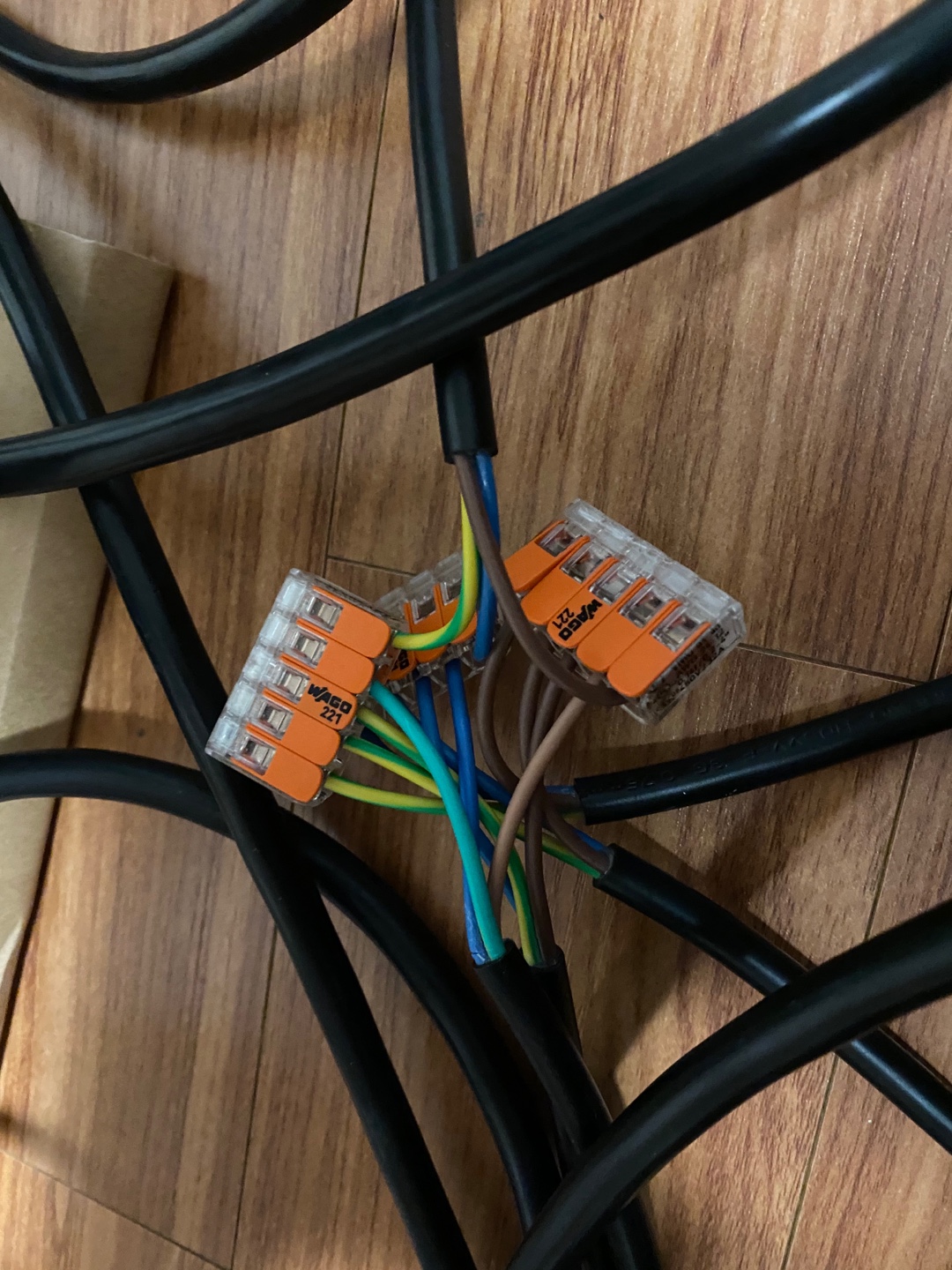

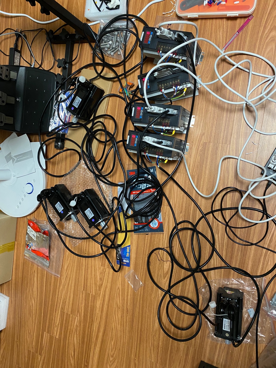

    Wired up and testing the motors.
    I used Wago connectors to daisy-chain the power cables.

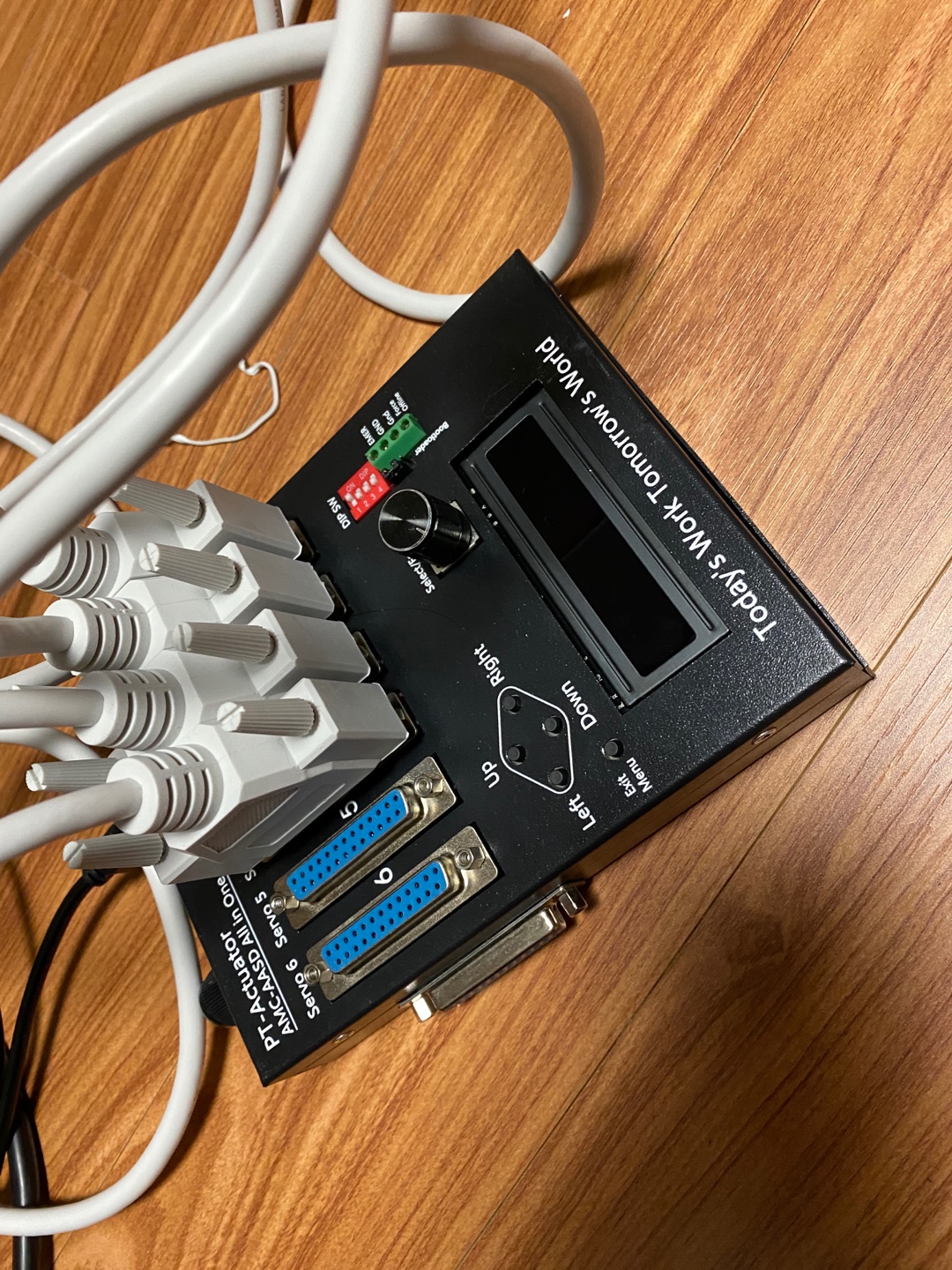

    I went with the Thanos controller for my project.

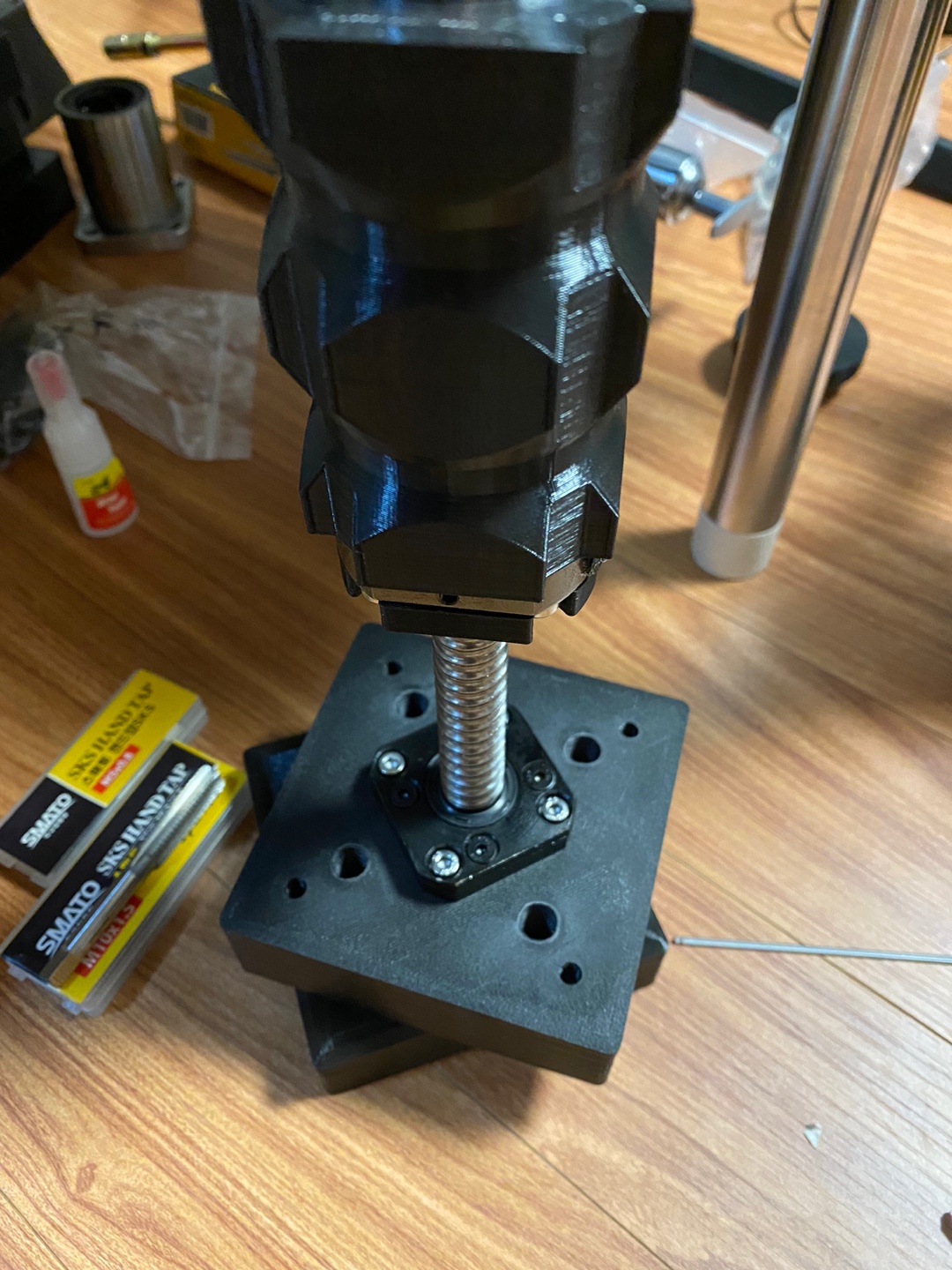

    Someone messaged me about where to get the profiles:
    Here's the link:
    https://www.aliexpress.com/item/32796414687.html?spm=a2g0s.9042311.0.0.21bb4c4dvORuxu

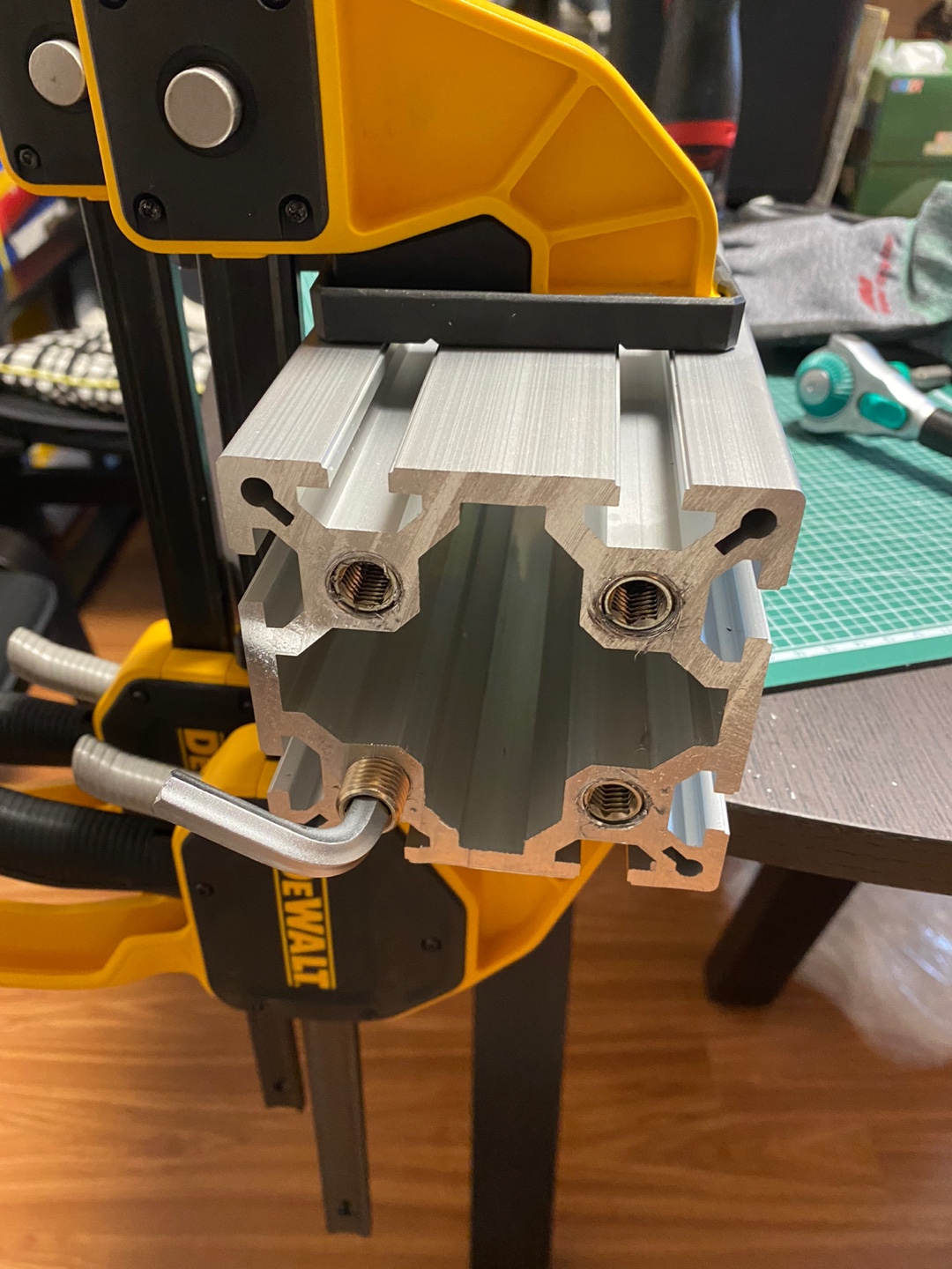

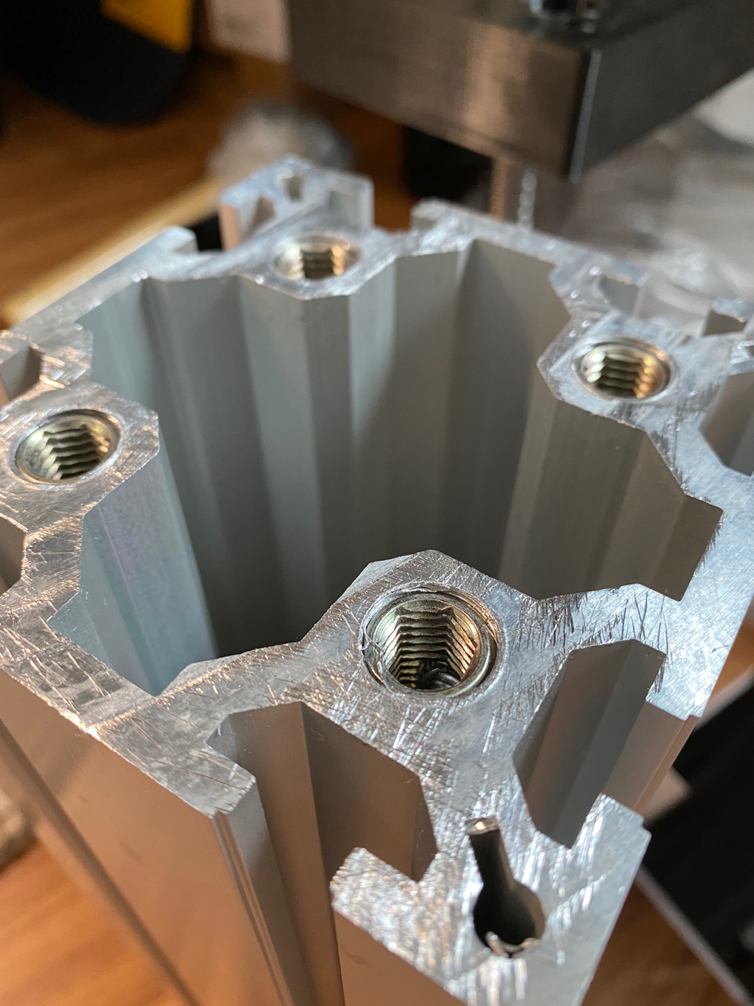

    Place an order and send a message to the seller (do not proceed with the payment). They will ask you what exactly you need. Tell them what you need (cut to 250mm pieces and the slot nuts) and then they will quote you. In my case, $100 including shipping (slow shipping) and 32 slot nuts and M14 x 1.5 tapping all 32 holes. Bear in mind that I live in Korea, which is right next to China. Your shipping cost may be more expensive.
    If you want to go this route, you will need to purchase 32 M14 to M10 thread inserts which cost me about $30.
    Also you need 32 M10 bolts instead of M8 ones.
    Currently I am having a hard time inserting the threaded inserts because it is so tight. Not even my impact driver can do the job. So I'm using a long hex wrench to do it manually. I'm suspecting the tapping quality is not up to standard. So I recommend getting a M14 tap and do it yourself.
    Also this project requires a different set of stl files for the 3d printed parts as the shape of the profile is different from the one from Kinetik.

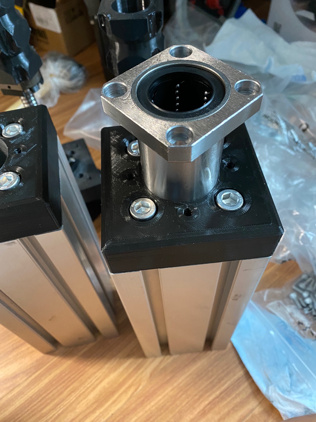

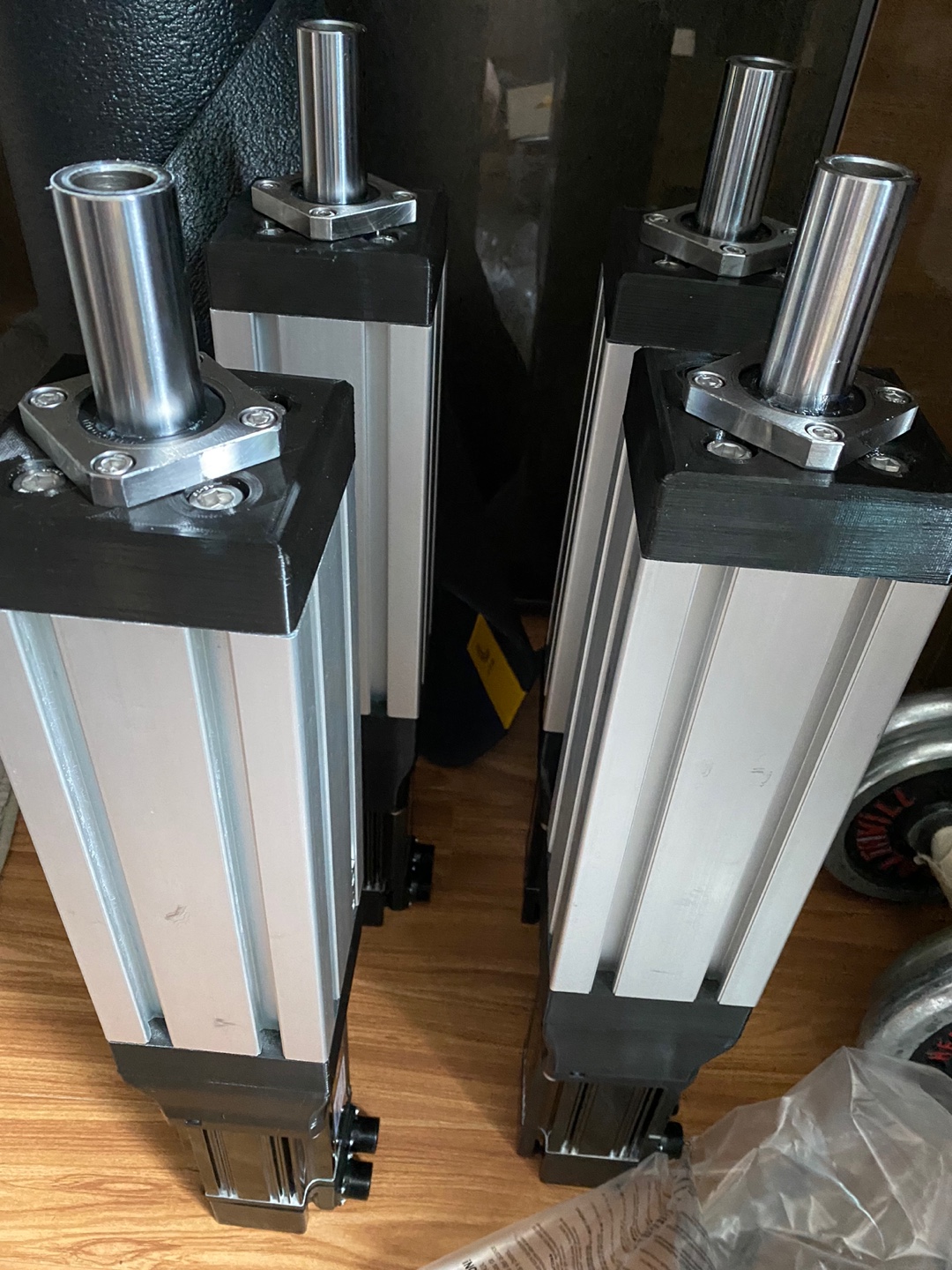

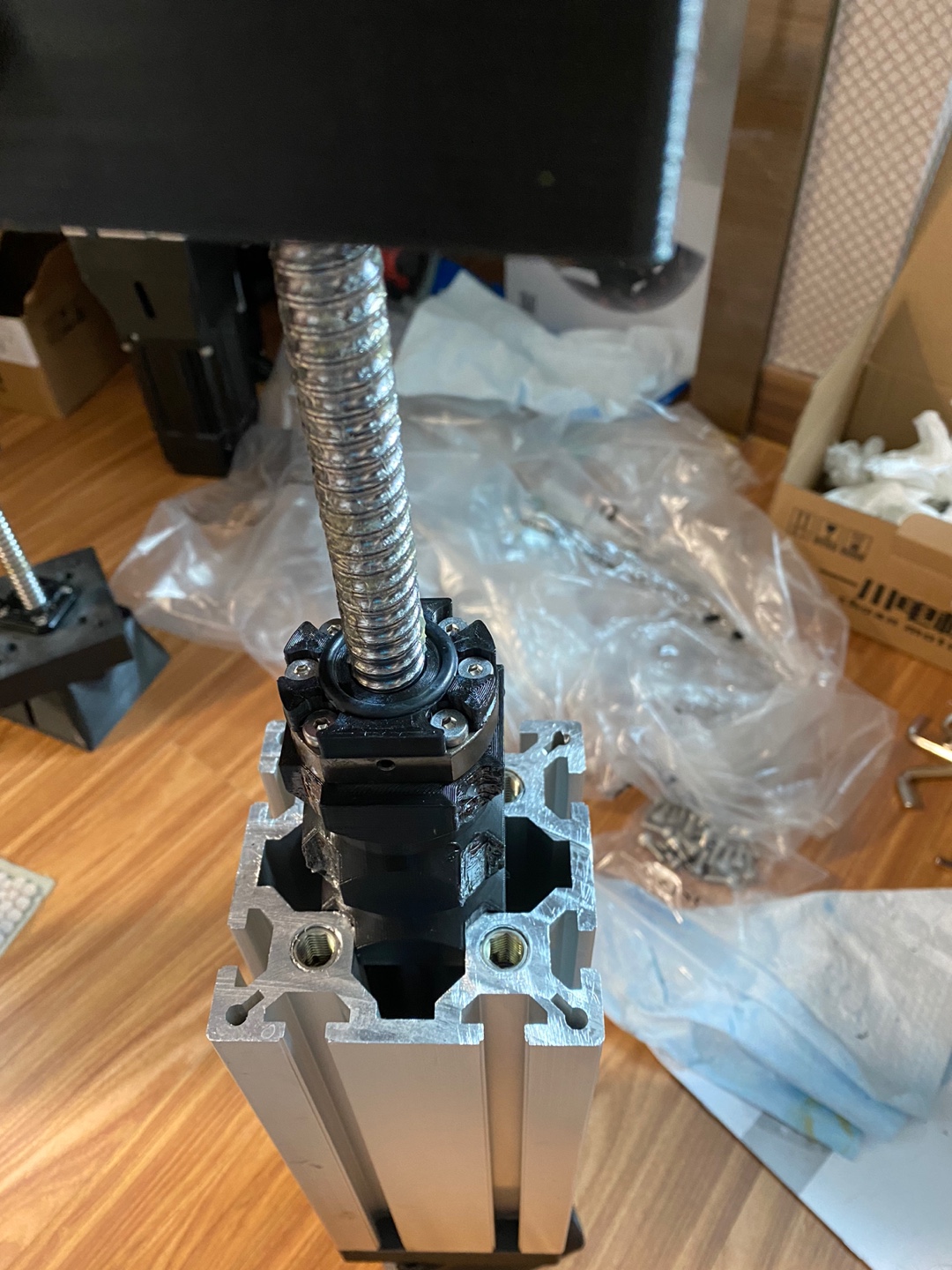

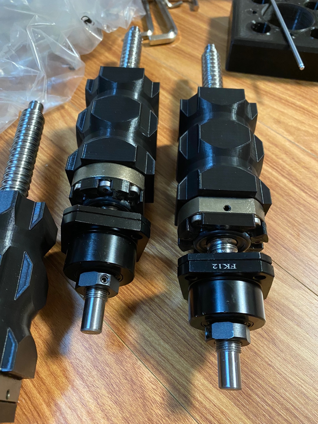

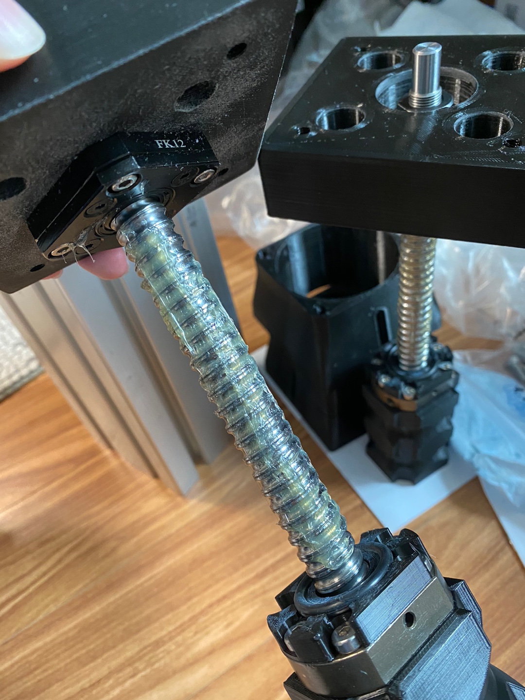

    Slider assembly. Make sure to not unscrew the bearing completely. Many sfx-100 tutorials mentioned this, and I had read them all, and I still made this mistake somehow. Took some good 10 minutes to shove the ejected ball bearing inside and put them all together again.
    Attaching slider assembly to the mount. It was a very tedious job screwing those four bolts into the mount.
    Watching Netflix while screwing these things helped.
    Inserting threaded inserts to the profiles. Took a lot of effort to drive those things inside. I used WD-40 in place of tapping oil. For some reason the M14 x 1.5 tap by the AliExpress seller was not quite compatible with my threaded inserts. So the threaded inserts kept getting out of alignment. I had to spend a lot of effort straightening the threaded inserts in the midst of screwing them in (by applying extra perpendicular force to the hex wrench while screwing).
    Rough edges and remnants of aluminum were filed away. I washed the profiles with water because there were aluminum dusts everywhere.

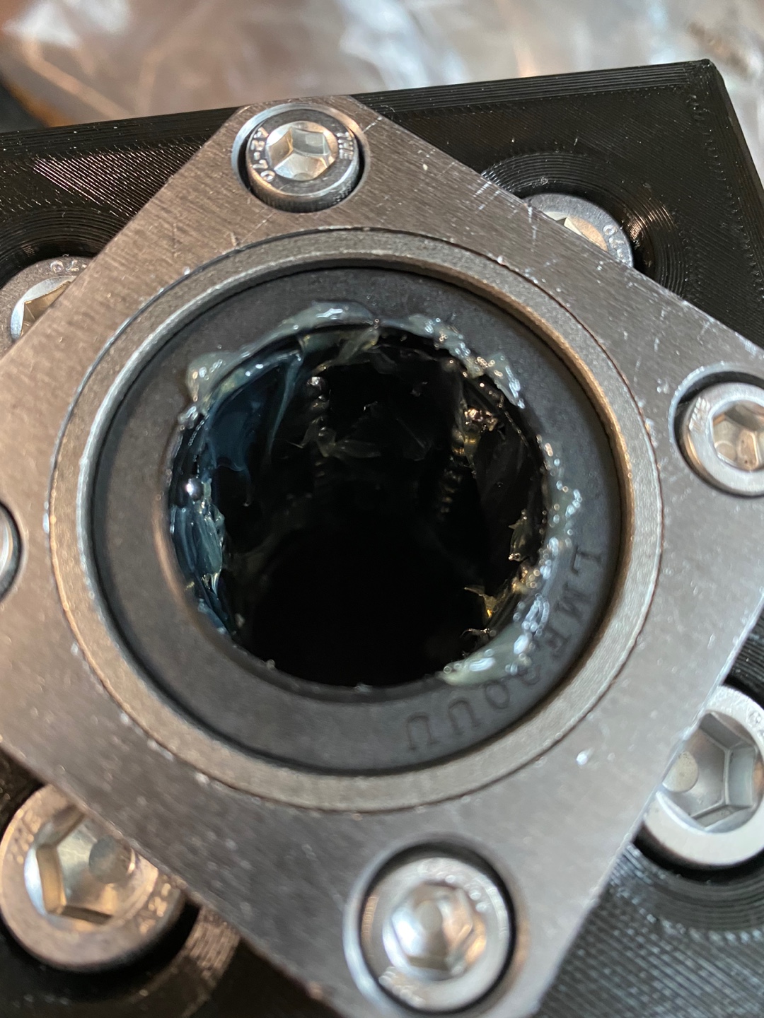

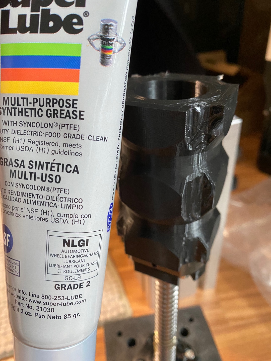

    I applied bearing grease on screw and Super Lube on the 3d printed sliders.
    I was very generous with the amount of grease. I hope they don't cause problems later.
    I went with 3d printed grease nipples to save money. All of them ended up snapping while inserting them to the ball screw. Do not even think of using them.
    Inserting the linear bearing. A lot of grease has been applied inside.
    The perfect fit of the slider makes it very satisfactory to put these things together.
    * Before this step, you need to put the T-slot nuts inside the profile. I realized this after the full assembly and had to come back to this step later.
    Finished building all four of the actuators. Phew!
    Fixed the motor drivers to the tray that came with server rack which will keep these things.
    All that's left is attaching the actuators to my rig! See you in the next post.

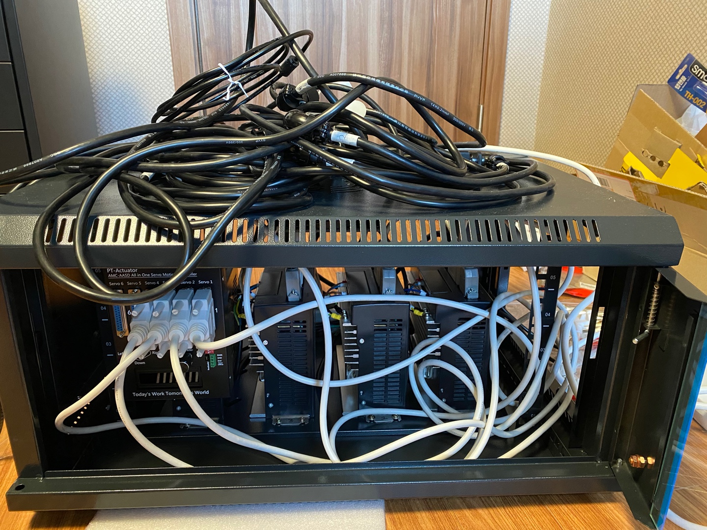

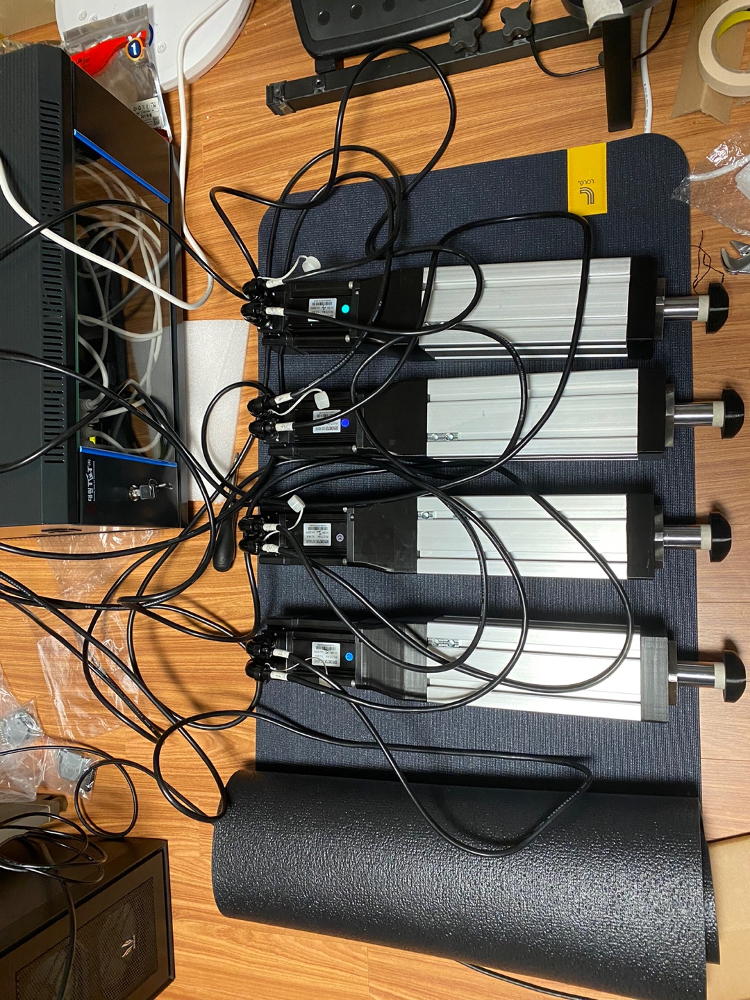

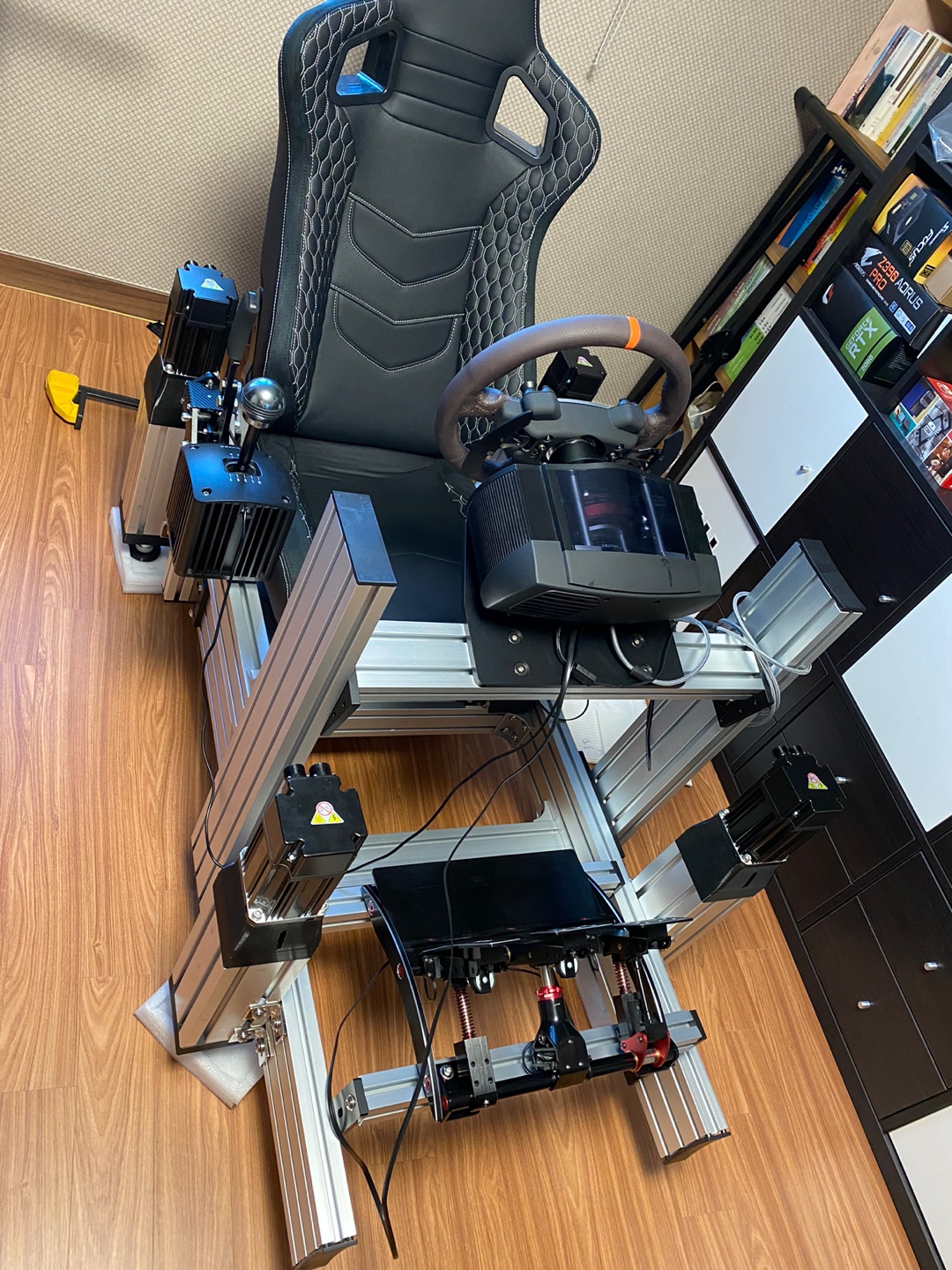

    Before attaching the actuators, I decided to give it a test run just to be safe.
    First, I had to cram the motor drivers and the Thanos controller in a server rack.
    It looks easy, but it isn't. It took me more than an hour to do this.
    Ready for testing.
    I used FlyPT mover program for testing.

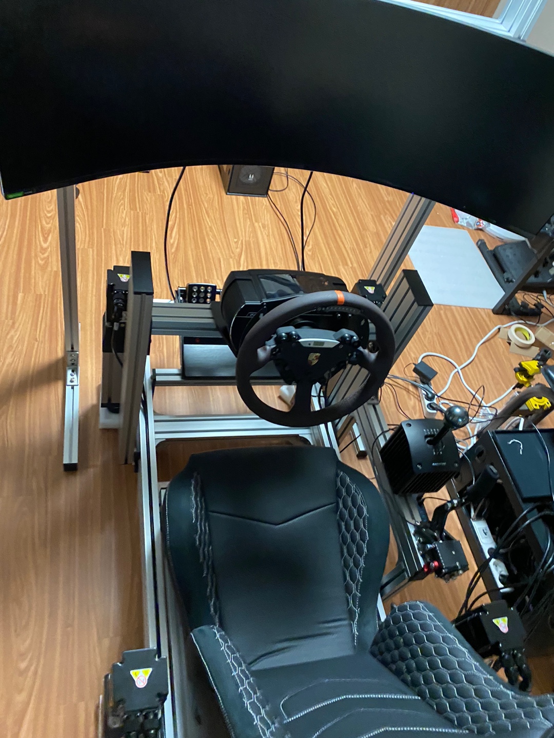

    The actuators seemed to work just fine in Assetto Corsa. So I went ahead with attaching the actuators to my rig.
    Ready for test drive!
    Unfortunately, the motion was very jerky and unrealistic due to having zero knowledge about tuning the motion parameters (surge, sway, roll, etc.). I am nauseating right now after one lap of Nurburgring GP circuit.
