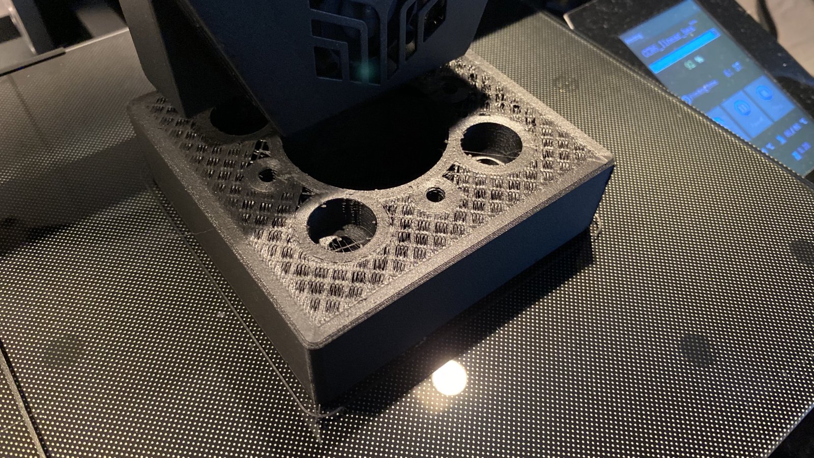

    Hey!
    Yeah i have started to understand that there are no magic profile that just fixes perfect fsx prints, since i posted i have been locked in the basement like a mad scientist and printed 100s of small test pieces and weighing between print quality, strength and print time. I'm now down to 14H on the big motor mount and around 6H on the smaller ones with about 3mm walls and 30% grid fill and have tried to screw it down to a T-profile with a lot of force and its holding up.
    I have a Creality CR-6 wich is a fairly new printer so theres like nothing in terms of profiles for anything, but its very similar to Ender 3.
    Leveling is not an issue though it have auto leveling and adhesion is defenitly not a problem on the ceramic coated glass bed, until i got the tip to put it in the freezer I ruined more than one good print :/
    Attached pics of the last print with 3mm walls and 30% infil/grid which looks.. well ok? Next one will be 3.5mm walls and 50% fill wich should be equal to the recommended 8 perimeters and the 50% to mitigate the missing setting in Cura to fill every 20 layer solid.

    Glad that you had succes with prints now.
    Your print looks good!
    I also used cura with My prints. I printed most parts with 30% infill and little thicker perimeters, bottom and top to compensate missing solid layer after x layers option in cura.
    My rig has hold together fine so far. But 50% infill is good too. I would not use more infill than 50%.

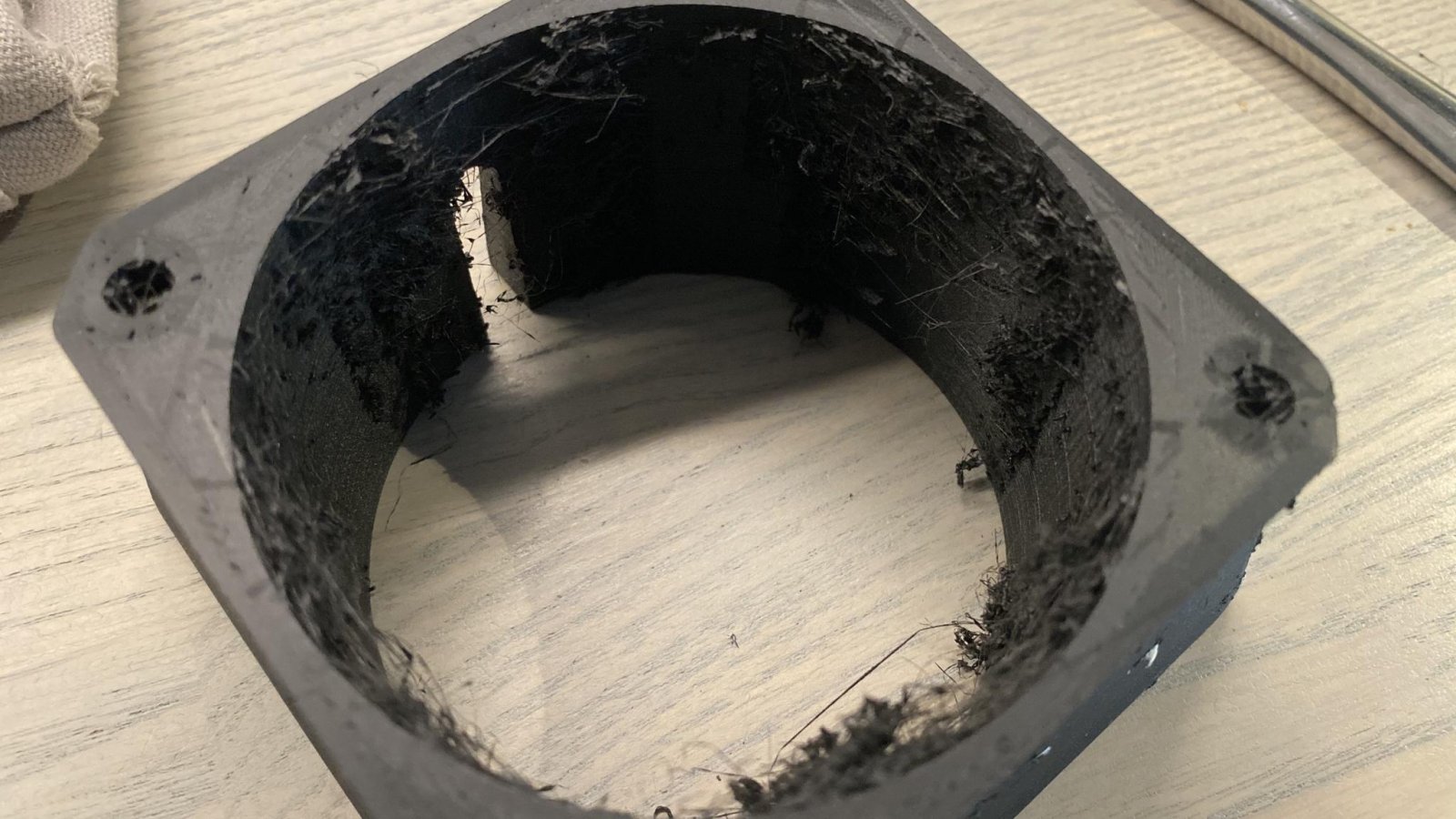

    Also some of My prints from ender5 came little rough on the inside hole. Specially the motor mounts i think that was due to not so great cooling fan of creality ender. But light sanding of print can fix that.
    If you start having problems again you might want to check extrusion. Creality ender series mostly underextrude with factory settings so not sure if cr-series have same issue.

    Rough on the inside you say? No idea what you mean :roll :D
    Just to clarify, this was one of the first prints i did and it didnt go that well as you see :)
    I´ll keep an eye on the extrusion but for now i think the bigger prints looks fine, right now im working on a profile for the smaller bump stops, printed way to rough with the same settings as the larger one.

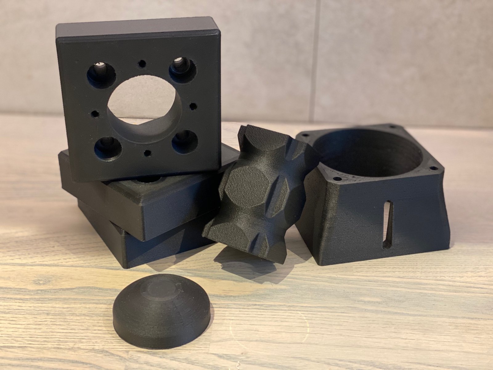

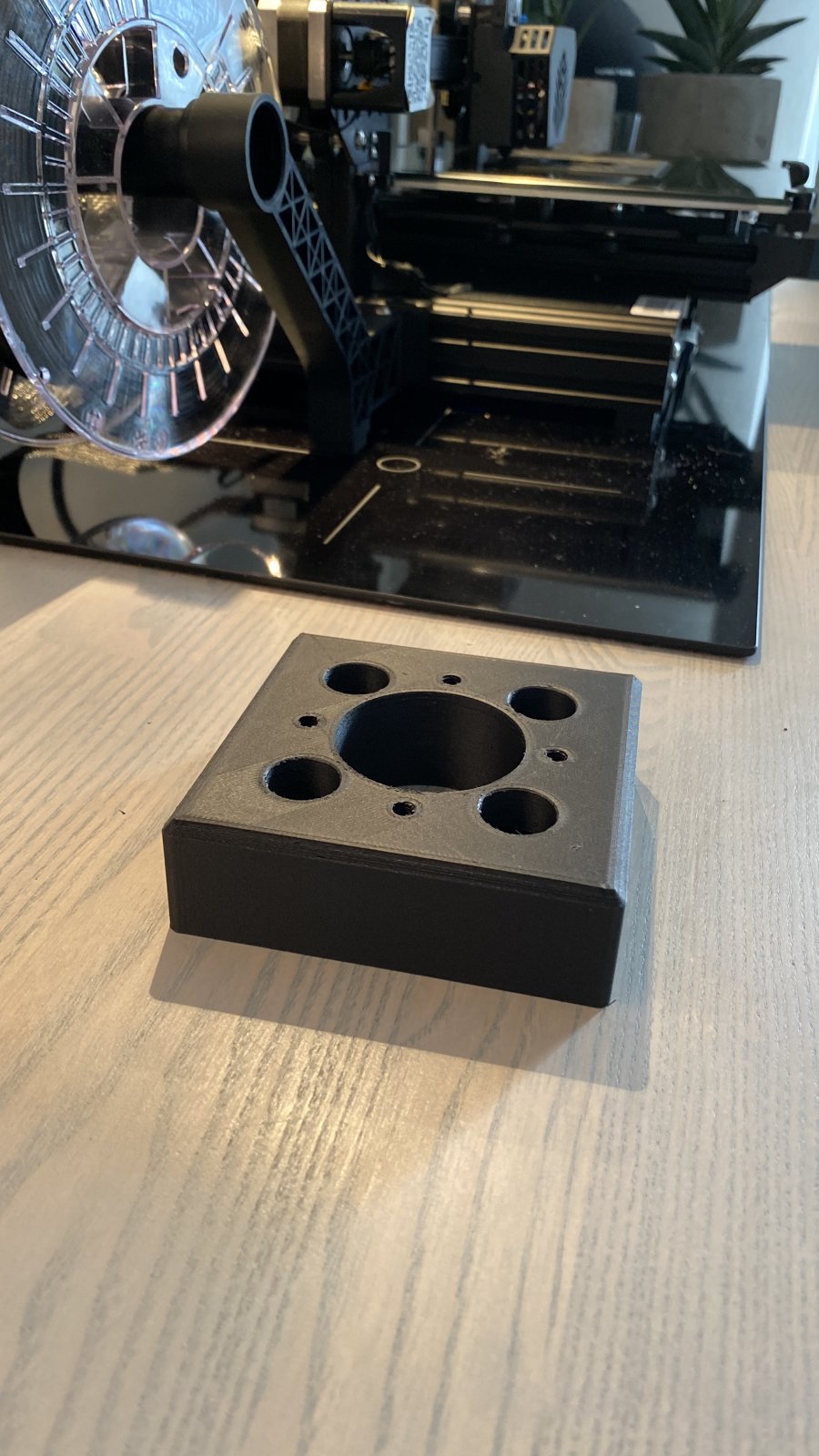

    Update:
    Managed to get really nice prints with thick walls (3.5mm) and quite fast print times, for example the big motor mount prints in about 9H. I know this time can be reduced further by going with 0.6mm nozzle and increase layer height.. but if anyone need profiles for Cura/Ender im happy to share them.
    Be warned though, i have no idea how these will hold up but they feel extremely solid.

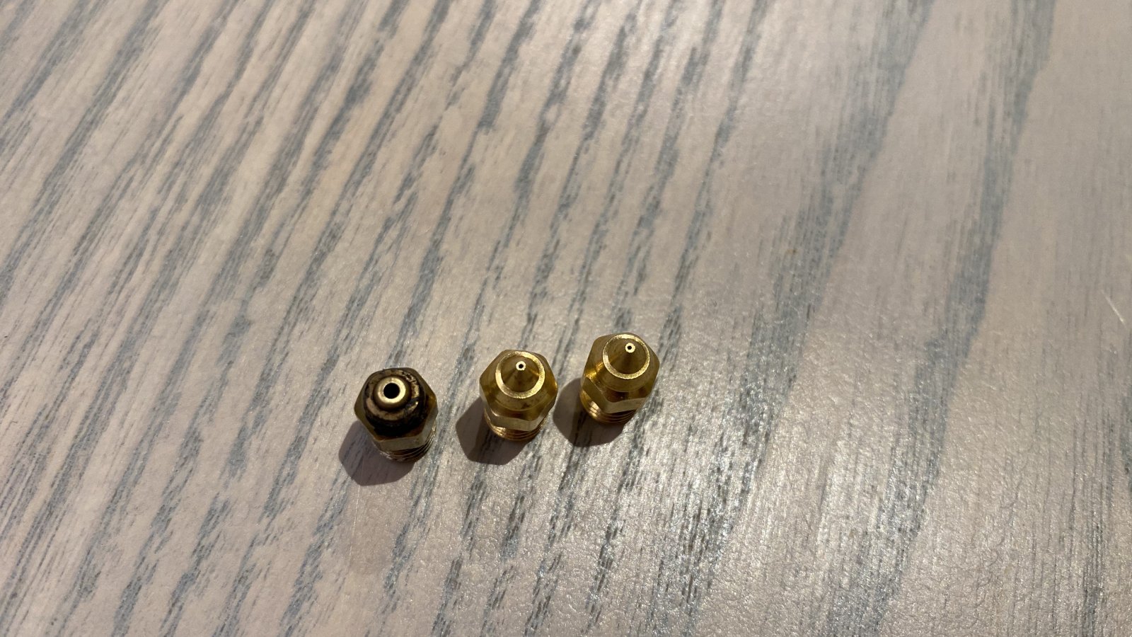

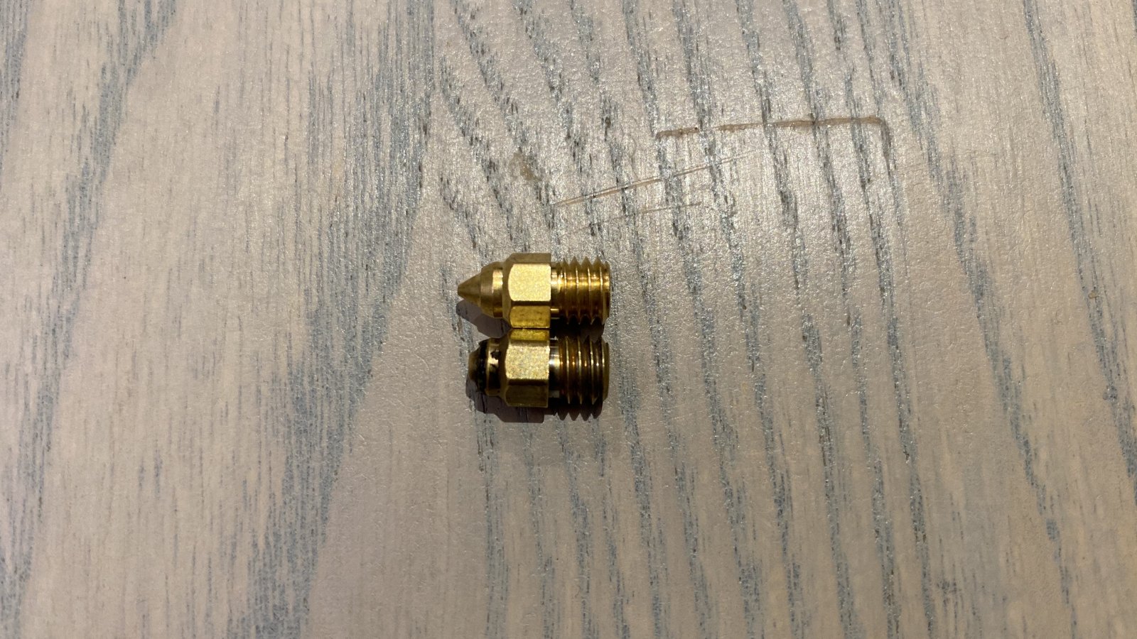

    I think a found the reason why i have had so much troubble getting good prints o_O
    After my last post i got more and more issues and the profiles i successfully used before ended up a mess. I then removed the nozzle to clean it and its like a 2mm size nozzle wth???
    The nozzle to the right/bottom is the stock nozzle and besides from being absolutely huge its like half the length of the other included nozzels, like it have been crushed. I can only assume that something went very wrong at some point, idk.
    Only problem now is that i have no idea what nozzle size the other two are, no markings what so ever. According to creality its suppose to be included a 02,04 and 0,6mm nozzle.

    Ho, looks like someone sawed off the tip...

    Nice prints! Looks like 0.2mm nozzles. You can extrude some filament and messure it with a micrometer. I'm running a 1.2mm nozzle atm.
