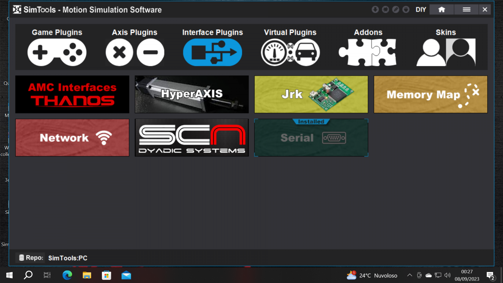

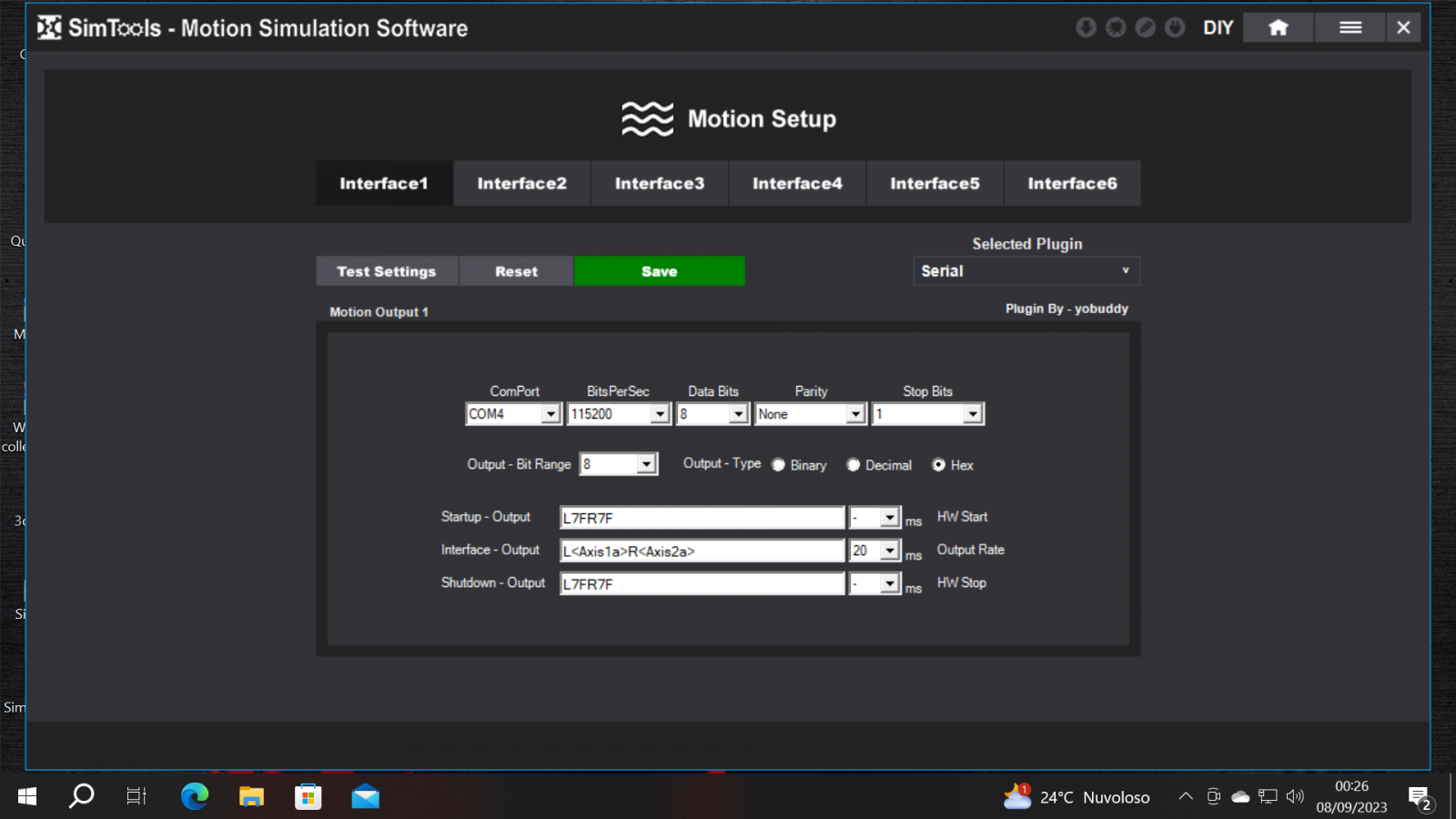

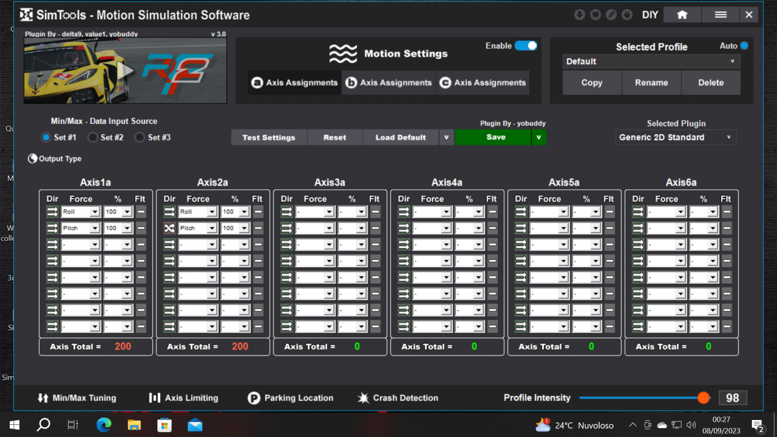

    Hi everyone, I'm trying to configure the interface for Arduino with Simtool v3, but I can't find the right syntax to describe the axes in the photos, it's how I set it but it doesn't work, when starting the test, moving the cursors doesn't work. nothing happens.
    Is it possible to see some photos of the correct syntax for Arduino in the interface settings?

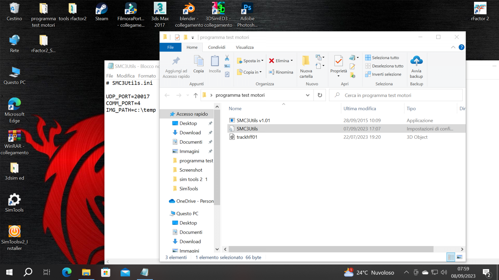

    I use SMC3 with its COM4 program and the motors respond perfectly

    For SMC3 the settings should be:
    Interface Type - Serial
    ComPort = 4
    BitsPerSec - 500000
    Data Bits - 8
    Parity - None
    Stop Bit -1
    Output Bit Range - 10
    Output Type - Binary
    Interface Output - [A<Axis1a>][B<Axis2a>]
  5. Andrea 1968
    Andrea 1968 Member
    Jul 1, 2015
    65
    italia
    193Coins
    +40 / 0 / -0
    Thank you very much, everything worked the first time, I finally brought my simulator back to life, Simtools v3 is simply a spectacle, now I just have to adjust the various options well.
