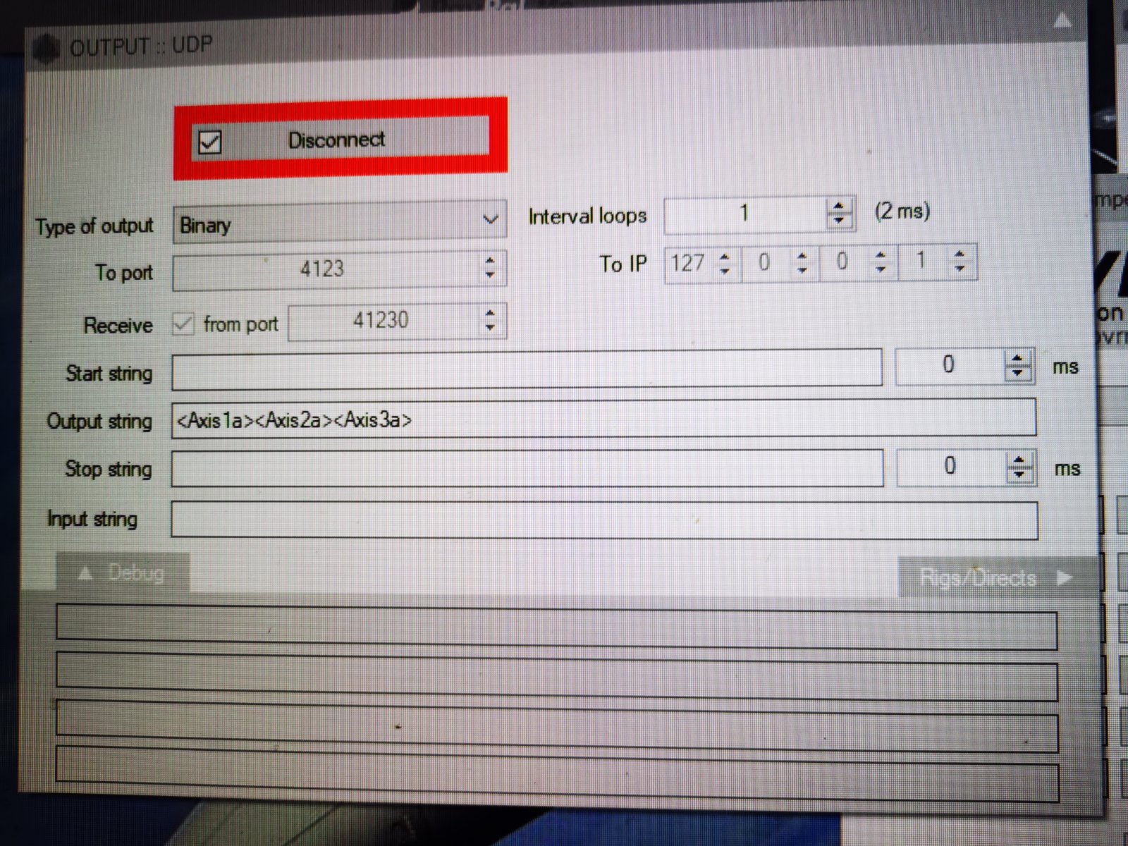

    Simtools can output data, but my Ethernet motion controller has no signal output and the servo motor has no action. What do I need to do to make the motor work? Thank you.

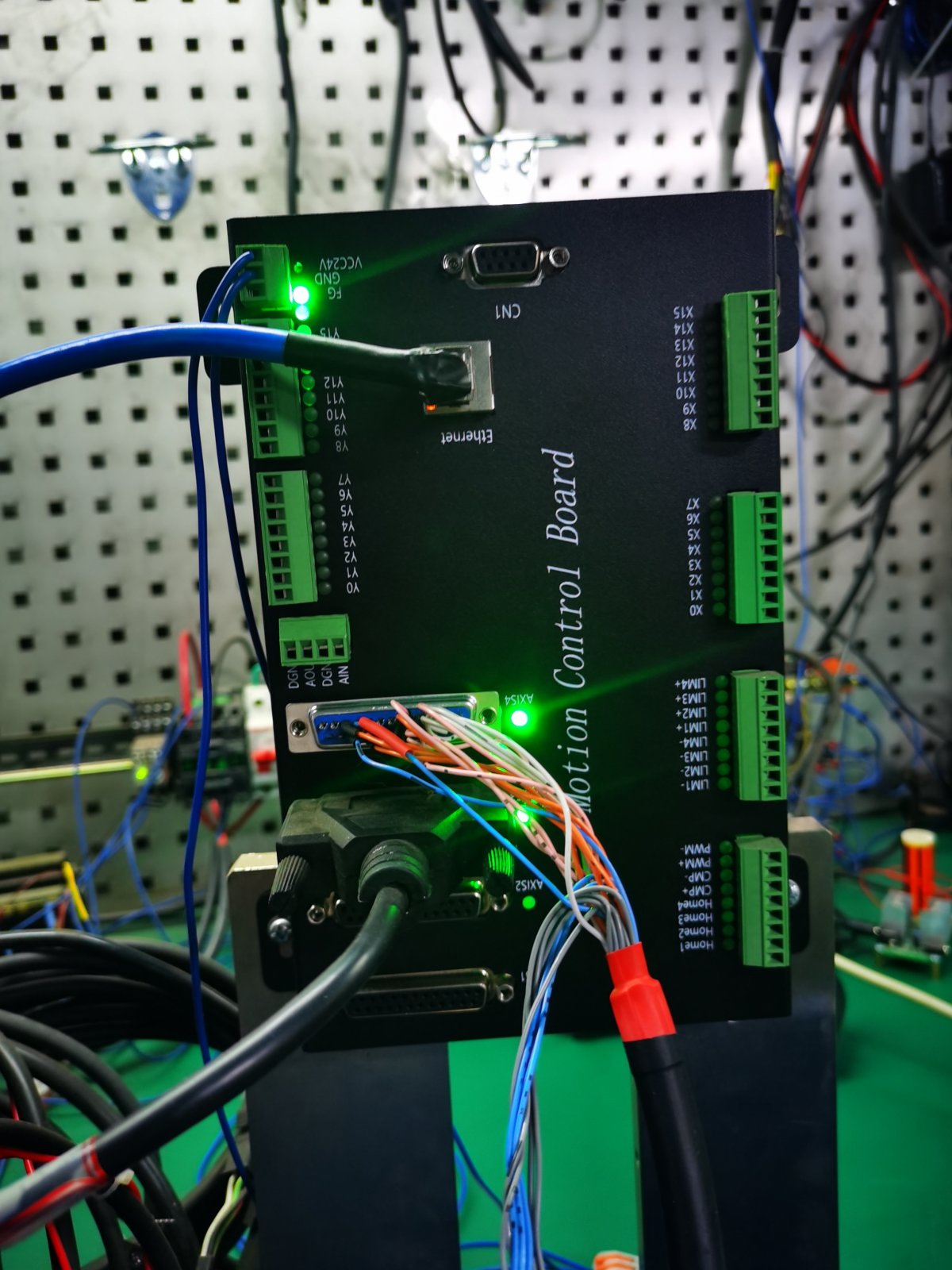

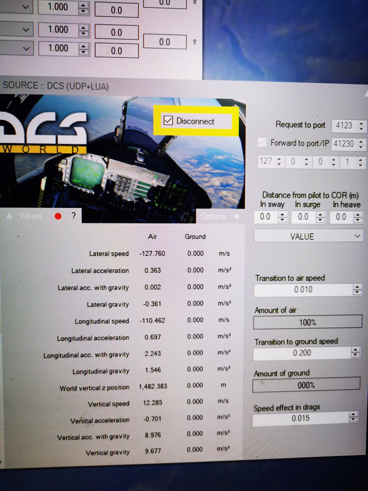

    I connect through the Ethernet motion controller (black card), and then use the output of flypt or simtools as the signal source.
    Both software can output data, but my servo motor doesn't work. It seems that the output data is not transmitted to the servo motor controller. Here, I really don't understand. Thank you.

    No, these are not plug a play to any motion software we use... who told you it will work?

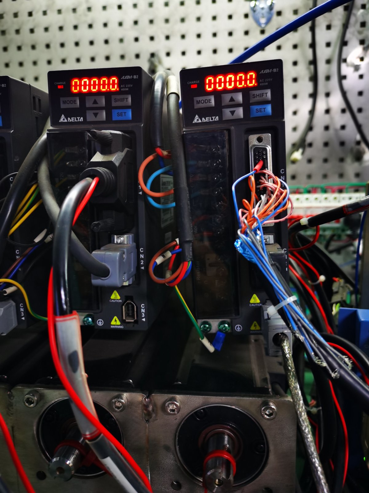

    If I use AMC aasd-15a, can I connect to any brand of servo motor driver through simtools? For example, I use Delta asda-b2. What else should I do after connecting? My flight simulator needs to rotate 360 °.

    No, the AMC-AASD15A controller is designed to be plug and play with AASD-15A servos. It can be also interfaced to some other servos, like the Dorna M1 or Syntron HS but with custom wiring. But these are just a handful servos that are verified they can work directly with the AMC controller signal voltages (5v logic level). Most Servos in the market are designed to be used with PLC automation systems that use signals from 12v to 24v levels, so their optocouplers may not work well or at all with the AMC controller. I tried Delta servos in the past, they simply don't work.

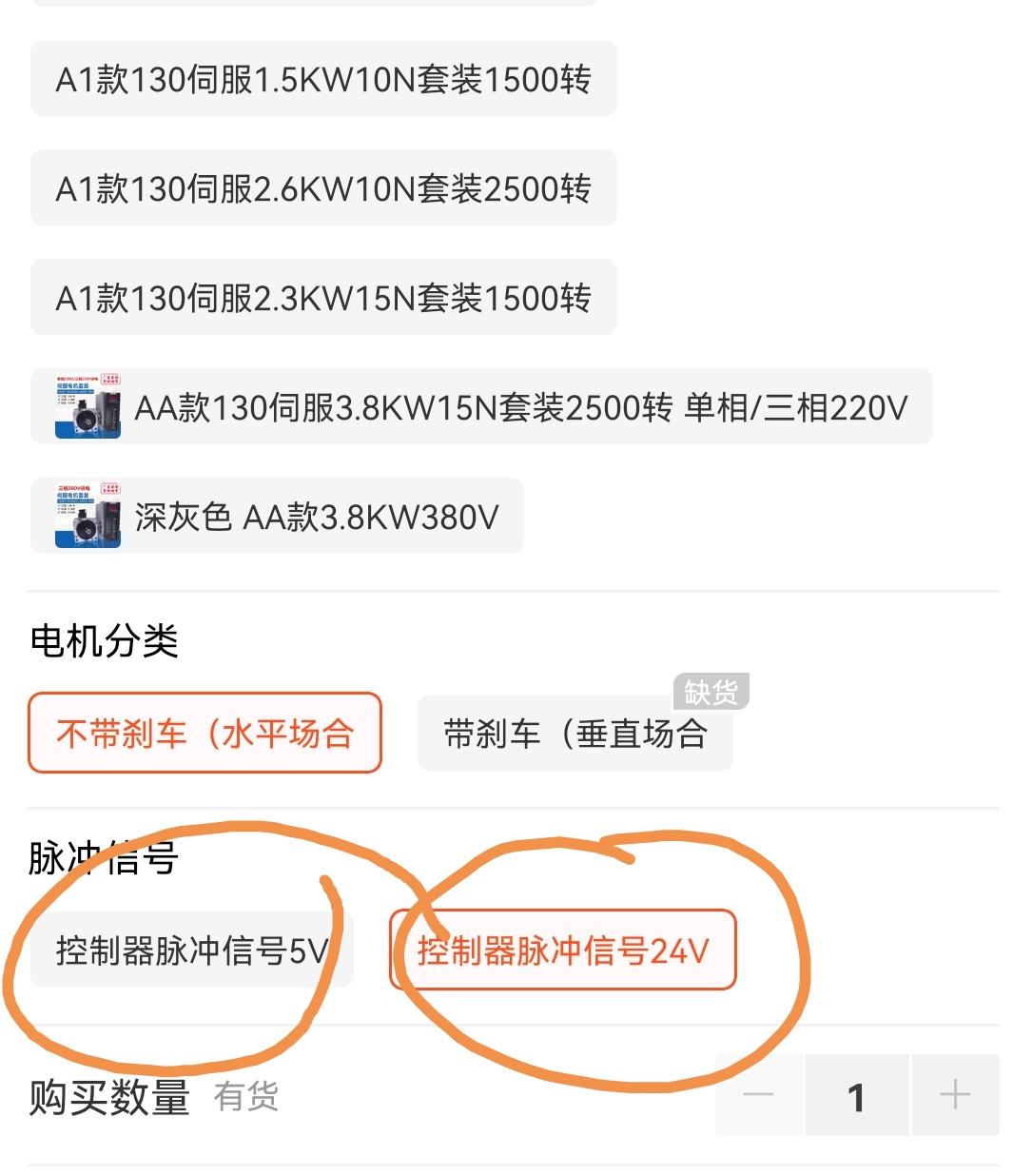

    Can I use the AASD-30A drive?
    The drive is divided into two versions: 5V and 24V. Which one should I buy?

    What is the 5v or 24v for? For the control connector for the signals? Can you show where did you see that?

    I saw it on the website in China, and what I drew out was that this shop can provide servo drivers with two voltages.

    I can't copy and paste the Chinese from the photo in a Google translate to better understand what they mean, but usually all AASD drives I seen are 5v compatible.

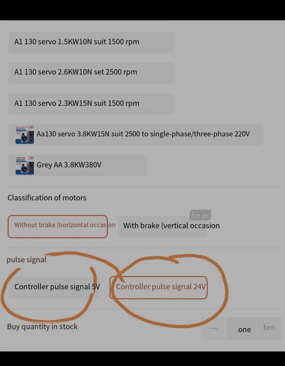

    I need to buy AASD-30A servo controller. The following figure shows two control voltages of this controller. Which one do I need to buy? Or just buy the standard version. I match the motor of 130st model.

    The AMC-AASD15A controller uses 5v control signals. If you plan to use PLC automation (for manufacturing) these use 24v signals...
