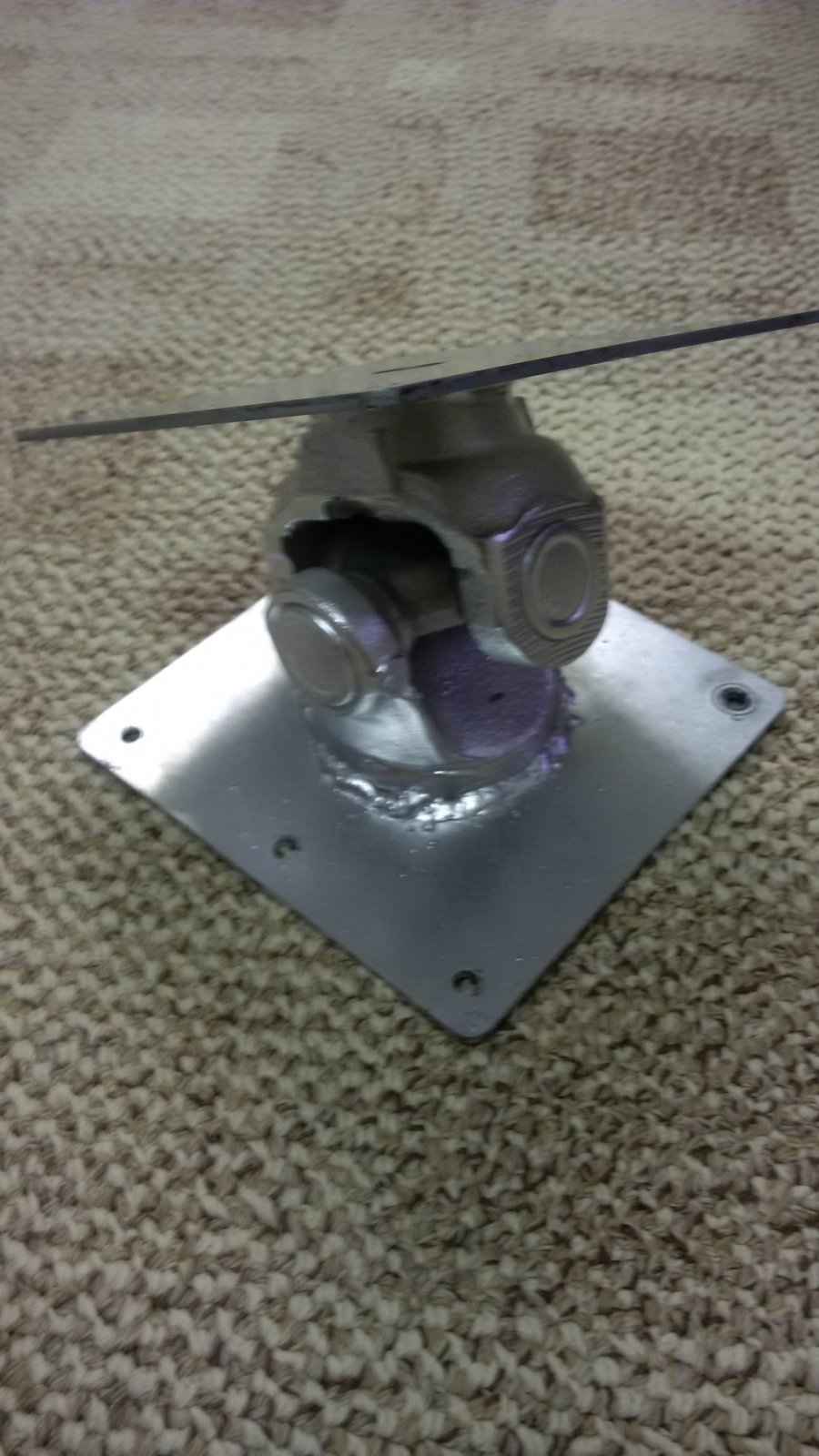

    For so great universal joint?

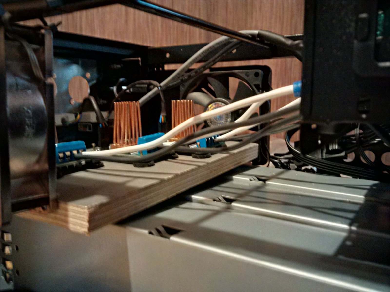

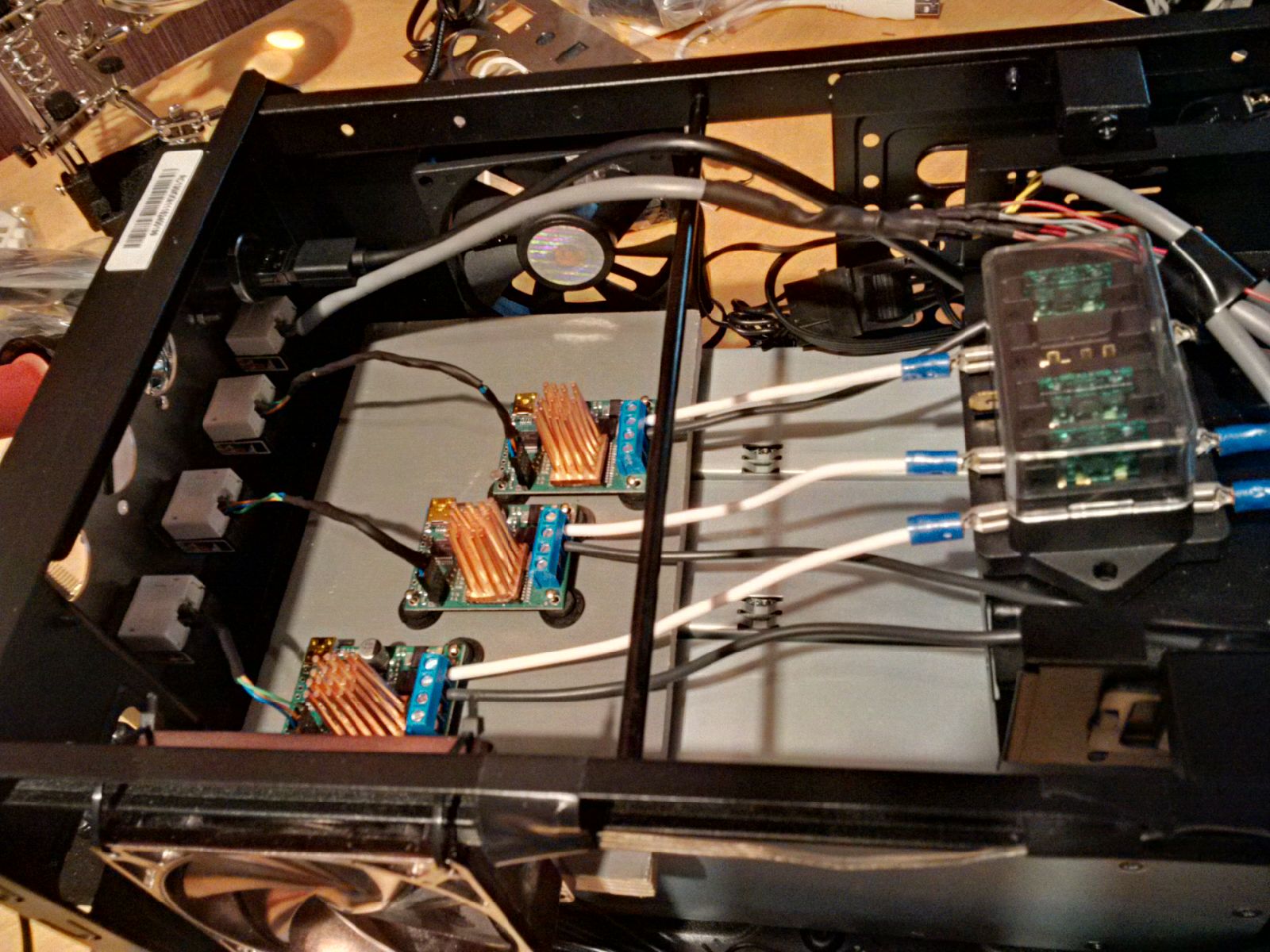

    More progress on the electronics. I'm just waiting on the USB hub and short usb cables for the inside. I'll have the JRKs wired up tomorrow. I have my cat5e cables done for my eSstop.
    I have 3 fans running. 120mm pushing air inside, another from the side 80mm pulling in air and another 80mm pushing out air. The latter two will be providing air flow for JRKs. Photos to come.

    Translation: Why do you use such a big universal joint? (btw I like it :) )

    From what I have read here, smaller joints may need supports added. This larger joint is strong enough for a very heavy setup and there is no risk of it buckling / breaking.

    Bigger is better syndrome ? :think..................:thumbs

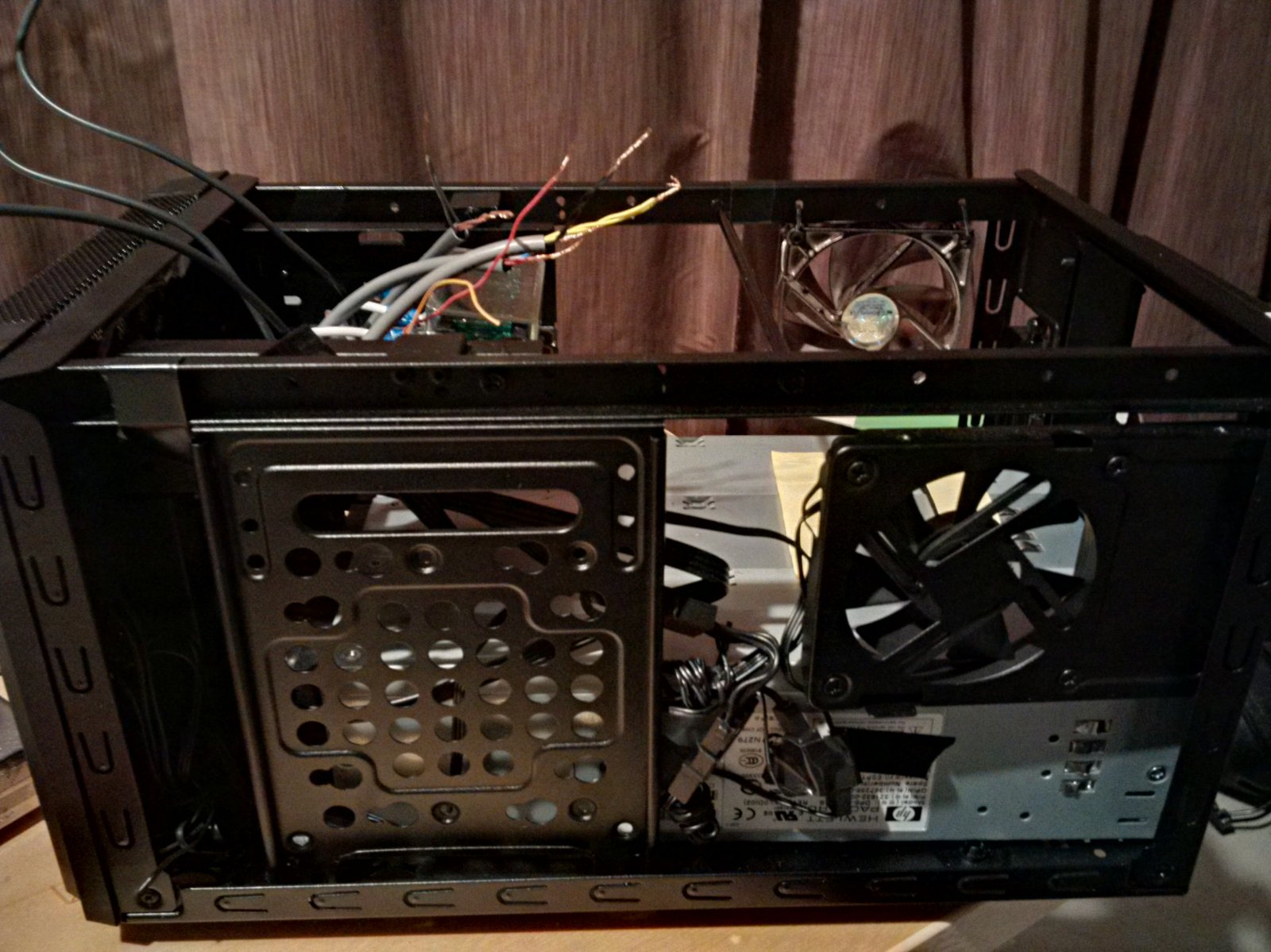

  10. Sebj
    Sebj Active Member
    Nov 13, 2014
    287
    Canada
    492Coins
    +165 / 1 / -0

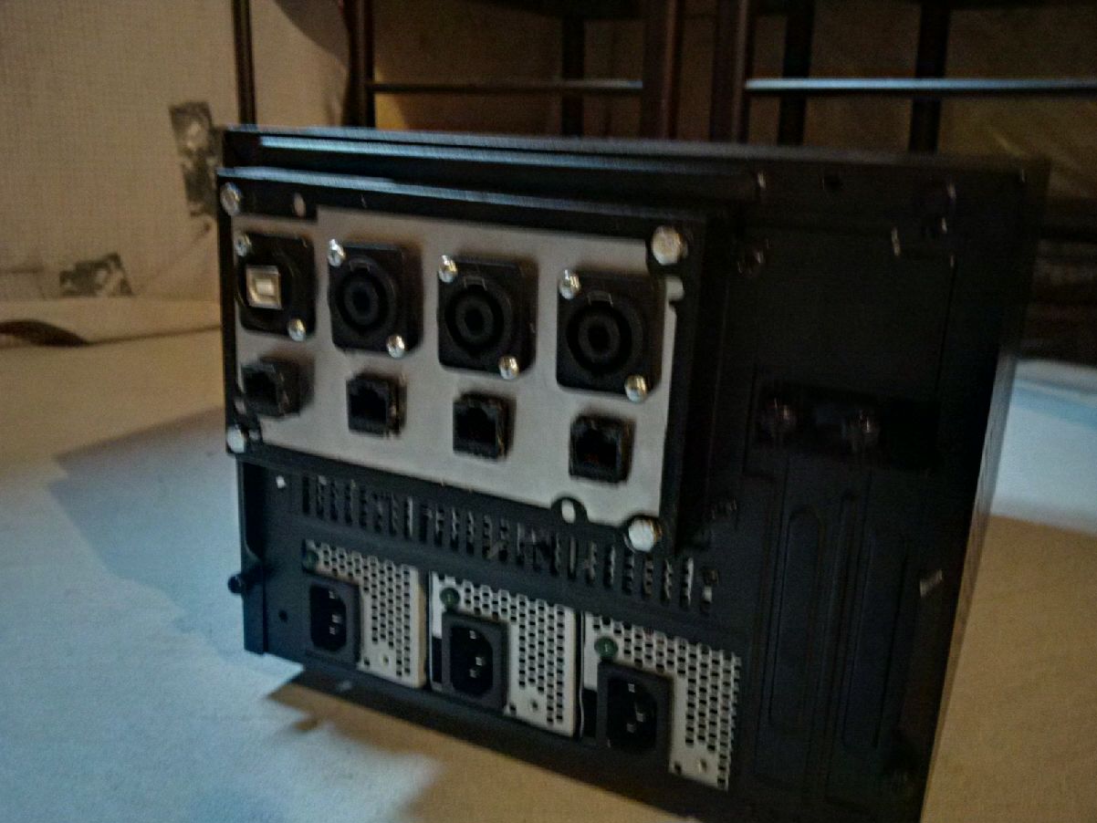

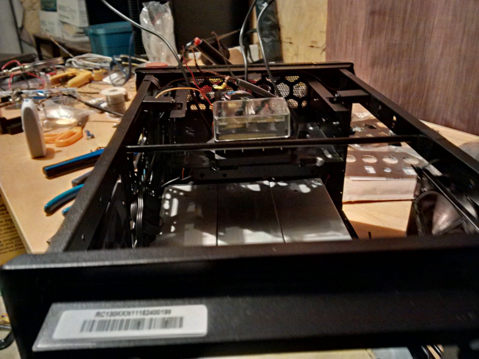

    ..almost done electronics

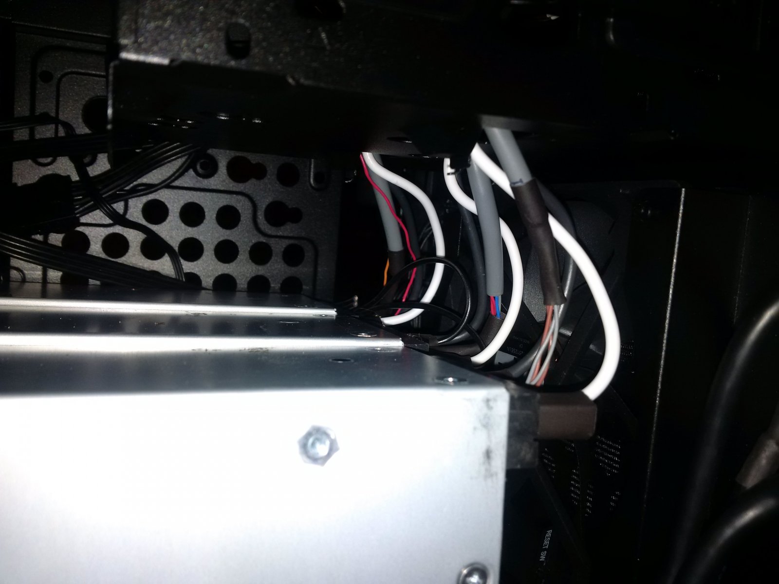

  11. Sebj
    Sebj Active Member
    Nov 13, 2014
    287
    Canada
    492Coins
    +165 / 1 / -0

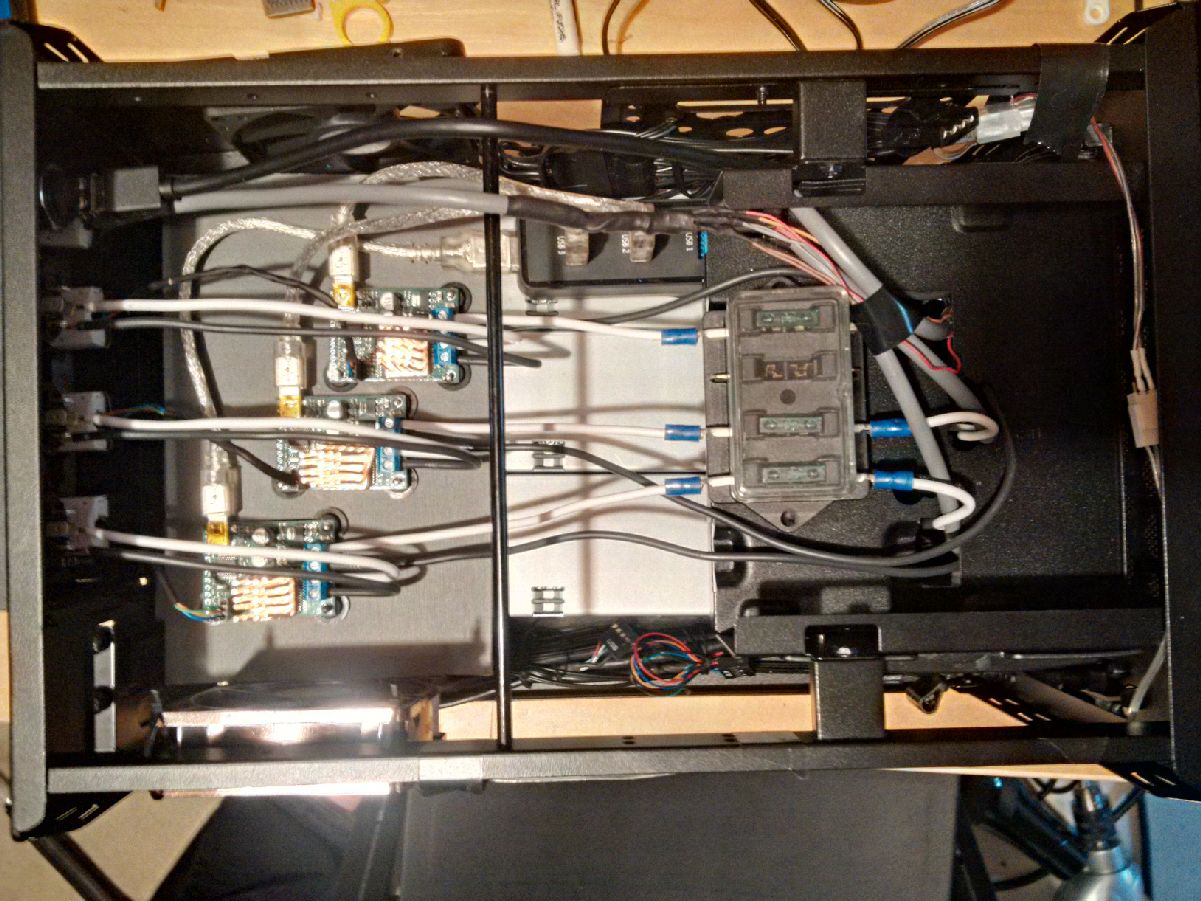

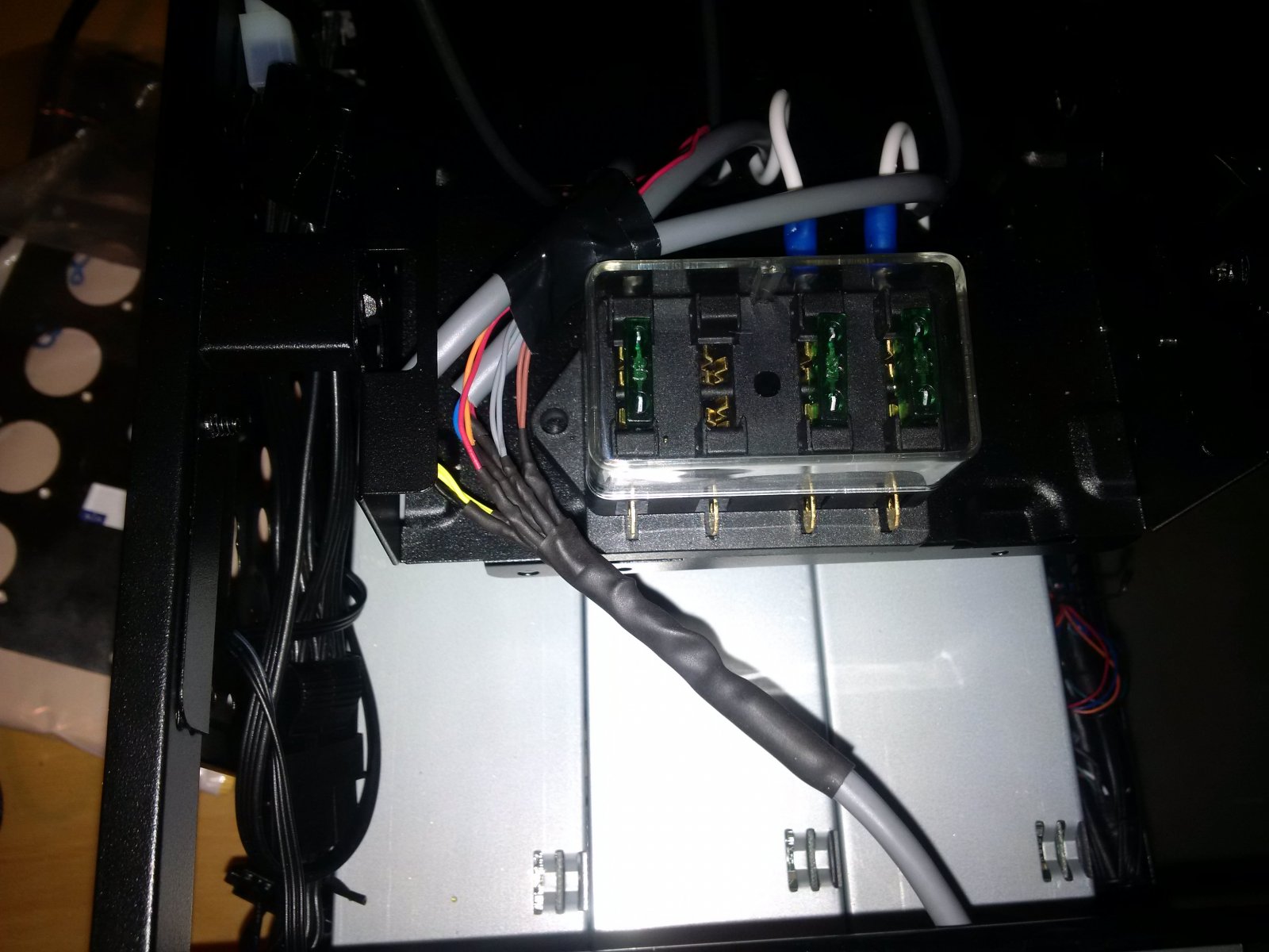

    Electronics all done! I really enjoyed this part of the build.
    I plan to connect the Cat5e cable to my eStop so I can turn on the power and configure the JRKs to windows. Potentially a project for this week :)
    IMG_20160131_155351_hdr.jpg IMG_20160131_155408_hdr.jpg IMG_20160131_155031_hdr.jpg

  13. Sebj
    Sebj Active Member
    Nov 13, 2014
    287
    Canada
    492Coins
    +165 / 1 / -0
    Hi, thanks for asking. I was having an issue with my cat5e cable wiring in order to get the PSUs running with a green light ie. jrks working. Really really strange as all the individual wire leads coming from the PSUs themselves worked but once in the cat5e connector some voodoo occurred and the wiring no longer responded with any logic. In the end I got if all to work but only through trial and error matching wires. It was as if there were wires crossed between psus but of course they were isolated.
    Anyhow I will get the JRKs configured in Windows now.

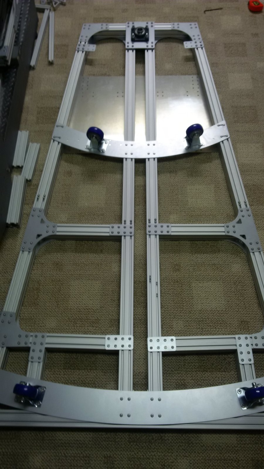

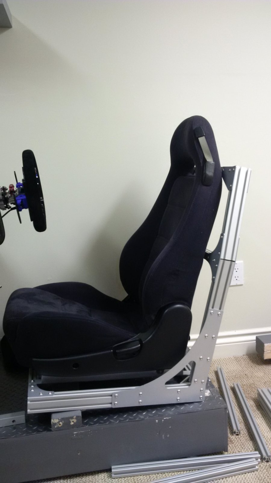

    Sebj Active Member
    Nov 13, 2014
    287
    Canada
    492Coins
    +165 / 1 / -0

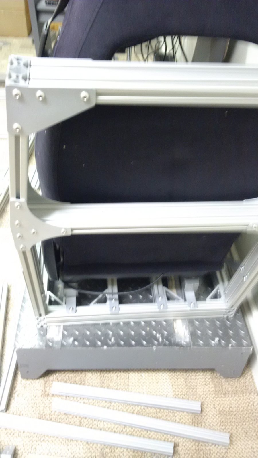

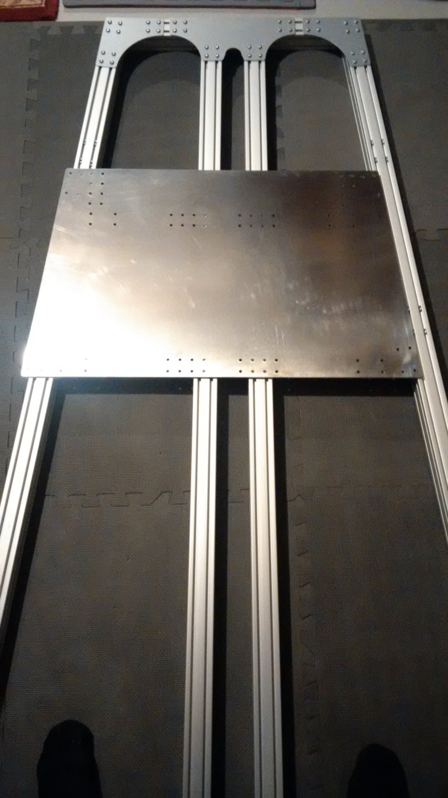

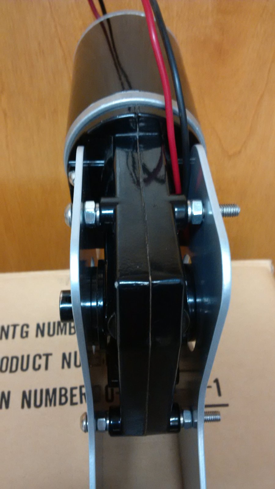

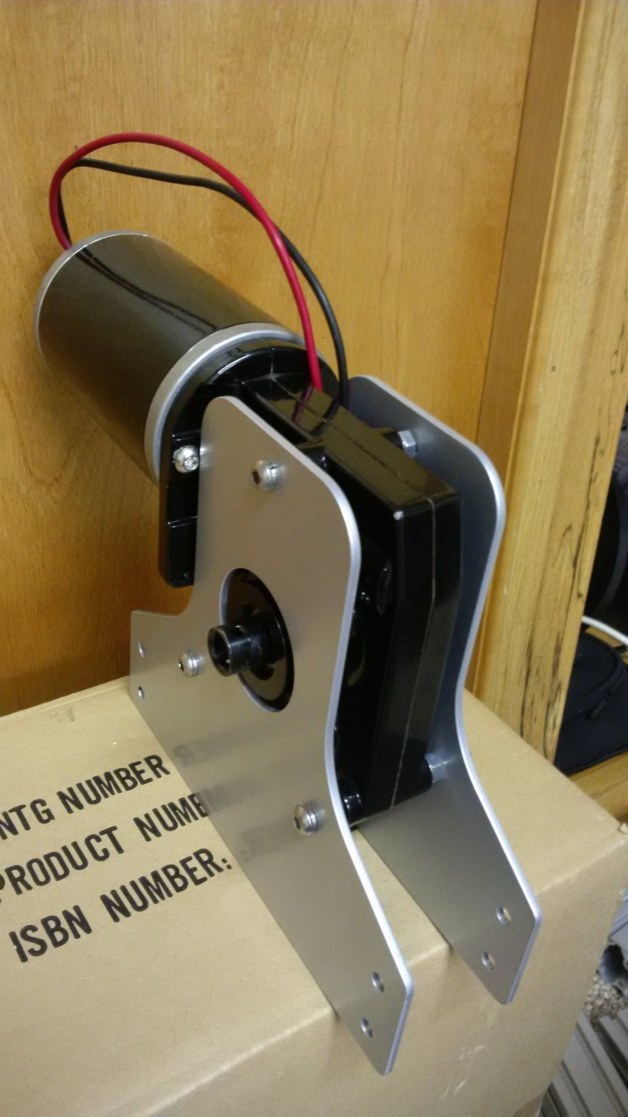

    IMG_20180407_163809.jpg IMG_20180407_163746.jpg IMG_20180407_163740.jpg IMG_20180407_163619.jpg IMG_20180407_163608.jpg IMG_20180407_163638.jpg
    After a baby and a house move, finally moving forward again.
