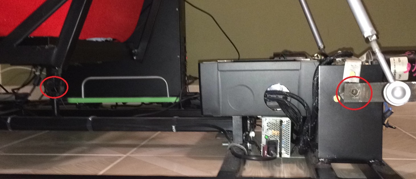

    @noorbeast is there a guideline concerning height of CV relative to the motor shaft? On a seat mover like mine.

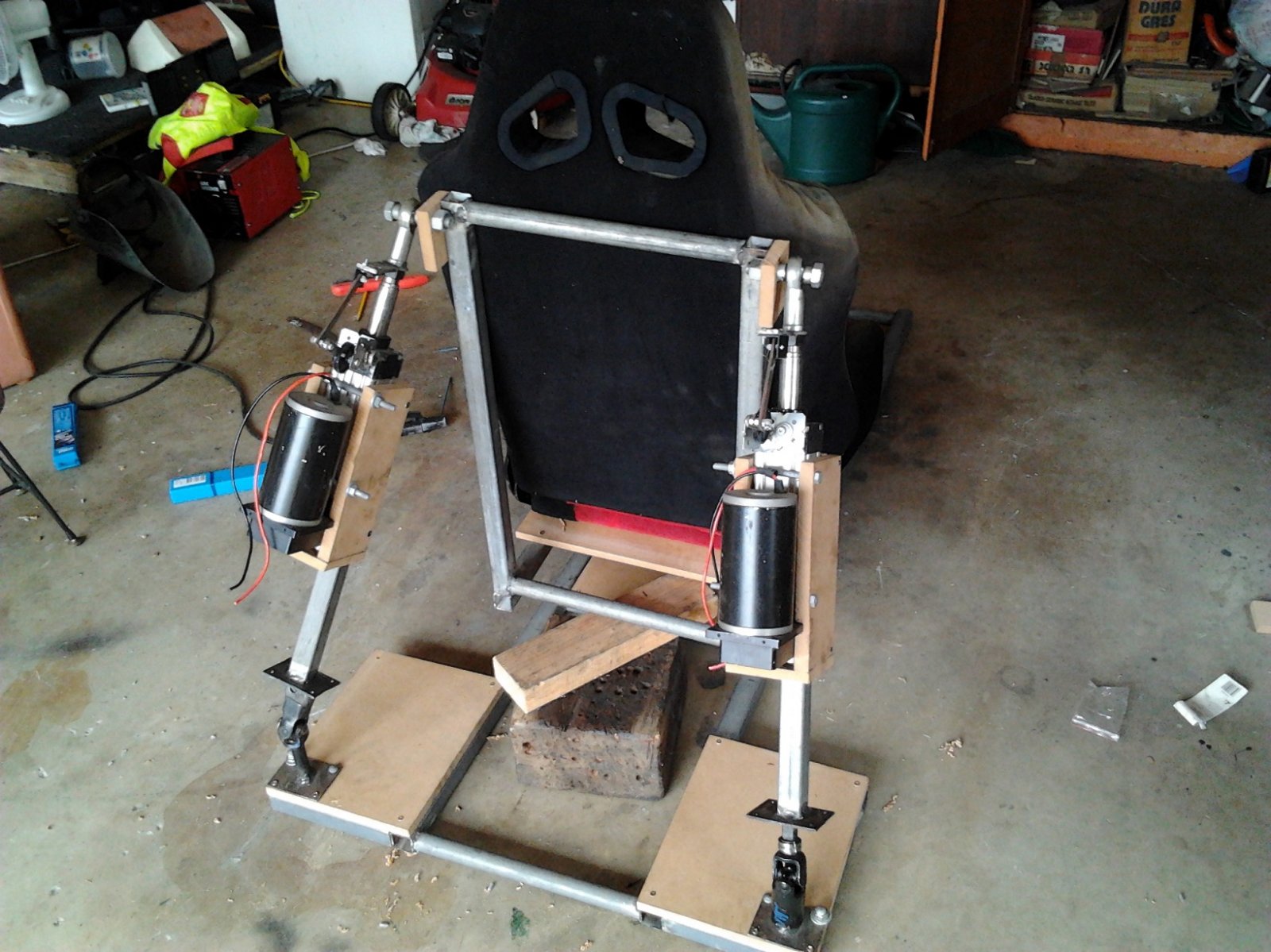

    if you are asking about this
    i have it at the same hight. may not look like in the photo but they are.
    i did it like that on my own but i would like to know too what would be better for our use to be same, higher or lower? @bsft could you help here as you have gone through some builds?

    @insanegr exactly what I was asking, thank you for recognizing that and posting a picture.

    Hi there, I was having a think, this is more or less how ive built my stuff.
    Motors stay as low as possible to the base, mostly because of bracket flex and also to keep them neat.
    Pivot is as high as possible under the seat as its the best place for getting the seat to balance in motion. Dunno why,I was told to do that, so I did, and it works fine
    although a low cut pivot is just fine depending on the build planned
    20151116_093937.jpg yes I am up to something.
    Although saying about motor placement, with my brickie actuators, obviously I could not mount them lower down, the small unis are above the pivot height
    Get the uni right under as much as possible.
    Dave.

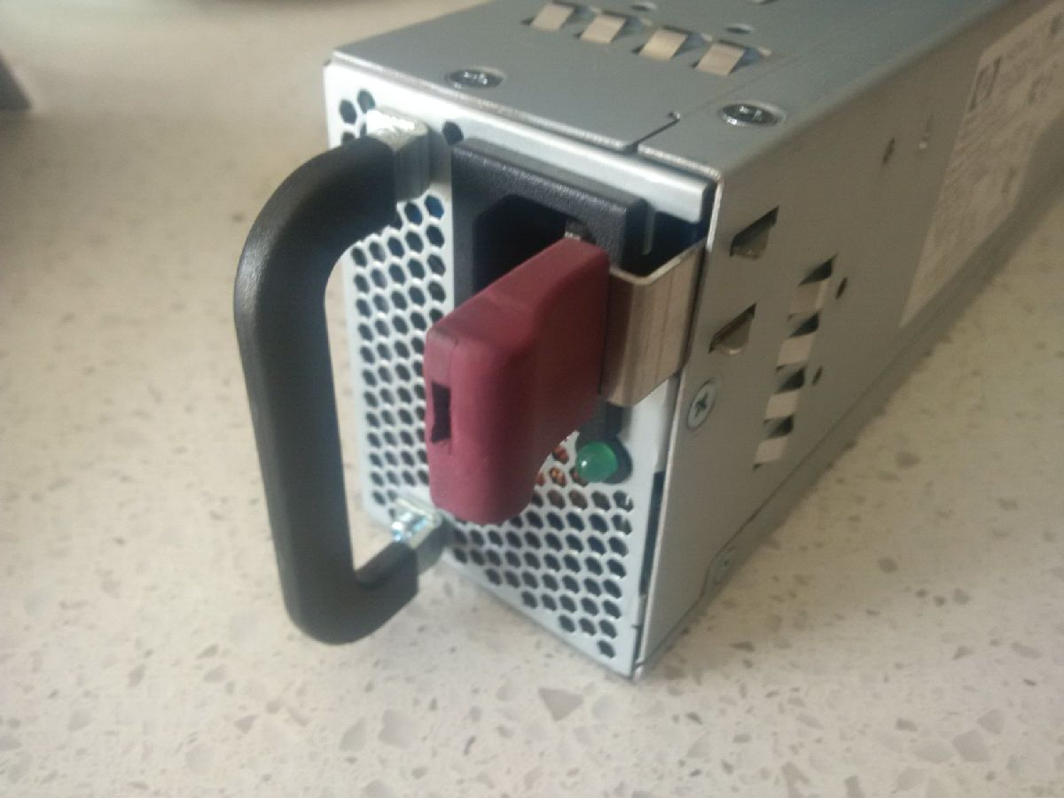

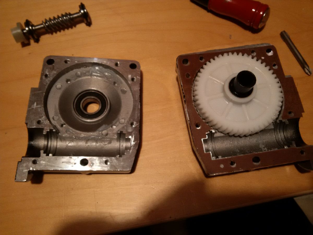

    I started a few things. Still waiting on some electronic connectors before I start the electronic build.
    I removed the handle and purple clamp piece off the PSUs.
    I also swapped the gear in one of the gear motors. It was actually quite difficult as the ball bearing loops were really wedged in there so had to finesse those out and also getting the thing back together was a challenge due to a rubber piece moving around that sits in the connector to the gear/motor housings. After some frustration I did manage to get it all back together again.
    Bought myself a new soldering iron on sale 0-60W adjustable and a third hand as well. Looking forward to the electronics.

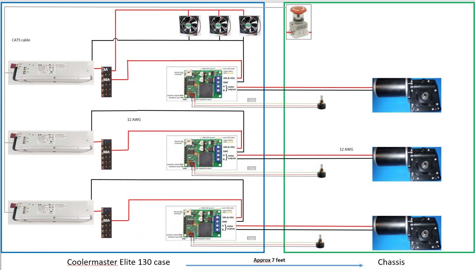

    Here is my updated wiring diagram.
    I took out the relays and I am connecting the eStop to the PSU's via a CAT5 cable. This will allow me to run minor V and A to the eStop to turn the PSU's off when needed.
    This really simplifies things. I will also likely use 12AWG wire for the main wiring (PSU->JRK->motors). Every wire will have a connector built into at the motor or Pot and at the case.

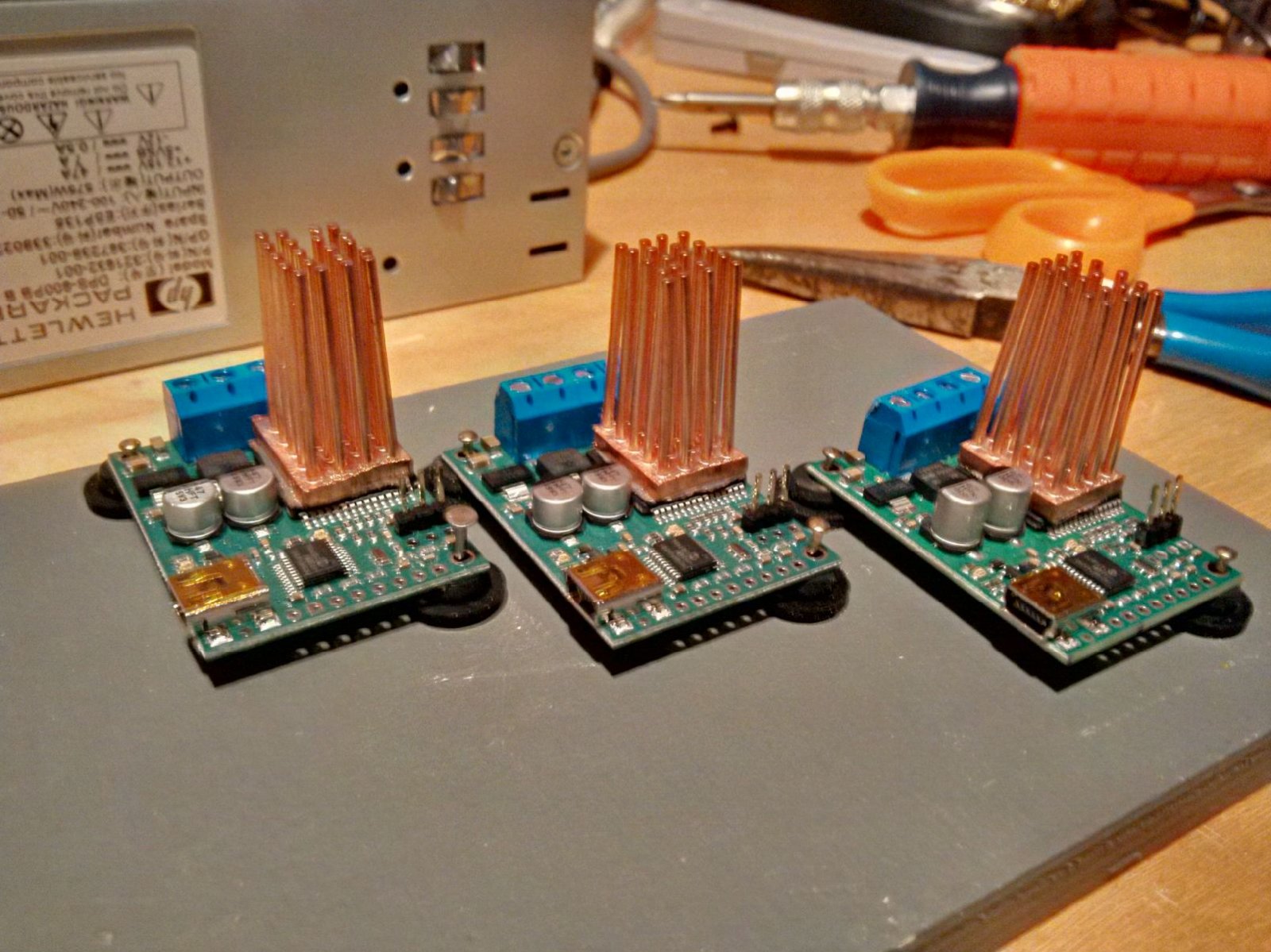

    An update.

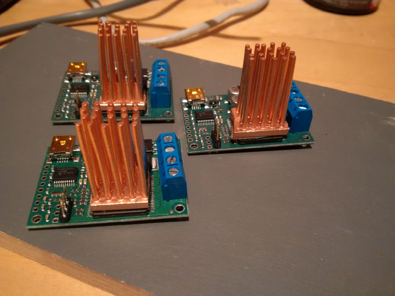

    I started doing some electrical items. I soldered up the GND and +12V terminals on the PSUs and setup the JRK's including heat sinks. I bought the heat sink in one piece so ended up having to cut three pieces. Now deciding on mounting hardware for the JRKs and then finish up the wiring.
    I had a custom backplate water jet cut for the case to handle the connectors.
    I'm posting a pic of the Enzotech heatsink if anyone wants to get one. It is all copper and long enough to make 4 or 5 little heatsinks for the JRK.

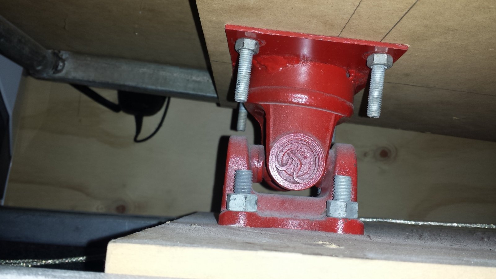

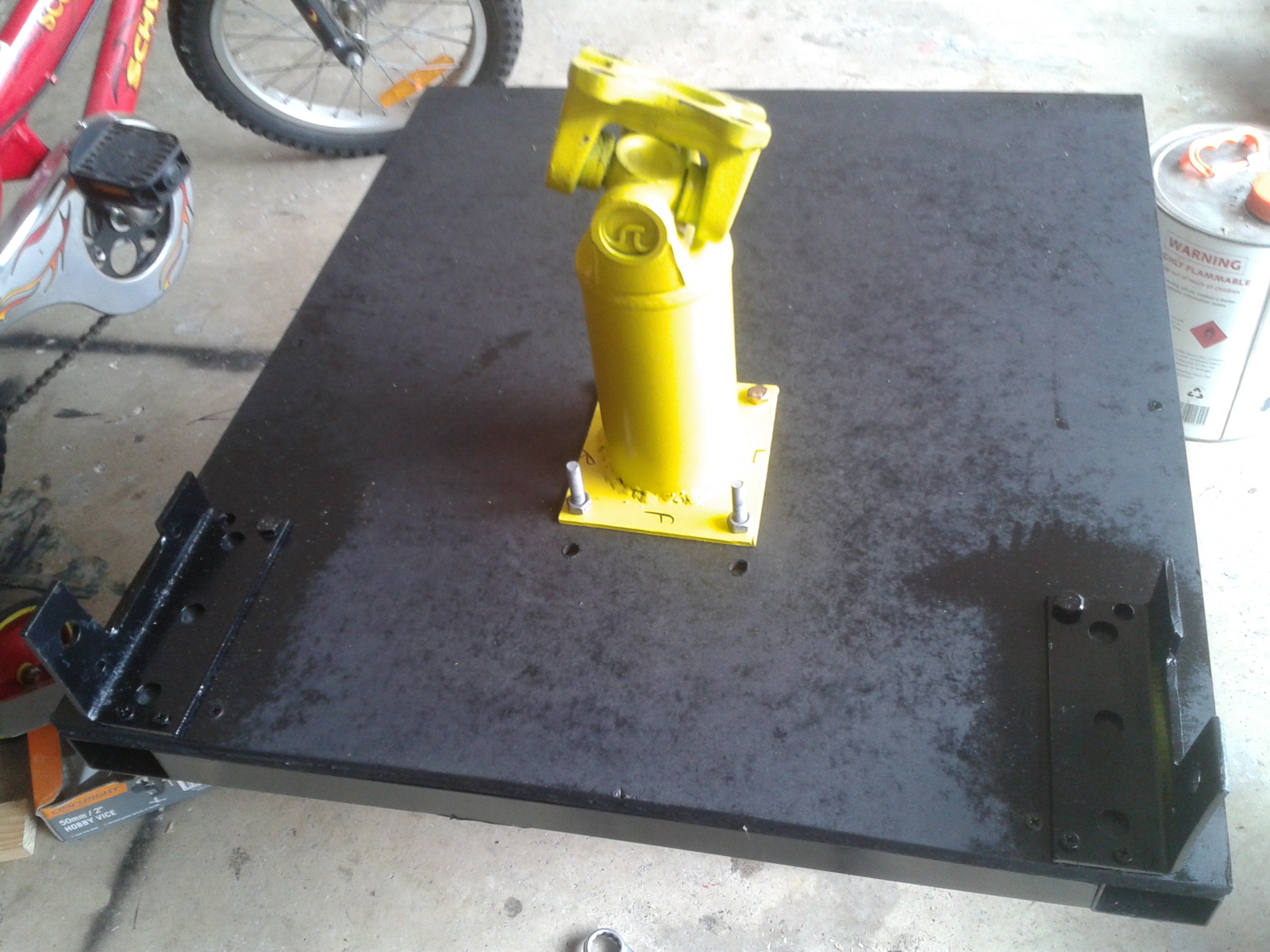

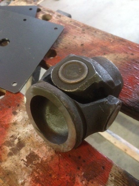

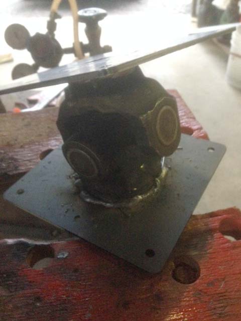

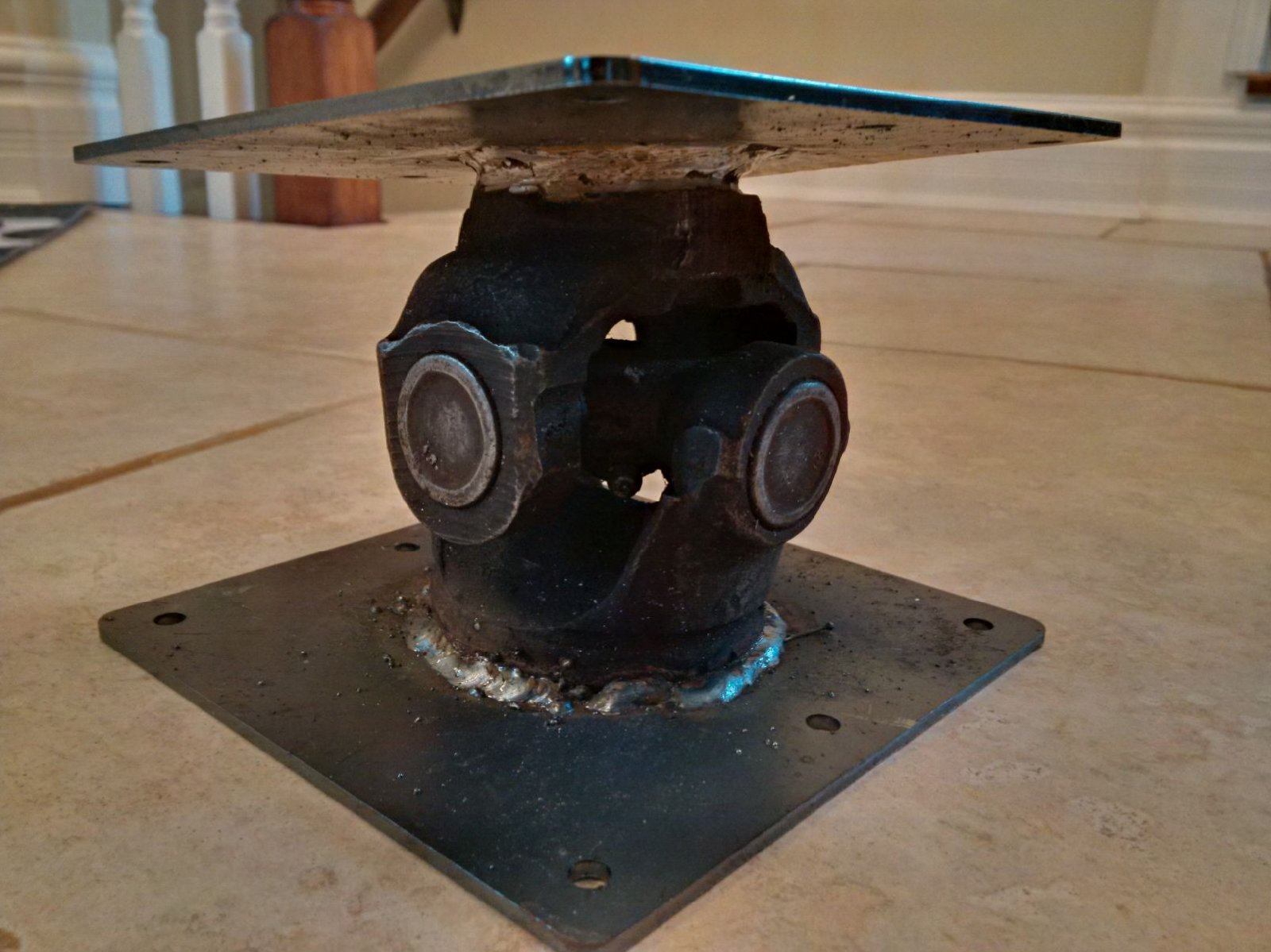

    Today I have the universal joint welded to two plates for mounting. Big thanks go out to @Steve spenceley for this.
    The distance between the two plates is 4 1/4 inches. The universal is cut as close as possible and welded to the plate that will rest at the bottom of the seat.

    pipis2015 over-boost
    Feb 18, 2015
    222
    Athens, GREECE
    10,248Coins
    +272 / 1 / -0
    gg on the u-joint.
    Such a strong part eliminates almost all rigidity issues.
    I wish every sim builder had access to one of these.
    No need for stability/flex bars and cleaner construction.

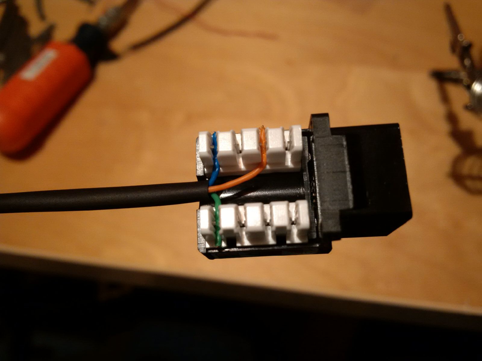

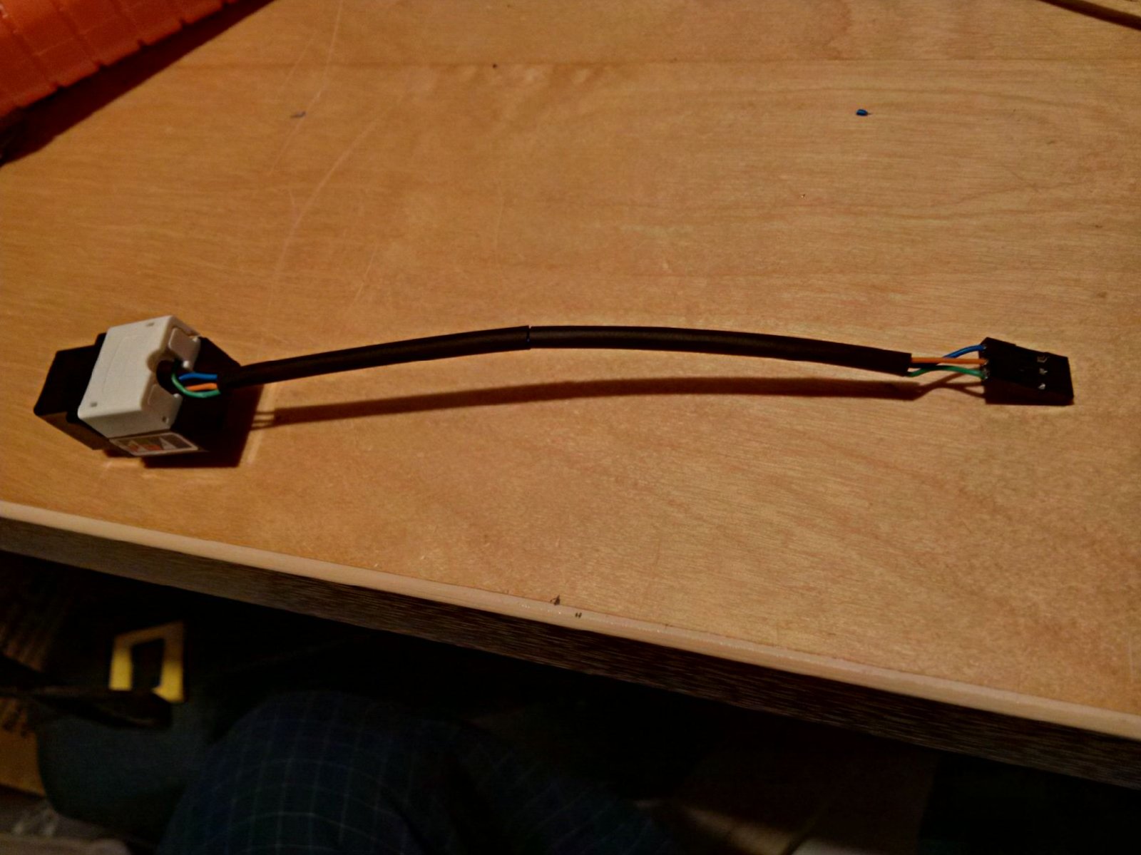

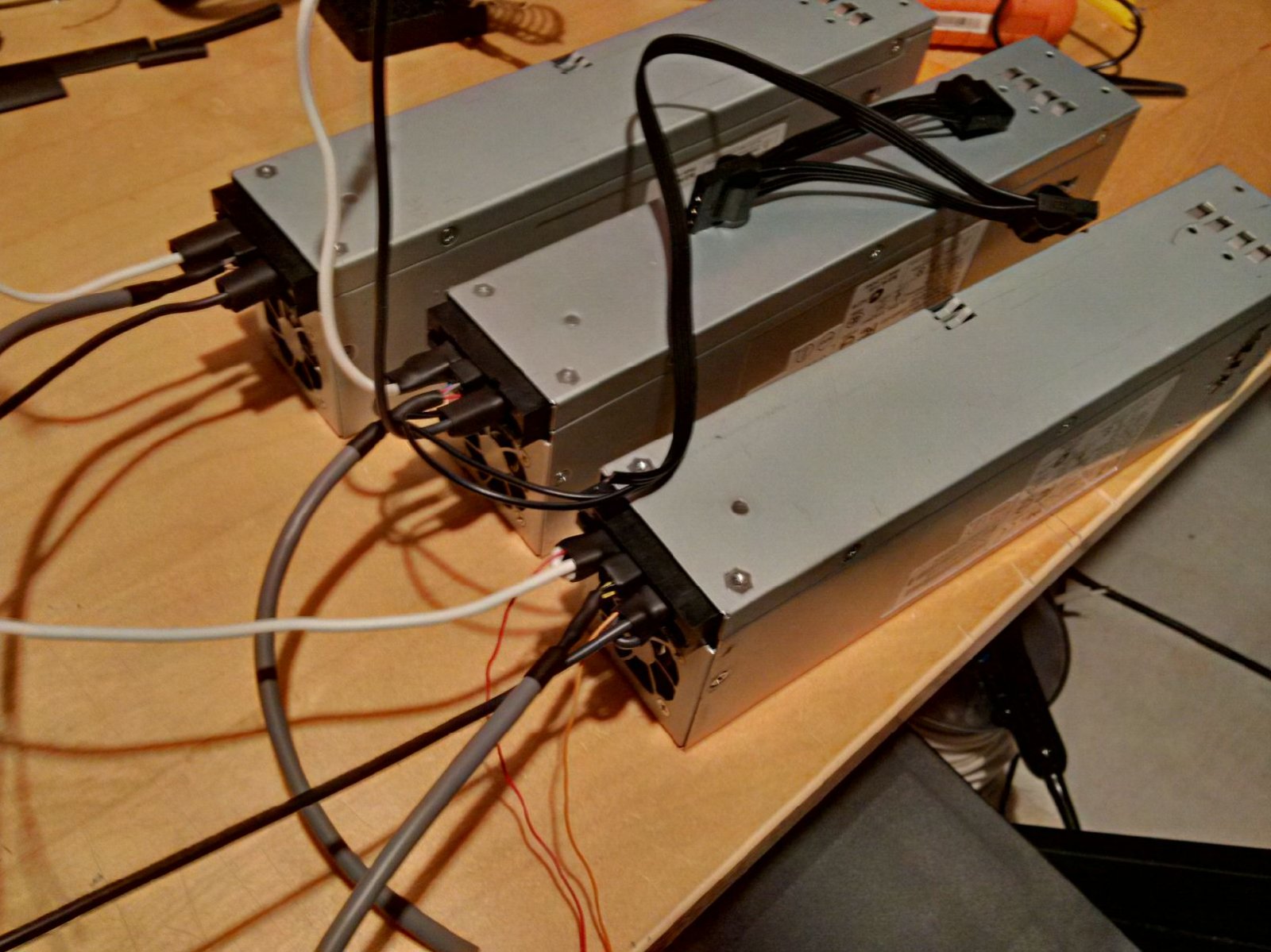

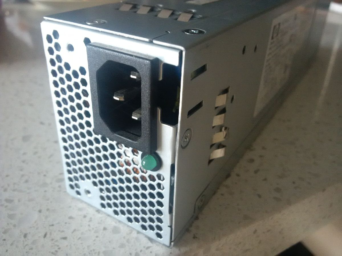

    Been making connectors and completing PSU cabling.
    What do you HP PSU guys do not turn off fan when PSU is 'off'?
    Fan keeps spinning when plugged in.
  19. noorbeast
    21,663
    151,632Coins
    +11,043 / 56 / -2
    I have my 3 HP PSUs on one powerboard and just switch that off.

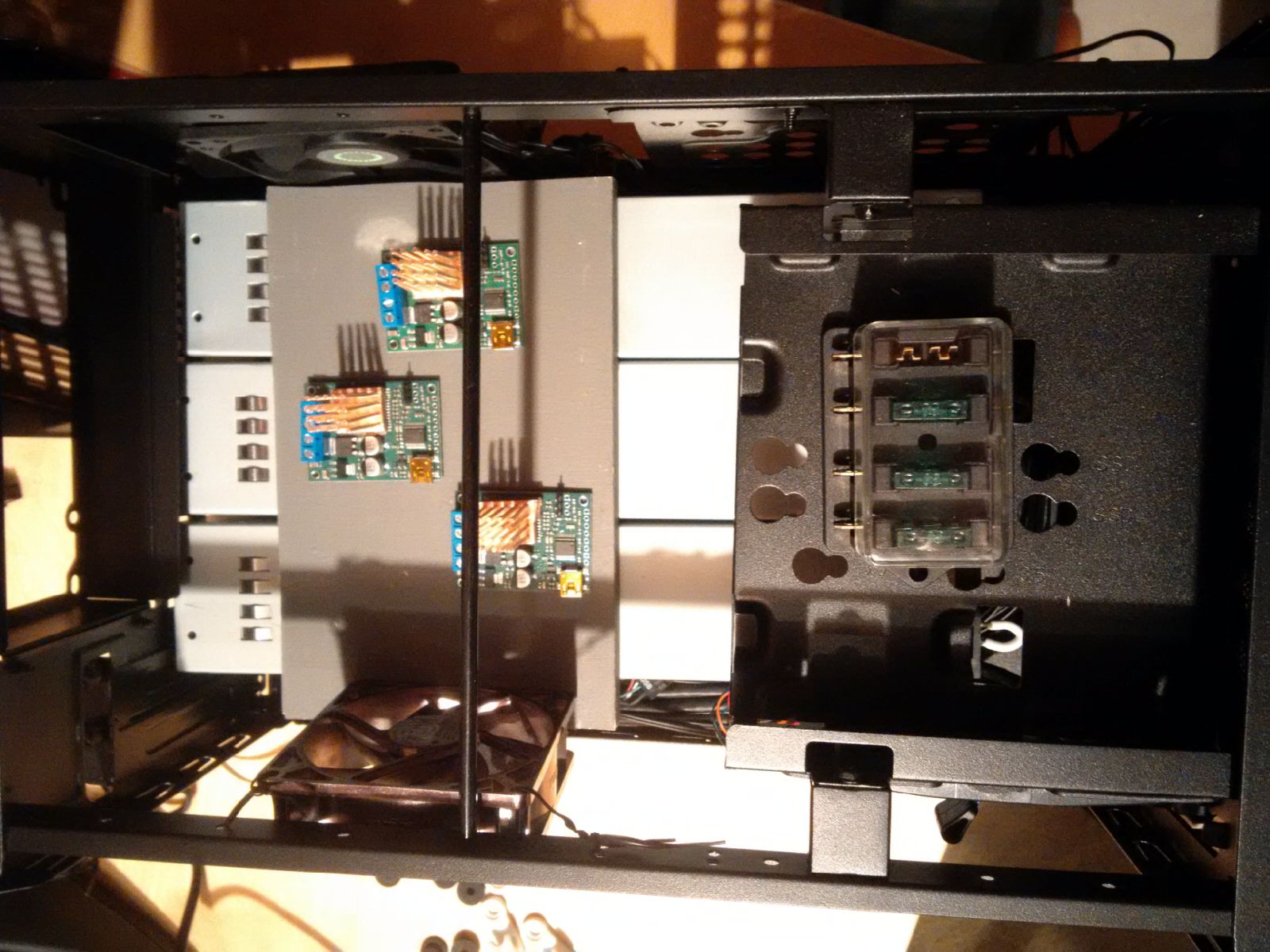

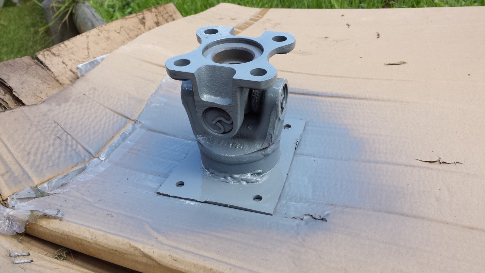

    Thanks to @Steve spenceley I have my universal complete. I need to clean it up and spray paint it. I find the universal has different extremes in the X and Y axes. Looks like I can get is 10.4 degrees to 27 degrees. Means the thing is limited to 10.4 degree movement in my roll axis. I think thats fine unless you guys say I need more.
    It is 1.75 inches from the top to the center and height is 4inches overall.

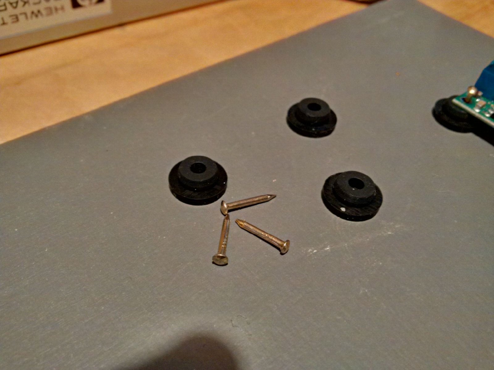

    I am close to completeing electronics. PSUs are all wired up and the JRKs I mounted on a piece of wood I had with rubber feet that are for mounting hard drives in my case. I put small finishing nails to hold them in place and it works just perfectly.
    IMG_20160107_160902_hdr.jpg IMG_20160107_163528_hdr.jpg IMG_20160107_165916_hdr.jpg

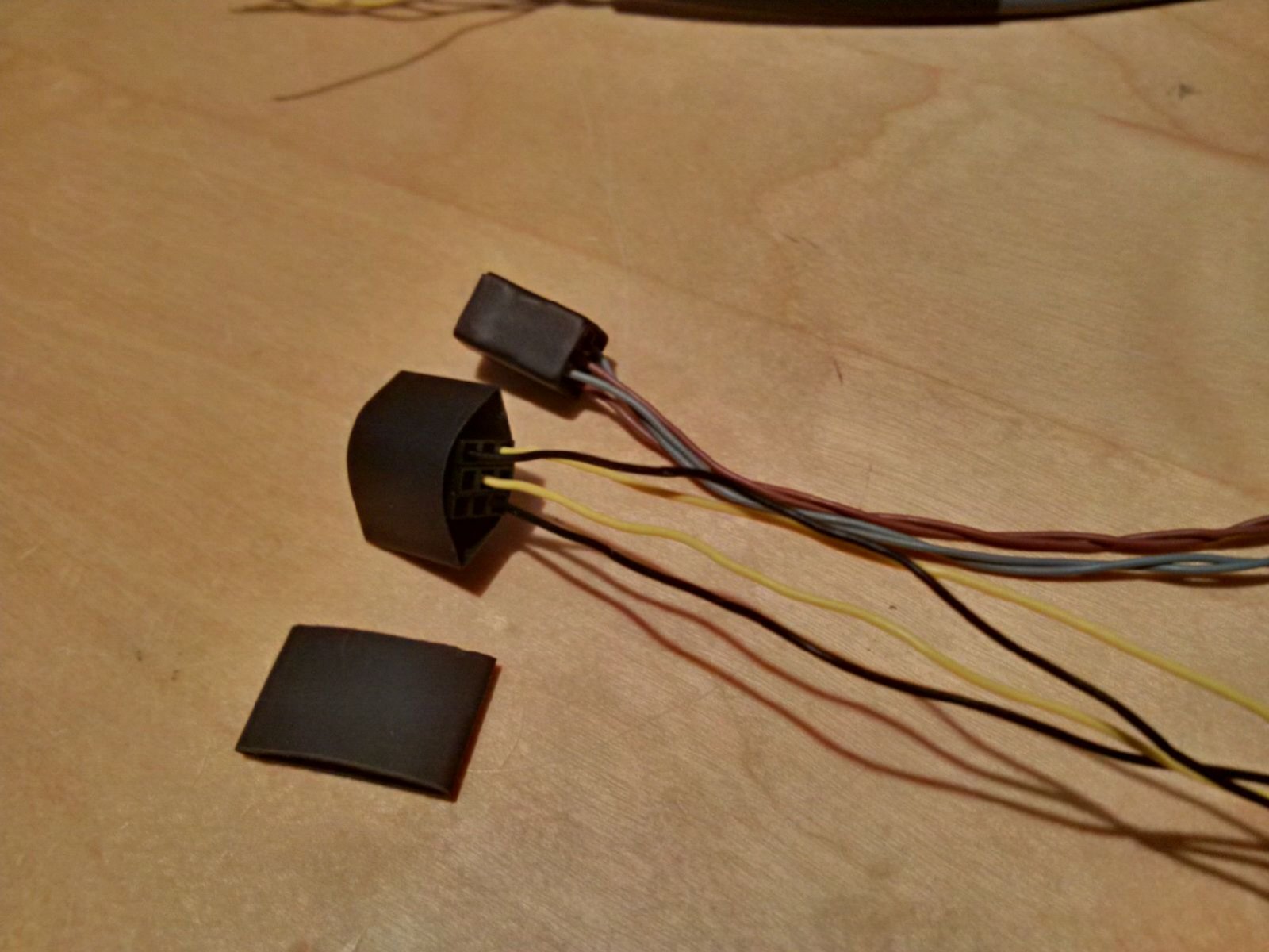

    I made all the connectors from parts as well.
    IMG_20151214_202631.jpg IMG_20151214_202728_hdr.jpg IMG_20151229_132254_hdr.jpg
