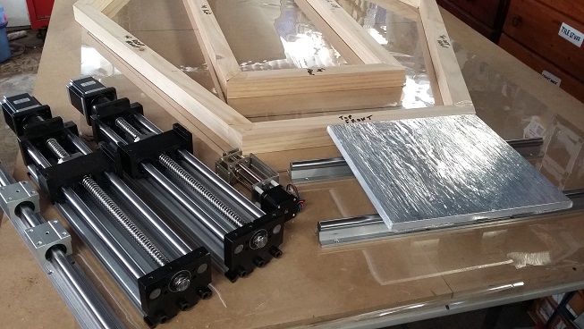

    Parts are slowly turning up :). Think I have enough now to start building the steel frame. Basically a 3D printer on steroids.

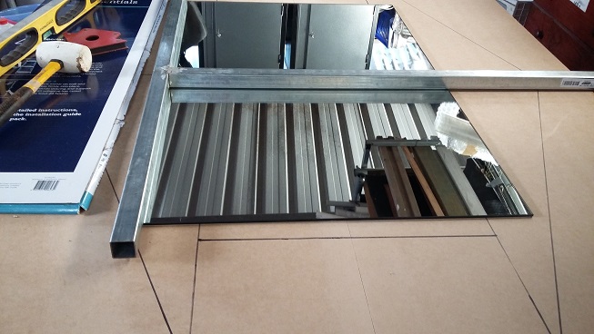

    Started on the CNC steel frame - I use a mirror to ensure alignment. FI. Base will only be half the size of the shown 'T'. First corner built this way, as it makes it easier to get it straight/flat.

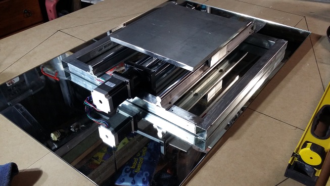

    It might be small, but it will pack a punch :). Build ticks along...

    Nice work @SeatTime
    Is that the plan for your new platform drawn on the wood underneath ??

    Yes it will form part of the mould. Two images back you can see part of the mould sitting on a mylar sheet.
