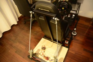

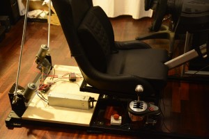

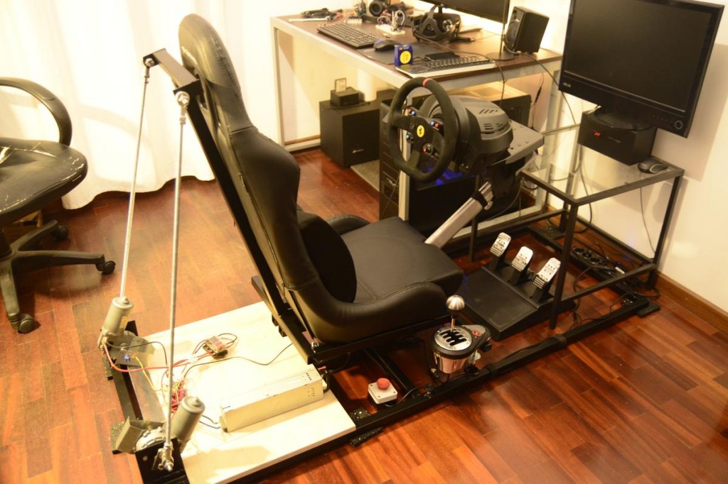

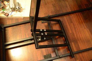

    Three years after building the first motion platform I took another step and built another one. Obviously I planned to improve on the previous and so far, it’s mission accomplished in multiple aspects! Two of the most noticeable improvements are the feedback system and motion response times.

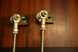

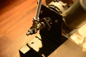

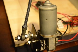

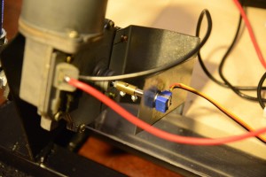

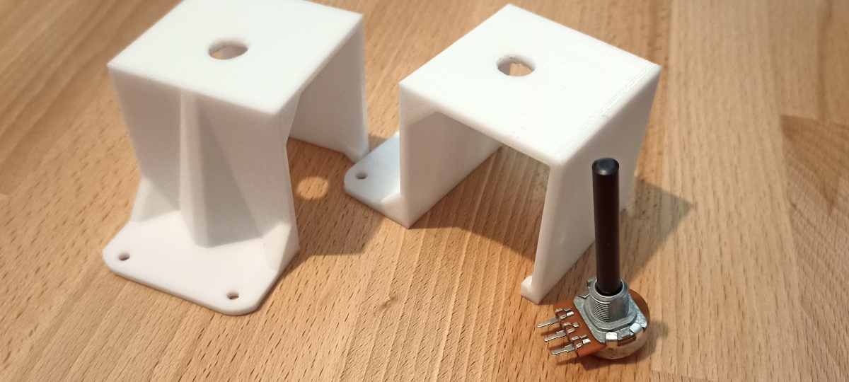

    The feedback potentiometers are now directly connected to the motor output, giving 1:1 readings, meaning nearly full ADC range, compared to the previous, ~1/3 range, this is a huge upgrade in terms of motion detail.
    Motion response times decreased a lot due to the position where the motor rods now connect to the seat. At shoulders level, away from the weight of the structure and driver, meaning that the motors have to move significantly lower weight. The top weight has also reduced since this is a seat mover, not a complete playseat mover (this can sound odd, especially because the pedals stay fixed, while the driver moves, but it is quite comfortable actually).

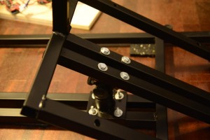

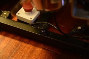

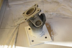

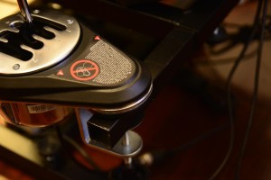

    Other improvements include a) seat closer to ground, making it easier for entering/exiting, at the same time, providing a better race feel b) lateral gear shift holder, adjustable c) modular structure, easier for transportation d) custom built motor bases, improved symmetry e) painted, looks better, rust free f) cardan is now mounted with bolts, allowing tiny adjustments to achieve structure symmetry g) cermet potentiometers – theorically these are way better than the plastic ones but honestly I’m not feeling an improvement, and one broke already – this is not bad, actually, because the cermet pots are way more expensive [​IMG]
    I haven’t built a monitor stand since I now drive with the Rift CV1 all the time [​IMG]

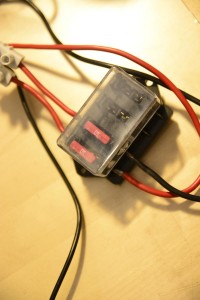

    All the electronics and some mechanical parts were harvested from the previous platform, including the truck wiper 12V/24V motors – this helped to keep the budget not too high [​IMG]
    I recently switched to SimTools due to X-Sim being more resource hungry and so far it has been a great experience. Especially with Dirt Rally! Coupled with Oculus Rift and motion, Dirt is one of the best experiences so far. Assetto Corsa was always amazing and rFactor2 is a legend, lacking VR support at the moment.

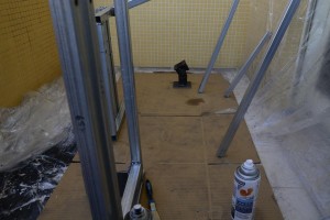

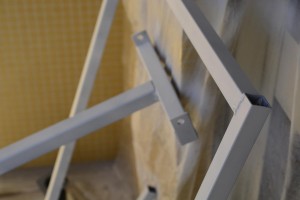

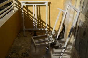

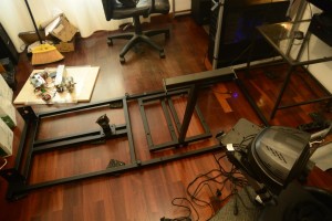

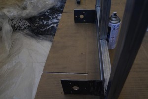

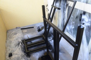

    All the pieces after welding, ready to paint:
    [​IMG][​IMG]
    [​IMG][​IMG]
    Assembly:
    [​IMG][​IMG]
    [​IMG][​IMG][​IMG]
    Electronics and mechanics:
    [​IMG][​IMG]
    [​IMG][​IMG]
    [​IMG][​IMG]

    • 4x M10 Female Thread Rod End Joint Bearing
    • 2x M10 threaded rod

    • 1x 16A quick circuit breaker
    • 2x 10A fuses + fuse box
