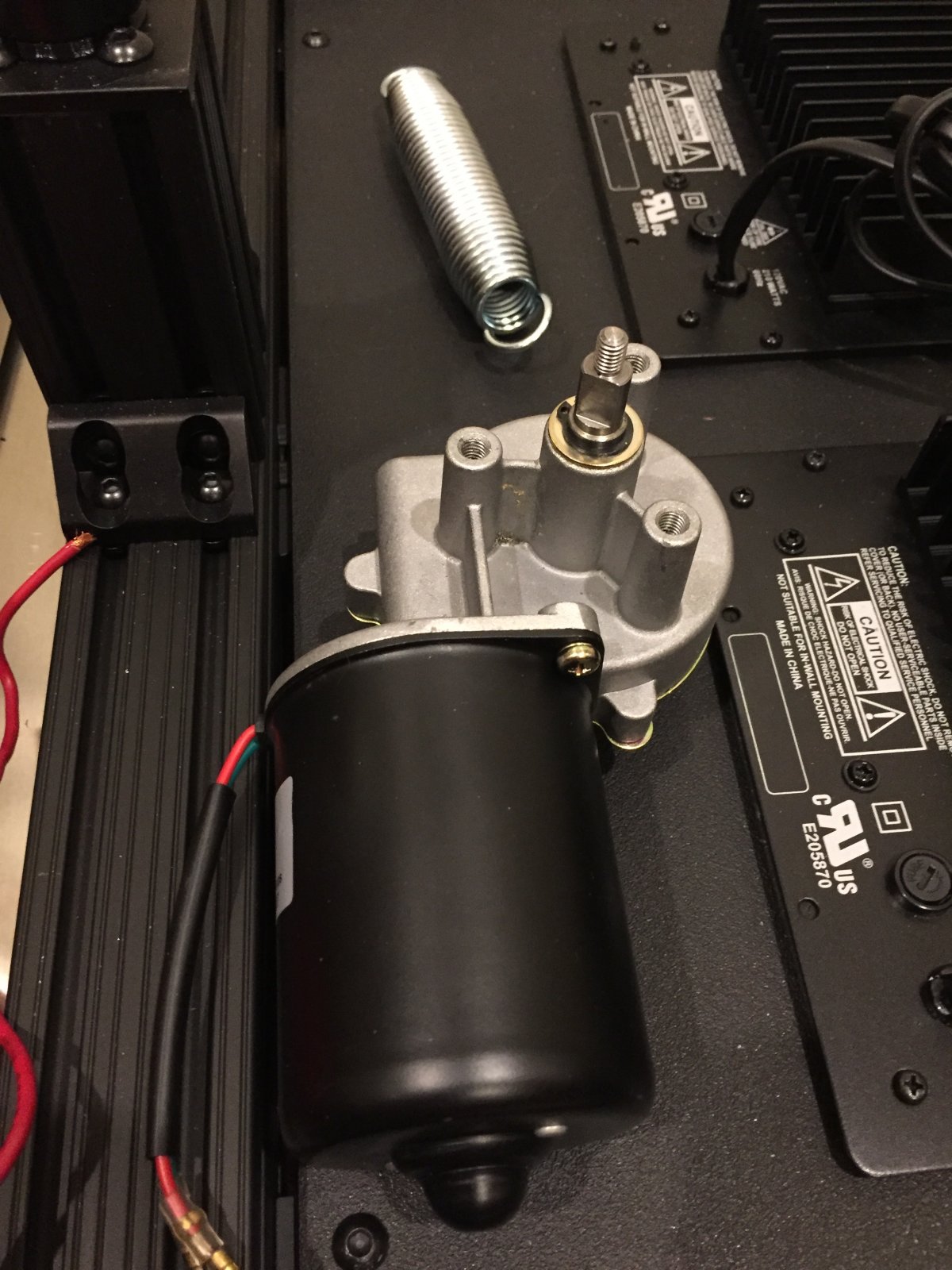

    I've decided to add a harness tensioner as I build my rig. I've looked around and @SeatTime's servo tensioners seems a popular design.
    Do those designs essentially put the motors into stall at full force? Has anyone used a gearmotor with an output arm with a spring in tension to pull on the straps? The reason I was looking at a spring is because Hooke's Law says that the force will be linearly related to spring extension. Instead of motors going into stall, and maybe I'm misunderstanding the servo designs, a gearmotor and output arm could set the tensioner force just by setting position. As long as the gearmotor/arm had the torque to pull the spring to full extension, it wouldn't stall and sizing would just be proper spring tension to get the proper force range with output arm and motor torque enough to get that range of spring tension.
    The only thing I can think of is that pulling against a spring is a bit unrealistic. Maybe add a hard limit to the spring extension so that at some point you hit the worm gear lock kind of like pulling on a regular seat belt?
    Has anyone else tried this? I've done searches but so much gets buried and hard to find so apologies if this is reinventing. I'd be thankful to get pointed at other examples.

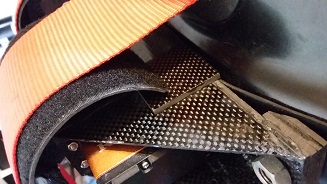

    FI. you can see the rubber mounting in the picture below - and note that my harness straps are connected to the servo via velcro. Good luck with your build.

    @pab61 - thanks! Looking forward to hearing and if I get it going first, I'll let you know. I was checking out springs today and am thinking something around 20 pounds pull at two inches of extension would be in the ballpark. We'll see how it goes if I'm guessing the proper pull range right.

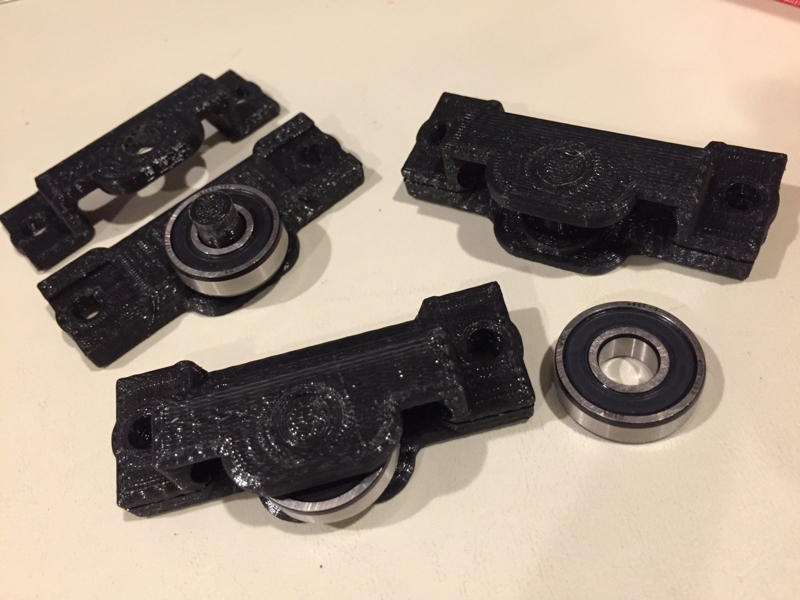

    And good luck to you! It's always fun to see how others do things and try to learn from them. And you are very right about lots of ways to do things. Curious what you are up to... :popcorn

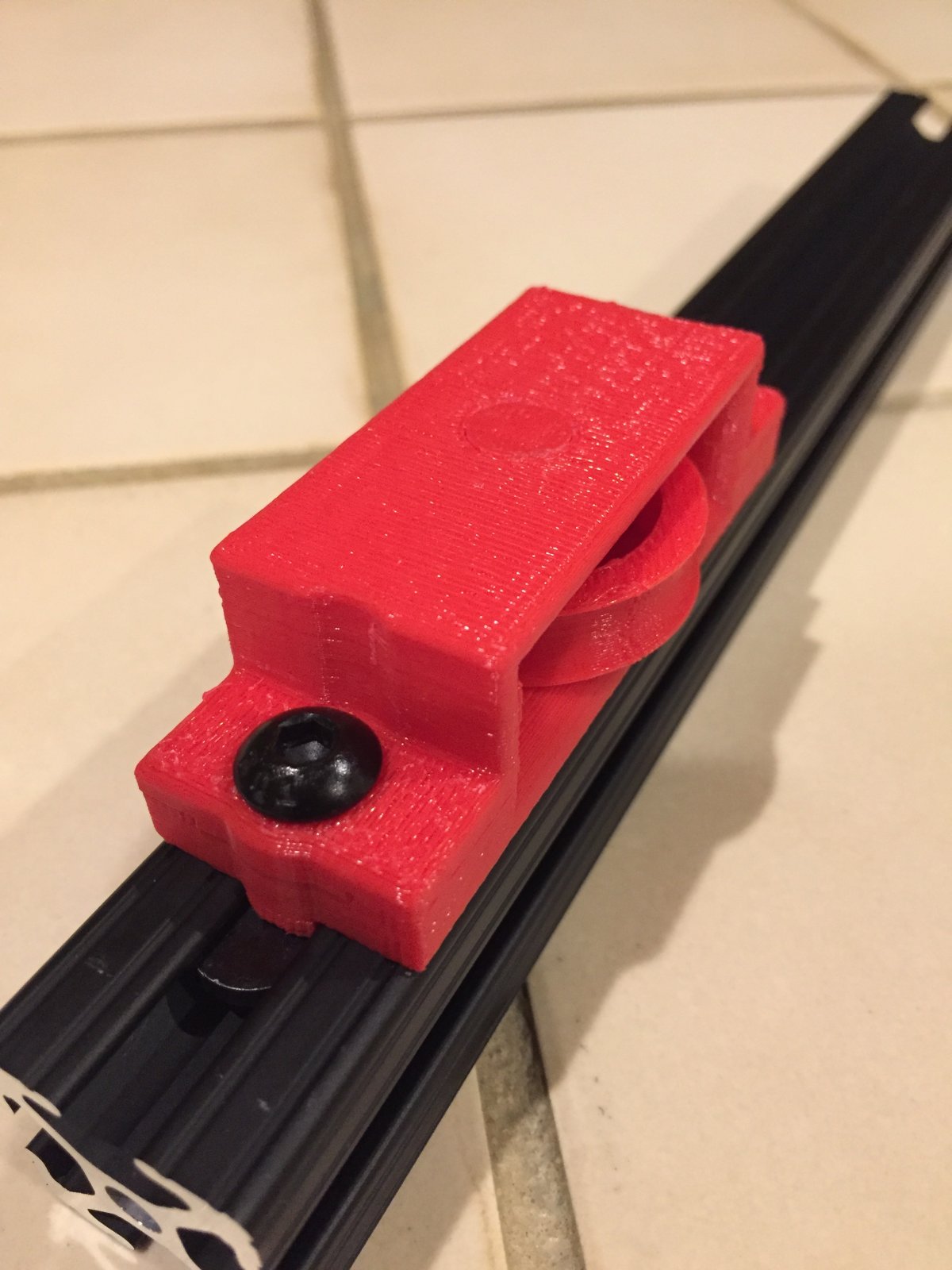

    I ordered some ball bearings today and am planning on 3D printing turning blocks to hold them. Since I'm building with 80/20 strut, they will bolt onto the strut with the bearings both parallel to the strut as well as 90 degrees to it. I got one of the 50 rpm MakerMotor gearmotors since it should have about 48 pounds of pull at about a 5 cm C-C with almost three inches of throw. I also ordered a hobby horse spring with a max load of 48 pounds so I'm hoping it's a good match. After the spring I'll split to the lap belt and shoulder harness ends.
    I think the MakerMotor will fit next to my shaker plate amps where I was going to put my USB hub. Will know better once I get it in hand. It's power supply will go where I was going to put my outlet strip. Fingers crossed it fits like I hope it will...

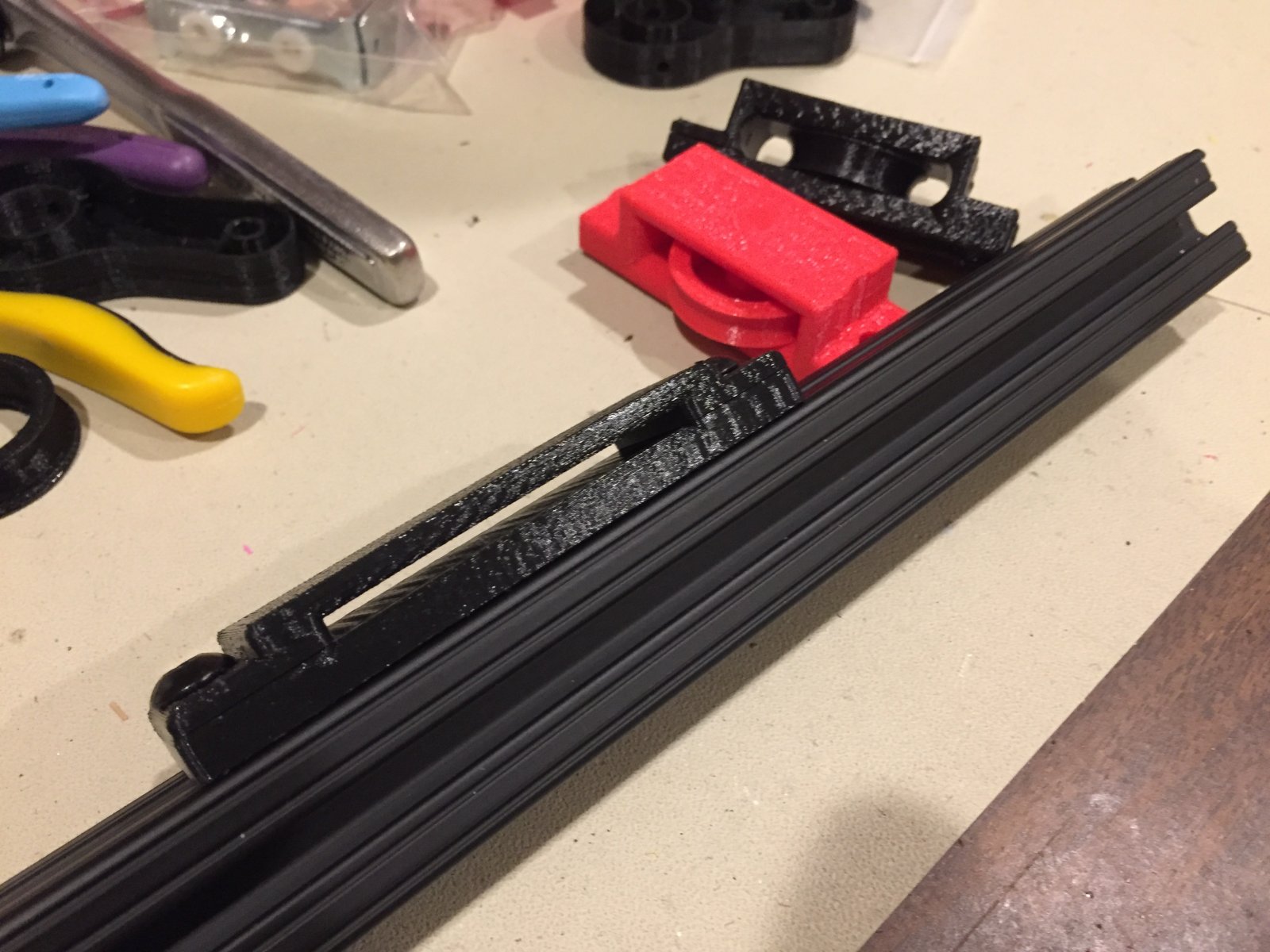

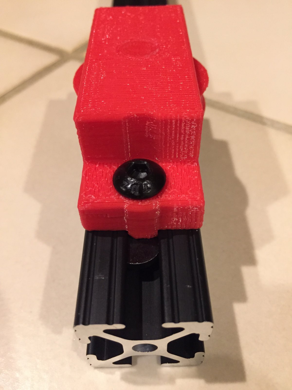

    @SeatTime - I ordered a pack of 10 bearings from Amazon and went to work on a turning block design. Learned more 3D printing tricks to split the frame into two pieces to clamp the bearings in place. Also did a curved face on a ring to keep the rope more centered that will fit on the outer surface of the bearings.
    The frame has a ridge along the bottom to help lock it into position in the 10 series 80/20 strut. Where the top and bottom clamp together I added keyways at either end to lock the top to the bottom in register and the bolts hold the two halves to each other as well. The center post for the bearing has a mating hole in the top half to support it at both ends.
    With the pulley ring having a bigger diameter than the width of the frame, rope can enter and exit at all sorts of angles to turn rope 180, 90, or all sorts of other angles as needed. I'll also need blocks with the pulley perpendicular but haven't designed that yet. I think I'll need eight blocks total the way I'm thinking this will go. It's just which version where with my seat frame. All in all very pleased and think this just might work.
    Seems a lot of effort for some simple blocks, but it's too easy to make parts exactly as needed. No bearing in the block. Not here yet... :thumbs

    In the same vein, bolt-on, two-piece, snap-together seat belt guides. They are basically thinner and wider turning blocks. Same design for the most part but to hold the belts captive and in proper position, and feed them around the frame.

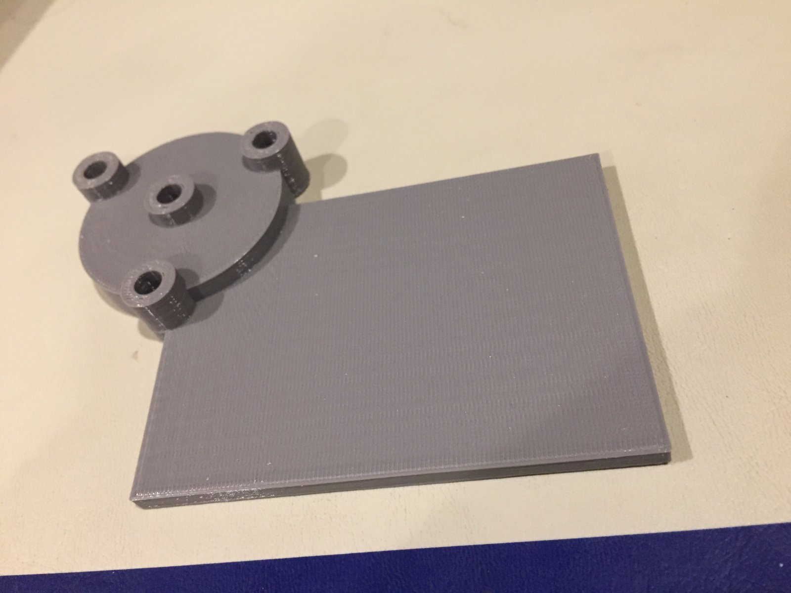

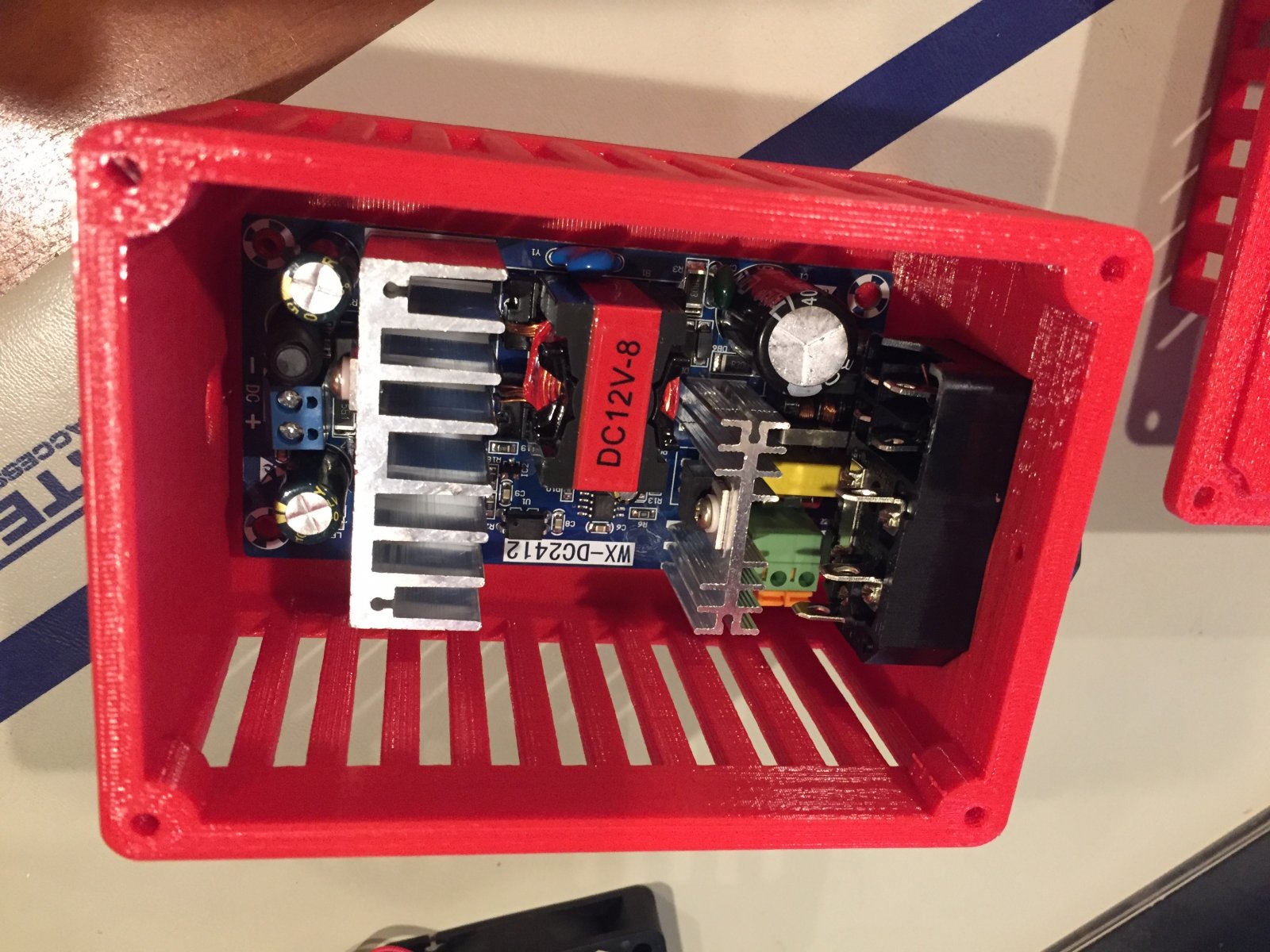

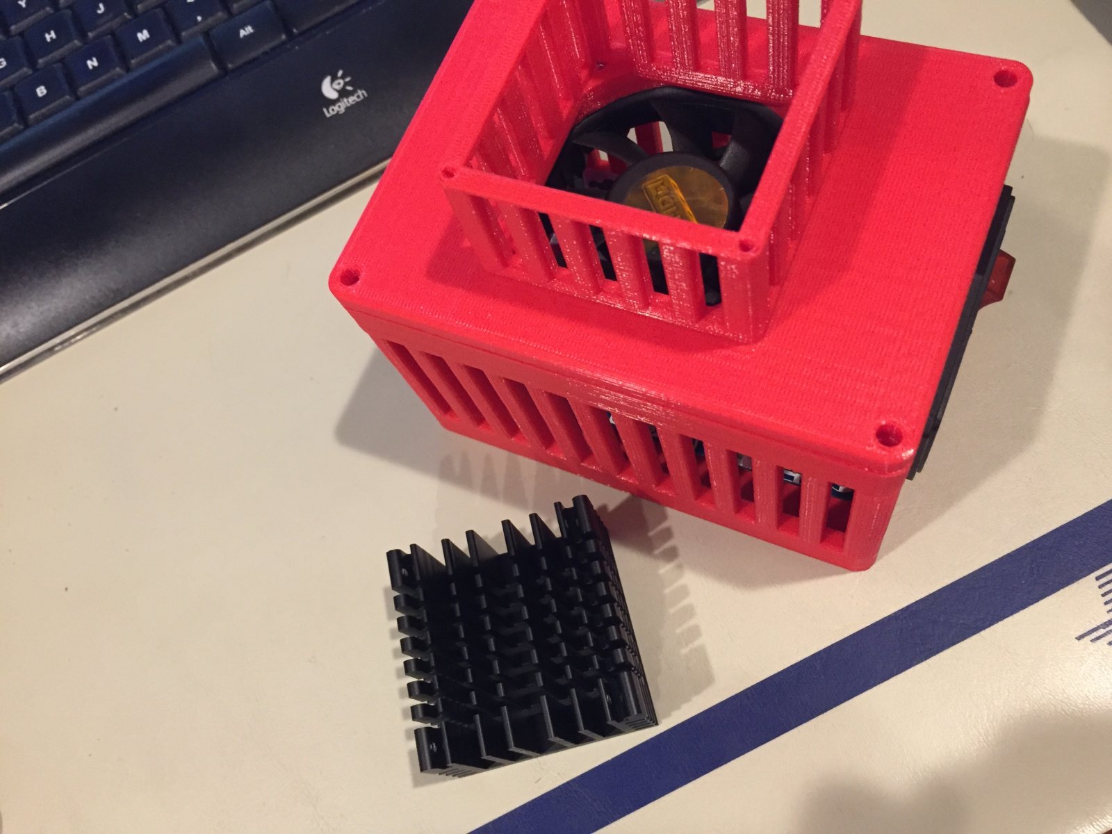

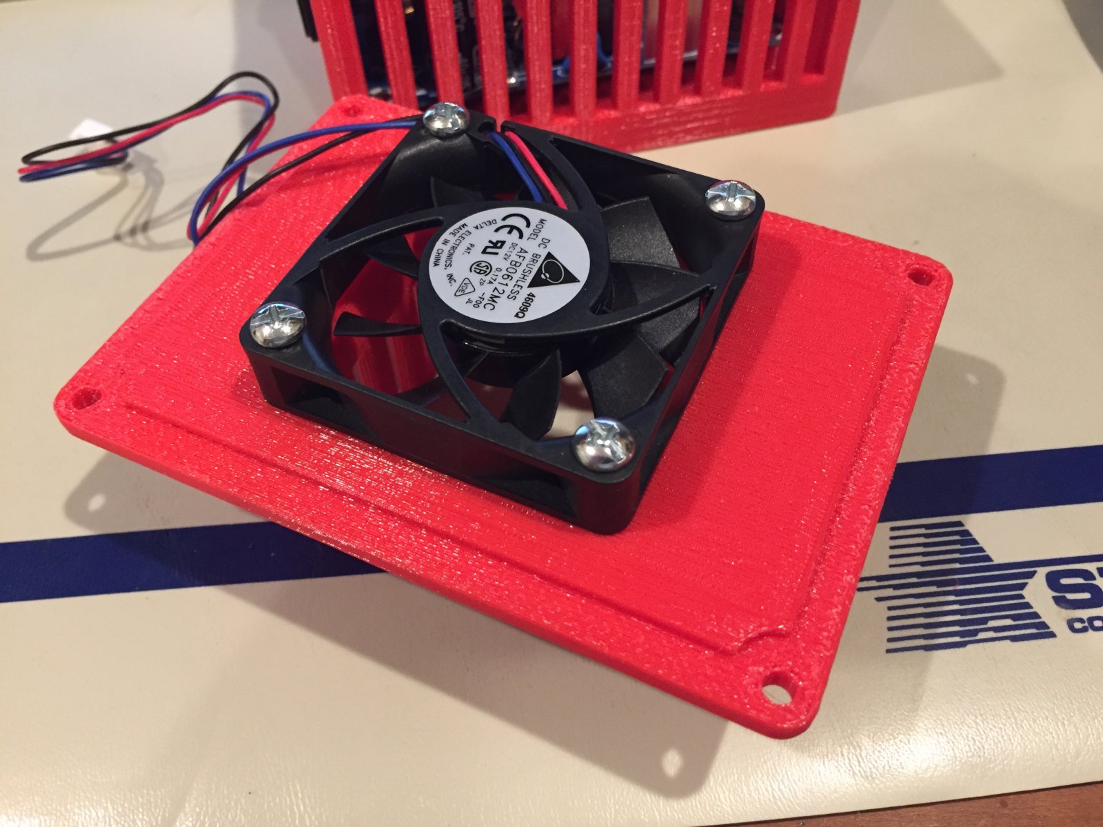

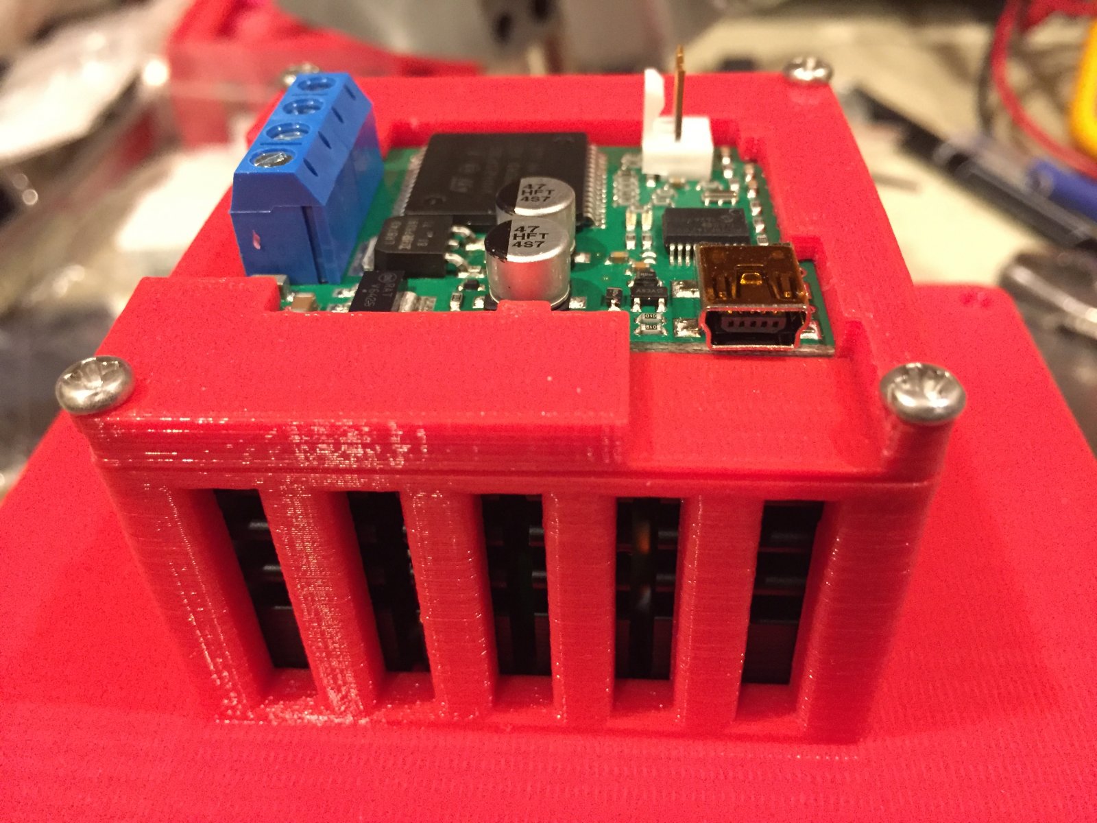

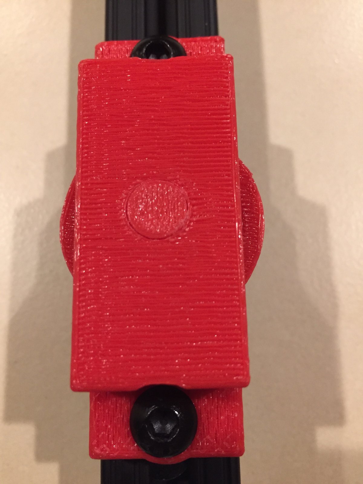

    @SeatTime, some progress here. Should be a lot more this weekend. Got parts in and am building again though still waiting on some key ones for the motion part.
    In the mean time, been printing pulleys (still need to print the pulley faces) to do the rope turning to keep all the weight on the lower frame. Made both center and offset designs to turn the pull from horizontal to vertical - that will get more clear when I lace it up. Got the motor and it fits perfectly where I was going to put my USB hub. Printed up a drill guide and will mount the motor when the mounting studs get here (delayed). Need to use studs as those are the mount for the tensioner motor Hall sensor too.
    Printed a box that will bolt to the frame right next to the tensioner motor, holds the power supply for it (hoping its powerful enough but plan on limiting in the JRK setup), and also mounts a fan for forced-air cooling the JRK heat sink and power supply. Using the same bottom board cooling as on my motion motor JRK units. Heat sink is a bit tall but that's what was available.

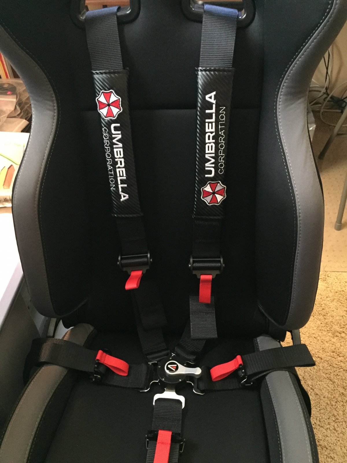

    Getting there. Doing all the wiring and component mounting this weekend. Looks like it's going to work just fine. Got a cheap Tanaka 5-point harness for all this to pull on. All the belt guides are printing now to hold the belts all in proper position. The hobby horse spring may end up being a little strong but only one way to find out.

    Got the harness. Can now add the strap guides.

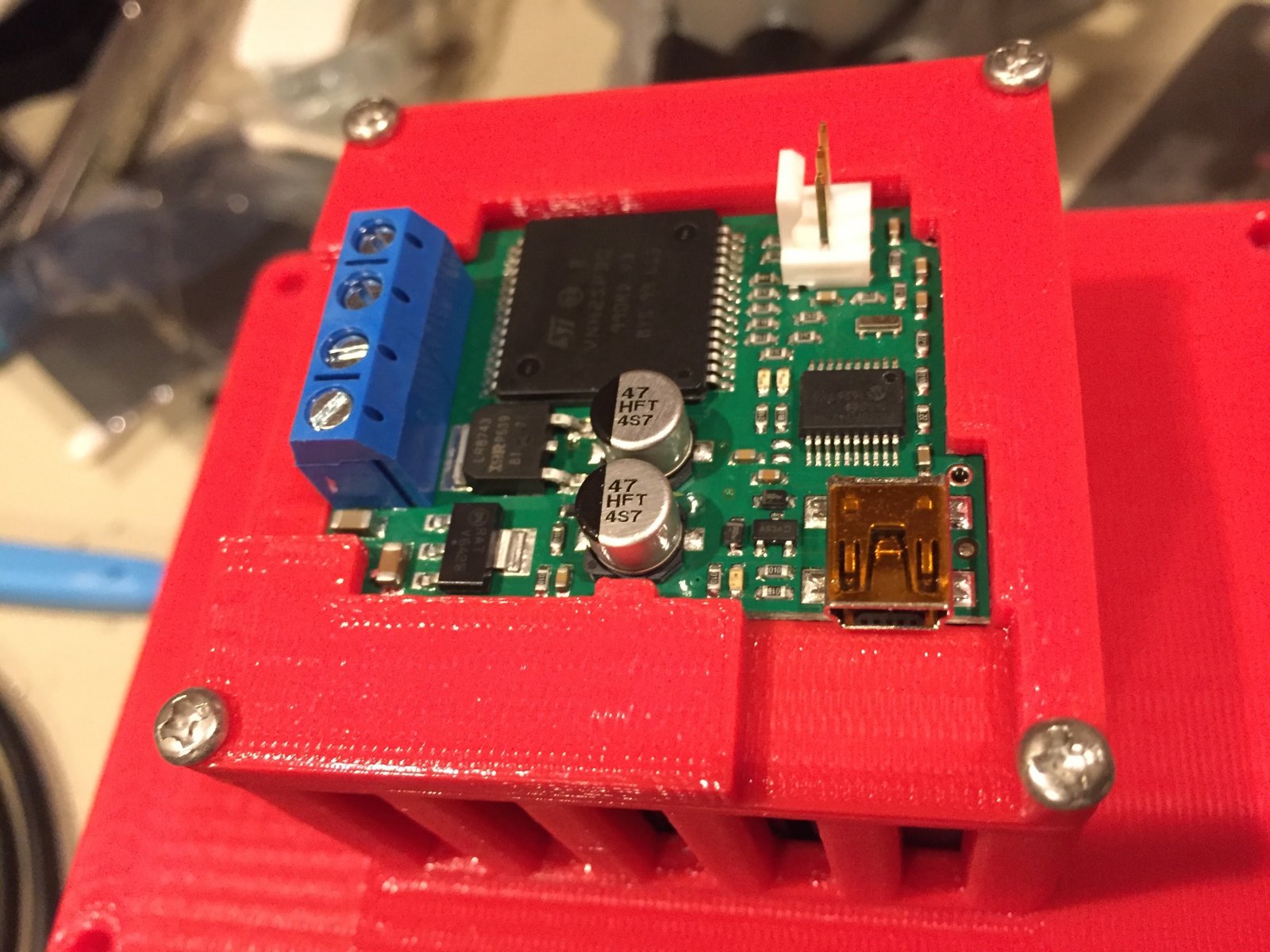

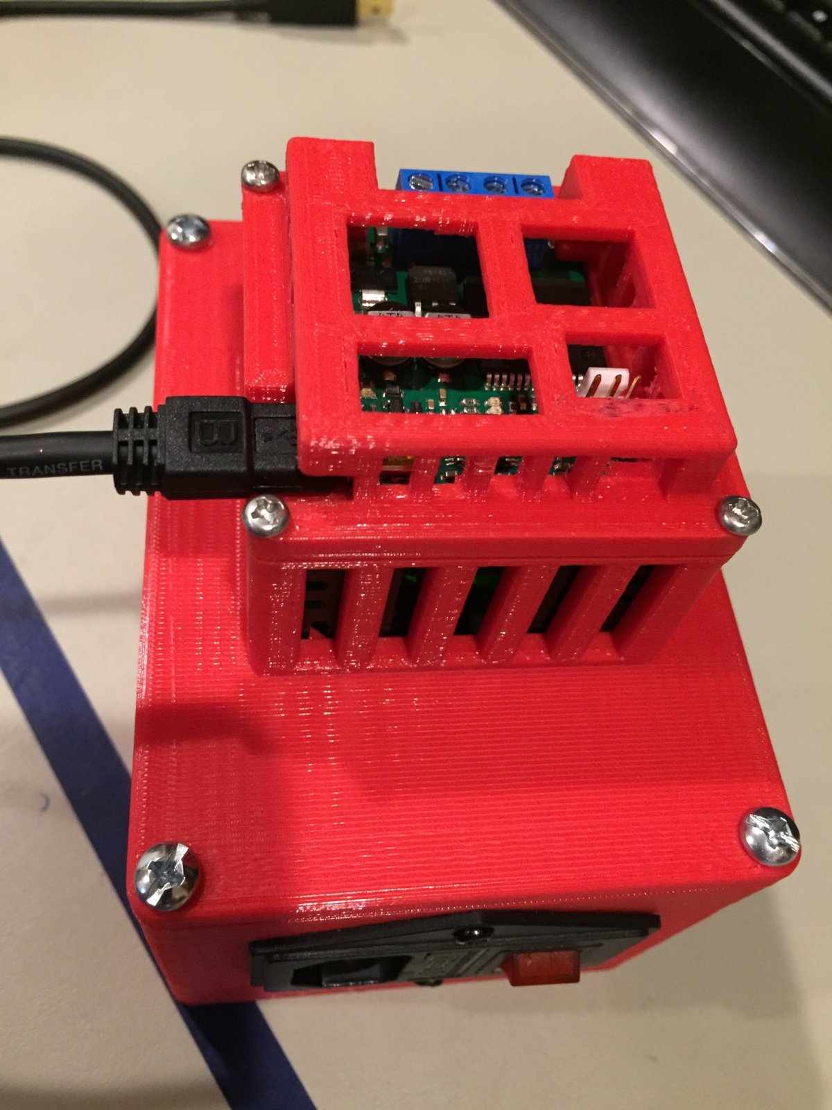

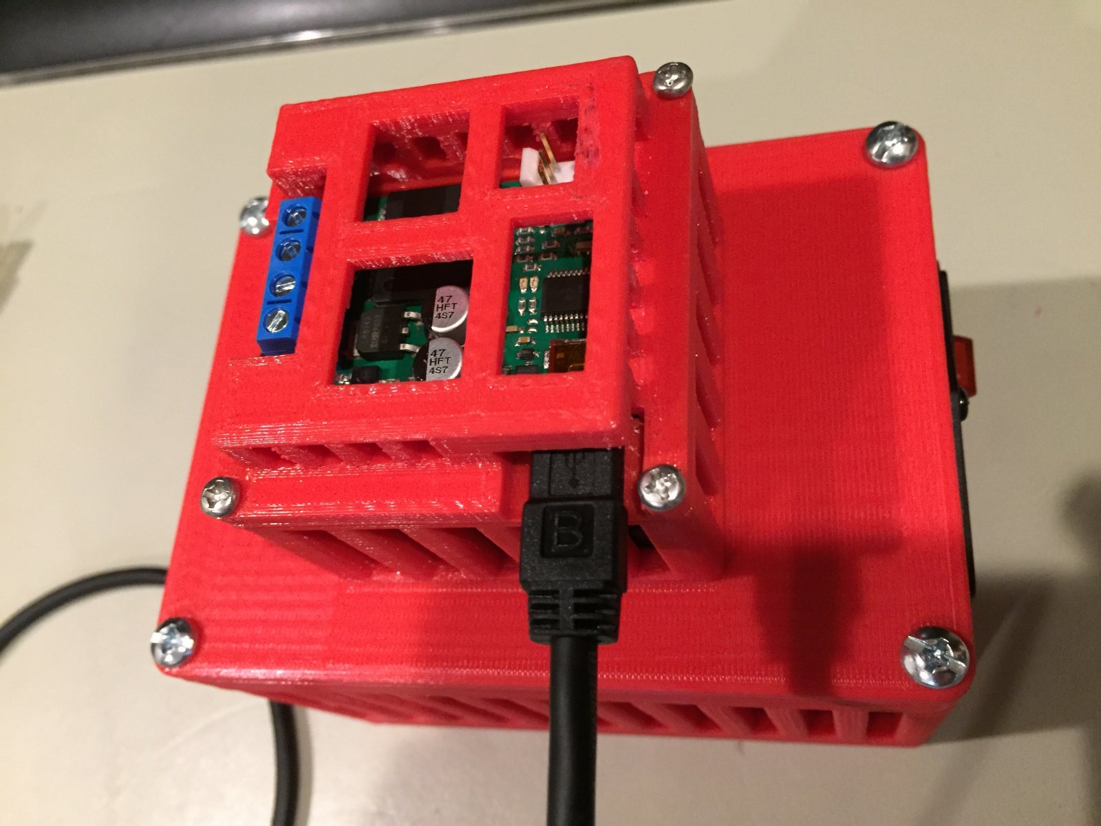

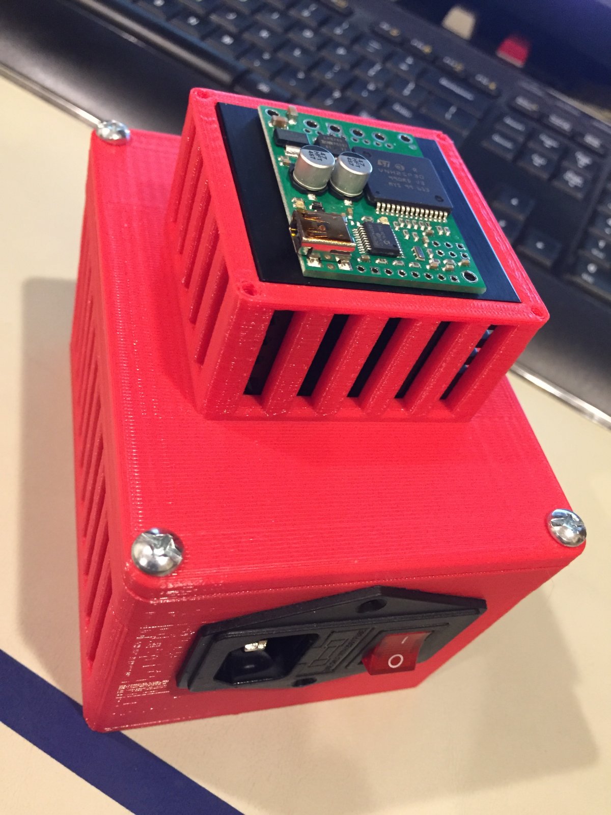

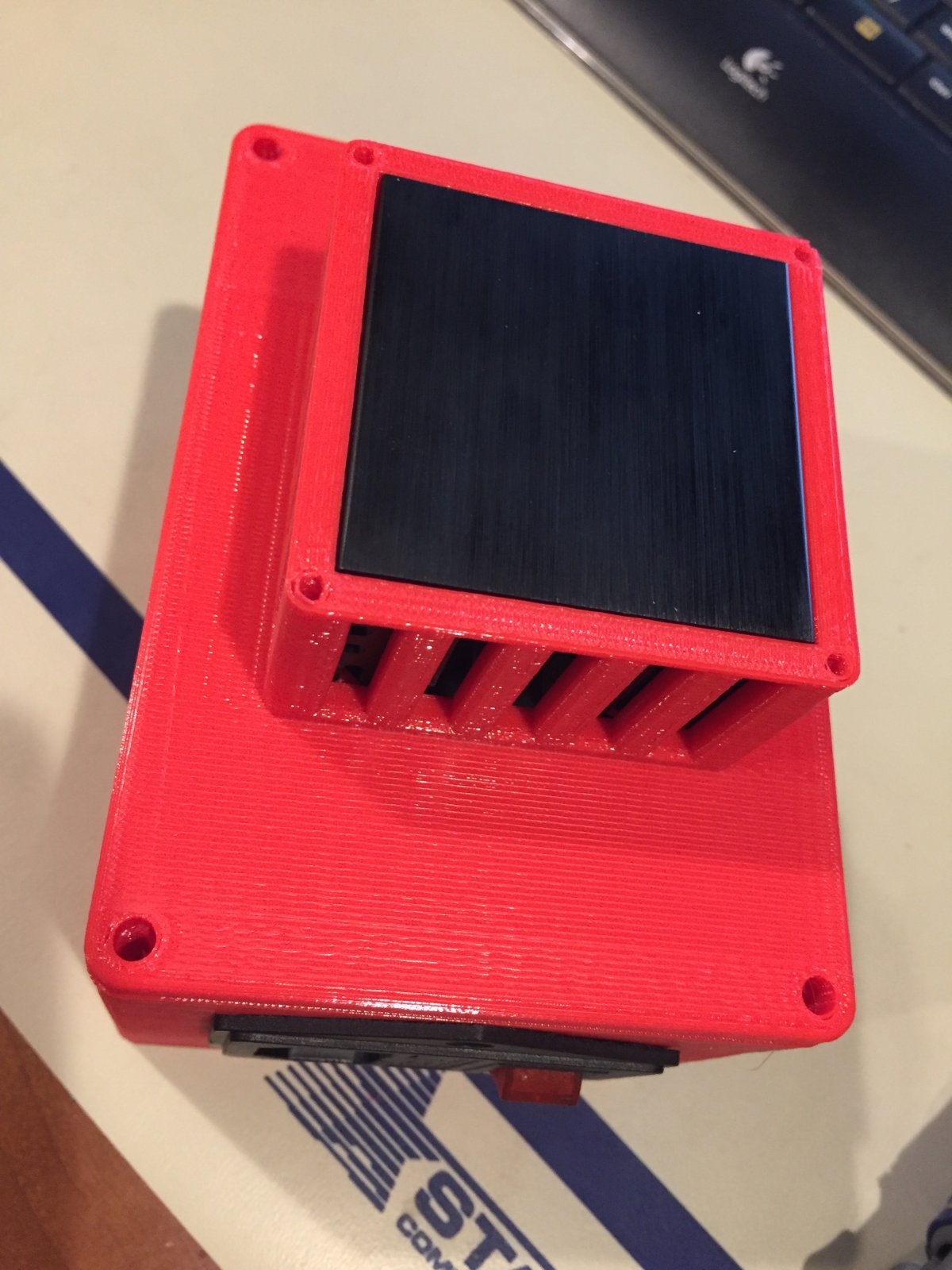

    I think I'm going to extend this clamp up to enclose and protect the JRK but this shows the clamping of the JRK onto the thermal pad material and onto the upper heat sink. The final piece will have vents but will use the same kinds of tabs to push down on the JRK board at the edges.

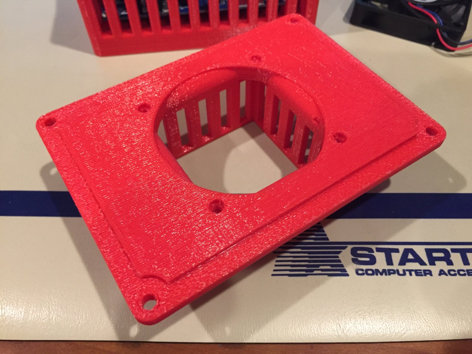

    Protective but lots of big vents just in case cover added to the clamp. Tested with the power supply wired up and the air flow is fine through both the top and bottom. Now to install.
