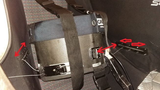

    I have tried them all and still use my G-vest system in my own sim. Feels the most natural, as it can pull on the body in many direction like gravity would do and can apply high pressure evenly to the multiple sides of the chest. Unfortunately for it to work correctly, it requires a purpose built support frame, which is one of the reasons that I moved to a fiberglass shell. See image below - note the shoulder straps are also driven.

    The vast looks great, but the cable system seems pretty complicate.....as shown. Why don't you use air bladders for your vast, instead?
    Btw, the vast could tighten your body, leaves no room for moving. Do you intend to apply this type design for F1 car seating, rather than GT car?

    All the cables are on sliders, so they can still move a small amount. Eg. the surge cables can still move in sway even when they are tightened. Same with the sway cables.
    Works well in my setup, don't know how well it would work with a proper F1 seat.
    Bladders are not as simple to get right as you may think for many applications. I have some handmade pneumatic rams that I would like to try, but fitting them will require some hardware/software changes to my current ballscrew actuators. Unfortunately cannot find the time at the moment and like I said - the vest is working well.
    Just posting my experiences, which I guess are very subjective. Don't claim to have all the answers and there is nothing like self discovery.

    Due to the front support arm, there is actually still space to fit and operate a flight stick in the middle, but I have it on the right hand side for lots of other reasons.
