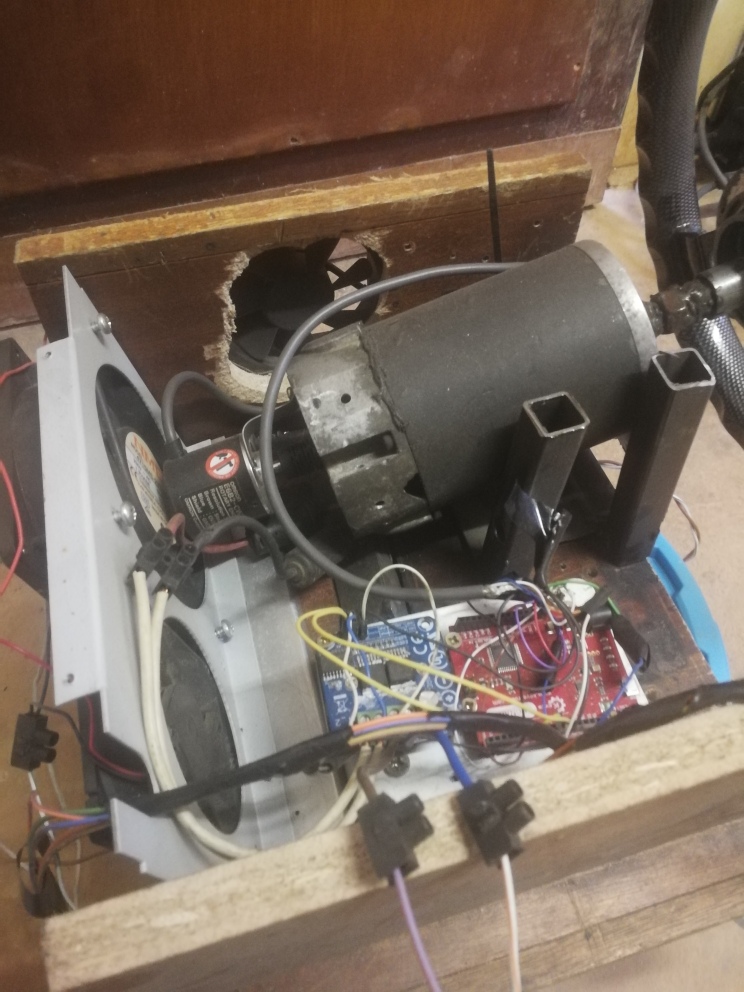

    Good day,here I am just posting my FFB wheel and pedals that I built.Actually started with a 4 dof 4motor axis simulator but as I was building it ,realized I need to put a pause on the sim build and build these peripherals first.Didn't think the pause would take MONTHS though:)Anyway have finally so called finished these builds and am now continuing the sim build.

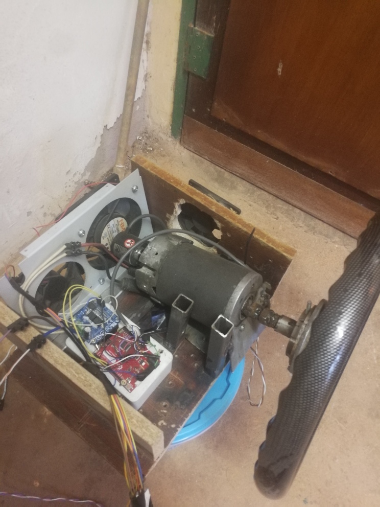

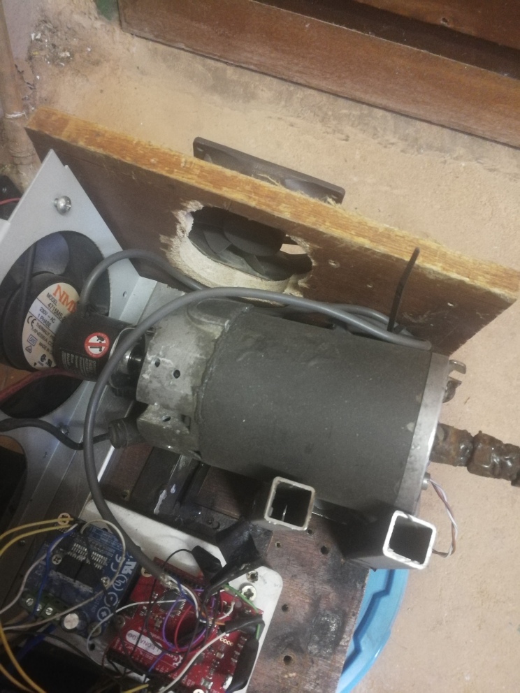

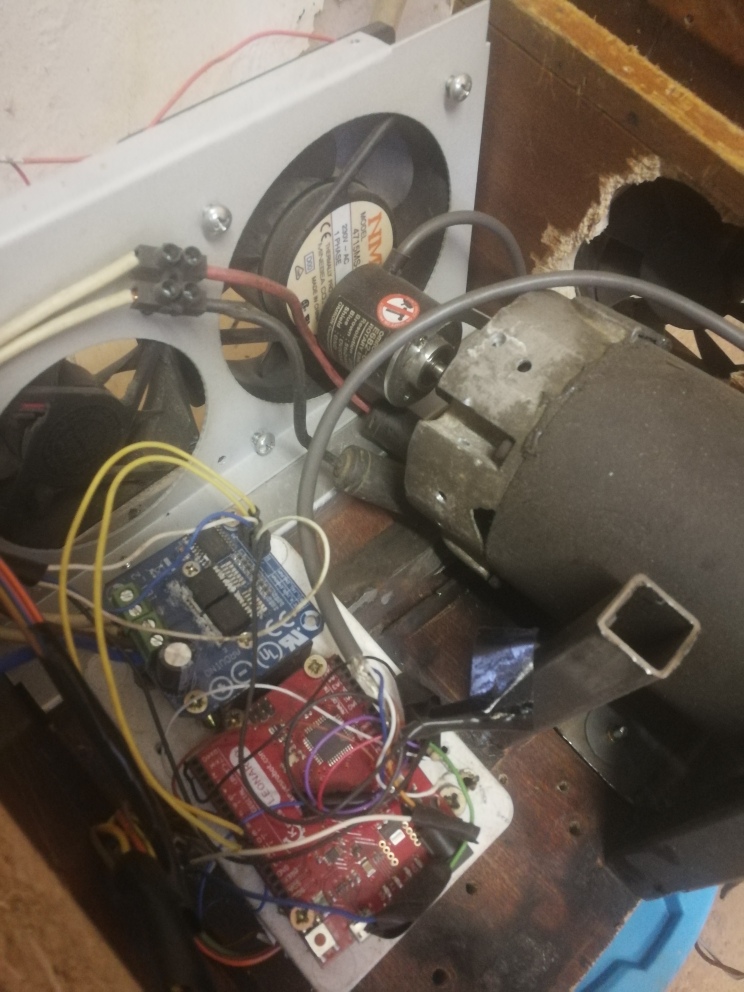

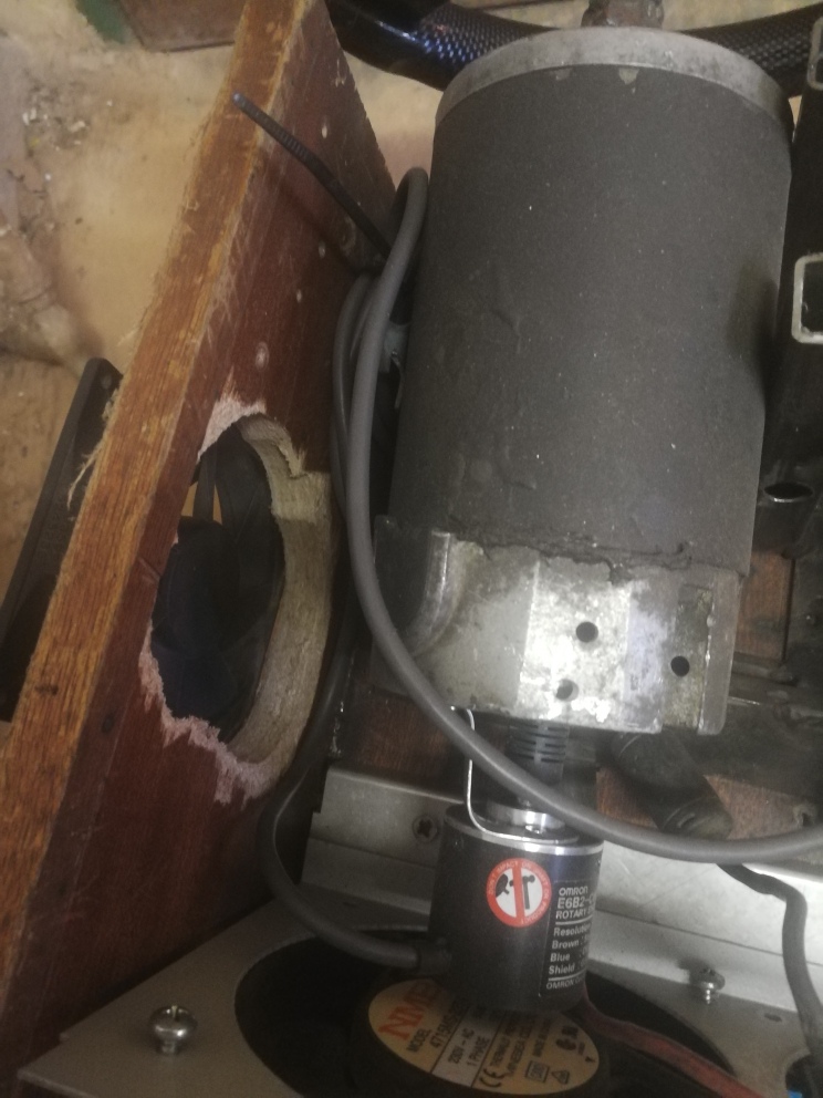

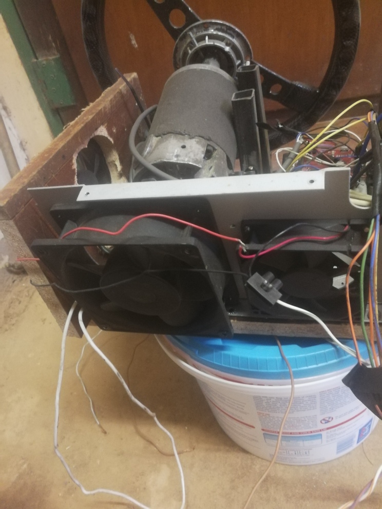

    So started off with a direct wheel ffb build .Used a 17amp 24v 400 watt motor,which I got from a floor polisher which I had actually put aside for my sim build,but the gearbox was damaged,so I thought it would do for this wheel.The motor controller is a ibt7960 chip and used in conjunction with a Leonardo board which I screwed onto a plastic wall plug box for better handling of the wires.The encoder I ordered from china 2000ppi which I fixed onto the back end of the motor by drilling and tapping a bolt which holds a bracket to place the encoder on.For the heat dissipation ,drilled holes into the motor and added a fan.The steering wheel I found at the scrap yard and welded to the motor shaft.Made a bracket to hold the motor in place which is screwed onto a wooden platform.Boxed up the whole unit with some pieces of wood laying around.Will be powering this up with my 12v 85amp car battery.Tried atx pc supplies up till 20amps but they keep tripping,so stuck with batteries for now.

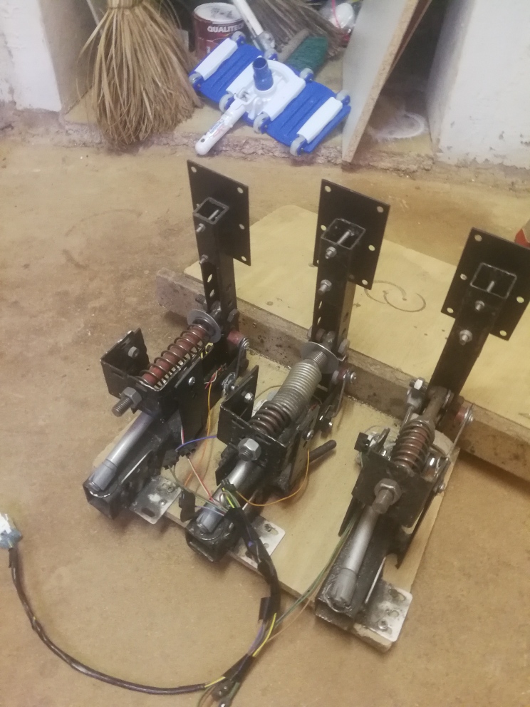

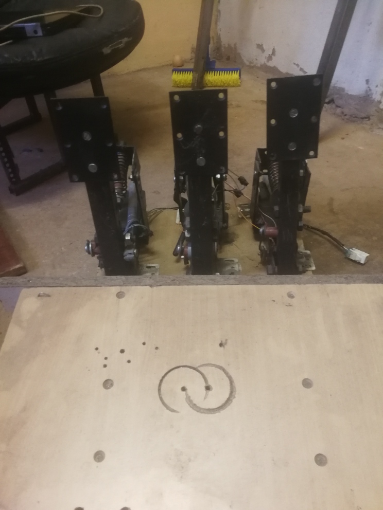

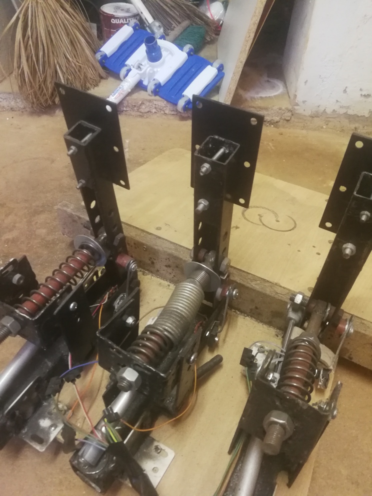

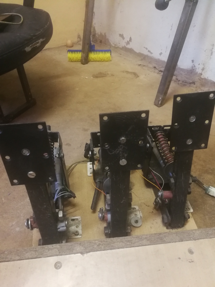

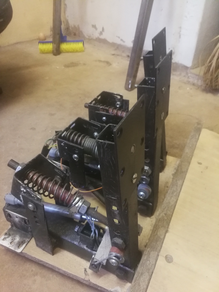

    Now onto my pedals :

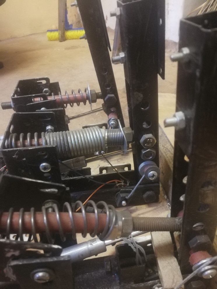

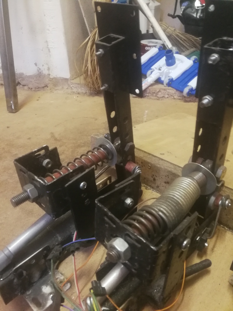

    Just used pieces of metal,some square tubing and sheet metal for the pedals and body work.For tension I used normal tension springs and hydraulic springs to give a better feel to the pedals.It is a very solid build and heavy.These pedals have pots on them which I connect to the arduino board located on the steering wheel.

    Hi,I actually have never tried a racing wheel before,just made this out of necessity because of building a motion simulator and needed this for control,was tired of using a keyboard :) The torque I have no idea,the motor is just a 400watt motor 17A/24V.I did make another wheel with a belt and pulley,have to say I felt a immediate difference when I made the direct wheel,it was much more sensitive to ffb.I am busy with a treadmill motor which someone else posted about using.Had one laying around and decided to try it and it is even better,seems to be more powerful and even more sensitive to ffb.I am powering it up with 24v also,thought it would be weak with that amount of voltage,cause when i connect it directly to the 24v power source I can stop the shaft with my hand with no effort,but when I have it connected via the arduino it has so much more power.

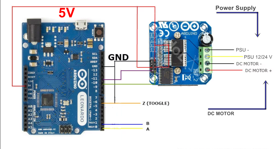

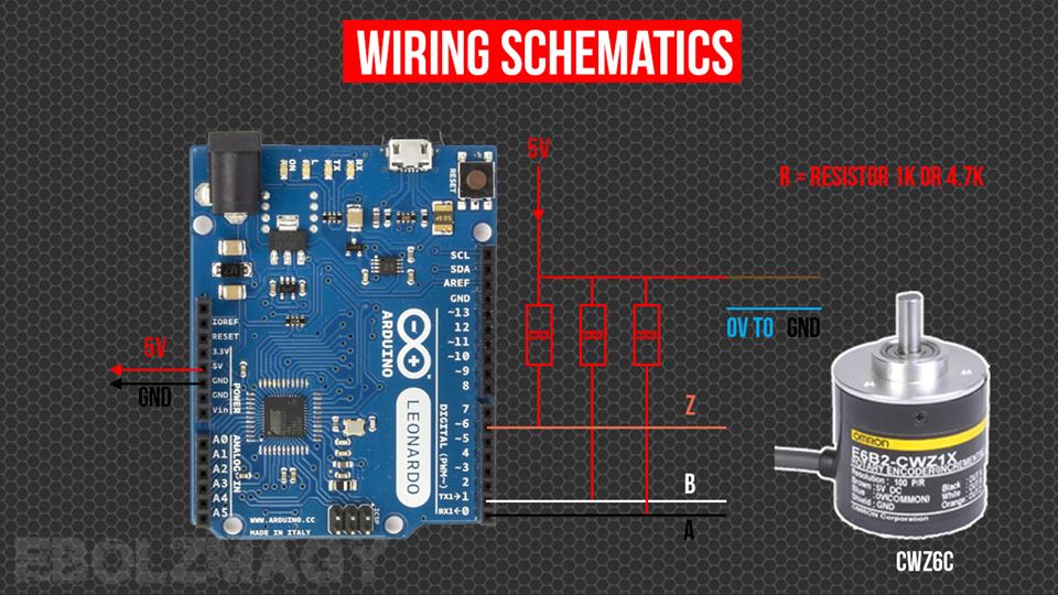

    so what's required to get this working. you just need a psu, motor, arduino and a control board?

    Yes and an encoder.I used a 2000ppr encoder and the ibt2 motor driver board.Have a look at the pics for directions,also download the wheel config software for setup.

    Thanks.No did not write it,Im using the ai wave software(Wheel config).Still working on the wheel,cause just as I was about to enjoy it,The ibt2 motor driver goes and blow.:(Anyway just waiting for another replacement.
