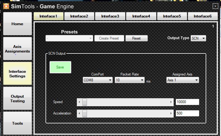

    i have now saved the interface settings and it says to restart engine. upon doing this i go back to interface and it has saved the com ports, packet rate and axis but the speed and acceleration revert back to zero.
    21,592
    151,215Coins
    Can you please post a screenshot of what settings you are trying to save.

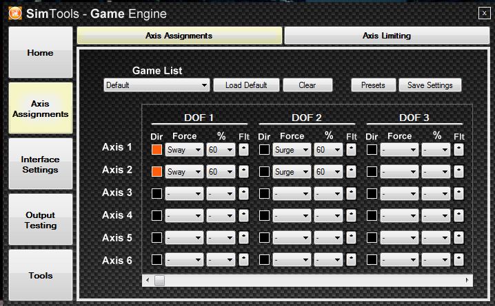

    I have followed the instructions and just used the above just for testing. when i go into the interface setting the green save button does not highlight and is not selectable. i have to reselect the com port again then you can save. Once save it says restart to which i do. when i go back in the speed and acceleration have reset to zero.
    I think it has something to do with the 4 way board as the individual one works. Im not sure if there is a setting or something as i did read somewhere about giving ID's but cant find it
    Cheers
    Jay
    21,592
    151,215Coins
    From what I understand actuator IDs need to be set to zero and com ports used need to be less than 10.
    I don't use SCNs but just looking at the picture instead of typing values in the box have you tried using the Speed and Acceleration sliders to add the setting value.

    hi noorbeast. I had set the ports less than ten. Im not sure how to set the ID's to zero so that may be the issue on the 4 way board. when i connected one of the actuators on the single board it worked using the same procedure

    well I hope my bits arrive tomorrow. Got no joy from TBVST or Mvst. I tried using the slider and not typing in the numbers. This did actually save the speed and acceleration info but still no movement.
    21,592
    151,215Coins
    Saving is one step forward.
    Are you using axis limiting and if so how much?
    The likes of @nclabs are best to advise on the hardware side.

    Hi noorbeast. Im using 95% axis
    @nclabs did say 4 way cards are best avoided but i already had it. Its not looking good for my bits tomorrow either now as just checked and they are still processing the order even though i paid ups for an early Saturday delivery.
    Sim tools is defiantly recognising the com ports as i have disconnected them and open simtools and it said it cant find them.
  16. nclabs
    nclabs Active Member Gold Contributor
    Jun 22, 2012
    165
    196Coins
    +148 / 0 / -0
    It safer to set the limit on 90% but it isn't surely the problem here. Do you have some comports above 10? Can you move at least 1 actuator with the output testing?

    Hi @nclabs. All sorted now. I just purchased individual boards
