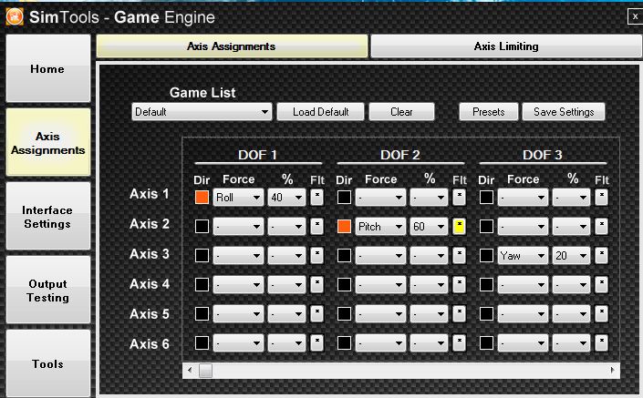

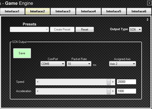

    I'm using simtools with FSX and the motion works great with the exception that the movement feels really 'course' or 'grindy'. When I fire up the game engine and the sim initializes going full travel on all axis the actuators are smooth with a nice zzzzzz sound. When in FSX it's more like grrrr-ah grrrr-ah grrrr-ah. I've just been working with the pitch axis and experimenting by increasing the speed and acceleration in the axis config in Game Manager and also increasing everything to max in the FSX Game Manager profile. It has gotten better but still not 'smooth'. It's almost like it moves in larger 'increments' where if it were finer.. it would be more smooth?

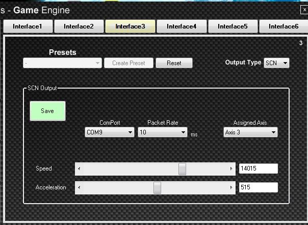

    @DaVinster,
    What do your interface settings look like?
    Will you post pic's of them here please?

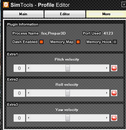

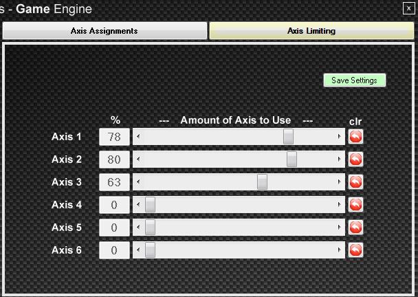

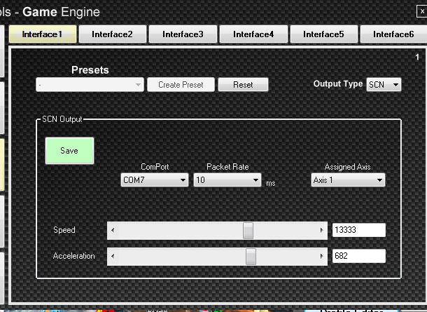

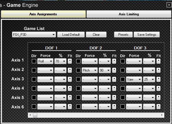

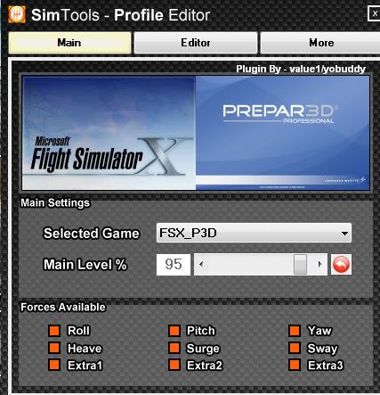

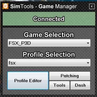

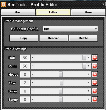

    My evening got protracted but here are the screenshots of my config including both Deafult & FSX_P3D settings:
    eng1`.JPG eng2`.JPG eng3.JPG fsxeng1.JPG mgr1.JPG mg2.JPG mg43.JPG mgr4.JPG eng4.JPG
    Thanks & cheers!
    DaV

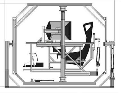

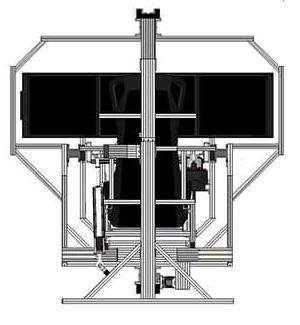

    Could I see a pic of your sim?

    Thanks yobuddy.. here it is.. 3 SCN6's - roll, pitch and yaw

    I pushed all the sliders to the right for the pitch axis in Game manager and also Game engine for that axis (No. 2). As per noorbeast's suggestion I also incrementally maxed out the Smooth filter. It helped a little but the motion is still 'notchy'. :(

  20. yobuddy
    51,589Coins
    +5,204 / 19 / -0
    I'd set all of the Game Manager settings back to there default values.
    Your not going to fix it over there.
    You do this in the interface settings for each scn actuator.
    Try setting the speed to 80% and the accell to 50% for each scn6 settings.
    And make sure you try out more than just one game too, so we know it not a bad Max/Min file.
    Let us know how it goes buddy!
