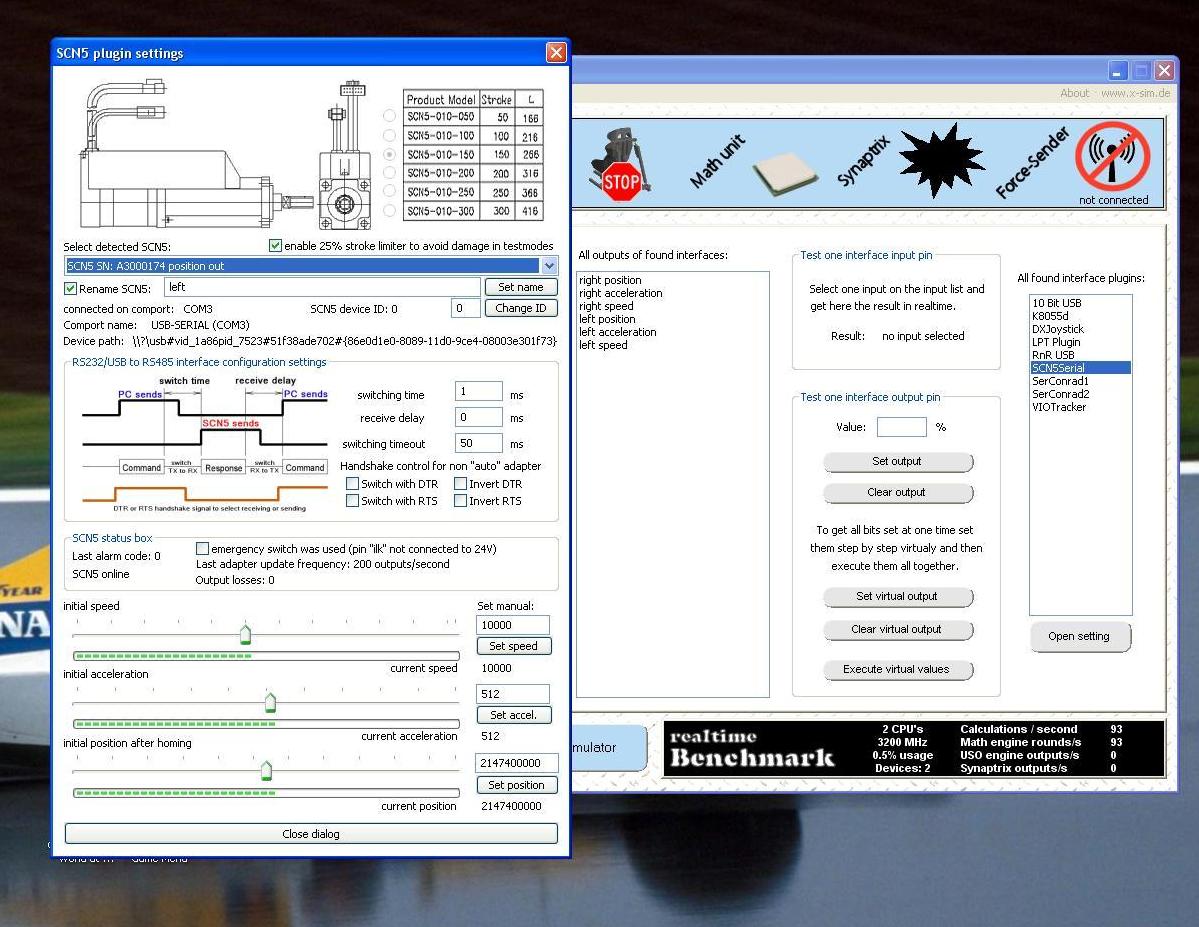

    I believe that my adapter is technically an auto-adapter per an evaluation of it by SirNoName a couple of weeks ago, but I switch it in X-Sim using DTS. I use a switching time of 1ms, a receive delay of 0ms and a switching timeout of 30ms. These settings achieve 140'ish SCN5 updates/sec per the SCN5 Plugin dialog box. I say 140'ish because it seems to vary between 140 and 154.
    There may well be a faster adapter out there. I'm not sure how important this is though. There must be some maximum number of updates per second that an SCN5 can handle via it's half-duplex interface anyway. Unfortunately, I don't know what that limitation is, so I don't know if pursuing a faster adapter than the one I have would be of any benefit.
    :sos: Does anyone know what the max inputs that an SCN5 can handle is? More importantly, what would it do if more packets were sent than it can handle. Does it discard information? I'm not sure if this is even possible to send more information than it can handle since the baud rate is predetermined at 115200. Maybe the better question is how many updates per secnd can be sent at 115200 baud?
    EDIT: Note switching this adapter with DTS improves the updates/sec to 176, but the switching timeoput has to be upped to 55ms in order to achieve this or the actuators won't be detected at startup.

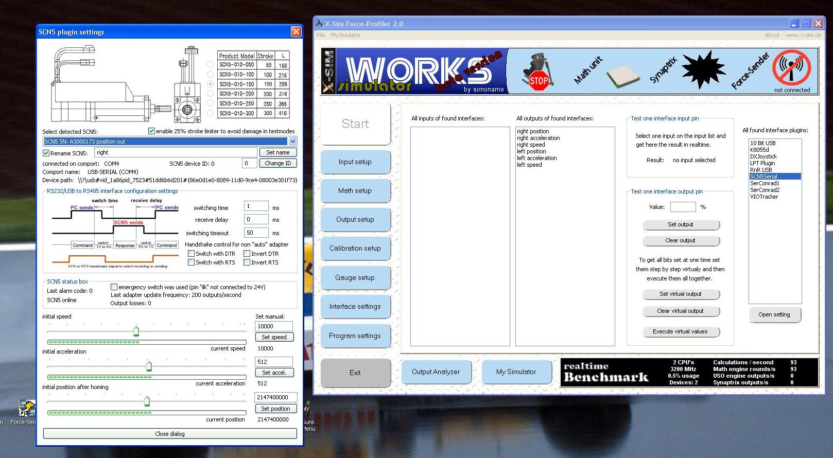

  7. Mr Burns
    Mr Burns New Member
    Oct 16, 2008
    139
    0Coins
    Re: SCN5 Hardware Thread
    First, I have to thank bvillersjr for his help with what to do.
    After changing numbers and trying all kinds of combinations this is the best I can get with the $7 ebay adapters.
    Any changes lower the numbers. Both adapters can do 200 outputs/second. Sometimes one is 166 and the other 200, most other times they are both 200. If I change any setting (for example receive delay to 1) both always get 166. Which way is better? Does anybody know what the physical limit/second of the scn5 is?

    Looks like a winner. I'm going to buy a set for my next sim and give em a try as well. I don't think I would be to concerned about seeing a different number on on actuator than the other. It seems that these numbers update on some kind of timed interval. Mine fluctuate as well, however, I havent seen one actuator different from the other. You may have just been switching to view the other actuator at the time of the update? Is it a common occurance that they are both report different numbers?
    They are not different if at lower outputs (166 and lower), but over 166 once it's 200/200, then 166/200, 166/200, 200/200, 200/200. It's always the same adapter that is lower, so it might not be the same quality.

    Hmm, that is a little corcerning. I've never seen that, although the best I can get is 176 updates/ sec and you say it happens more often at higher speeds. Are you using the latest SCN5 Plugin? If so, we will need some advice from EgoExpress or SirNoName on this one. I'm not sure how the profiler would deal wuith the variances if they occur frequesntly. Knowing SirNoName, it's already handled, but better check to be sure.

    Tried another computer and the same results.
    I think 166 is good enough for $7.
    Don't have any serial printer option in the com port advanced section. No Miscellaneous Options at all.

    Most of us run games probably with framerates alot under 100fps. I think a converter with at least 150 outputs/per second and a single pc with dual- or multicore-processor is sufficient enough. Frex, for example, drives them with a single pc as well.
    I cannot see why we should try to get 2000 outputs/sec, if we are not able to deliver gamedata in that speed.
    I think we should recommend those 7$ converters.
