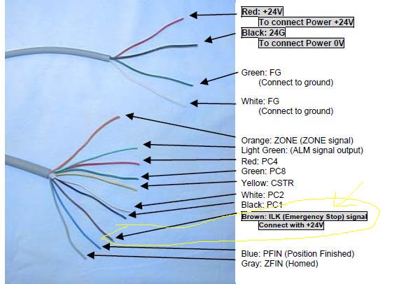

    If using the scn power wire (long wire) to connect the ilk it must be like this picture with +24V connected and cut the 24V for emergency stop? (from scn instructions)

    Dont referr to the wire colors, as they may change. Only the pin layout is consitent.

    This is the wire that comes from the scn5 makers, I think they would have the extension wires be what they list in the manual? I'll check to make sure it goes to the right pin.

  11. Mr Burns
    Mr Burns New Member
    Oct 16, 2008
    139
    0Coins
    Re: SCN5 Hardware Thread
    Yes, those ones. Those should not change even if the short wires change (one would hope). As long as it goes to the ilk pin it should be good.

    EgoExpress is correct. Definitely go with the pinouts, as the wire colors could vary. On my 150mm, brown is not the color of the ilk pin according to the pinout diagram.

    Does anybody have a recommendation for a emergency kill button that can take both actuator wires (and kill them both at the same time)?

    What about using cheep automotive relays, one on each actuator wire. And use the kill button to switch them either on or off at the same time? :?

    I must be missing something regarding the dual kill switch? What would be the purpose? If you kill the 24v to the ilk pin, the actuator pauses but is not moveable by hand.
    If you kill the power to the actuator, it is obviously paused and limp.
    What would be the benefit of stopping the voltage to both?

    I believe bvillersjr is right; you should be able to wire both actuator ilk pin’s to the stop switch.

    I am looking at this picture. I have extension wires for the power cords (didn't cut the connector). Each actuator has 24V going from a power supply (two 24V 2A) to the main actuator power wire and to the ilk pin (to the wire connected to the ilk pin) and a button in between ilk pin and power supply. Are you saying you can connect both kill wires (for both actuators) to a single button and 2 different power supplies? This means 2 times 24V 2A current flowing through. I thought about using a button that can connect to 2 power supply wires (2X 24V) but on different inputs and somehow cuts both internally without interfering with each other.
