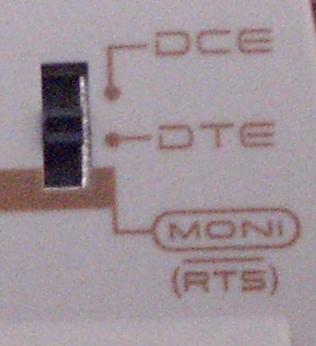

    I also tried with this switch in all three positions. In each attempt, I tried the 'Invert RTS' checkbox of the SCN5 Plugin in both positions.
    Next I am going to try with a 150Ohm 1/2 watt resistor. I was able to obtain 220Ohm, 150Ohm and 100Ohm resistors. My local store does not carry 120Ohm resistors :( However, in the first page of this post, it says for beginner to try a short cable with a 220Ohm resistor so I tried this first.

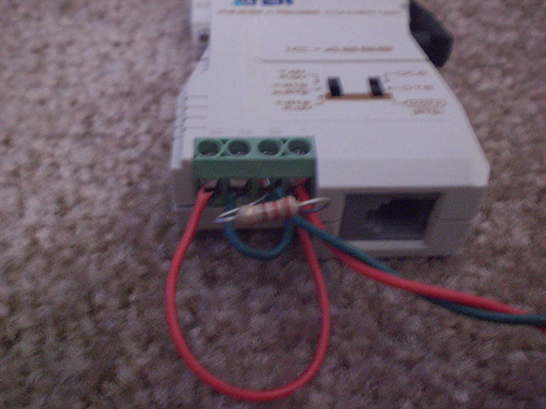

    Aside from the resistor that I installed between the T+ and T-, do I need additional resistors?
    Thank you for all of your guidance.

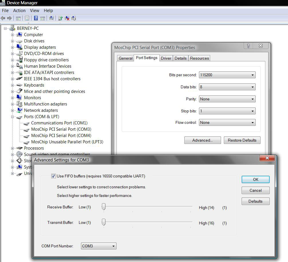

    Thank you for pointing out my mistake. Here is what I have done. I have also attached a picture of my COM Port Settings. I thought that I had checked this before, but one of them was set to 38400 instead of 115200. I just changed it to 115200.
    Thank you for your feedback. I will begin testing again.

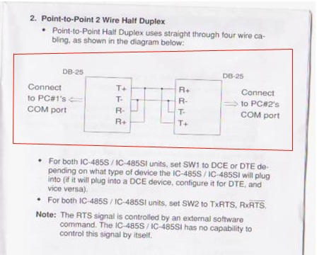

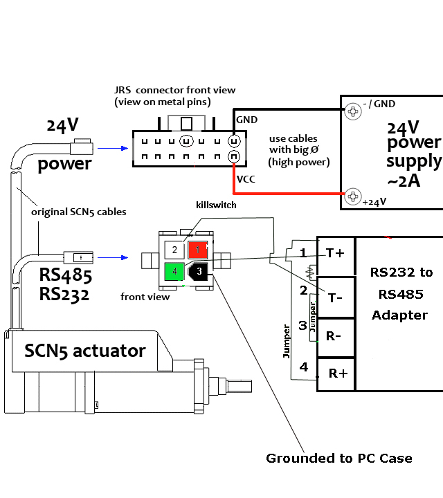

    It would appear that my adapter meets the 5 criteria?
    • 1. external powered by 9V power supply -> save
      2. cleared with the shown wiring -> save
      3. cleared, RTS switching / unknown: is RTS normal or inverted? (Tried invert RTS switch in both modes)
      4. 220Ohm 1/2 Watt resistor between T+ and T- on the adapter
      5. cleared, switch set to DTE -> save
    Here is exactly how everything is connected showing the jumpers and resistor.

    I re-tested each scenario with the FIFO buffers at maximum. Still no success. I will take your suggestion and try making a loopback. I will have to wait until Tuesday though. Do to an error by the company that I order my serial cables from, I only have 1 serial cable even though I ordered two!
    Could the Flow Control Setting of the COM port or other COM port settings be able to affect the SCN5 plugin from detecting the actuator?

    You are right, it is not Vista. I learned several things if you were following the posts.
    1.) ilk kill switch pin MUST be connected to 24V or actuators will not be detected by SCN5 Plugin
    2.) It is possible to wire some types (maybe not all) of full duplex adapters to the half-duplex Termi-bus on the SCN5's, BUT it is not worth the headaches. SirNoNames originial suggestion of still purchasing an auto adapter with fast TXD switching remains the best advice in my opinion
    3.)There is a simple tool that you can install to spy on the communications between the SCN5 and your PC to determine if they are talking correctly.
    4.)The SCN5 plugin has a debug mode that can be used to find out why the SCN5 isnt being detected if the communications mentioned above are working correctly.
    5.) WE FOUND THAT I HAD A DEAD ACTUATOR AFTER 2 DAYS OF TROUBLESHOOTING.
    If I can help someone else with this troubleshooting now that I understand it, I would be glad to help. I would consider it returning the favor to SirNoName by saving him some time.
