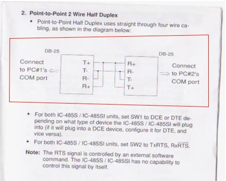

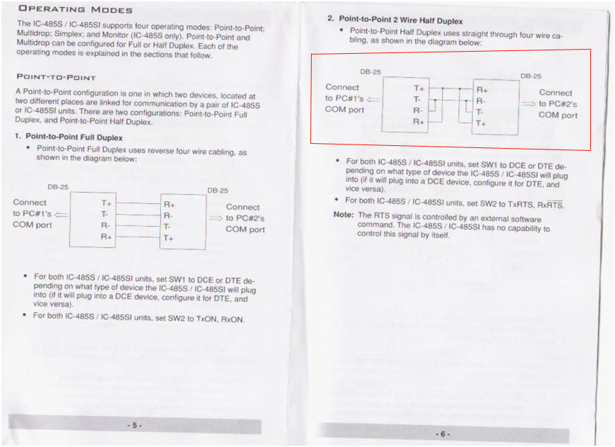

    If I am not mistaken, this wiring diagram would provide half-duplex functionality. Is it possible to achieve full-duplex with the SCN5's?

    I will confirm that mine work tomorrow when I have some free time (Thanksgiving obligations today). I believe that they will and only cost $30.
    They support 8 different configurations including Point-to-point full duplex (four wire) ,Point-to-Point half-duplex (two wire), Simplex, Multi-Drop Full Duplex (four wire) and Multi-Drop Half Duplex two wire.
    According to SirNoNames statement about the Termi-Bus limitation above it seems to me that the correct configuration for this adapter would be Point-to-Point (2-Wire) Half Duplex and that it should work just fine.
    I'll post back once I've confirmed.

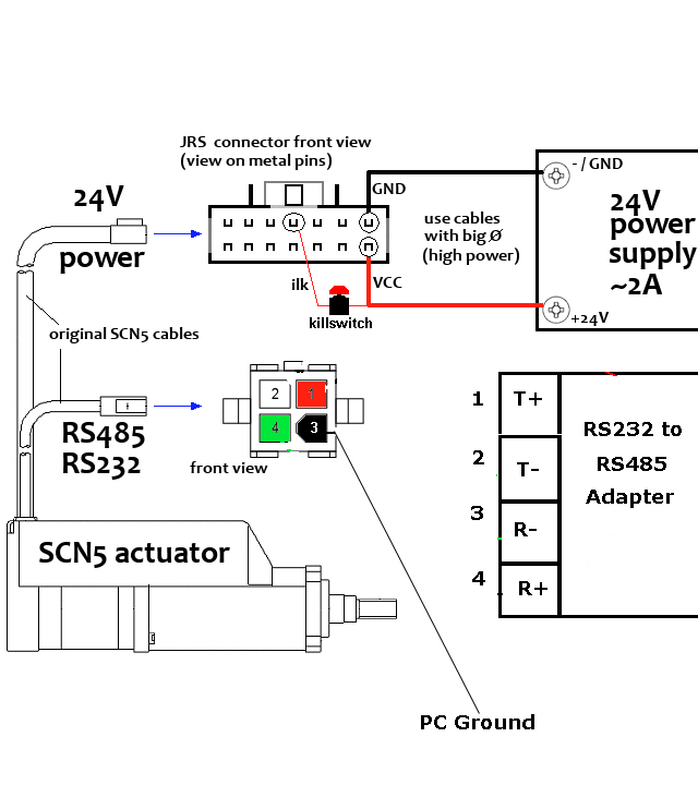

    The ground did not fix the problem. I have attached some documentation about my adapters and a revised version of the SCN5 wiring diagram depicting the differences between my four wire adapter and the other solutions presented here. On the other adapters shown in this forum, TR+ and TR- are grouped together. They are individual on my adapter. Also, my adapter does not have a ground, so I grounded the SCN5 to my PC, but am still unable to get the Profiler to discover my software.
    SirNoName's idea to first connect to PC's with these adapters is a good one, but I dont have another PC with a serial port :(
    My COM Port Settings are default, except I reduced the FIFO buffers to 1 for troubleshooting purposes.
    I have tried the following connections:
    This should work per the ATEN documentation
    • Adapter T+ to White(2) on the SCN5
      Adapter T- to Green(4) on the SCN 5
    I also tried this
      Adapter T-to Green(4) on the SCN 5
      Adapter R+ to White(2) on the SCN5

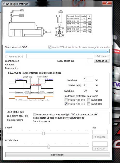

    Also, per this post and Ego's recommendation, I tried many of the possible checkbox combinations in the SCN5's. I closed the profiler and re-opened it after each change. This is sufficient right? I don't have to reboot between changes?
    I have been shopping around for an Auto Fast TXD switching RS232<-->RS485 Adapter but I'm not finding anything under $100 each! If noone is able to offer any advice based on this documentation, could you please point me to where I can purchase an Auto Fast TXD converter?

    Before I start he, let me first say that I am not an expert of serial communications, most especially RS485, so I appreciate all of your guidance.
    My adapter claims to support full duplex and half duplex point-to-point.
    I DID FORGET THE RESISTORS. I assumed that when the switches on my adapter were configured for point to point half-duplex, that the adpater provided the resistance internally, but I am probably mistaken, and will try with the resistors.
    The rest of my simulator is ready, and even if I order another adapter today, I have a few days to try to toy with this one before it will arrive :(
  17. bvillersjr
    bvillersjr Active Member
    Oct 11, 2008
    1,174
    Ohio, USA
    438Coins
    +23 / 1 / -0
    Re: SCN5 Hardware Thread
    1.) Self Powered
    2.) full or half duplex
    3.) controlled by RTS signal
    4.) Not provided by documentation. I am going to buy some resistors and try. I dont have a mulrtimeter :(
    5.) DCE / DTE selectable by switch
    The manual states that DCE / DTE is switch selected and should be set based upon what device is connected. If SCN5 is DTE device then it says to set adapter for DCE. If SCN5 is DTE device then it says to set adapter for DCE.
    I do not know if the SCN5 is DCE or DTE so I may have this switch set incorrectly.
    Thanks you for your feedback!

    Thank you very much for helping me to eliminate some of the variables.
    The adapter is connected with the included 9VDC 300mA power supply.
    I tested witht the invert DTS option selected and deselected so I think I can rule that out as the problem

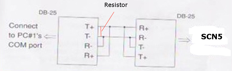

    It looks like we have narrowed it down to my adapter not being equipped with an internal resitor.
    I need to make a trip to the local electronics store for some resistors. I am using a 1.5m cable. Do you suggest 120Ohm or 220Ohm resistors? Am I correct in assuming that I will only need one resistor and that I can wire it between the T+ and T- as shown below?
    I apologize for the crudeness of this drawing.
    Thanks again!!

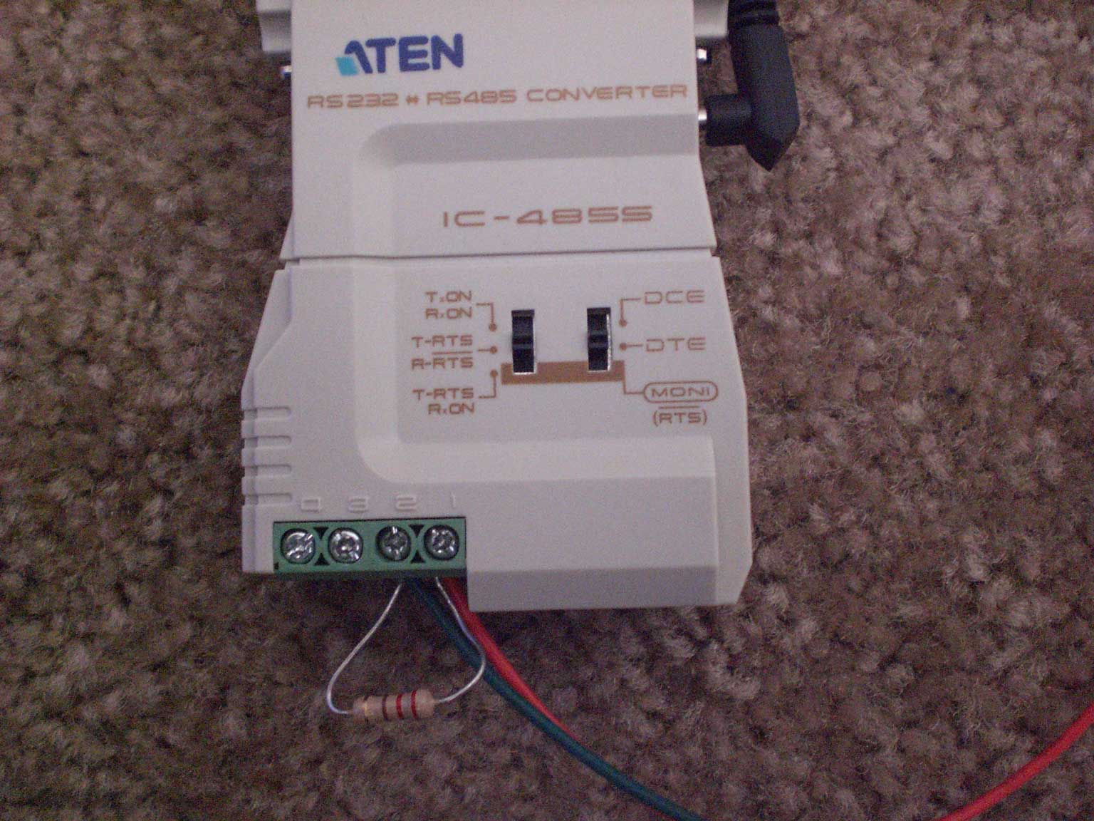

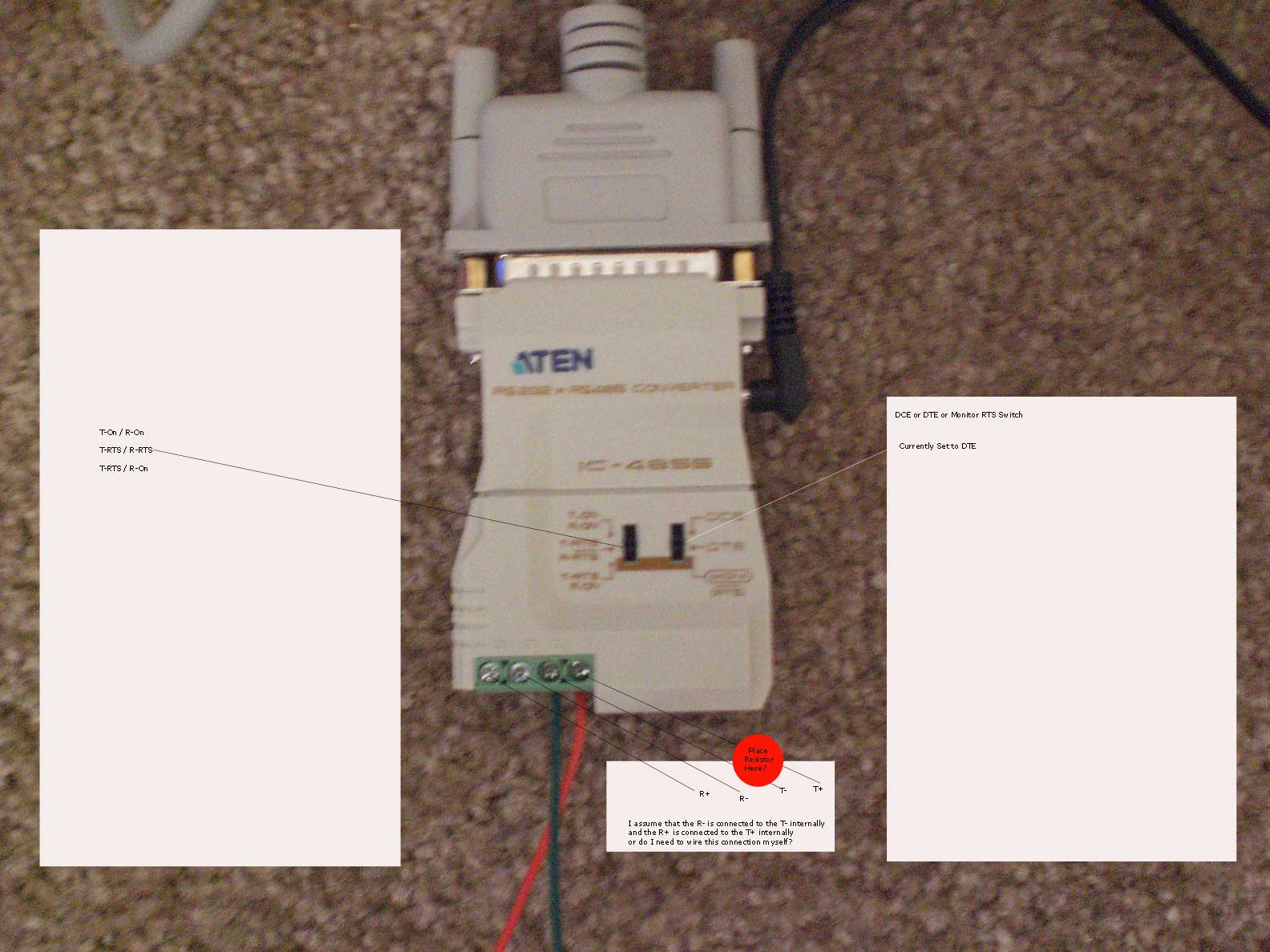

    This adapter does not have LED's.
    Here is an actual photo of the adapter with a few commments. This may help shed some light on things. I am off to the store to pick up resistors now. Thank you very much SirNoName for your time. I hope that I will be able to walk someone else through this later to return the favor and save you the time.

    I placed a 220Ohm 1/2 Watt resistor between T+ and T- per the first page of this post (see picture) and am still unable to get connected. I also tried the following in the SCN5 Plugin.
    1. external powered by 9V power supply -> save
    2. cleared with the shown wiring -> save
    3. cleared, RTS switching / unknown: is RTS normal or inverted? (Tried invert RTS switch in both modes, SEE PICTURE)
    4. 220Ohm 1/2 Watt resistor between T+ and T- on the adapter (see picture)
    5. cleared, switch set to DTE -> save
