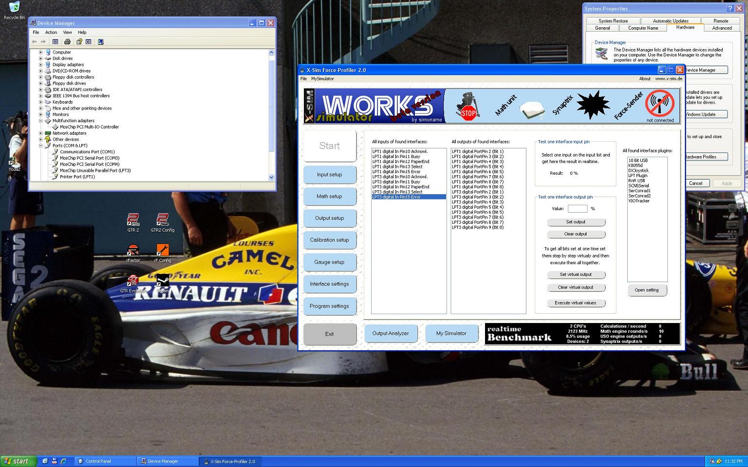

    I connected the actuators as described to a Rs-232 and the Rs-232 with a serial cable to a serial port in the computer. I made extension cables and tested the cables and they are fine. I didn't connect the killswitch wire.
    Black to GND of RS485 adapter
    Red to 5V of RS485 adapter
    White to RS485- A connector
    Green to RS485- B connector
    Connected the power to 24V 2A DC power supply. Measured voltage and it gets 24V. I hear a clicking sound when I plug the actuator in.
    But I don't get anything in the profiler, and sometimes the computer crashes if the actuators are plugged in the serial port. Here is a picture of what the com ports look like and what I see in the profiler.
    Any advice?

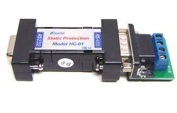

    Here are some pictures of the adapter and instructions. The instruction are a little hard to read.
    The screws on the 485 side of the adapter are labeled D+/A (white wire), D-/B (green wire), GND (black wire), +9V (red wire) - i don't know why it is labeled 9 when it is written +5V everywhere else.

    Yes, but I don't have them listed in the Interface Settings, so I can't set up anything and the computer acts weird when I plug the serial cable in (reboots, display goes blank etc). Maybe something is wrong with the adapters or the cable.

    I also tried a Com test program not to actually test anything, but it hides a com port if it is used by something else and it won't show in the the available com port listing inside that test program.
    Started the profiler then the com test and it was still showing all com ports as available. If i set the test program to use one of the com ports and start another instance of it, that com port is gone from the list. So, the profiler doesn't do anything at all.

    Ok, I am trying to get some pictures of the inside, if we ever get it working it should be a cheap alternative (only $6 each)

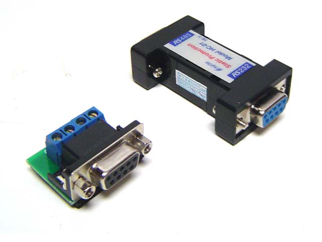

    Front side (click and you can zoom in if you save them):
    female (232) -- male(485)
    Back side:
    male (485) -- female(232)
