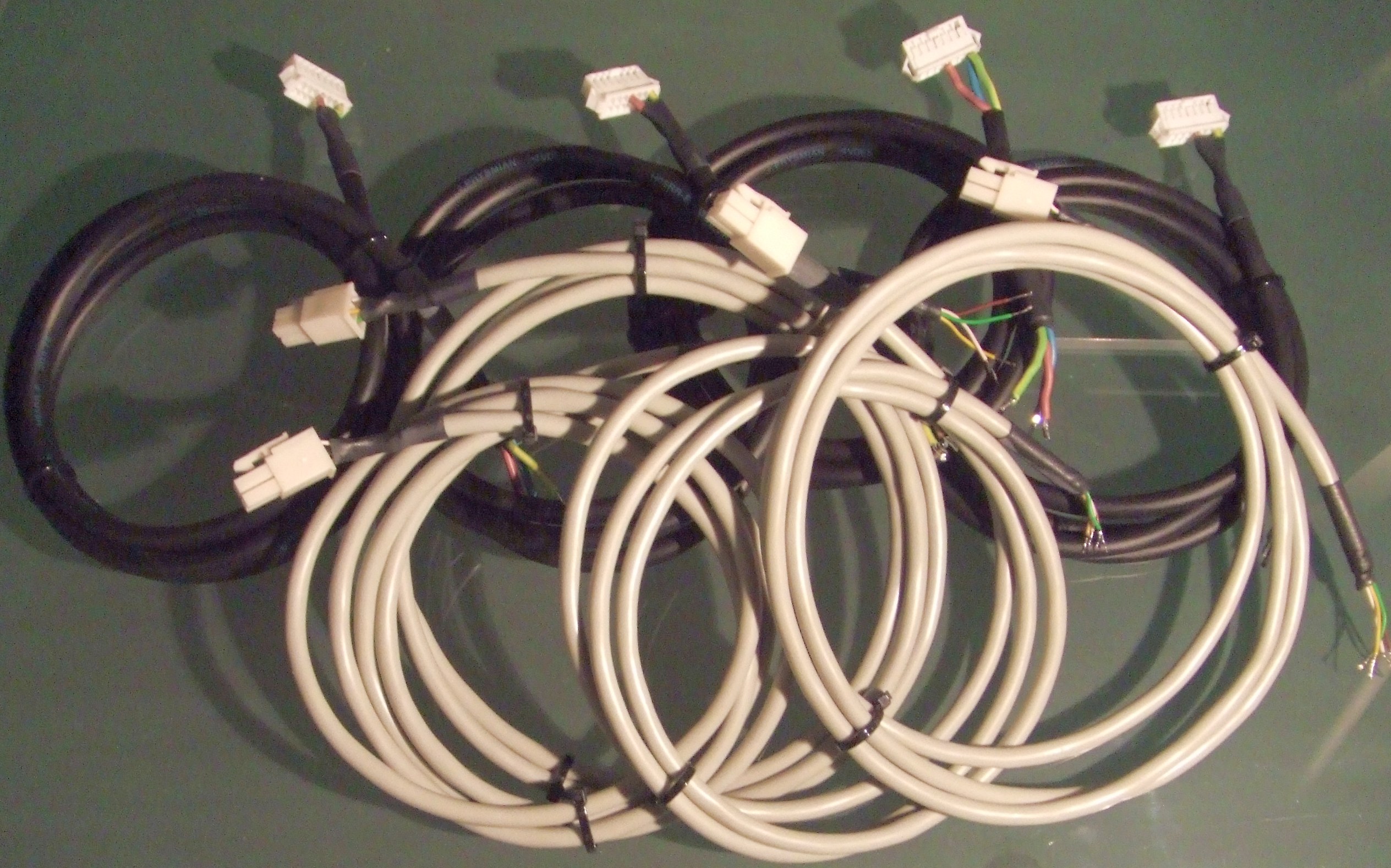

    That's not right. The comport converters suggested by Sirnoname do work and are fast enough as well. I've made 3 of them yet.
    As well I have made some adapter cables recently.
    So everybody who has his frame finished with SCN5 actuators, can ask me for cables now.

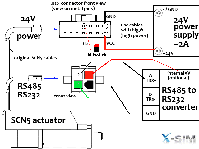

    Download the SCN5 manual from MIRAI. Page 56 details the pinout from the motor. Build your cable form there, or just snip the connector and use your own. MIRAI did state motor end-cable colors are not always consistent. Use the pinout for the correct wiring.

    I've added the killswitch into the scheme.
    Regards

    Cables, get some of those small connectors from Radio Shack and some wires (they have them in with matching colors even) and you can make them yourself to extend the scn cables so you don't have to cut the original ones.

    Every adapter is usable, as long at it outputs RS485.
    USB->RS485 or RS232->485
    The SCN5 plugin supports them all.
