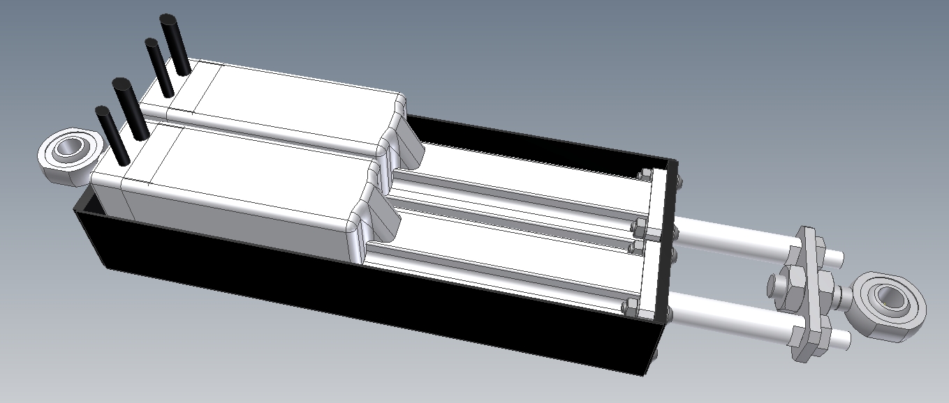

    SimSim New Member
    May 21, 2011
    4Coins
    I am looking at a slightly different rig configuration, and was wondering whether is it possible to use the SCN6 (or other) actuators in parallel to give twice the force? How would this typically controlled?
    I understand that the SimExperience 4000 can run up to four actuators, so would this be a nice tidy way of doing it?
  20. bvillersjr
    bvillersjr Active Member
    Oct 11, 2008
    1,174
    Ohio, USA
    437Coins
    +22 / 1 / -0
    You have to yoke the two actuators with 3 total pivots, not connect them firmly. This is because one actuator can be a little behind the other due to Windows timing and you dont want to cause one actuator to have to drag the other. I have seen the yoke concept successfully implemented, but I did not do this myself. Additionally, the push pull system is effective as SirNoName mentions, because the 1-2mm that you can be off in positioning is likely to be compensated for with mechanical slop as the resuly of ball joints, etc..
