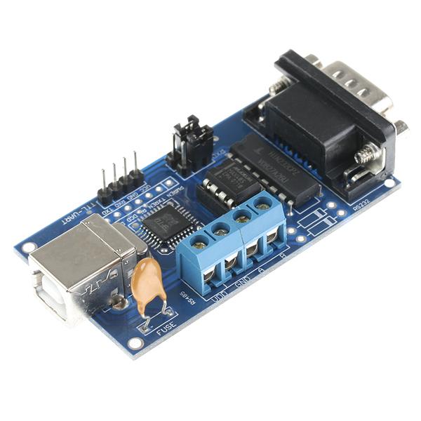

    Dear sirs,
    Do you mean this type of adaptor?
    This is just for reference to people who might be new to the forum.
    Kind Regards.

    Dear sirs,
    This concerned me slightly.
    The cheap adaptors from Ebay are usb...
    I think maybe it is all about try and testing.
    Maybe they work for some as good as NON USB. Will not work for others as PC's all differ.
    hmmm....
    Kind Regards.

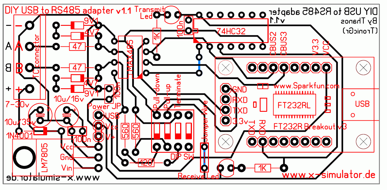

  6. tronicgr
    tronicgr
    Re: SCN5 Hardware Thread
    Wow!! You received it already!!???? :eek: NICE!! I wish my postal service was that fast too!!!! :lol:
    Anyway, Did you tested the pull-up, pull-down jumpers as well? They suppose to clean the signal in some cases and maybe will allow you achieve faster outputs.
    Also try setting the com port that it create in Serial printer mode. It will be faster and more precise in timing then for sure!
    The PCB layout photo on the first page is old and needs some repair. Here is the updated one:
    DIY_USB_485_adapter (comb) v1.1.pdf
    Regards, Thanos

    :D
    So, these can be found on ebay from the US for $7 and are auto with good response. I would say they are good if self-making is not an option.

    Great!
    I think the serial printer option would stabilize Mr.Burns converter with his own pc as well.
    So in the end, buy that converter whose pcb color you like the most :D
    They work all. Even the 7Dollar ones at ebay, or the DIY ones.
